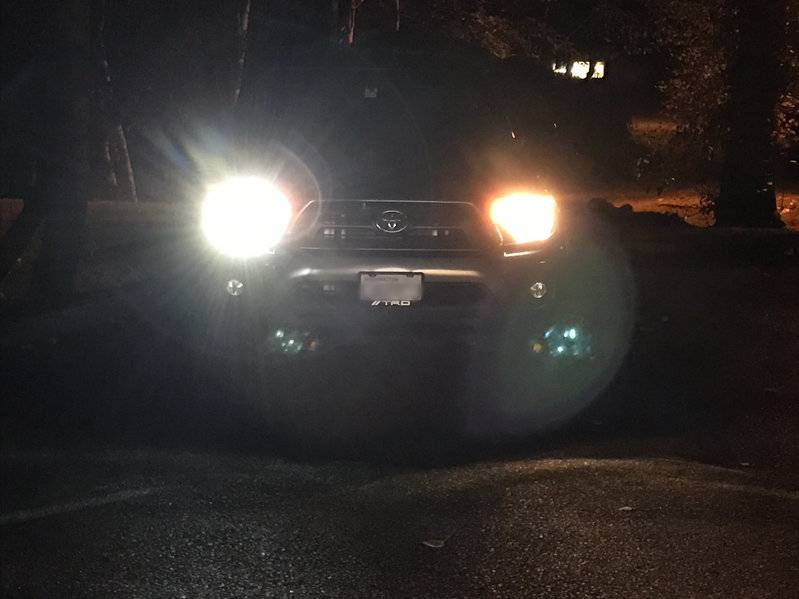

Light cut off is not the only problem. Glare / Spillage is.
Even if you achieve somewhat normal cut-off, that is not the problem, the below picture is what you are subjecting oncoming drives to. By physical design reflector headlamps are suppose to throw light everywhere. They are giant bowls with chrome plating.
Projector headlights are built with a focal point / dome housing design for a reason.
https://www.tacomaworld.com/threads/why-leds-should-not-be-run-in-halogen-reflectors.454371/
