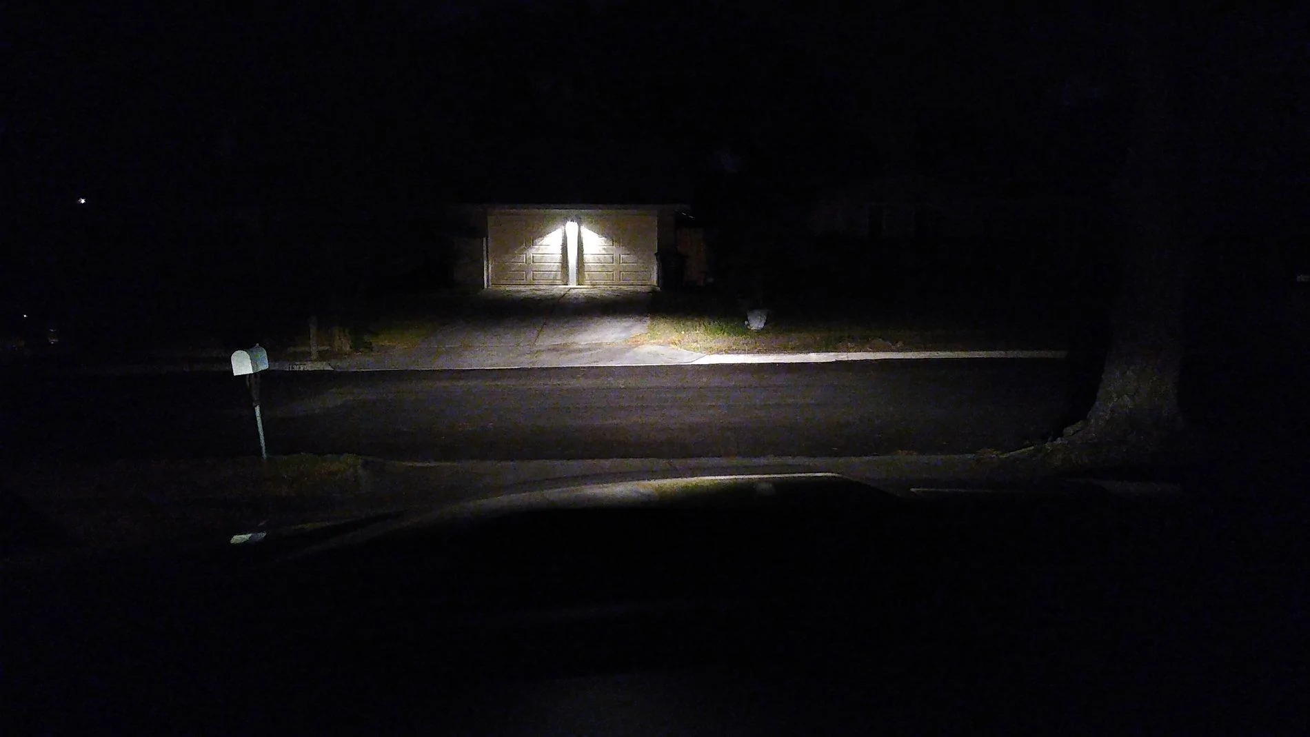

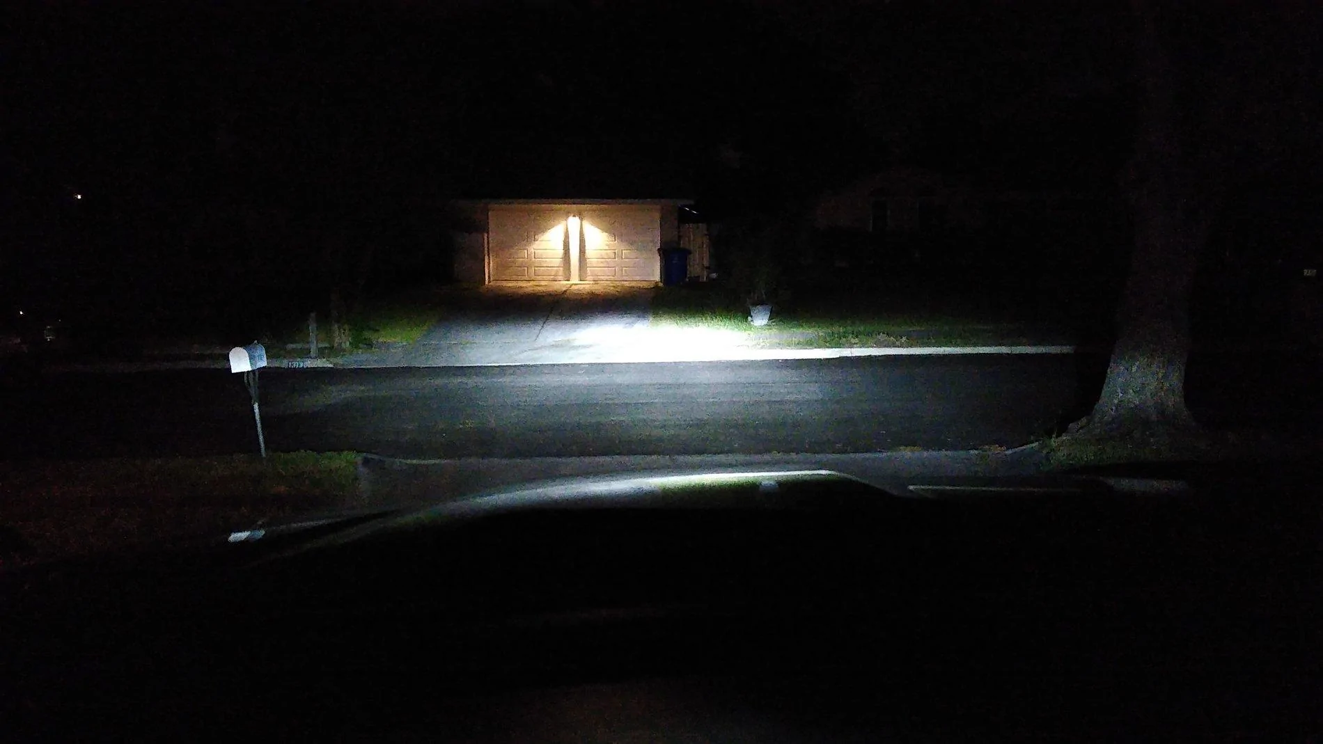

I figured we could maybe get a thread going to compile everyone's LED/HID upgrades from halogen.
I found a website, bulbfacts.com that reviews all kinds of lighting upgrades from Amazon. From his information, I bought the Hikari Ultra LED kit.
Here are the results:
Stock halogens:
I didn't want something that would create too much glare but I did want some more foreground light with a little more light at the edge.
The only downfall is that the covers will not fully seat because the fan motor is so big. They can be partially installed to keep dust and water out for the most part.
I would recommend the Hikari Ultra kit.

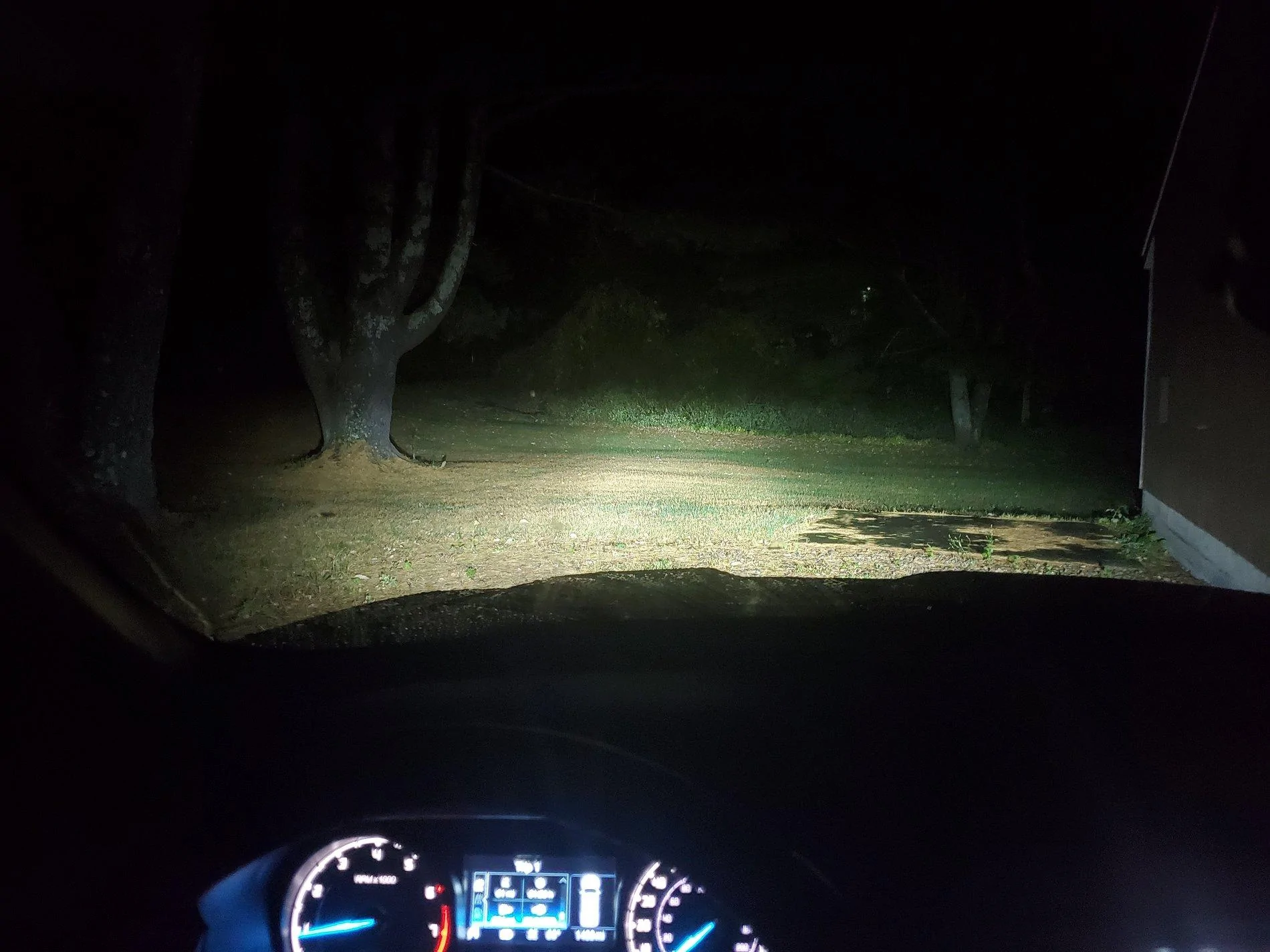

I purchased:
H11 LED Headlight Bulbs Mini Sized 80W 16,000LM Per Pair High Bright, AUXITO H11/H8/H9 Headlight LED Bulb Conversion Kit with Cooling Fan, 6500K Xenon White, Pack of 2 https://www.amazon.com/dp/B07WD6G42D/ref=cm_sw_r_cp_apa_i_eR.MDbJPCXX1X
And
9005 LED Headlight Bulbs Mini Sized CanBus Ready 80W 16,000LM/Pair Extremely Bright, AUXITO 9005(HB3) Headlight LED Bulb Conversion Kit, 6500K Xenon White, Pack of 2 https://www.amazon.com/dp/B07WCSJQYC/ref=cm_sw_r_cp_apa_i_FR.MDbFX3WS87
They both have the resistors built in and can easily be tucked into the headlight compartment and the dust covers fit on both the low and high beam bulbs without any issues.
I didn't really have to do any adjusting of the bulbs aside from lowering the low beams a little but the beam pattern is pretty good and it's a nice bright light.

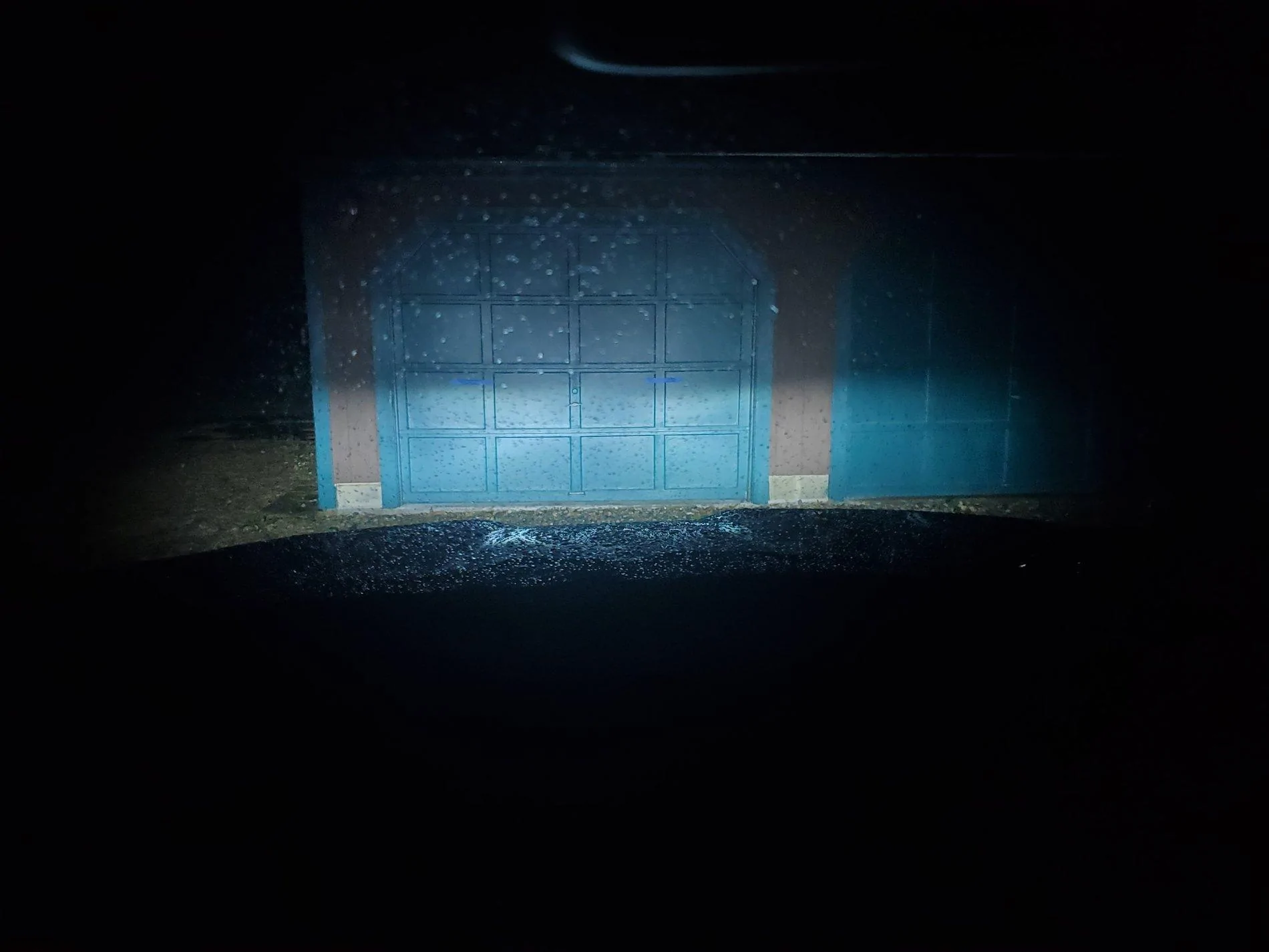

So as much as you are trying your comparison is invalid. Open field vs a garage door show no difference beside light color
