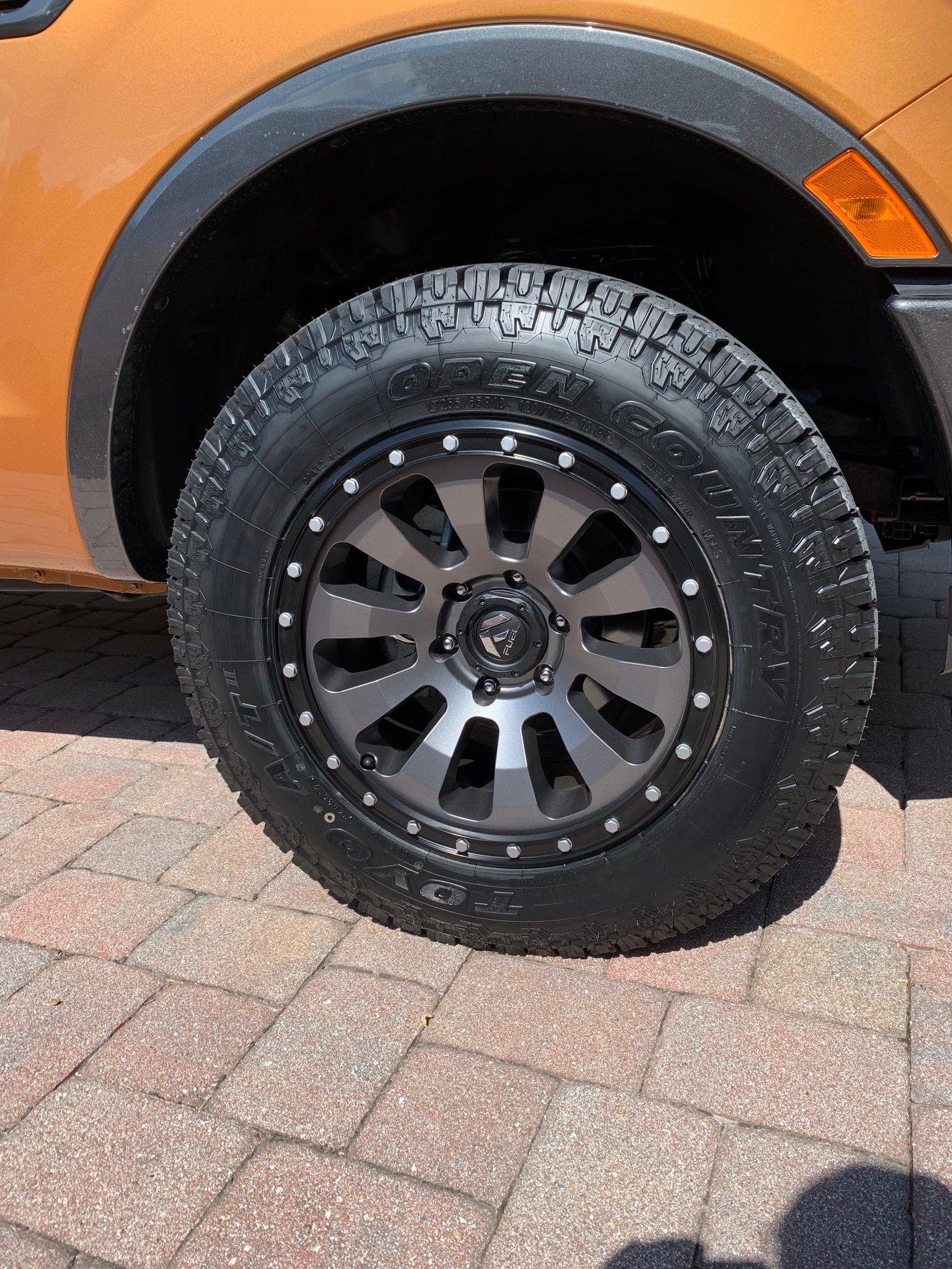

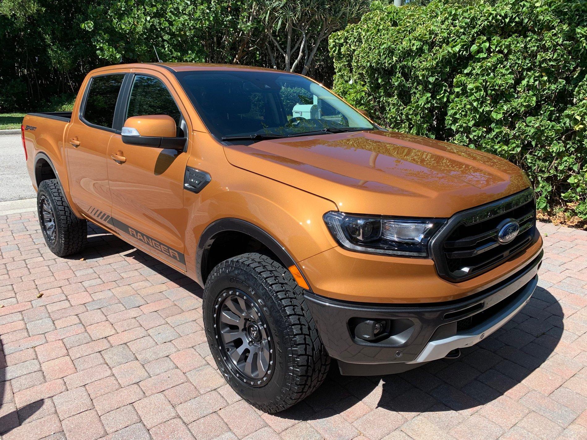

Got my Rough Country leveling kit and Toyo Open Country AT II tires installed.

With a 2.5" leveling kit, do you think I could run 275/70/18s?
Jeffrey
Jeff
May 5, 2019
44
107
Singer Island
Ranger Lariat
You will most likely have to remove the crash bars. I put Fuel Tactic 18 x 9 with Toyo tires, you can remove the crash bars without cutting by loosing front bumper.
You can remove the crash bars without removing the front bumper? Could you let us know how? Everyone who has posted has said that they cut them off because the bumper gets in the way. From when I've peeked in the wheel well it looks like the bumper gets in the way too.
Doug, I took mine to a tire and rim shop, they told me they loosened the bumper and pulled them out, they handed them back to me.
Jeff
That's good to know! Thanks for the reply.
