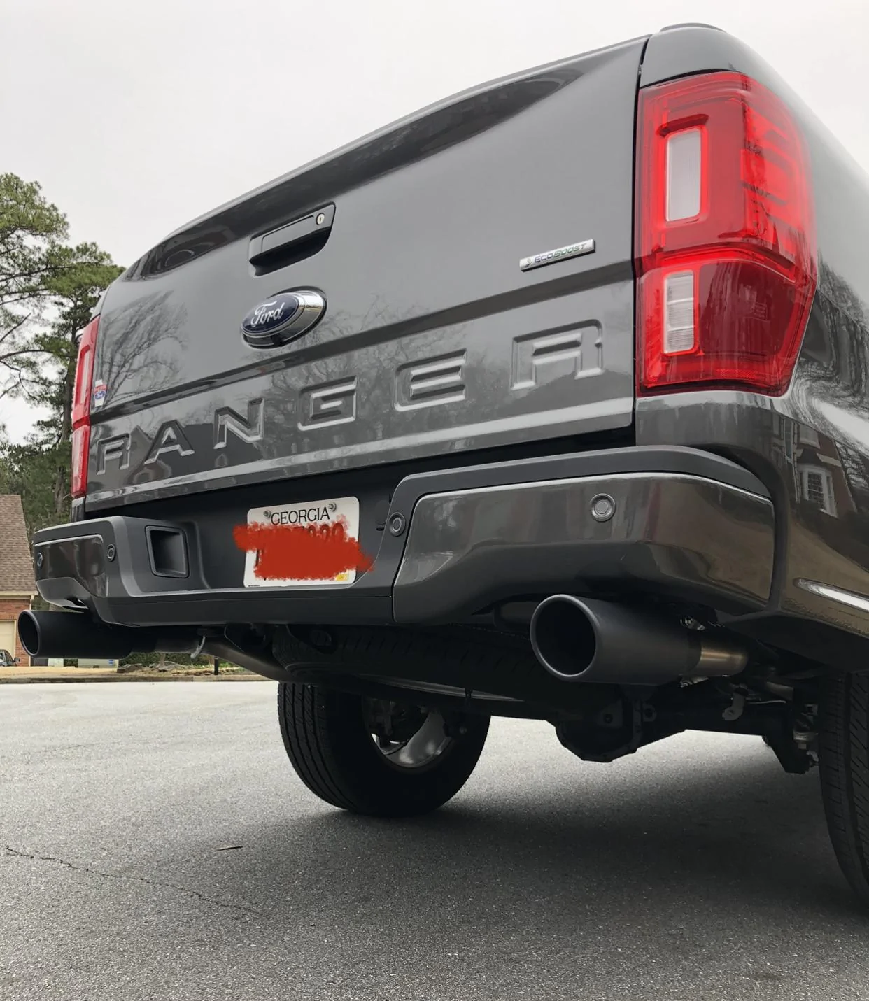

For a rear dual exit, that looks like its tucked up nice and high- doesn't look like you lose much departure angle if any. Which is nice.

I promise the Gibson is WELL WORTH the money compared to other cat-back systems. The sound is a more mature one yes, but I've learned my lesson on loud mufflers in the past and they're best saved for cars w/ manual transmissions IMO. Plus look how much better this looks.

Looks great!! Did you consider the MBRP version that's similar to this??

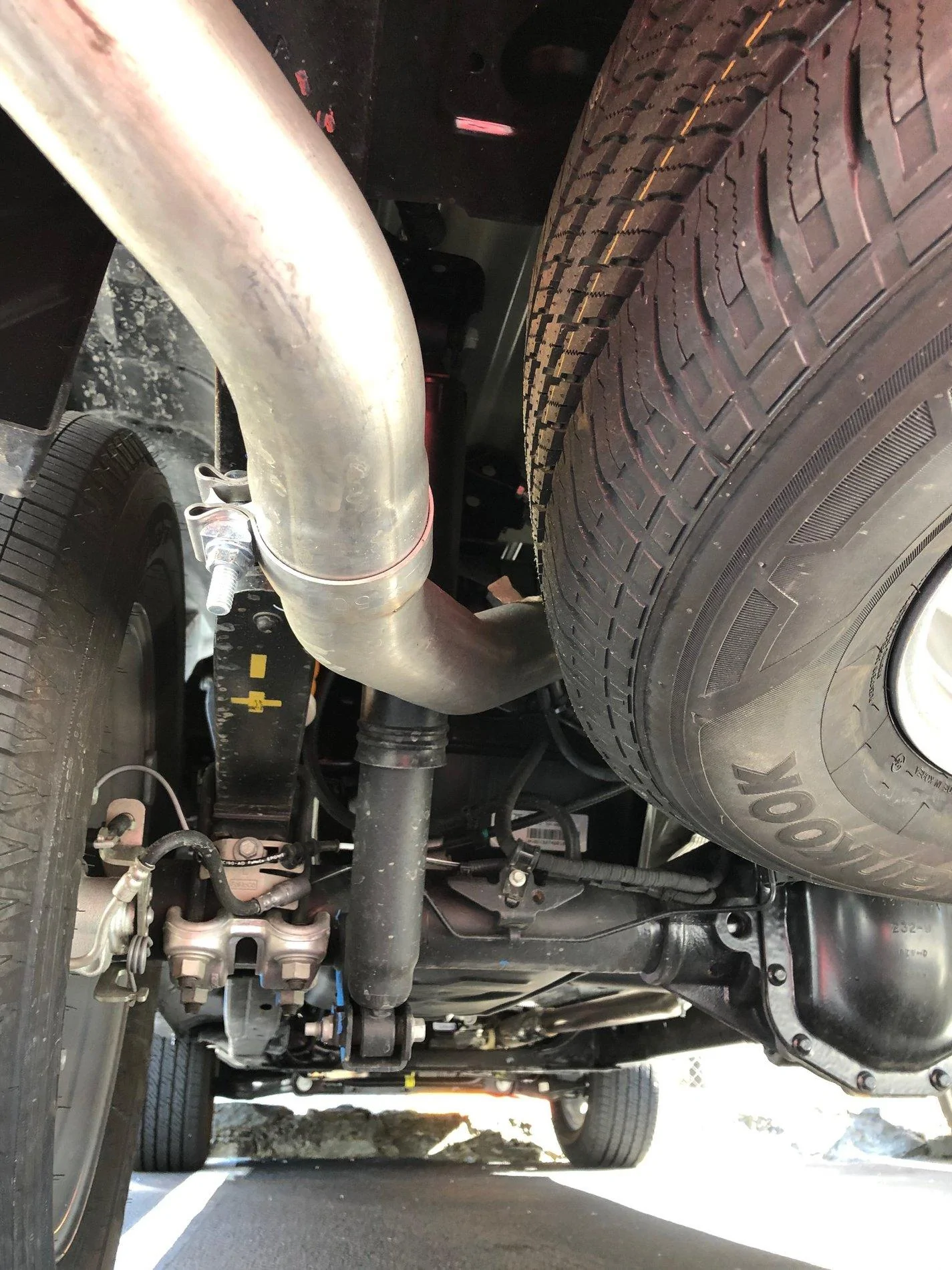

How much clearance do you have on the driver's side and your spare tire?

I'd guestimate about 2.3 - 2.8 inches. I plan on adding a little bit of heat wrap to that section at some point to be safe.

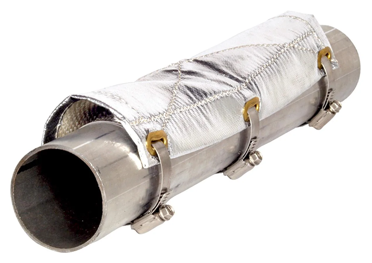

Thanks for posting this. It looks like people who have or plan on having bigger tires with a matching spare may not be able to get enough clearance. Even with the stock spare I think a wrap or heat shield would be a good idea. Maybe something like this Thermo-Tec clamp on shield.
