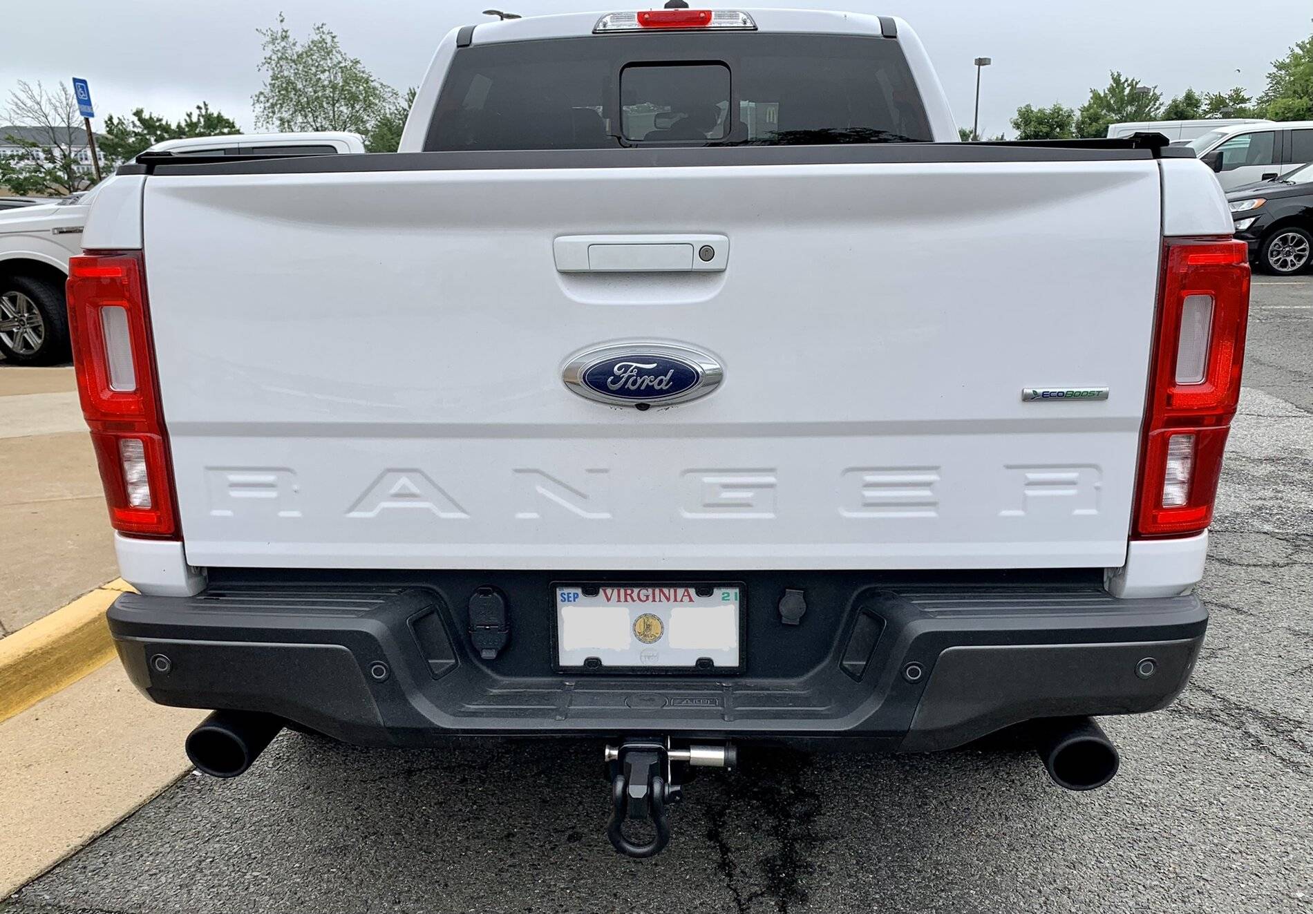

I had all of the same problems with the cheap clamps and things not lining up correctly. Had to adjust it enough times to where I finally said F it and took it to get it welded. Looks like this now:
Exhaust sounds great (definitely louder and deeper than stock, but still pretty tame and not fart can sounding), and it makes the truck look like a mini raptor. I love it, but there was a moment where I didn’t lol

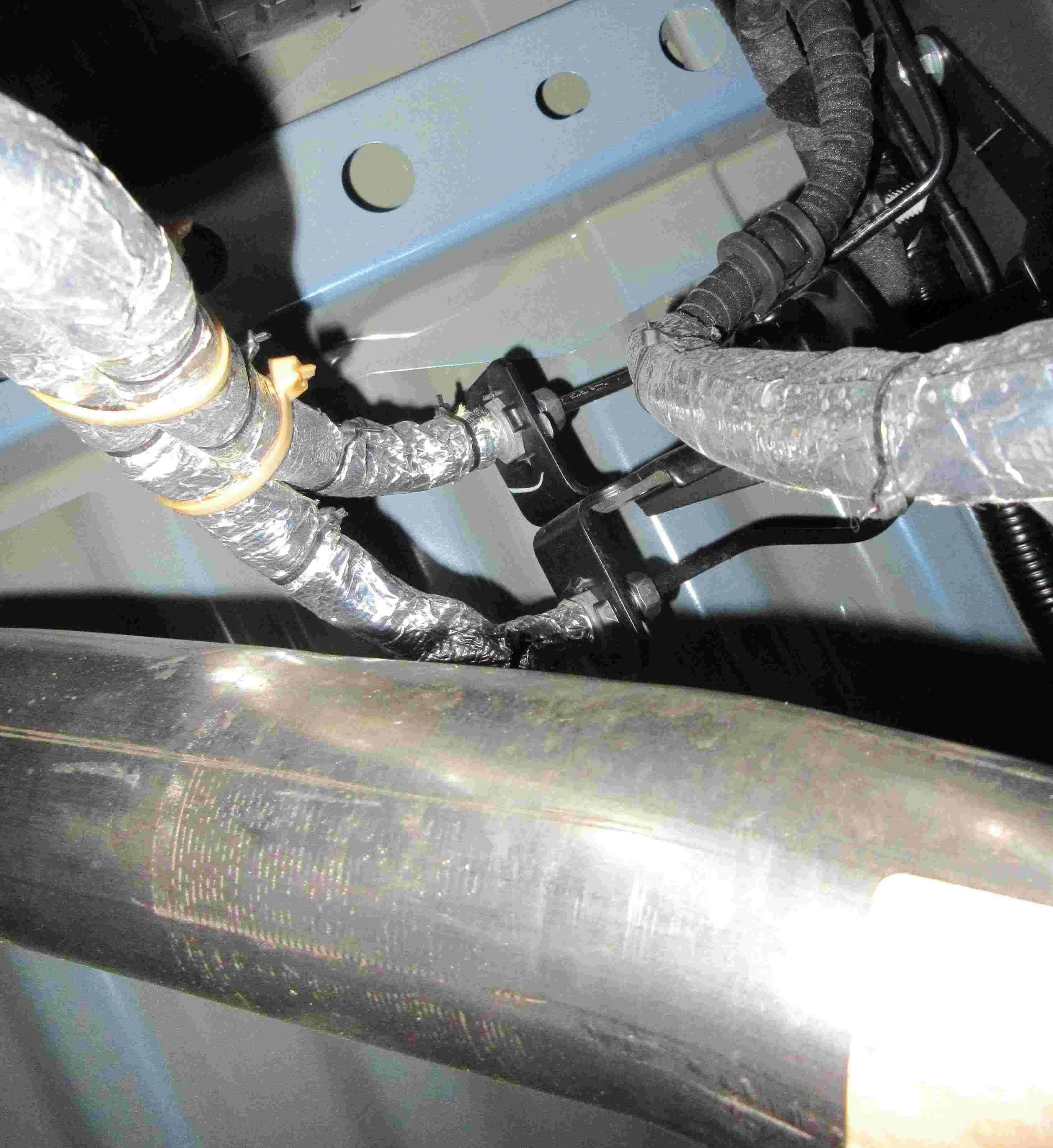

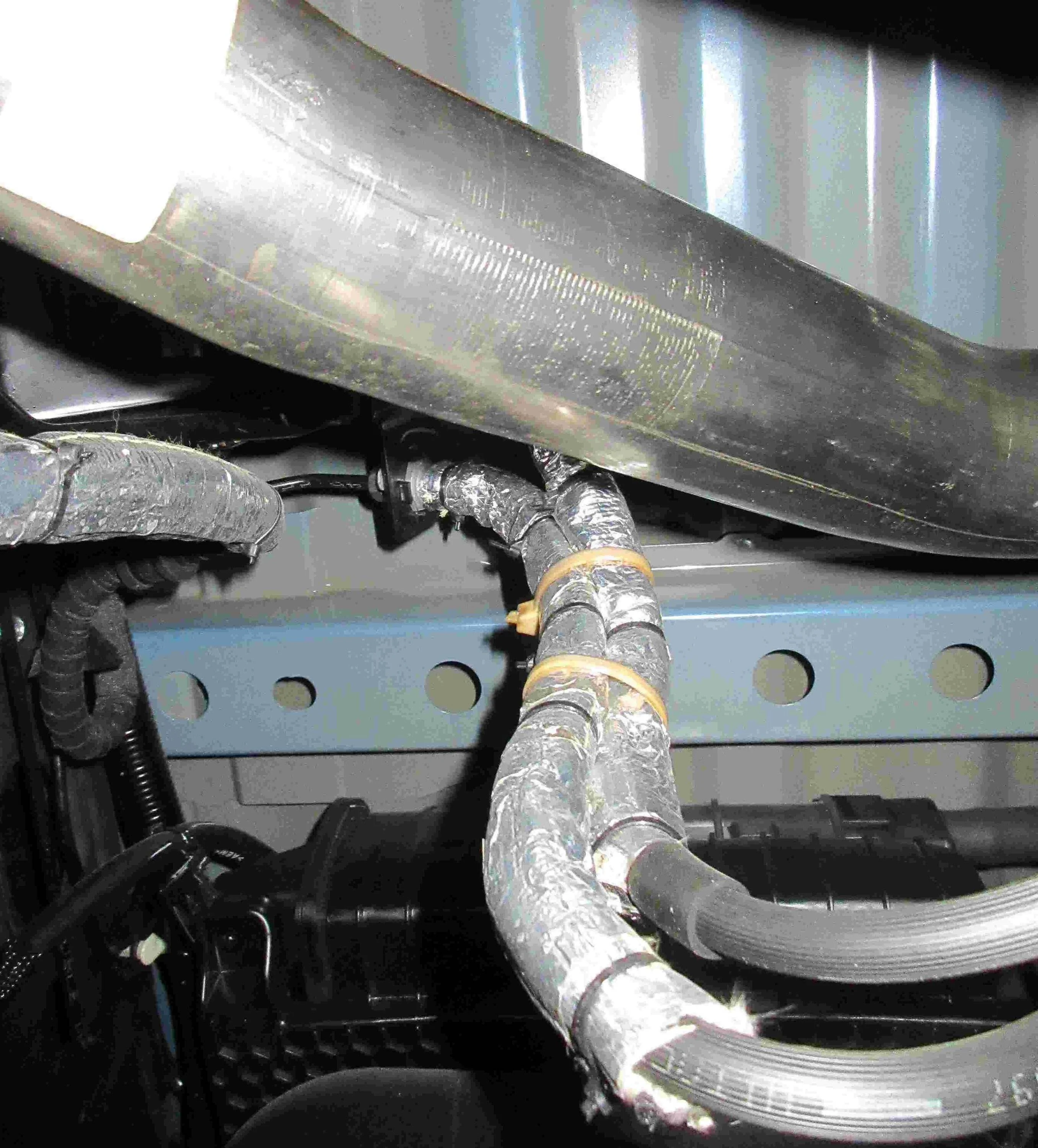

Super Cab with rear seat delete and not getting any drone, just louder than stock when you floor it’ Something to watch out for is brake lines & electrical wires come pretty close to the cross over pipe. Kit comes with a fiberglass type cloth & ty-wraps to shield the brake lines. Might be overkill, but I used aluminized fire sleeve on the brake lines & electrical cable, with high temp ty-wraps. Also a 265/70R17 31.6 in spare fits O.K. between the pipes.

BY cross over, you mean the part of the pipe on the front side of the spare? I'll have to look, not sure the shop would know what to do with the shield.

Yes where the pipe goes from one side to other behind the spare tire. Bought mine in 2022 for $725.00

I just checked, the shop installed the heat shield and did nice job! I paid $784.
