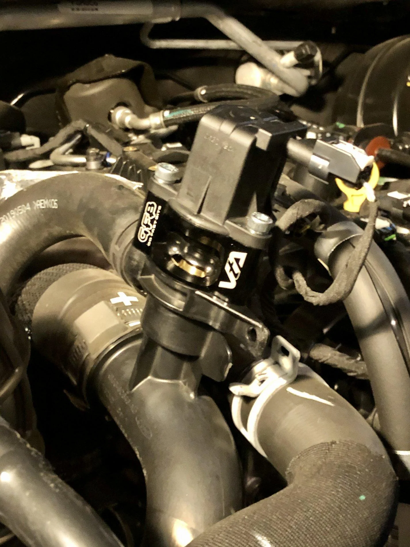

Mine came, it's the authentic part and easy to install. I debated leaving the Piston spring out (the GFP plunger replacement spring of course went in) since the instructions suggested having the spring in was more akin to having a 'sport mode' effect. I guess not having the spring would allow the valve to snap shut faster and minimize the benefit of holding some boost pressure back. With the two automatic trans modes I am starting with this in; haven't changed any other specs on the engine other than the Magnaflow cat-back exhaust and catch can, wondering what better 'boost holding' GFB says could be had without the spring. I'm more interested in a more refined turbocharged experience after having driven older turbos in the past, thinking of low-speed performance they mention in their literature.
https://gfb.com.au/products/blow-off-and-diverter-valves/dv-plus/
From their instructions:
The main spring installed can be thought of as a 'Sport' mode, offering the best possible throttle response and boost recovery during on/off throttle applications (i.e. during gearshift with a manual transmission).
Using the main spring means the DV+ can open and close progressively in response to how much boost
pressure is present unlike the factory diverter which just opens fully regardless of whether there is boost to vent or not.
It is not unusual (or detrimental) to hear a different sound from the intake when lifting off the throttle at low RPM, especially if you have an aftermarket intake or a larger turbo installed.
If a different sound does occur and bothers you, it is possible to install the DV+ WITHOUT the main spring
behind the piston. This configuration can be thought of as an improved 'Standard' mode, which behaves
just like the factory diverter, but with the added benefits of better boost-holding, strength, and reliability.
Racket
Jan 21, 2020
2,265
3,591
Here and There
2019 Lariat Supercrew 2WD
Transient
Follow up: installed the diverter valve (easy) and drove the truck a couple days. Used S mode to utilize the turbo more - and thought at first I may have made a terrible mistake buying this. The engine would 'bog' as it neared redline and refused/balked before shifting...
Looks like the ECM had to go through a learning step (or two/three). Week and a half later, truck s running fine, spring still in the diverter valve. Took a trip a week ago mostly highway and loaded/unloaded the truck was pleasing to drive.
I can't detect a radical change in high RPM shifts so I may be imagining it, but the Lariat pulls and pulls smoothly to.... Oops, triple digits.
This is a simple - and not extraordinarily expensive - upgrade to the wastegate, maybe there will be a long term benefit and perhaps the Sport mode will be more refined.

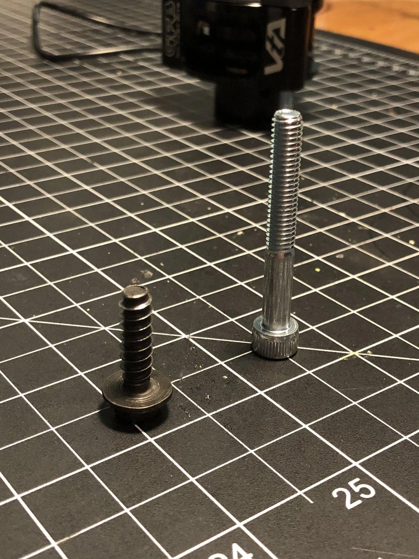

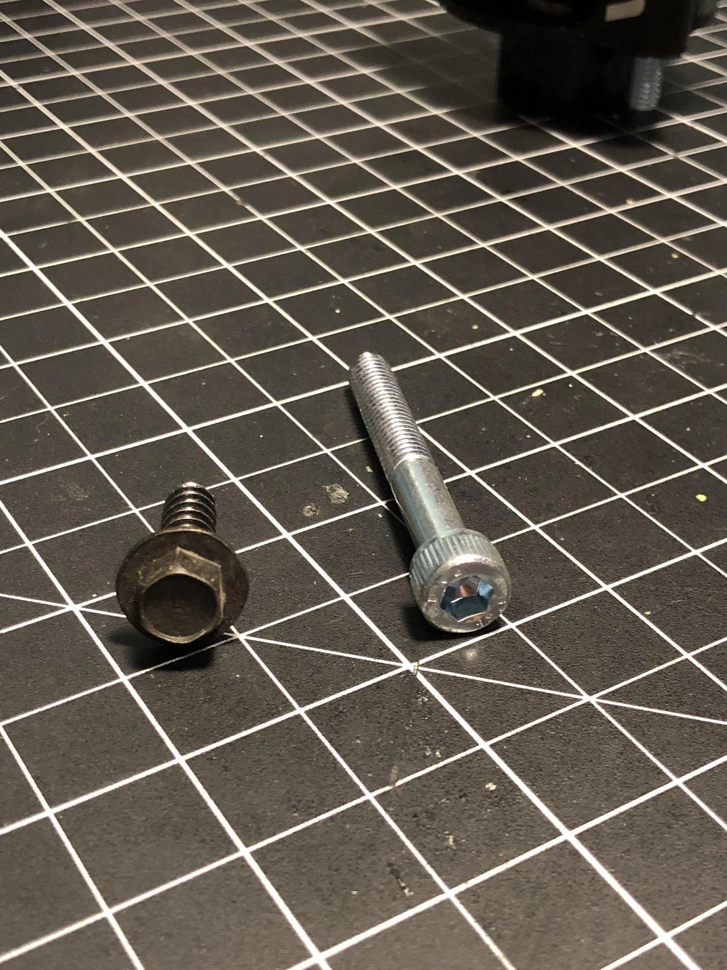

Hey guys, having a bit of an issue installing the DV+ VTA. 2019 ranger manufactured 6/19
The hardware securing the stock DV has a much courser thread than the supplied hardware. Am I doing something wrong here? Pic below.
I should’ve just kept reading, lol. Just threaded new hardware into plastic housing.

So, the new bolts in the kit rethread the factory housing, and you have to permanently modify the stock diverter valve to reuse a piece of it? I don’t know how that makes me feel. I need to be able to revert back to factory quickly in case of an emergency.
HarryD
Sep 3, 2019
197
129
Western MA
2020 Ranger 4X4 SuperCrew Magnetic Lariat Sport
The new bolts don’t actually rethread the mounting holes because the original screws are way coarser and cut deeper threads than the replacement ones. That being said, I was planning on installing heli-coils for a better thread engagement and to revert back to stock only would require shorter screws.
I changed my mind, however. I am going to install “Heat-Inserts” instead. This uses a solder iron type of tool to melt the plastic while the insert is being pushed in and then hardens around it. I will then have permanent M6-1.0 threads in place.
