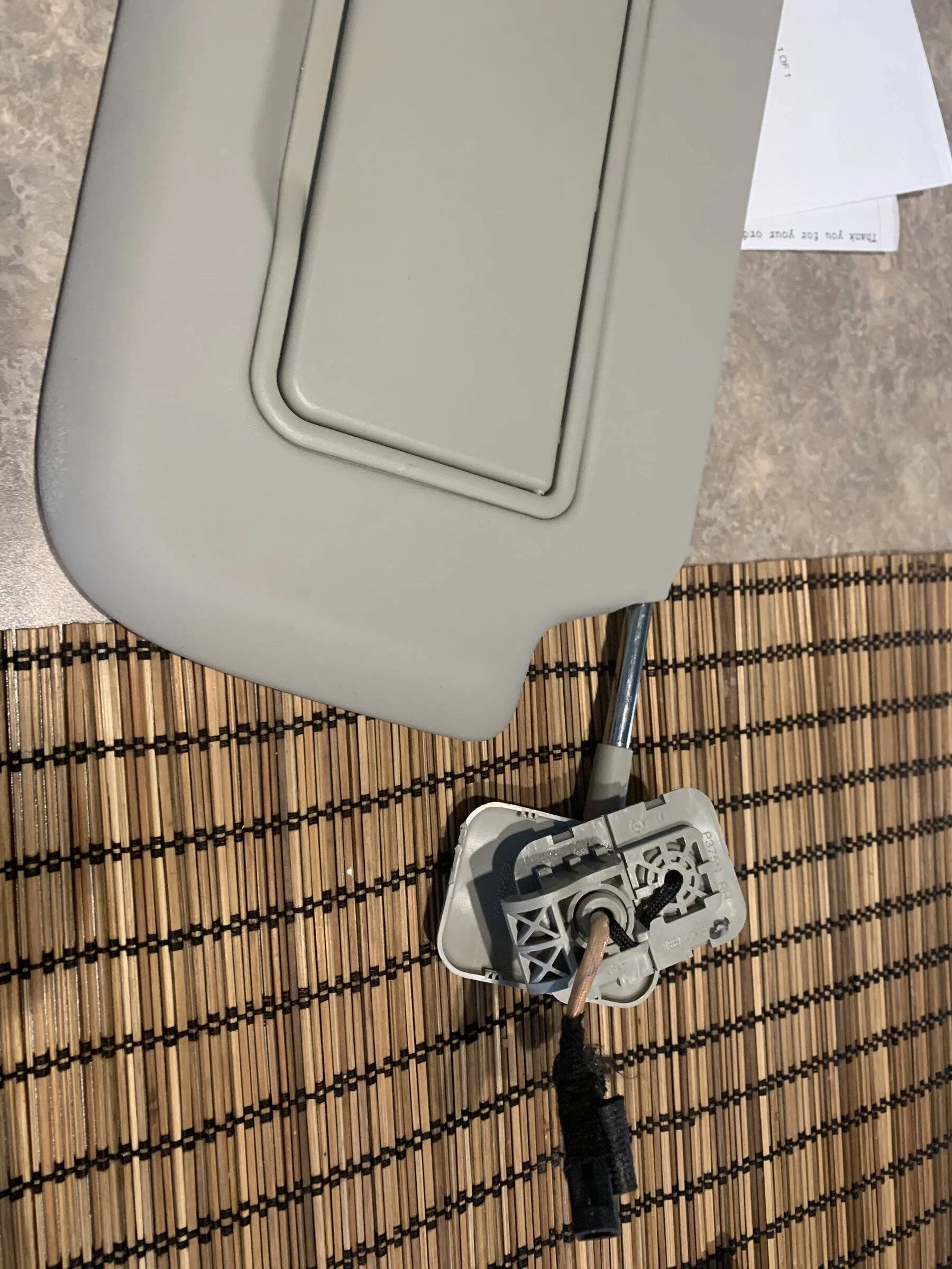

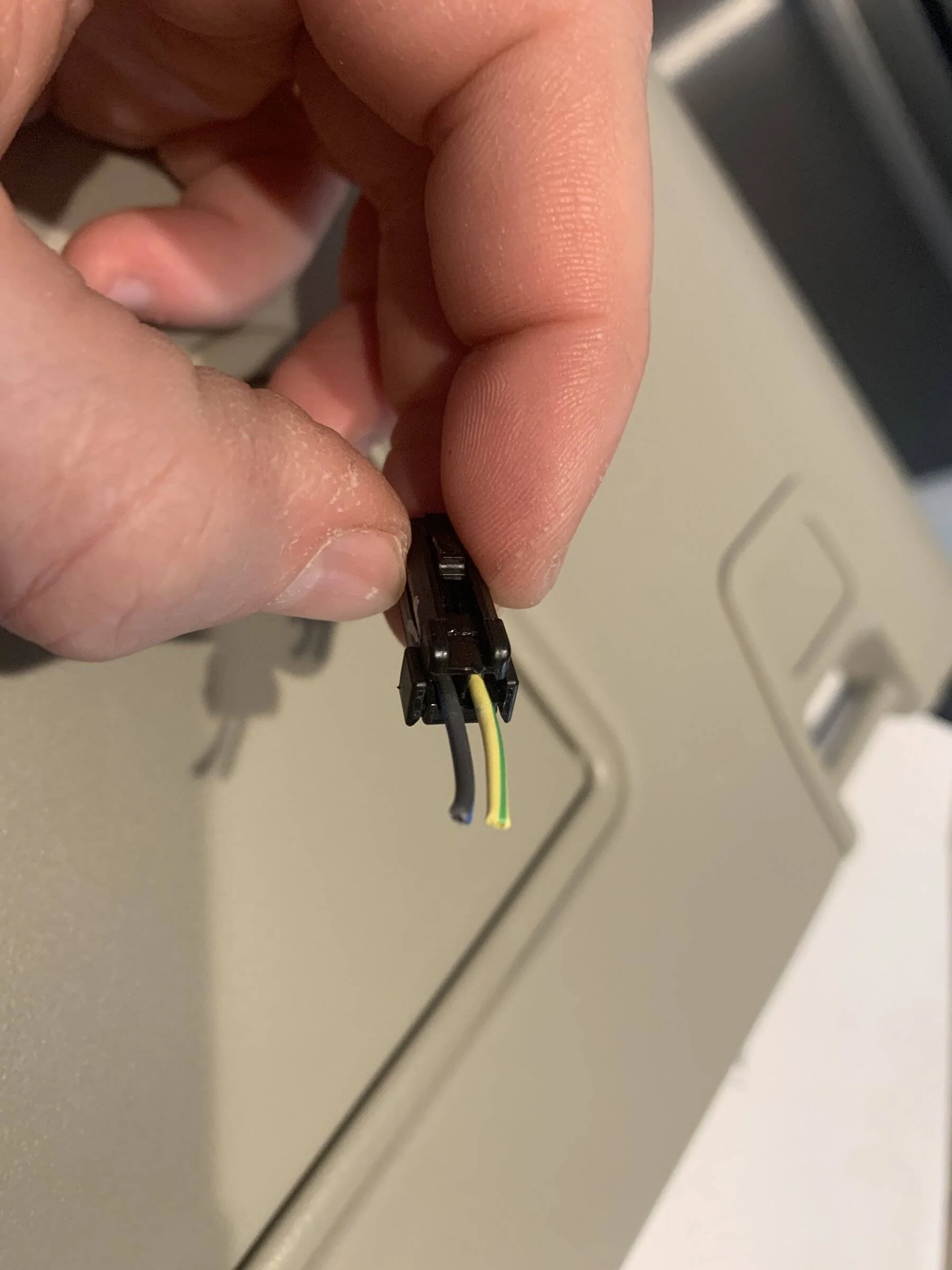

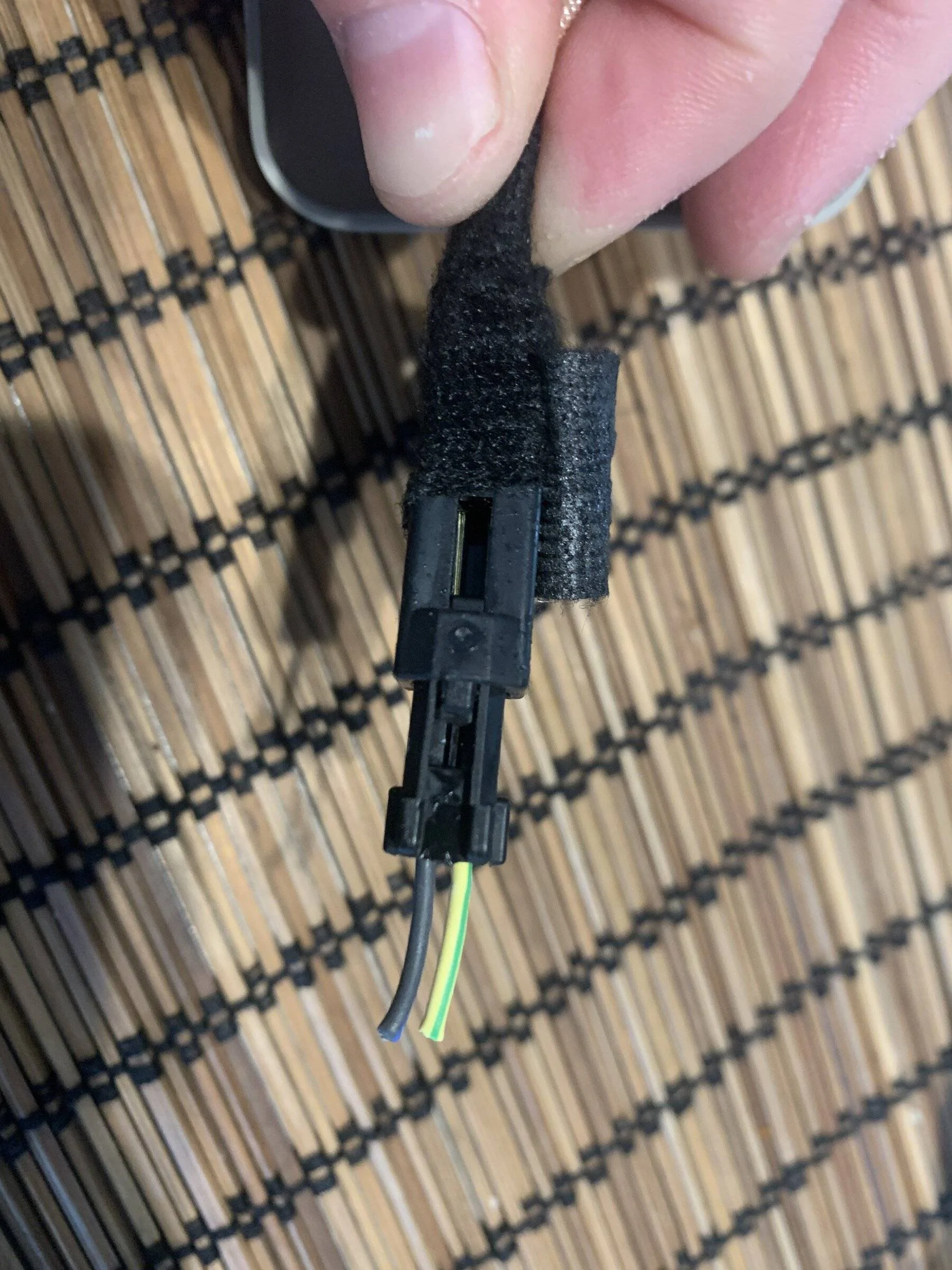

Alright, I got my Lariat visors w/Homelink in the mail the other day from LKQ. They were kinda dirty/mildewed but they cleaned up nice with just water and a little magic eraser action. Now for my question. I plan on wiring these up to an ignition fused source from the fuse box on a dedicated wire ran up the A pillar. I have an XL so I don't have any power wires near the mirror and I specifically want the homelink activated only when the ignition is on. The dismantler cut the wires very short but at least gave me both halves of the connecter. Is it possible to remove the short wires from the connecter and replace them with new ones? I hate to cut and splice with such little wire and if I can avoid it altogether that's what I want to do. I'm also not super savvy with electrical connections so if anyone can offer some insight on how to wire it properly that would be great. I planned on using an Add-a-fuse thing in fuse box like this unless there is a better way:
https://www.amazon.com/Nilight-5004...e&qid=1643826829&sprefix=add+a,aps,308&sr=8-3
https://www.amazon.com/Nilight-50040R-Holder-3-Circuit-Standard/dp/B07TBRM45F/ref=sr_1_3?crid=2RN4KMCI4HUAP&keywords=add+a+fuse&qid=1643826829&sprefix=add+a,aps,308&sr=8-3
HERE is how I did mine. I had to buy the connector body and pins. You do need a crimp tool thats better than a red-blu-yel crimper. I tapped into an existing line
