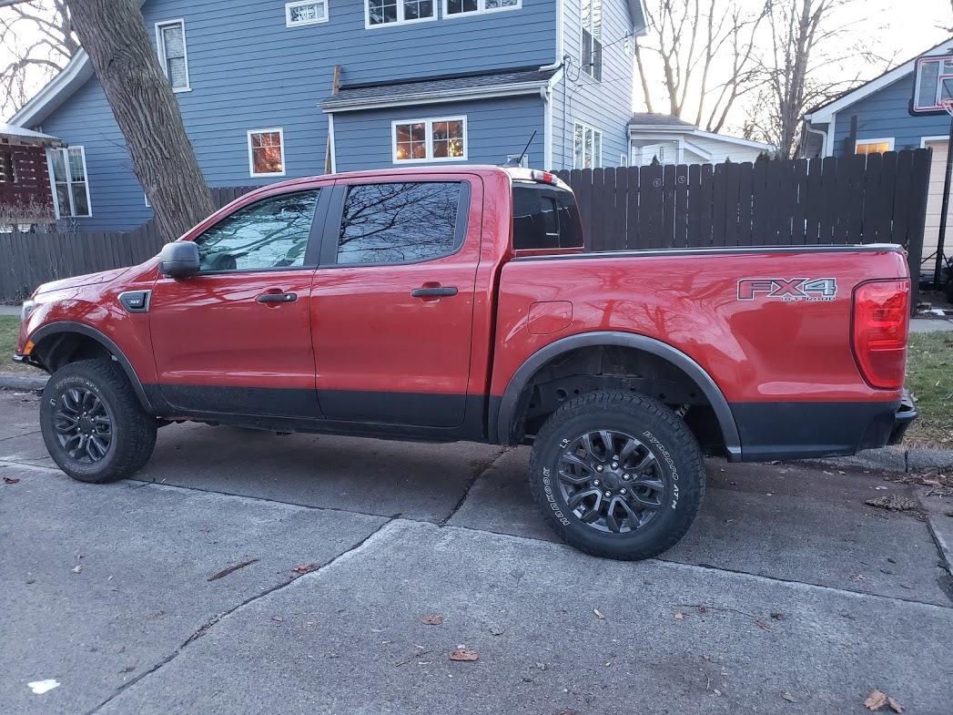

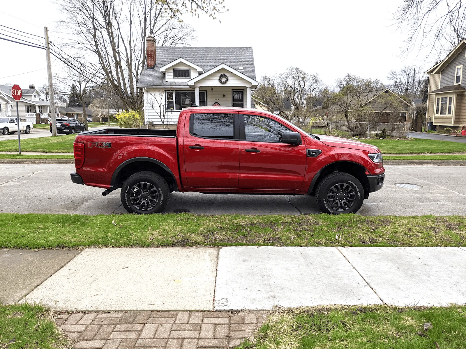

Here's the truck as it sits this morning:
That's an SVC tubular rear bumper (!) and with the rocker blackout wrap courtesy of yours truly.
I keep saying I'm going to install the suspension, but family always becomes the priority. This thing is going to look so good with a small lift!

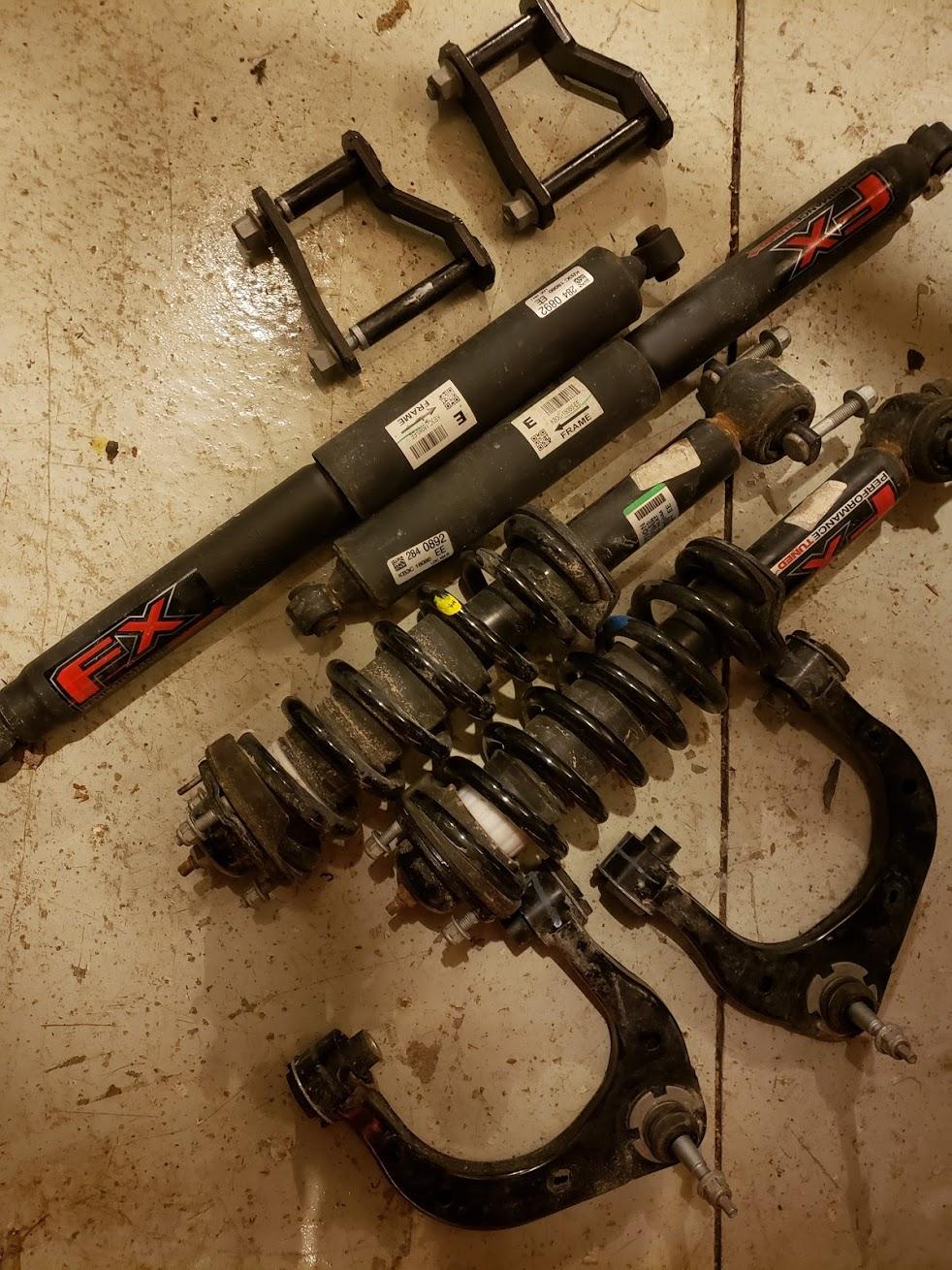

I spent some time this week and installed the suspension and wheels / tires. Suspension first!

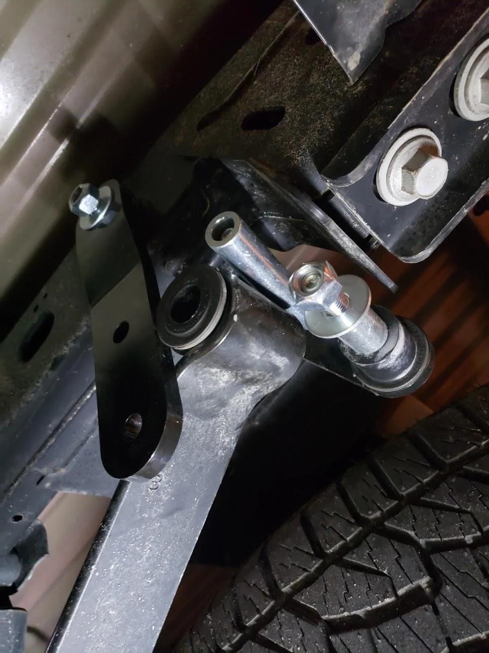

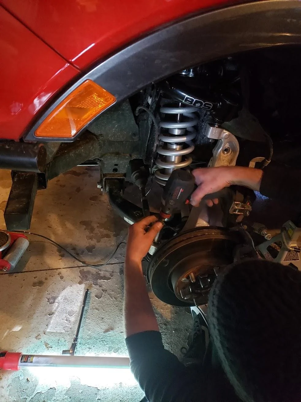

I had ordered BDS / Fox suspension back in April from Impulse Offroad. It arrived quickly, and then life got in the way. My truck's 1 year anniversary from it's adoption date was my wakeup call to switch priorities around.
Out with the old...
A pic of the BDS rear shackles being installed...
Here's a pic of the front Coilover installation in progress...
Installation was extremely straightforward, but as usual it took longer than expected. Hours seem to fly by when I'm in the garage. I might be the World's slowest mechanic, but at least I am happy.

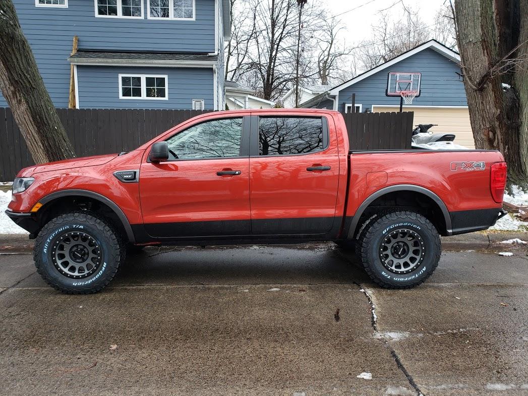

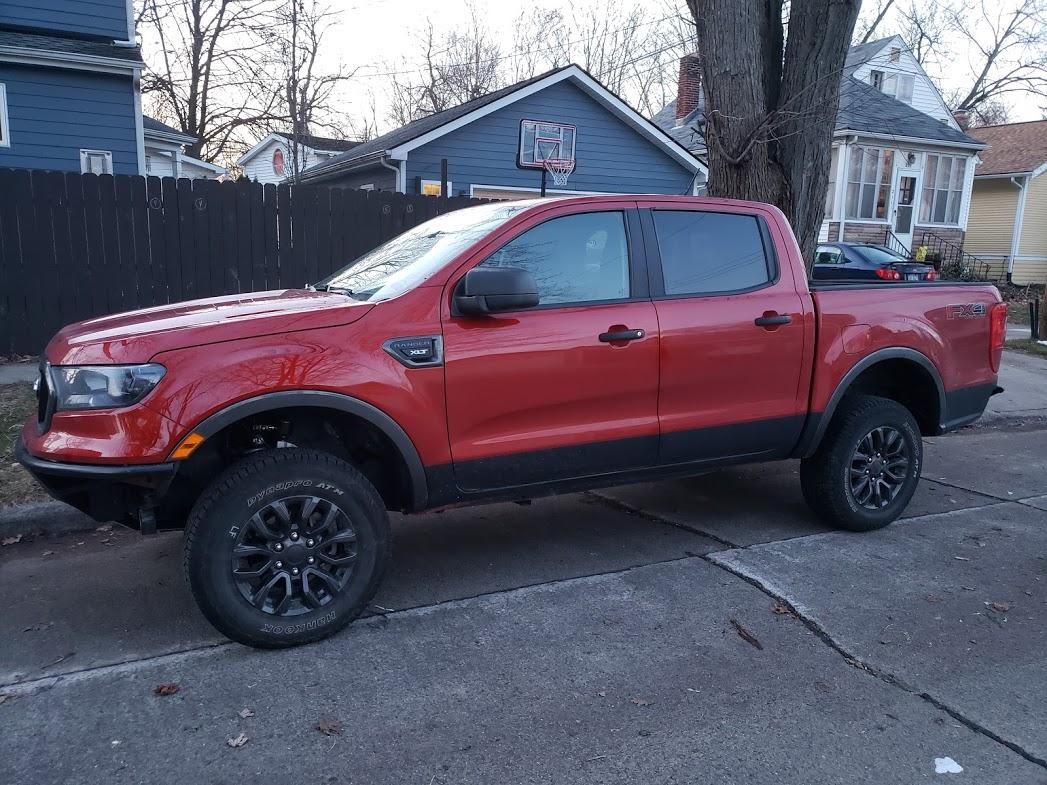

Here are a couple of before / after comparison shots with the suspension lift.
Looks better, but not quite done yet.

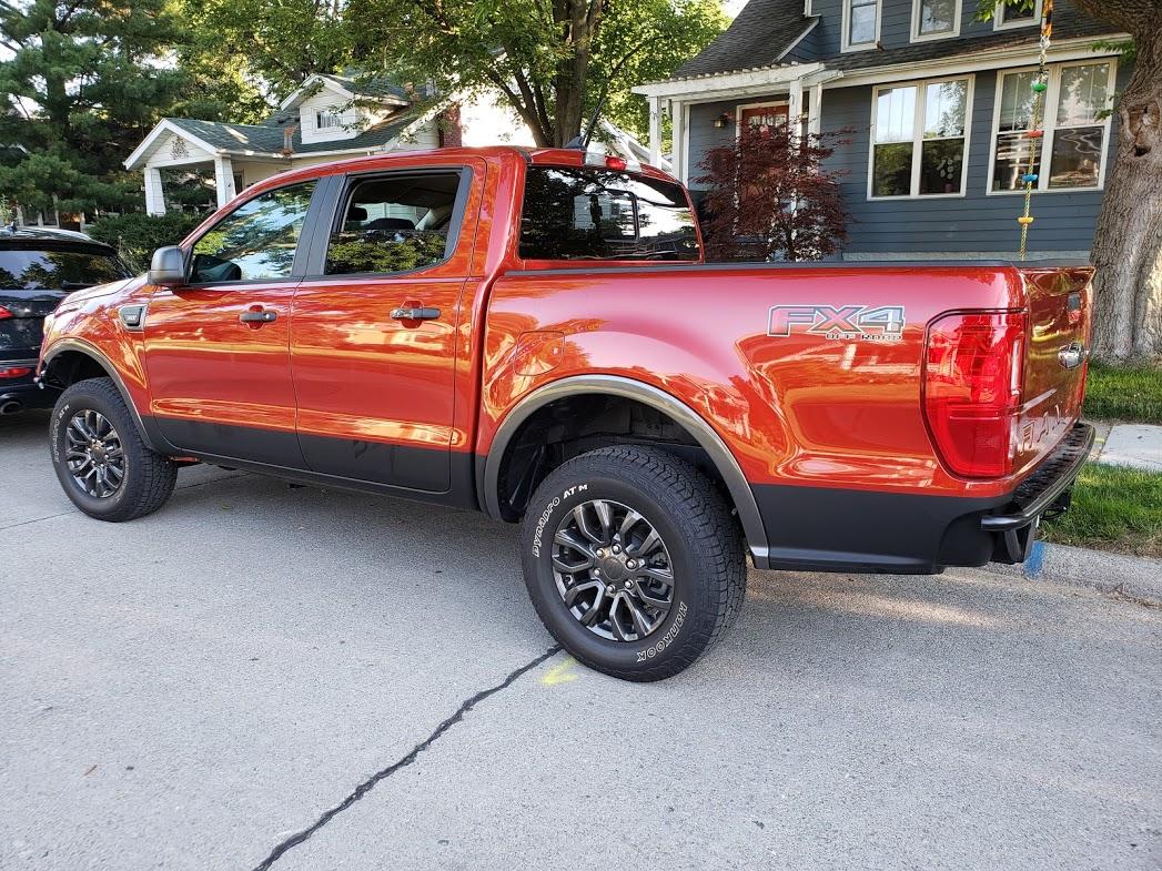

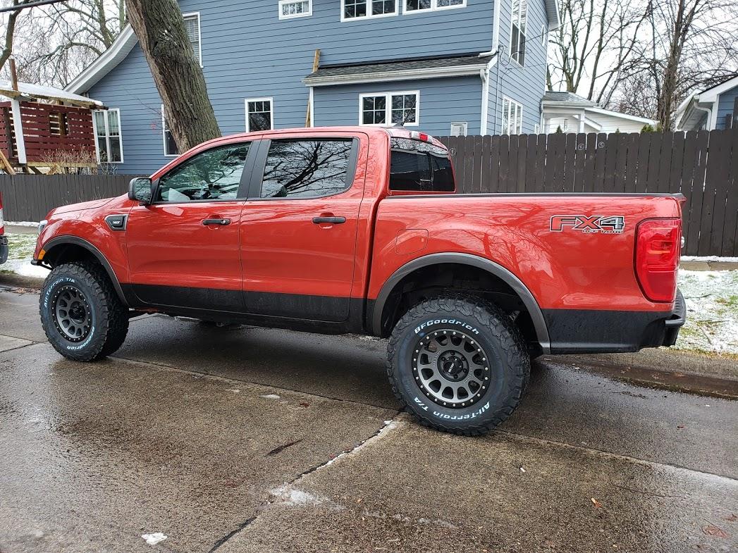

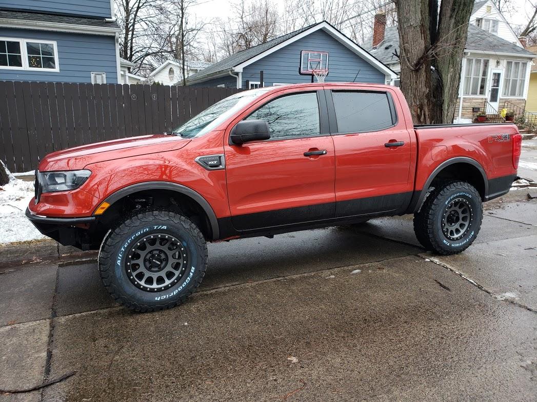

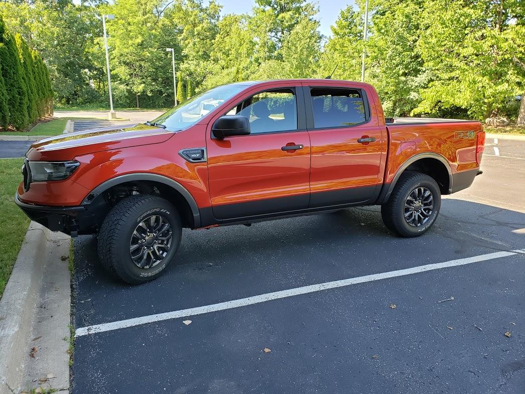

Lifted truck with the new wheels:
I think the wheel color looks amazing, it works well with the Magnetic trim.
