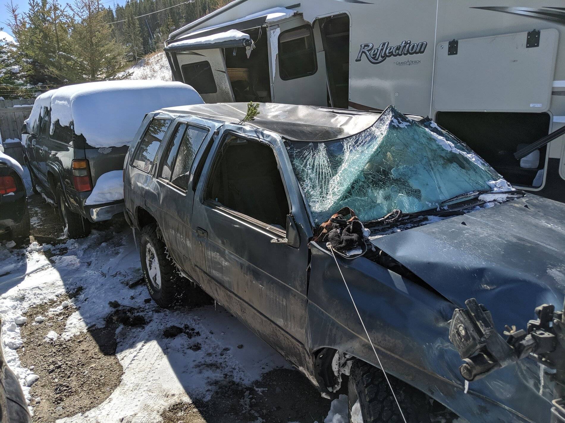

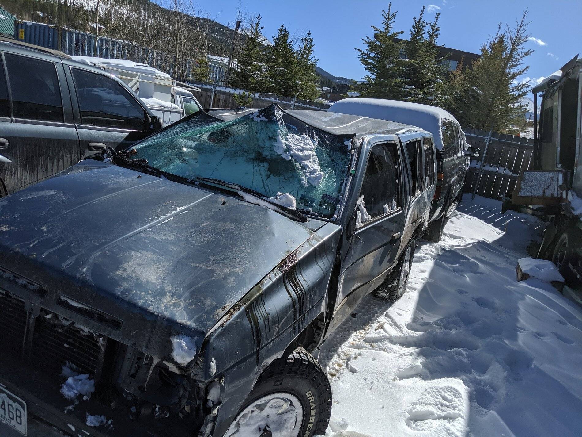

Sound a bit outrageous to you? Well it shouldn't and it is to help prevent accidents along with people getting stuck. See the below pictures of what was left of my 1992 Pathfinder thay did not have the right tires on.
