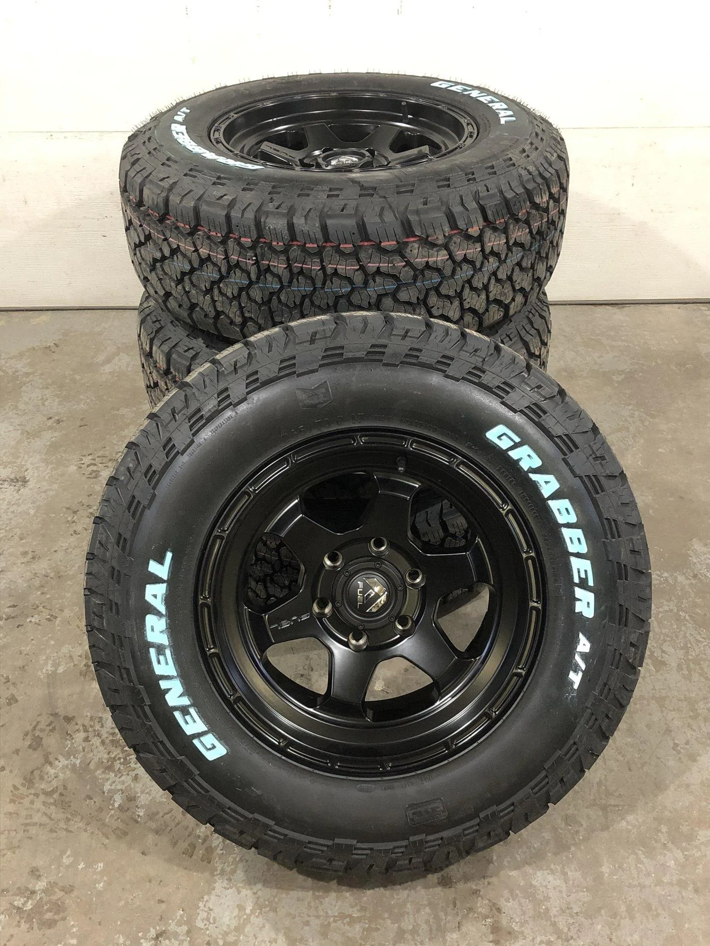

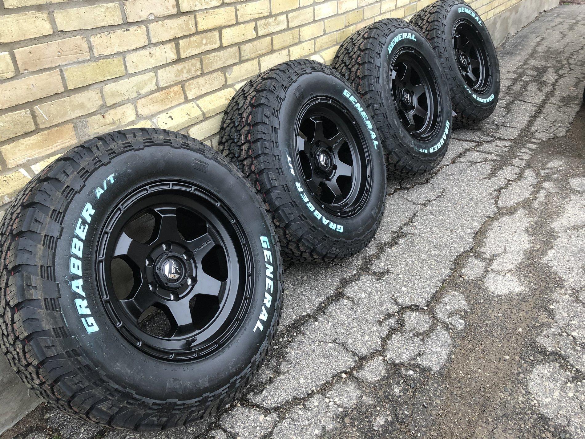

I ordered Fuel Shok 17x9” 20mm offset wheels in black that will be on probably in the next month or so, they’ll have 265/70R17 General Grabber ATX on them. I also ordered hub centric rings, black spline drive nuts and some TPMS sensors to go with them.

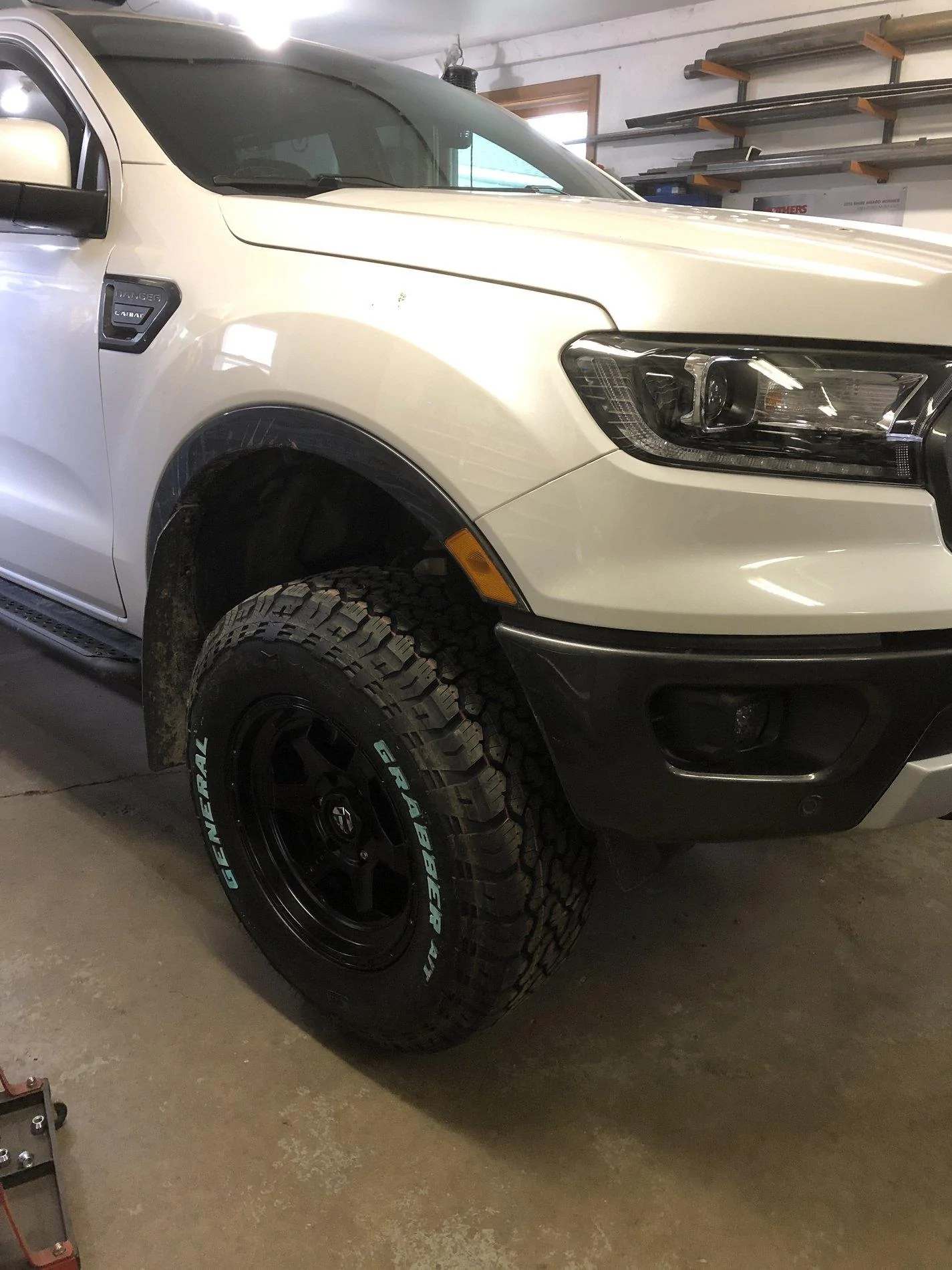

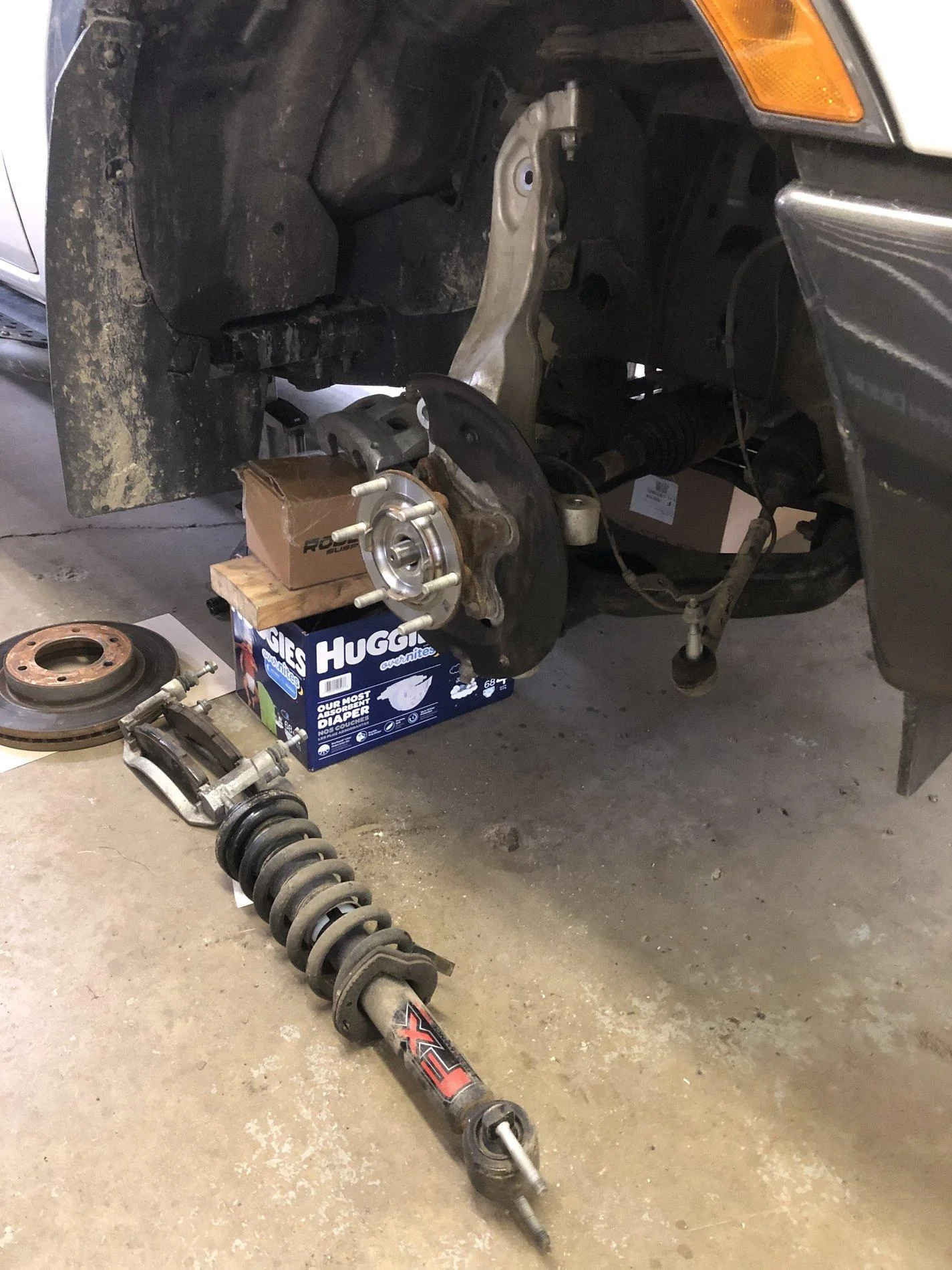

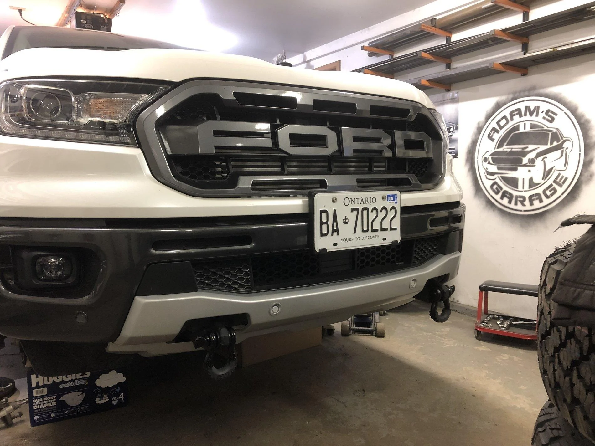

Finally some updates!
Putco bumper Insert and Rough Country shackle conversion installed. Wheels/tires test fit and I removed the FX4 struts to send out to have the springs swapped onto the Eibachs.

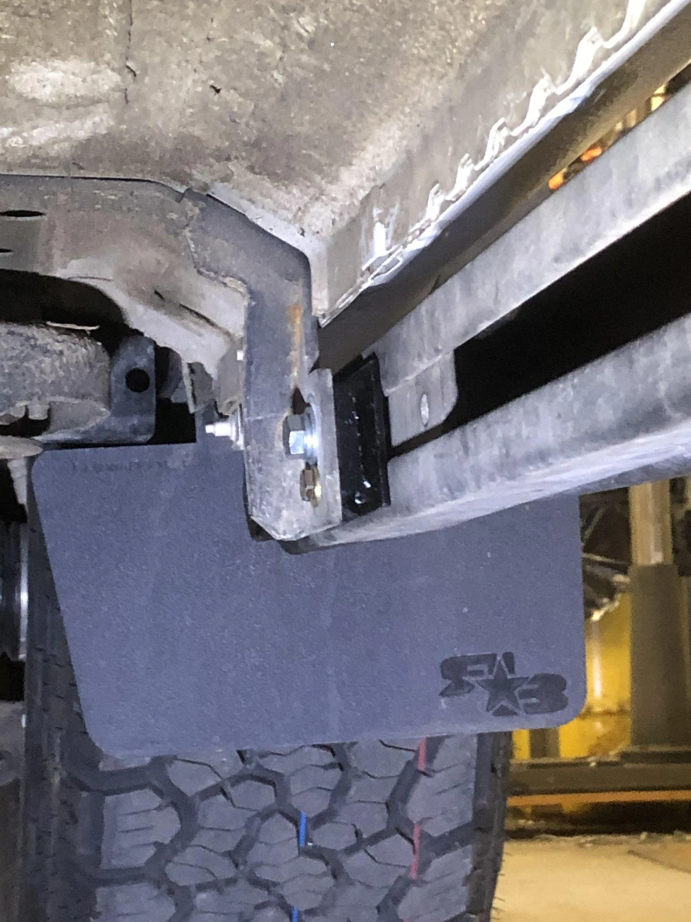

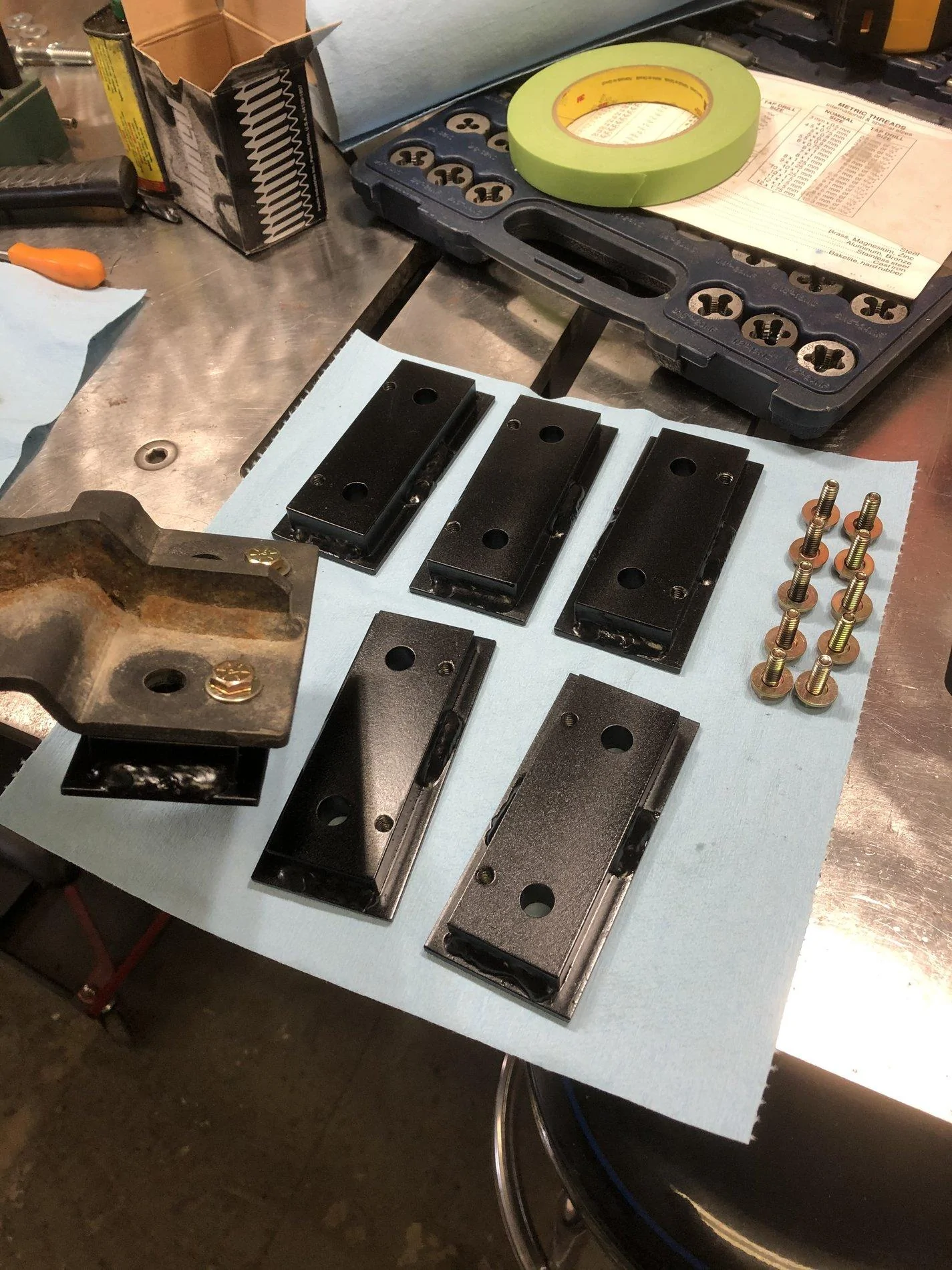

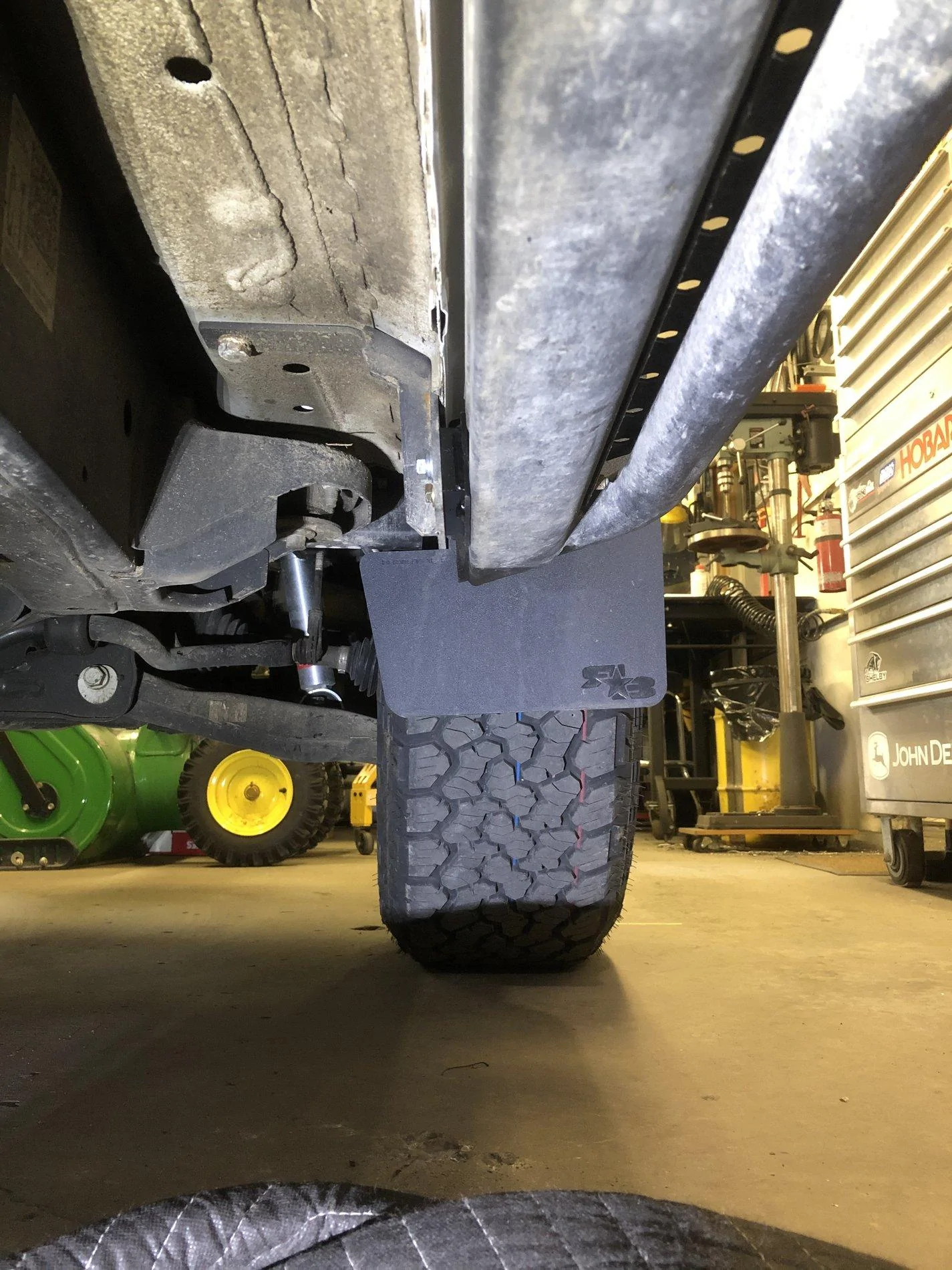

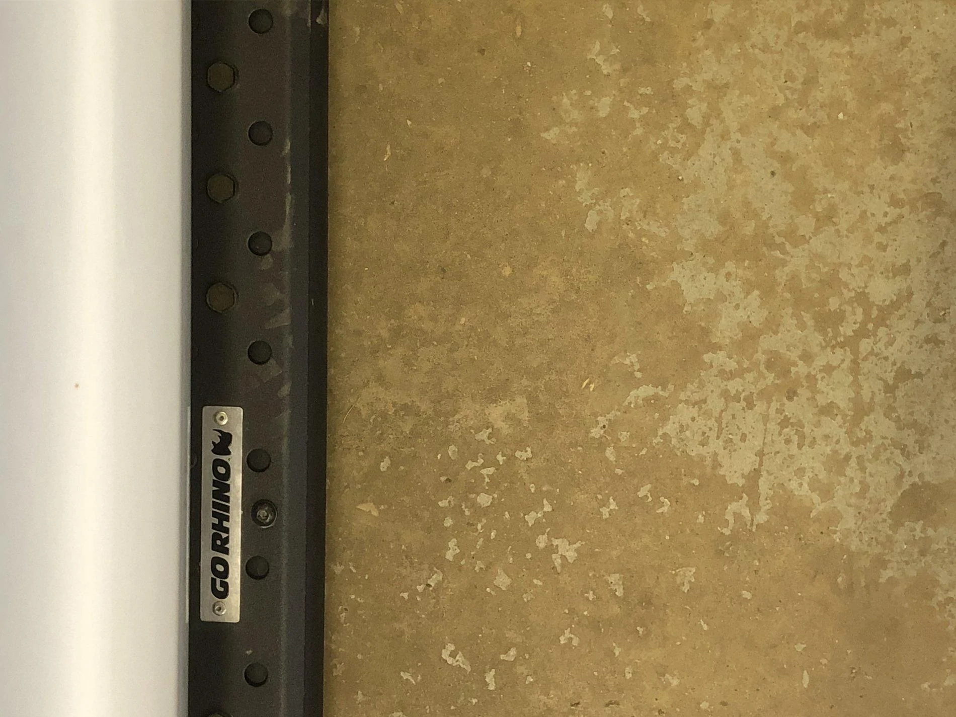

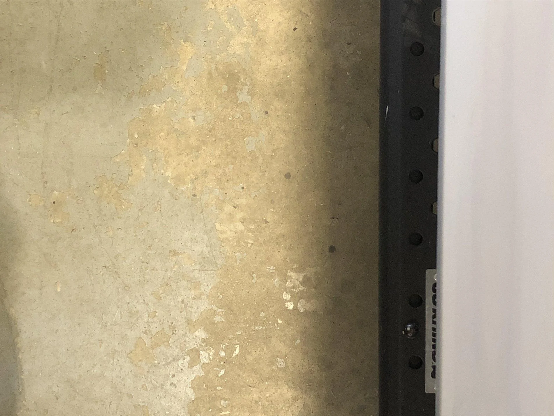

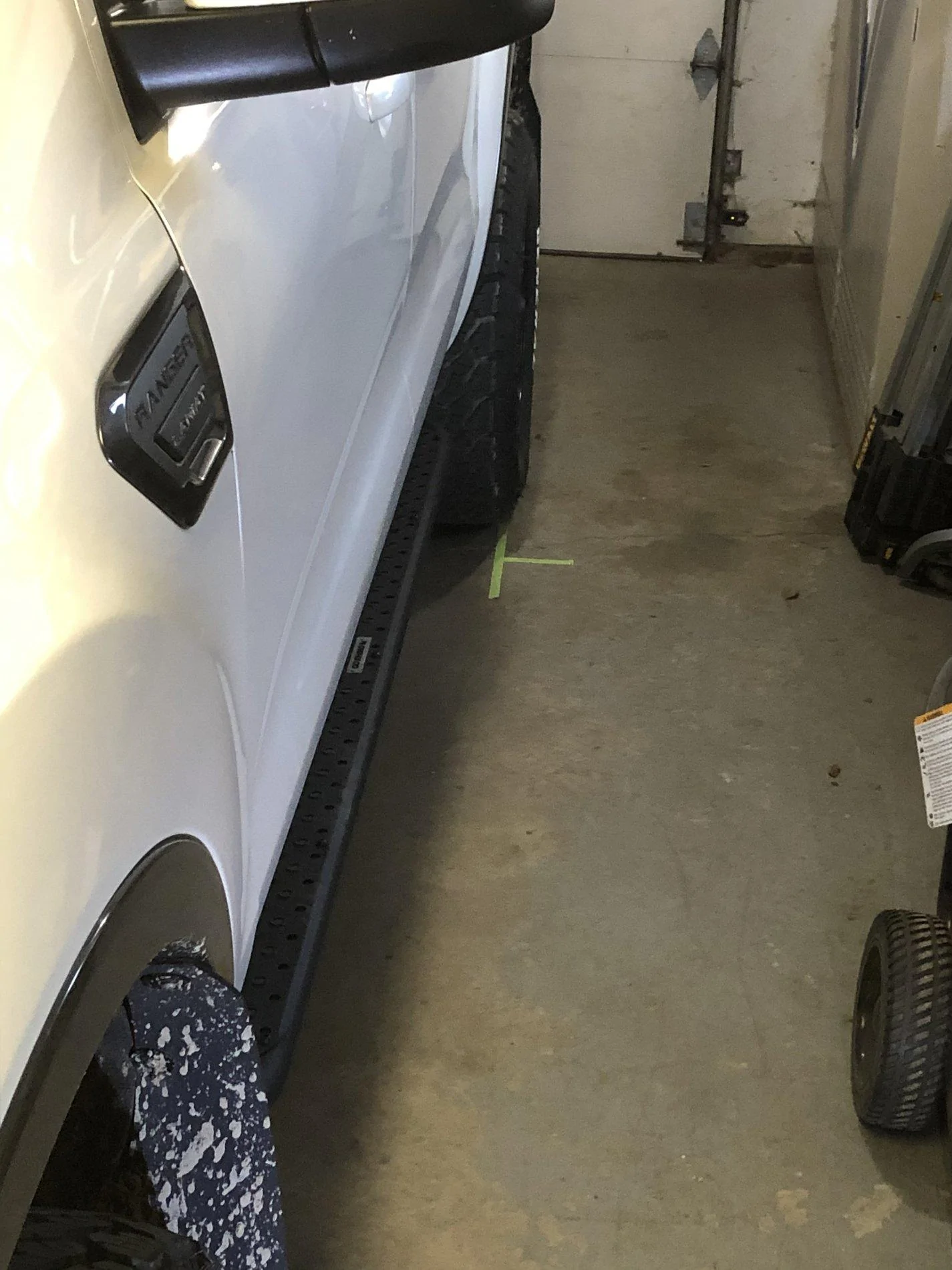

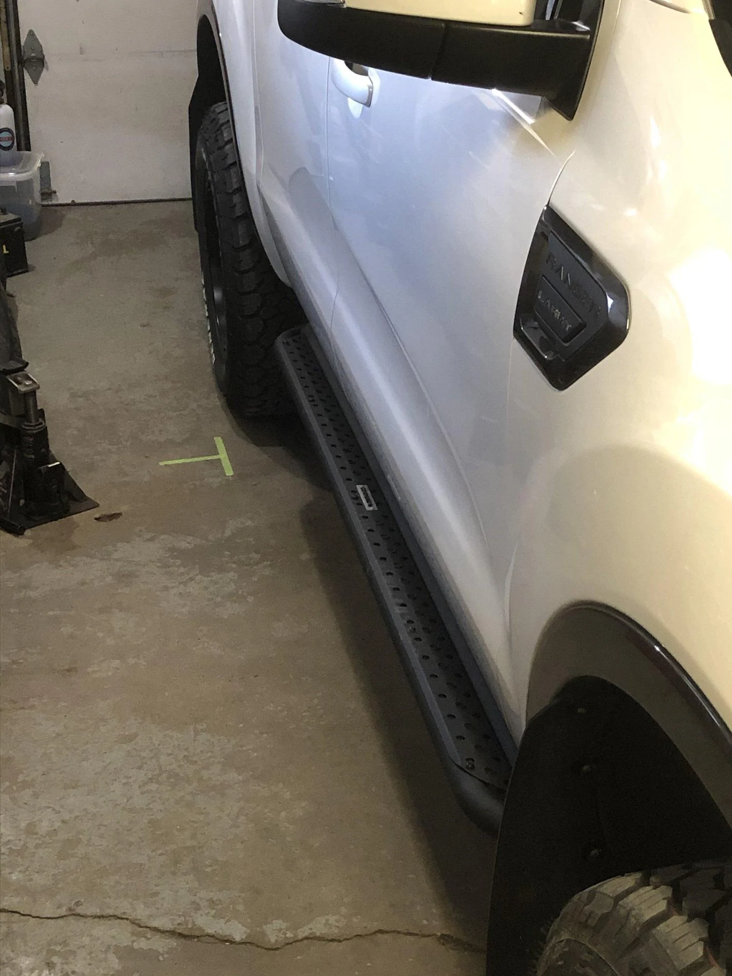

Fixed my Go Rhino DSS bars today. I always thought they mounted in just a little too far so I made some 5/8” spacers to bring them out. These are a couple before (driver’s side) and after (passenger side) photos.

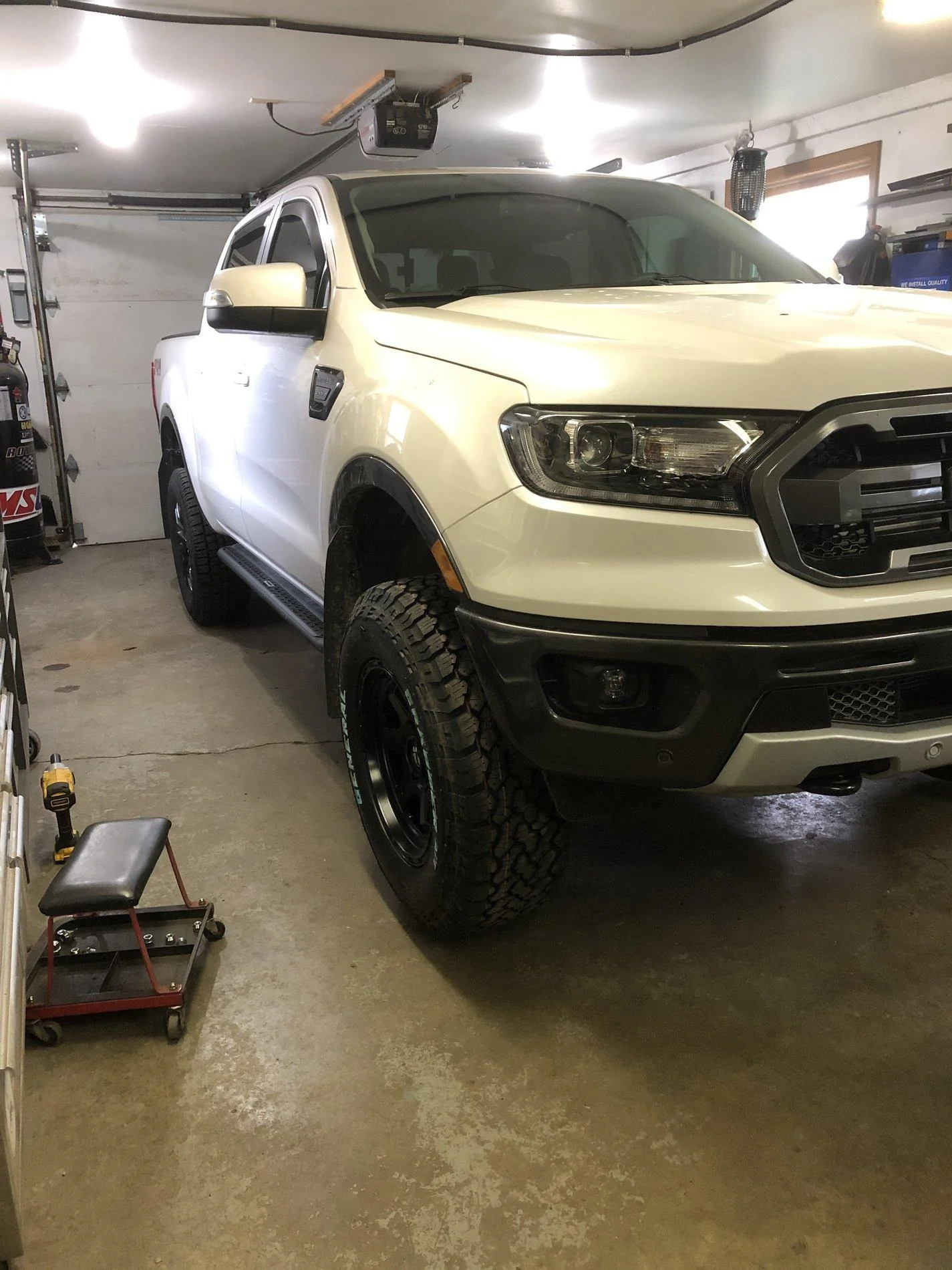

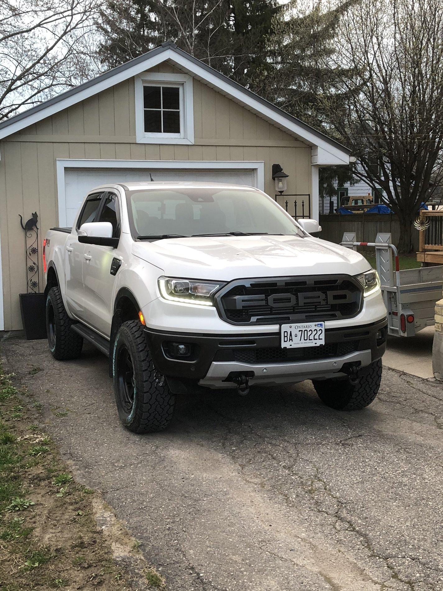

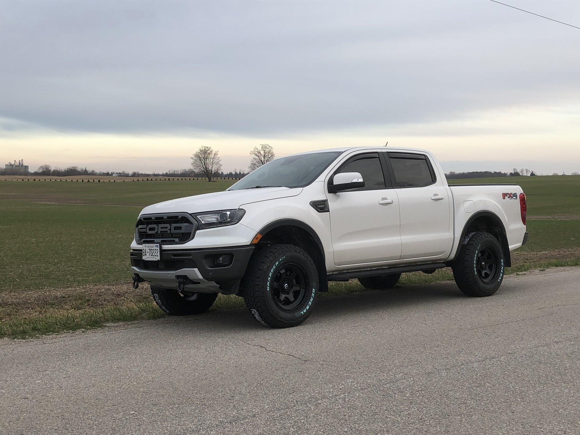

I also took a couple photos of the truck as it sits today. I think the only large item I want to replace is the exhaust system, I just haven’t made a decision on which one yet.
