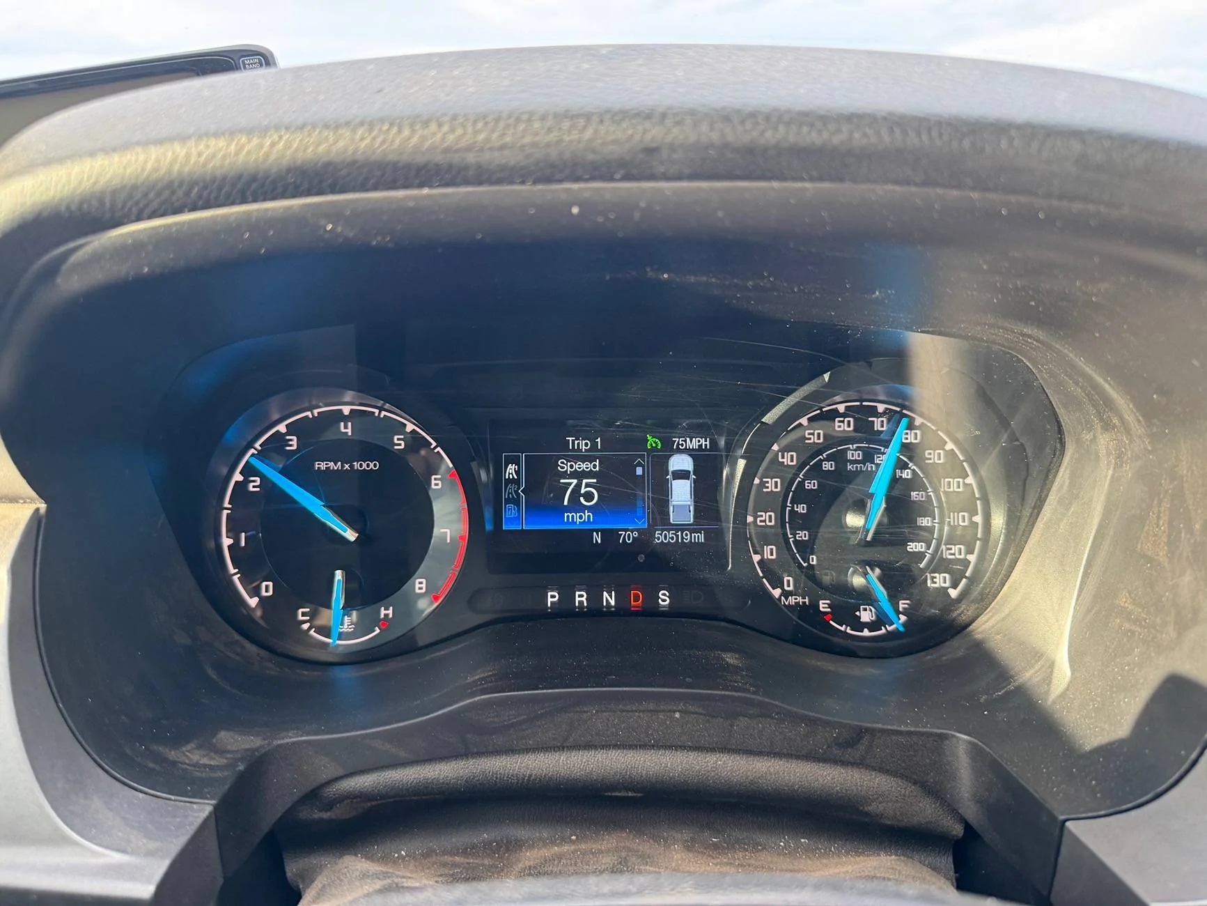

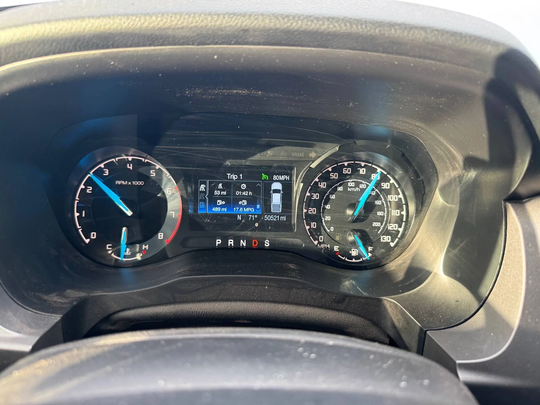

There have been some questions about RPM at a given speed. Here is 75 and 80. I don't do those speeds often, though the highway to my house is 75. Its comfortable to cruise at 75. The average mpg started before I got the gears. I topped off yesterday and will keep an eye on it. So far, I'm getting 20.x mpg since the fill up and I've driven about 90 minutes. I was getting 15-16.
