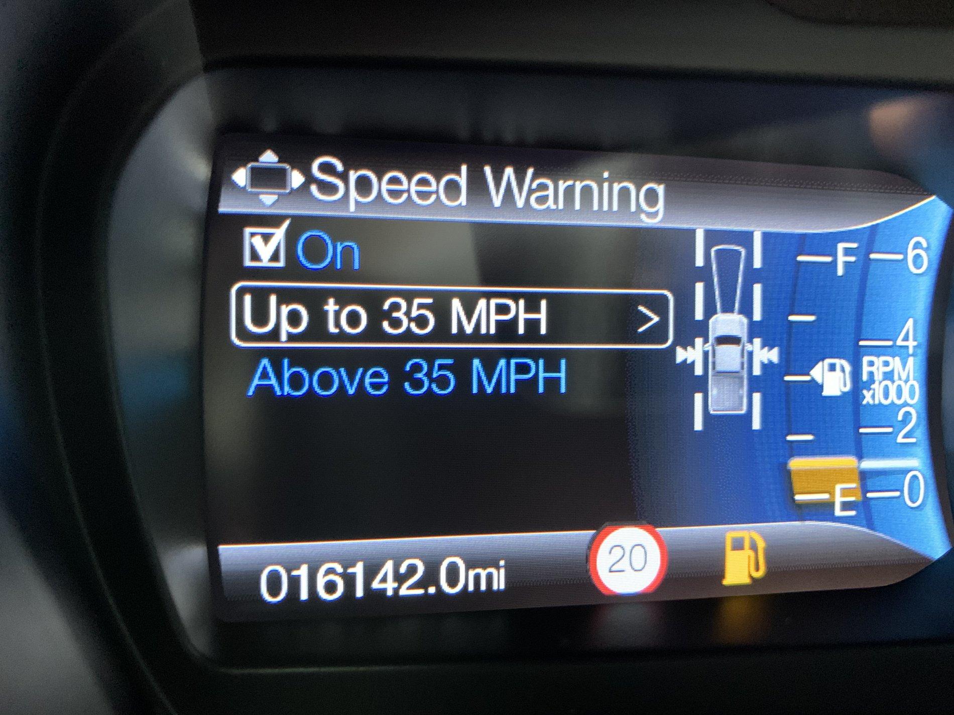

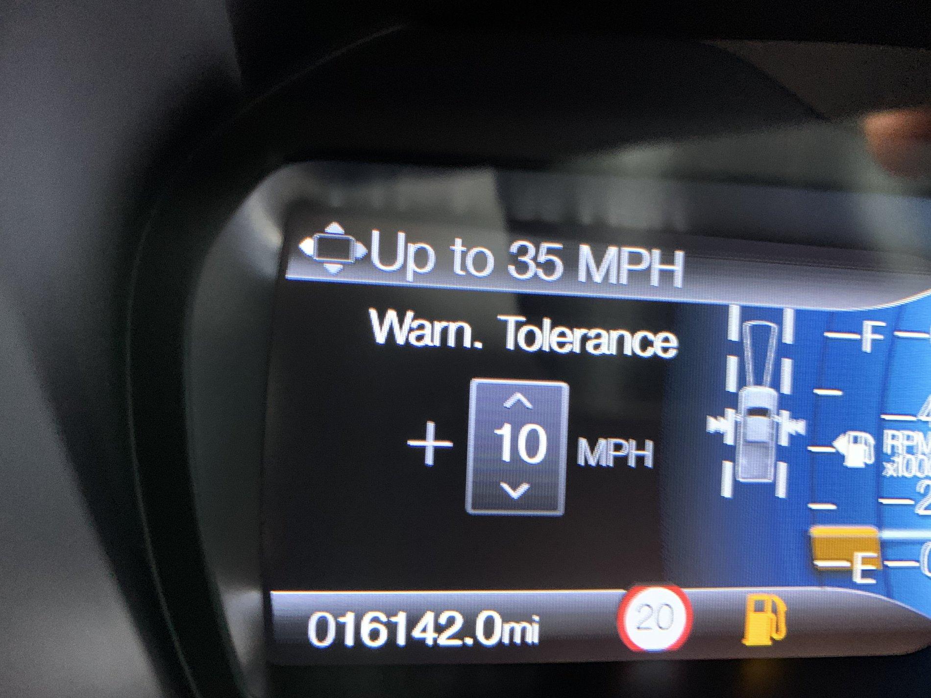

Here's the modules that need changed in order to get the full Speed Limit Sign reading to work:
IPC > Traffic Sign Recognition = Enabled
2020-06-24 18_02_06-FORScan v2.3.33 beta, Ford Ranger_Courier_Mazda B-Series EcoBoost Gasoline...png
2020-06-24 18_02_33-FORScan v2.3.33 beta, Ford Ranger_Courier_Mazda B-Series EcoBoost Gasolin...webp
IPMA > Traffic Sign Recognition = Speed Limit Information Function (SLIF) AND Traffic Sign Recognition Mode = Camera Only On (other modes cause errors).
2020-06-24 18_03_59-FORScan v2.3.33 beta, Ford Ranger_Courier_Mazda B-Series EcoBoost Gasolin...webp
This all add the options that need to be enabled in the dash menu:
Driver Assist > Traffic Signs > Always On (It will show up in the area highlighted when it detects a speed limit sign. It will time go blank when you slow down and stop/turn a corner of speed up a lot).

Excellent write up!!
A tip: the sign indication will revert to blank after making an indicated turn. I’m assuming this is done because the speed limit on the road you just turned on may have a new speed limit.
Also the speed limit warning function works as expected. You can set the number of mph above the posted speed limit for anything above 35 mph and below 35 mph.

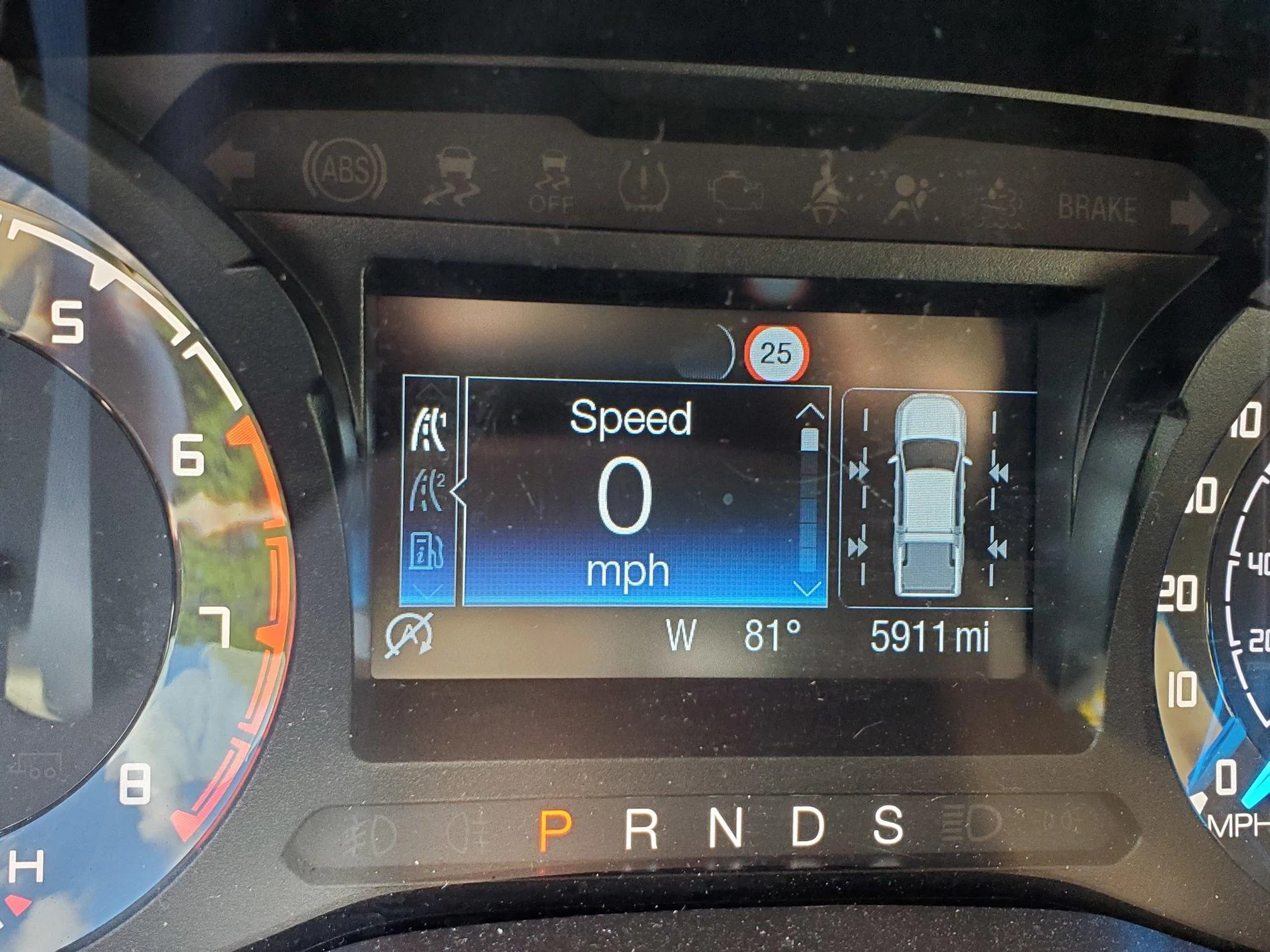

Success! I can confirm that the speed sign display and warning work on an XLT with Lane Keeping.
Now the question is what is the little circle to the left of the speed limit used to display? Oh by the way the speed limit flashes at you if you go over the threshold you set. Kind of cool, I may keep it.
Congrats! You have managed to display an International speed limit display with English units for other displays but is the 25 kph or MPH? I am not sure what you mean for the left of the speed limit in this picture.
Yes it looks like an international speed limit display but that is MPH. It matches the physical speed limit sign it is seeing and the warning flashing follows the speed shown on the dash correctly. I watched the sign change and warn me and compared to my speedometer.
If you look just to the left of the international speed limit display there is the shadow of another circle. You can just make out the right side of that circle. Wondering if can display some other road sign?

Yep..saw this but was unsure if this was the camera or the actual display. Very weird...
Phil Schilke
Ranger Vehicle Engineering
Ford Motor Co. Reited
The spot where the speed limit is looks like that when a speed limit is not displayed.

I’ve yet to see that other circle show anything, but the speed limit one is on the money with the actual speed limit.
