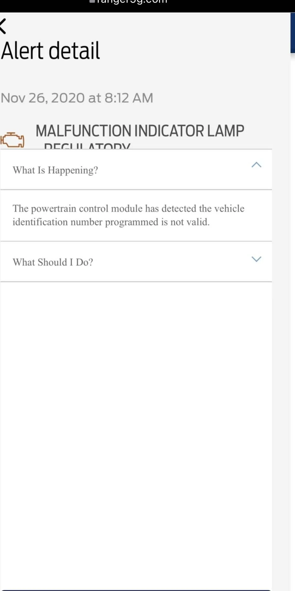

So I did a kam reset after I had a tune on the truck and this popped up.
I can’tfigure out how to get rid of this and I need the experienced to just random ideas on how to fix this . Because I’ve taken it to the dealer and they can’t even fix it (they dumb) .

So what is Forscan reporting that error to be? Got a code on it?
There are 2
0x7E8:p0630
0x7E8:U0422
ill have to look tomorrow what they actually say but it lines up with the pcm vin does not match bcm.

Issue resolved last week. They had to have a ford engineer remap the bum and update it .
