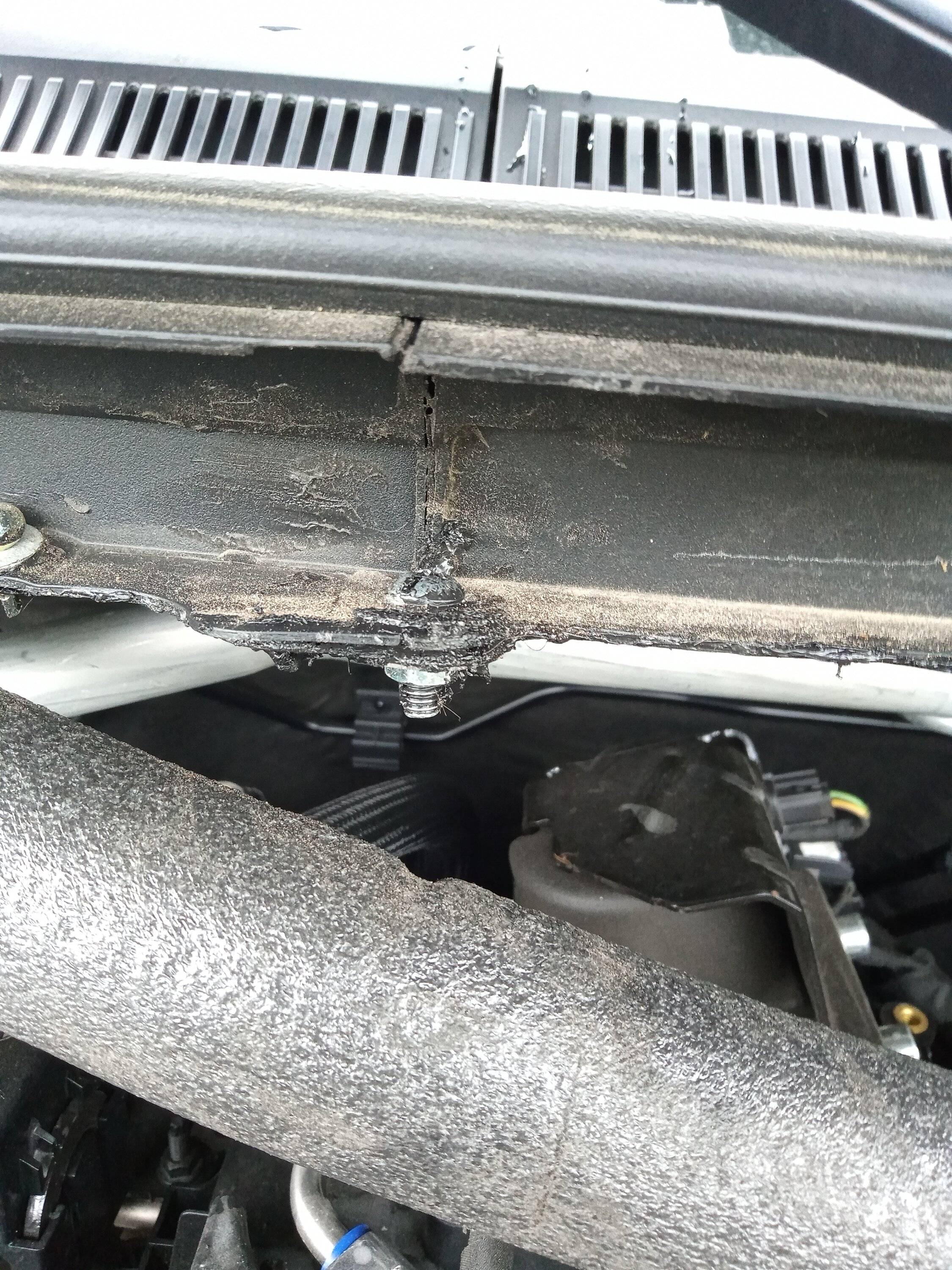

Be aware that @NotBudule and other users have found that the actual point of entry is probably at the cowl. It seems water drops there, lands on the top of the block, then settles in from there.
The cover might not really do anything. It was originally designed to mitigate sound, not water. Which is why it was only standard on the Lariats.

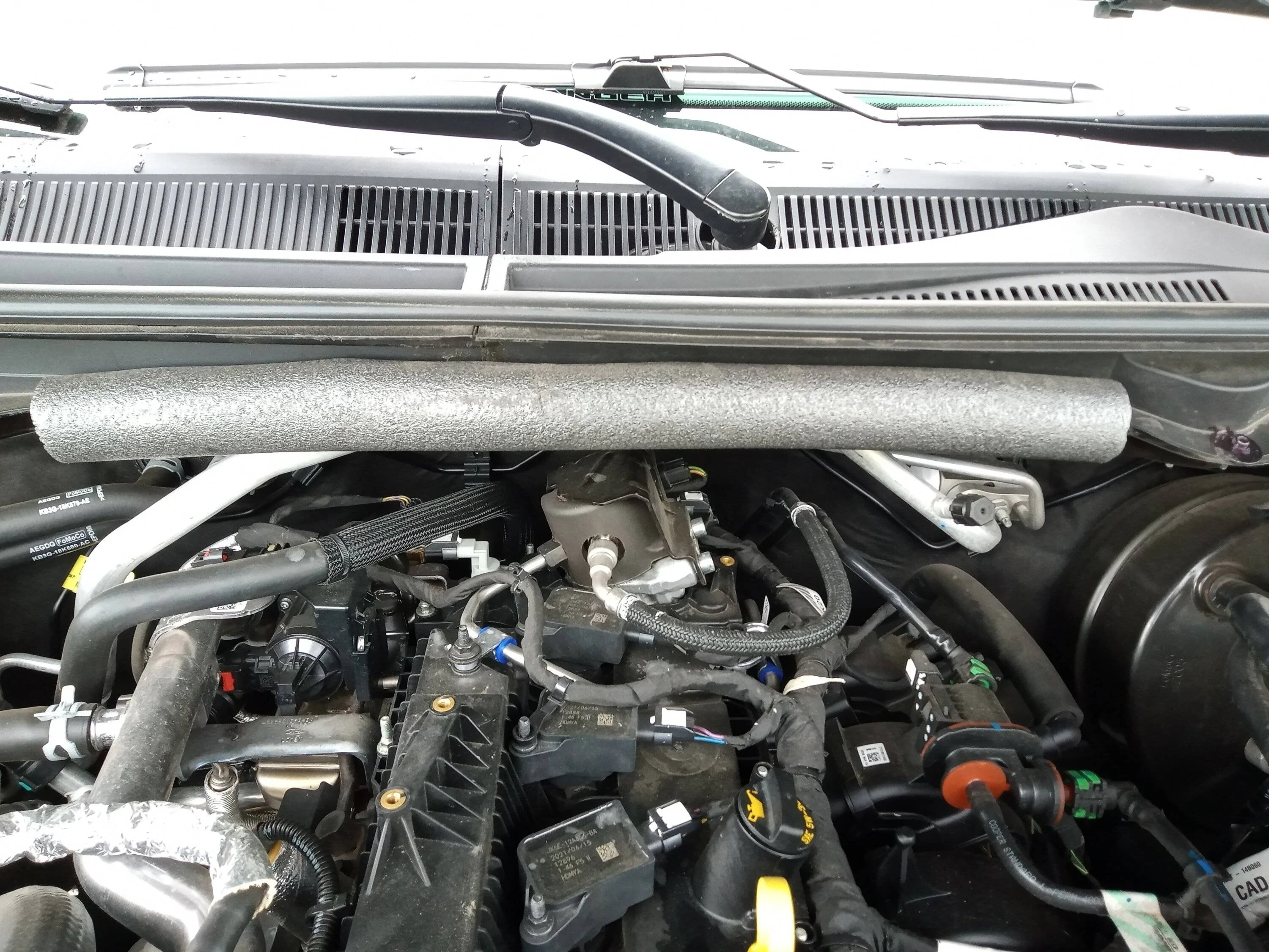

It's a LOT of water , as soon as I saw how damn much it was , I made it "Job 1" ... Bent the cowl back some , sealed and bolted it versus those push rivets then covered the lip with some split pipe insulation... That much water is not good for the top of the engine no matter where the cover (hopefully) deflects it to and is an absolute JOKE from Ford as a fix ...imo... These frozen plugs are gonna start popping up a LOT more now that these trucks are getting to tune up mileage for a lot of people...

Sealed the two halves of the cowl and bolted together , then just split foam to hide it ...the insulation by itself redirected the water away from plugs , but I decided to seal it up and keep it outta there...
