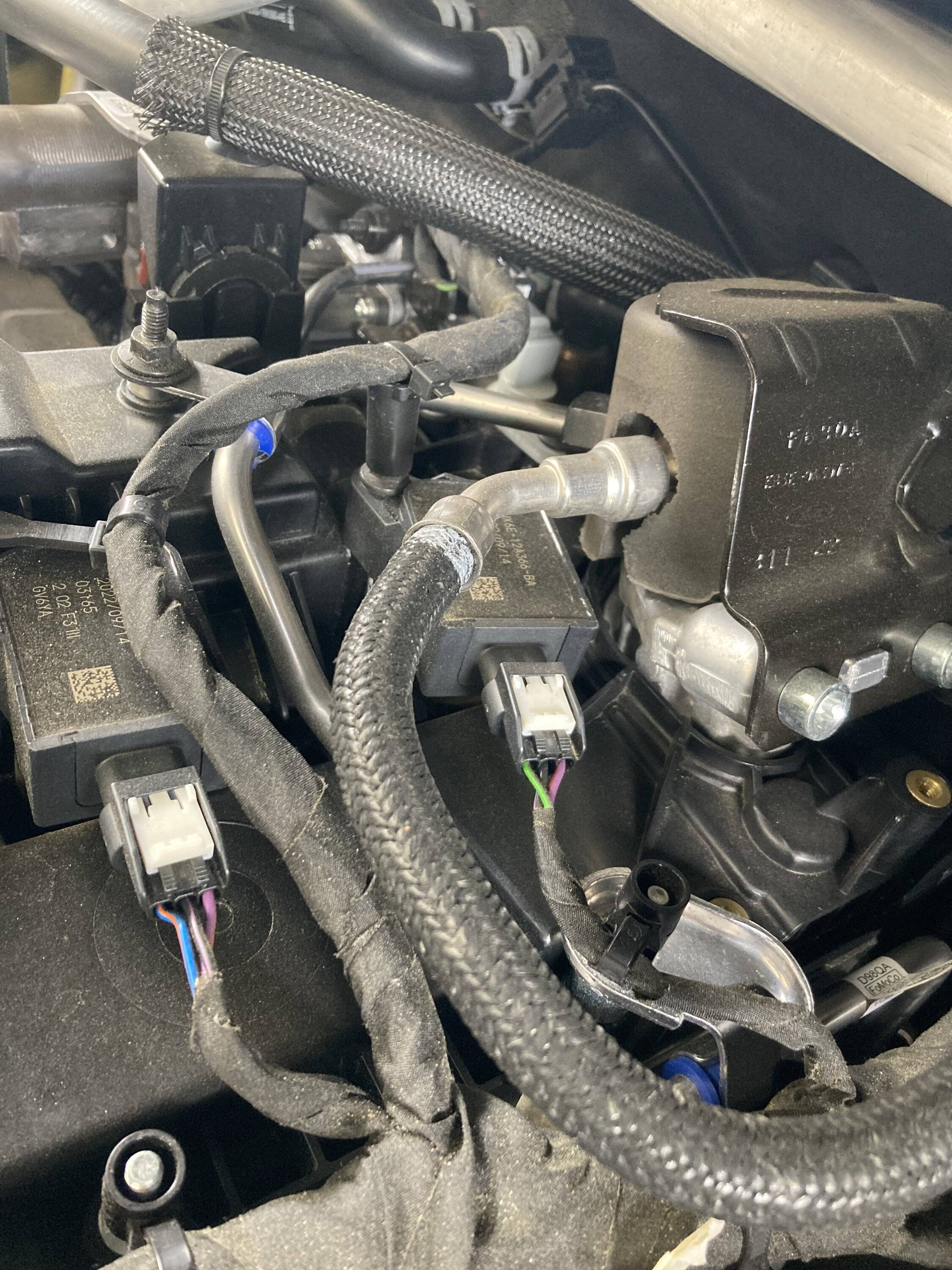

I just looked at mine and the spark plug coil at the back of the head appears to be blocked in by a fuel line (high pressure fuel pump?) There's also a fuel hard line laying next to it that looks like it would prevent rotating the coil to get it out from under the other fuel line.
Remove the nut and the connector and the spark coil will rotate to the left to clear the fuel line.
