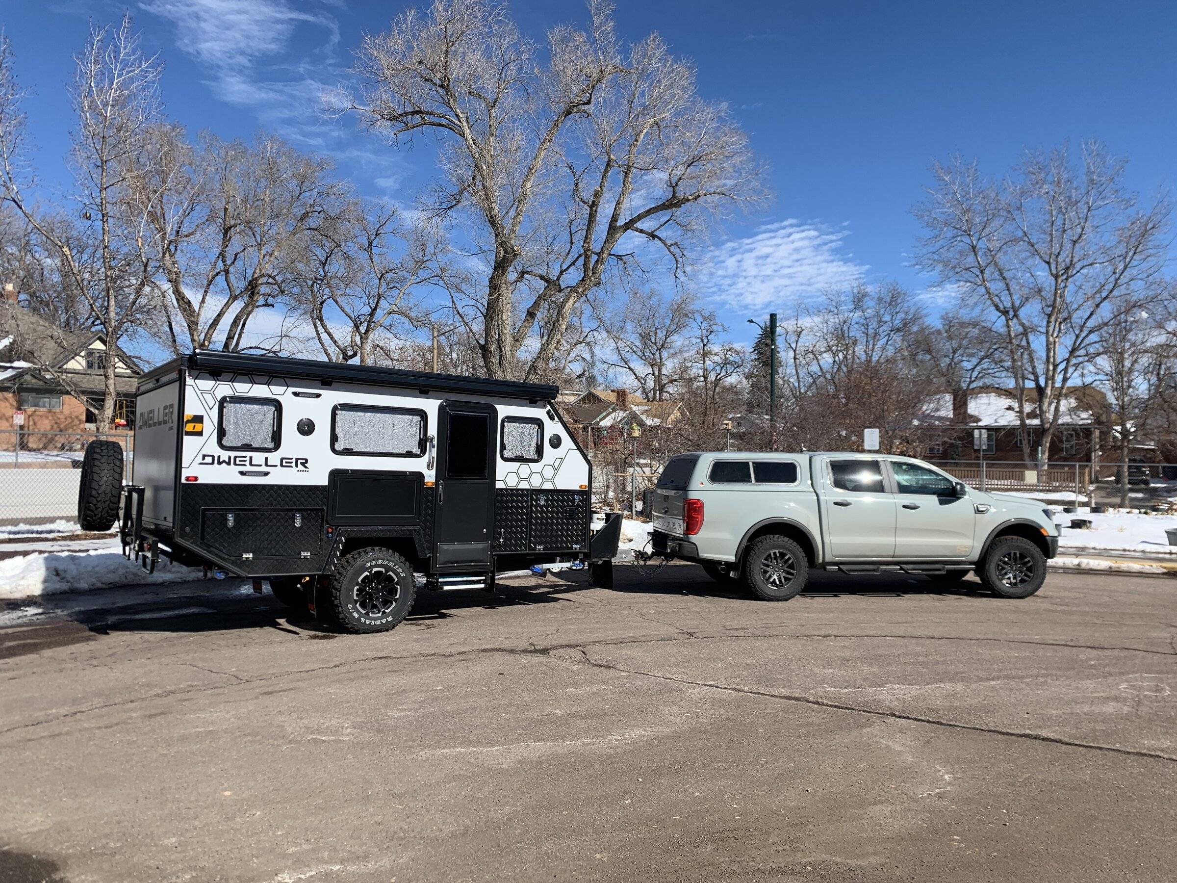

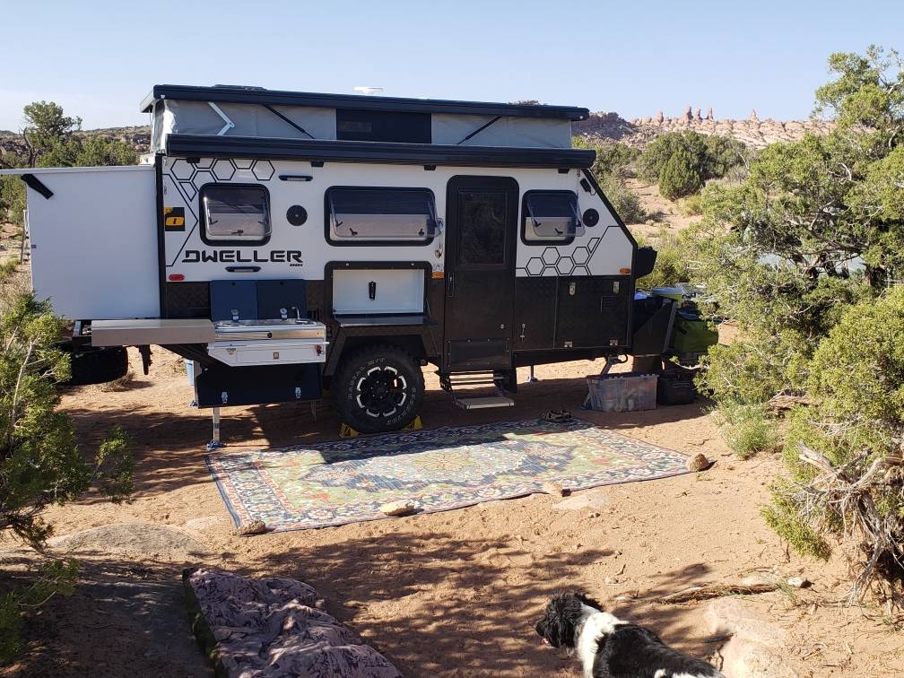

The main problem may be my expectations and impatience. It has been much better the last couple times out. But approaching 65 mph it starts to rock/bounce from side to side pretty good. Filling the front water tank and putting some weight in the tongue box seems to have helped some. I have been pulling a Coleman E1 Pop-up for the last 10 years and it was a breeze.
Not much to my Ranger, mostly stock with the Tremor and Factory Tow packages. I do have Firestone air-bags and a Draw-tite brake controller. Can’t find anyone in Denver who has any experience with the McHitch set-up and a WDH option.
Like you said, it’s all a compromise. What makes it tow great off-road doesn’t help much at highway speeds: independent suspension, articulating hitch, higher clearance.
The unit is great other than that. We had a deposit on an Opus OP15 for sometime and the delivery kept getting pushed back, plus it was just a little too big for us. Our local dealer started carrying the Dweller and we are happy we changed our minds. The layout is perfect for us. The fridge and furnace/water heater are a big upgrade, and the solar set-up is a game changer.
