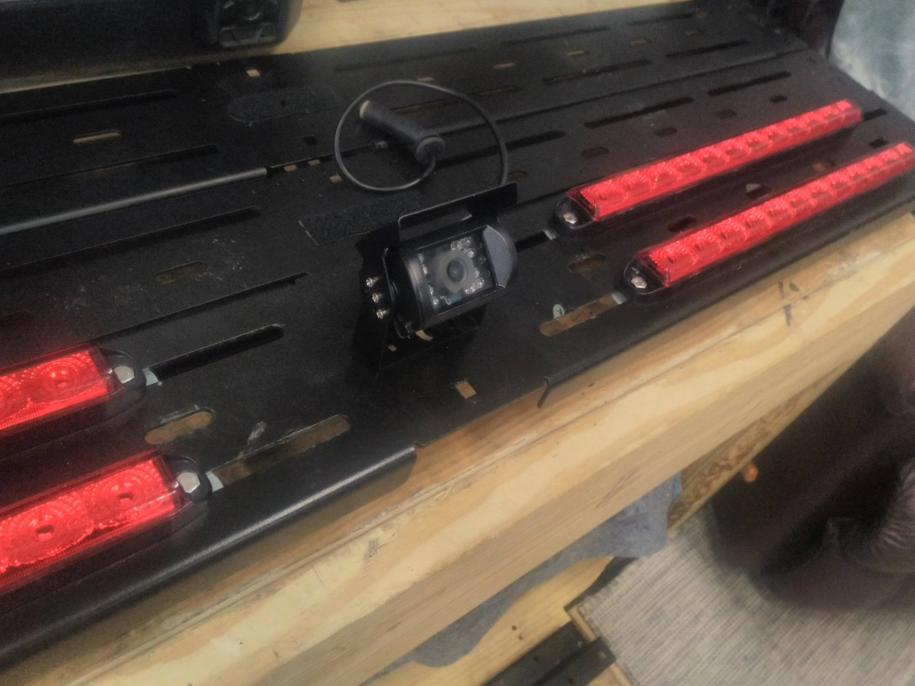

I gave up on integrating an after market camera because I was only willing to go as far as the rear harness to get it operating. I am sure I could get it working further if I was willing to go all the way to the head unit and convert something there.
But I'm not.
Down the road I will simply design a project box that better fits the factory camera more cleanly, or just go with a whole separate third party system.
In a nut shell, there is more at play than just wiring a third party camera to the factory rear harness. It doesn't work, the best I could get was a video with extremely bad quality.
Fair enough. I am still going to give a try and connecting in at the back of the Sync screen, otherwise I will at a second camera screen.

Some more progress but no love. You can absolutely tie into the connector under the tail gate and connect any camera (incl cheap rca cameras) by connecting the video source (rca center post) to the white/green and the rca outer ground to the blue/grey. This would work for mounting a backup camera up on a rack like @OFC Ranger wanted. You can power the camera separately with any 12v (or appropriate aux) power source.
My other hypothesis that the display of the camera on screen was controlled by power to the camera proved false. I hoped they may have engineered it this way to avoid failures, so that anytime the camera is power by the BCM the reverse camera should be displayed, even if the sync system isn’t fully booted up yet. Alas this is not the case.
I think that puts a nail on the coffin of trying to integrate multiple cameras to be displayed on the built in display. To do so would require overriding the sync system, which is likely how the rostra rig worked. This is beyond my capabilities and enthusiasm.
On the plus side, the RCA switching box I got off amazon worked well. It allows you to hook up up to 4 cameras and toggle between them, or display any 2, 3, or 4 cameras on split screen. I think I will try to use it with an external screen to make a custom multicam setup for off-road. I’m thinking front cam, downward side cams (under mirror or off roof rack), and a rear axle cam for clearance. Shared some pics of the split screen modes, though I only had 2 cameras connected.
