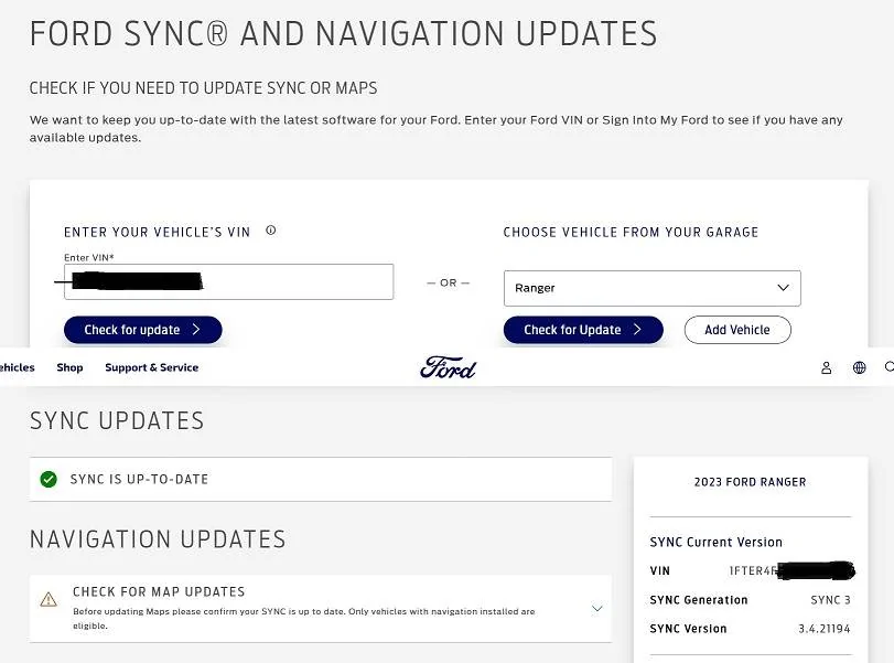

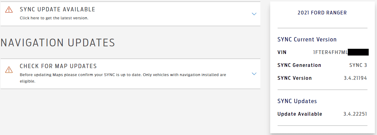

Most likely does, I'm just giving you Ford Motor Company's official stance. As I said, I've been fighting with them for months over a potentially defective Sync system. Mine shipped from the factory with out of date software, which no one at Ford can explain, yet Ford's servers insisted that my system was "up to date." Actually had to take pictures of my Sync software version screen, and get the dealership to contact them, to convince them their server was wrong.egardless, 3.4.23088 fixed an issue I had been having with my new phone randomly not being able to make calls. AND, when I go to the Sync Update site it states I am up to date and lists my version as 3.4.23088.
So now its apparently a "server side issue" even though I never saw version 3.4.22251 showing up as an available update before they yanked it. Hey, at least they finally sent me the most current out of date maps... Hopefully I'll know tomorrow if their "server side issue" is resolved, or my Ranger is still broken.
As far as Syn3 goes, it was put quite plainly to me that if I used it, it would void the warranty on my APIM and that any issues caused by "unathorized software" would most likely not be warrantied. After the 3.4.2251 debacle, I can wait, and they can either fix my system or replace my truck.
