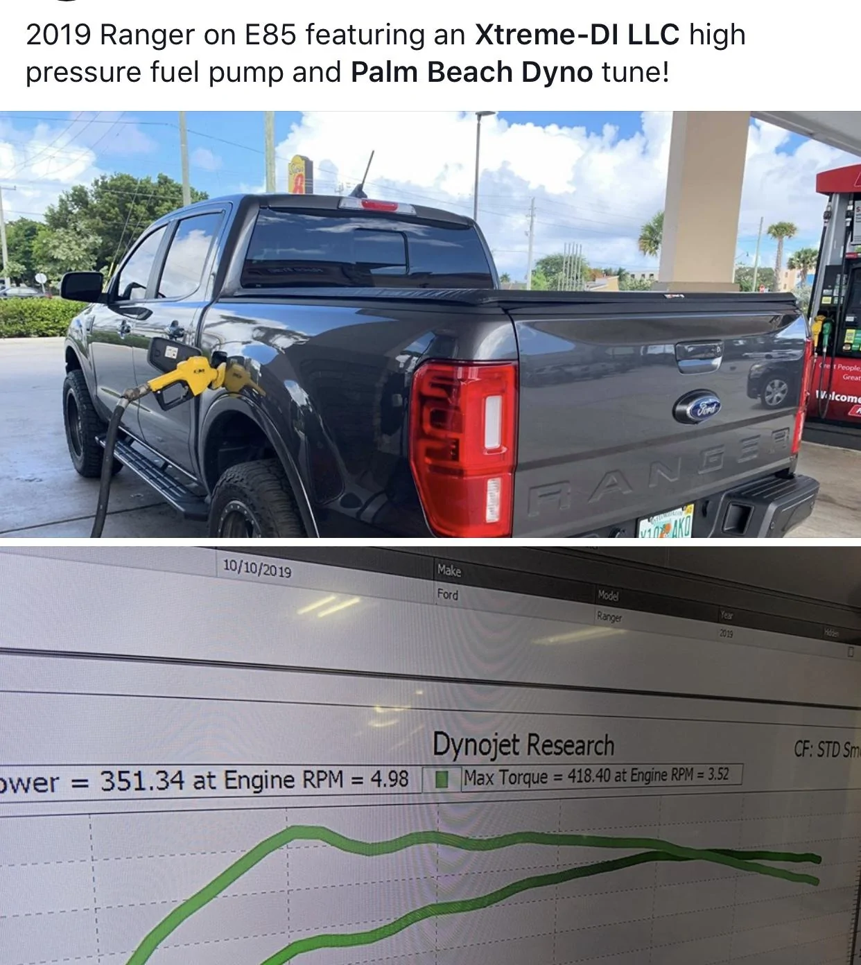

That truck is not operating on a factory tune. And while it has stock internals, the engine is FAR from stock. A quote from the owner...
E85 is on board. A couple of vendors have reached out to put their stuff on this truck so we will have real life results shortly. Track time on Friday night!!
If you think 350 whp on a Ranger with only a HPFP and e85 on a FACTORY TUNE is possible you should stop posting advice here and stick to embarrassing yourself with the frat boys on College Ave.

:giggle:
