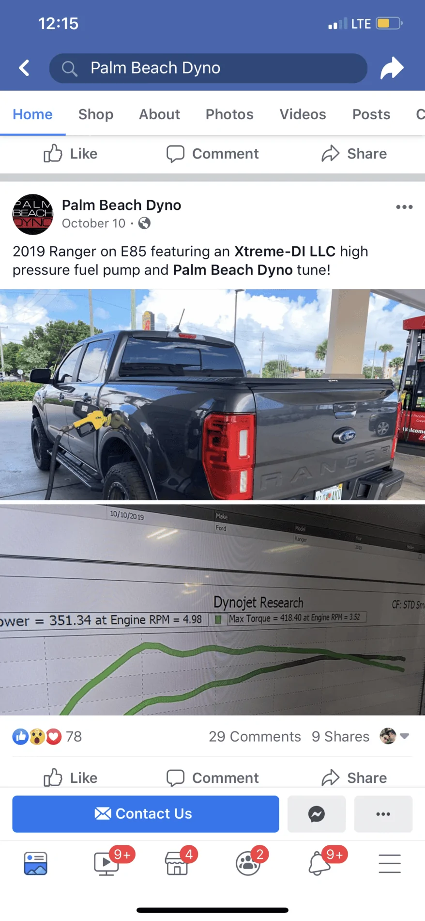

There are options out there. Depending on what your goal is may change who you go with. Mine is right above 350 to the tire and drive it daily and everywhere. Street manners are similar to stock and it runs mid 13's with ease.

350 to the tire! Dang! Have you dyno’d it or are you guessing?

pfft...he's exaggerating
(Note to mods: in no way is that meant to be flaming or trolling)
100% factual. Truck is on E85 and went a 13.46 with some changes needed to be done to tune for shift points. Will be in the 12's by Christmas.
