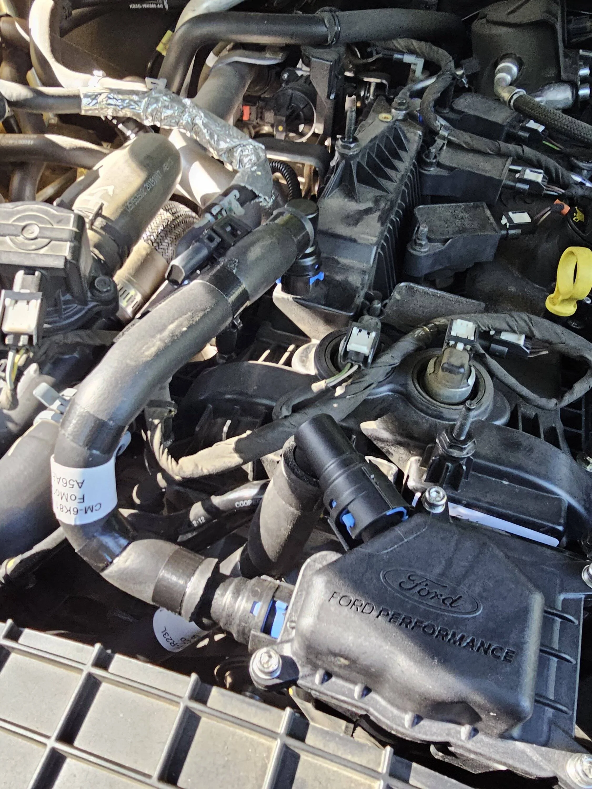

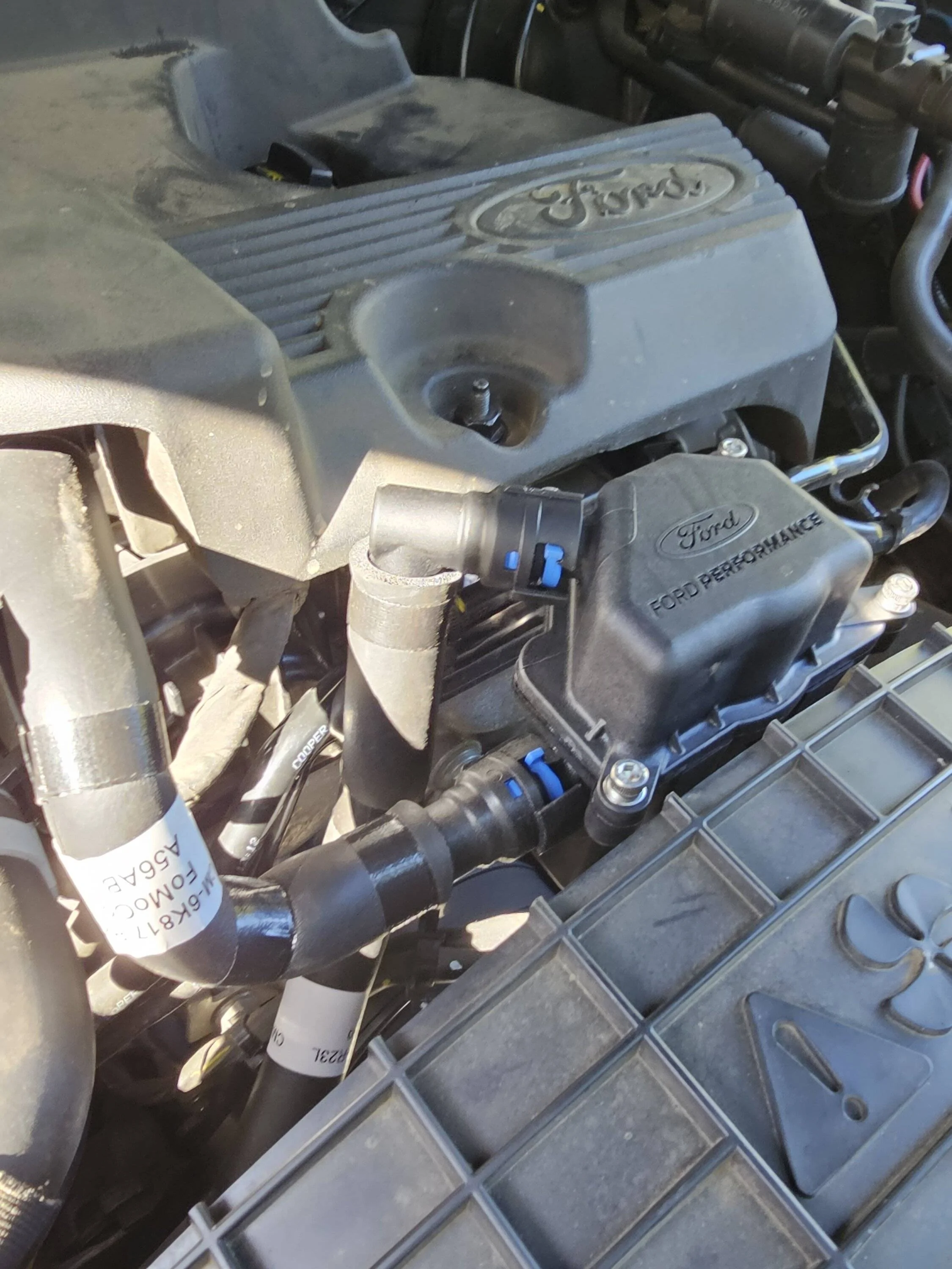

?EDIT? I found a solution (a ridiculous one at that) I bought the tube with sensor for $35 From my dealer PN- KB3Z-6758-A. Then I just popped it into the new tube and away we go. The "A" is the sensor style tube. See the additional photos below.

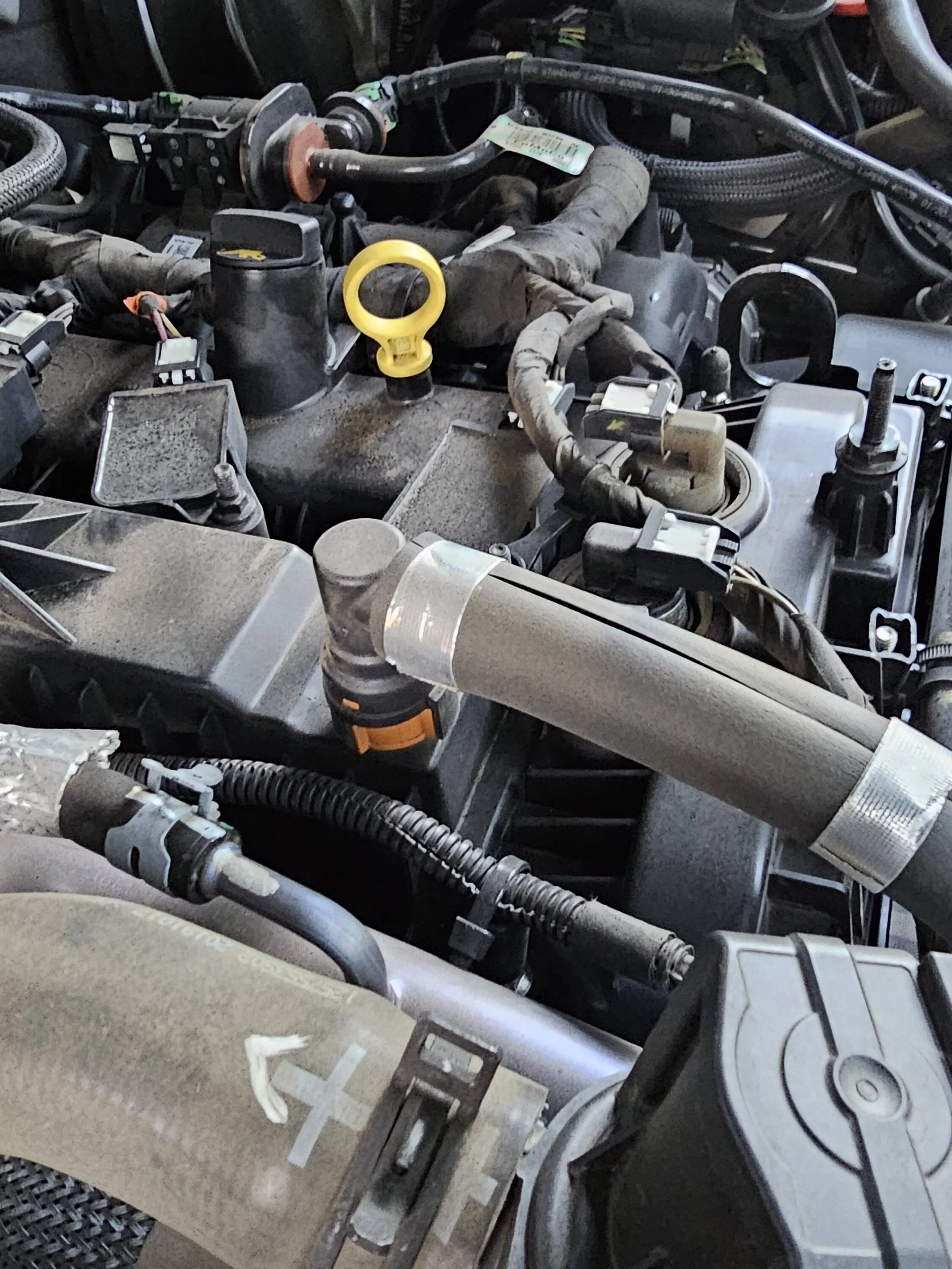

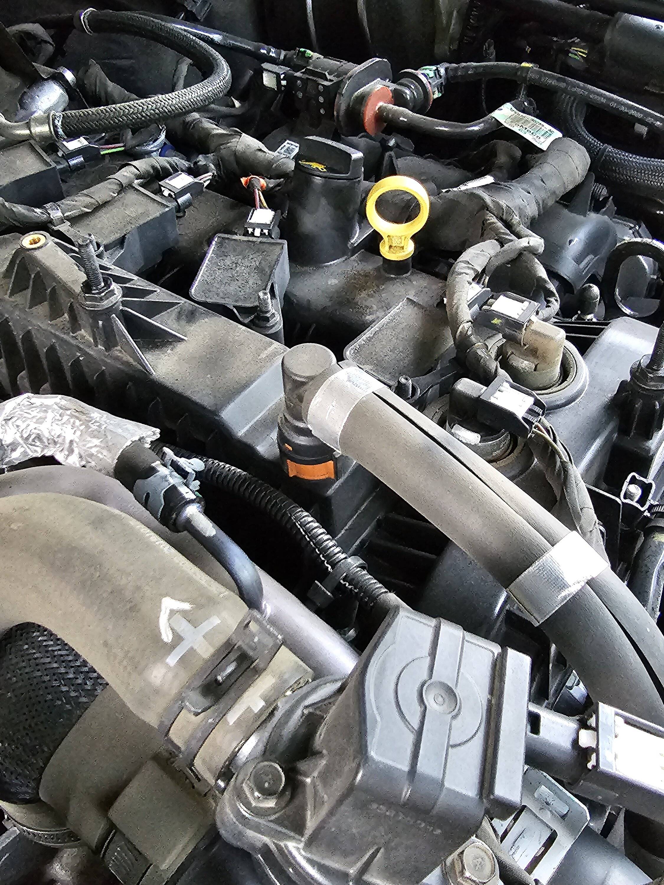

At the risk of looking like an absolute idiot, I'm going to ask for a little help here. I bought the Ford Performance oil separator and downloaded the instruction from Ford; and that's where it all went South. Looking at the photo of my 2020 2.3L and the photos from the instructions...where in the hell is my crank case pressure sensor?? It certainly isn't where they say it should be, which is problematic when trying to install the new tube. Am I just blind or stupid? What am I missing?
Now that's a solution I could live with! Ya it costs a little more but if your impatient like me it works .

I looked on my 2019 and I have the sensor.
I want on Ford Performance website and saw that if you don't have the sensor
the kit part number is M-6766-B23 and not M-6766-R23.
With sensor : https://performanceparts.ford.com/part/M-6766-R23
Without sensor : https://performanceparts.ford.com/part/M-6766-B23
Just ordered the B23 version, as it states it will work on 22-23 Rangers and my late 21 ranger has no sensor so it should work. Thx for the find on the B23 version!!
rbern
Rich
Nov 27, 2021
37
55350
2021 ranger stx 4x4
Factory
In 9 or 10 of 2021 they change the routing of some of the PCV valves that might have something to do to it I put a GLT on and mine was the later version which had different pipe routing maybe they got their numbers missed or something I don't know but they did change it mid production year of 21 my kit did not require no sensor hook up so
