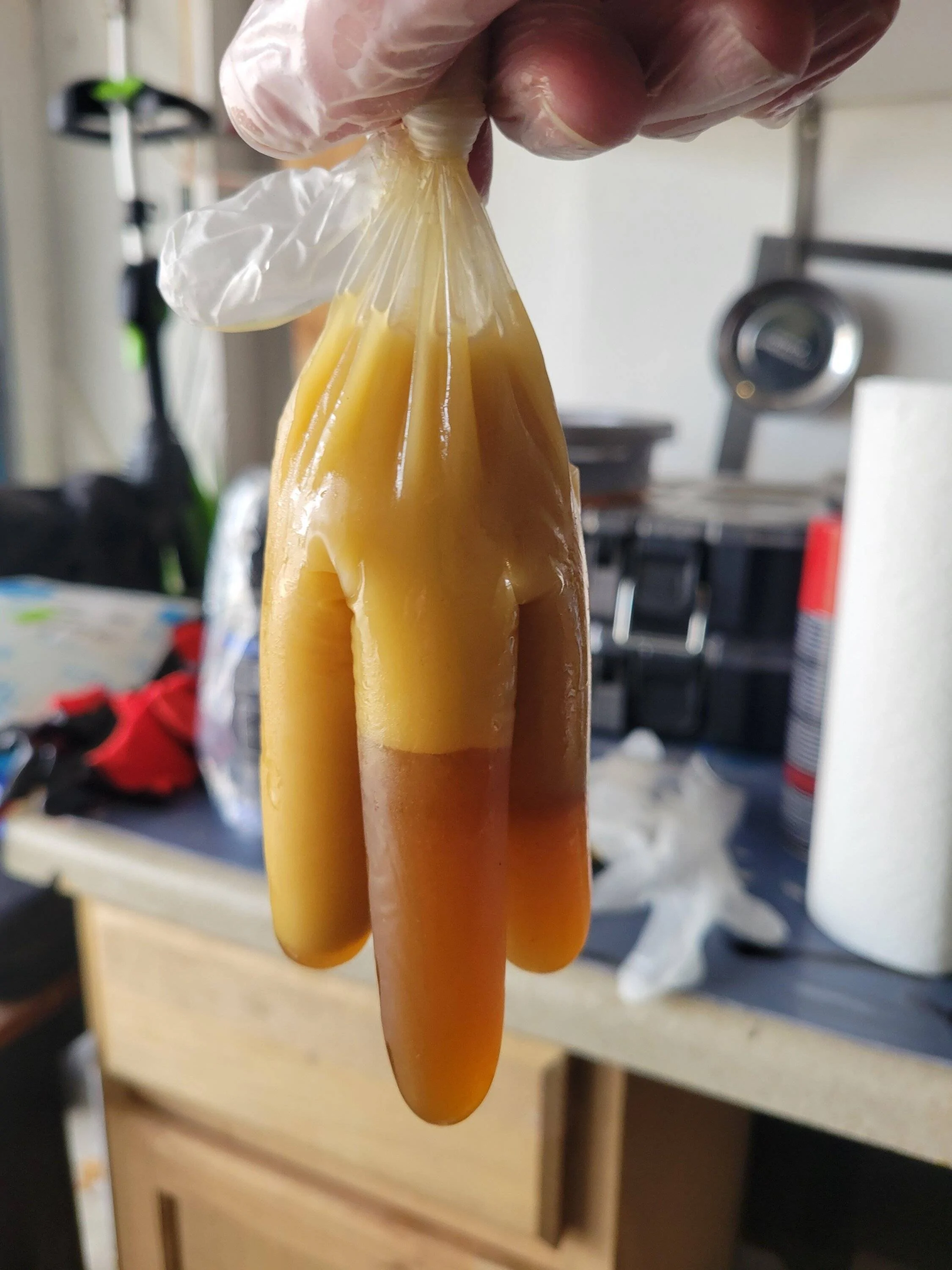

GoGoPowerRanger
Dec 7, 2023
'21 Ranger Tremor
Congrats on the successful installation.
Catch can Installations simply suck on the Ranger. I still feel your pain, and I installed the UPR Dual port catch can several years ago! I tell you, even if it didn't work, I ain't takin' it off!
Seriously, it can't hurt and it is good insurance on a DI engine.
Love that can! Hate the freakin' install! So worth it when you empty it, though.
That's a winter empty. You can see the difference for sure.
