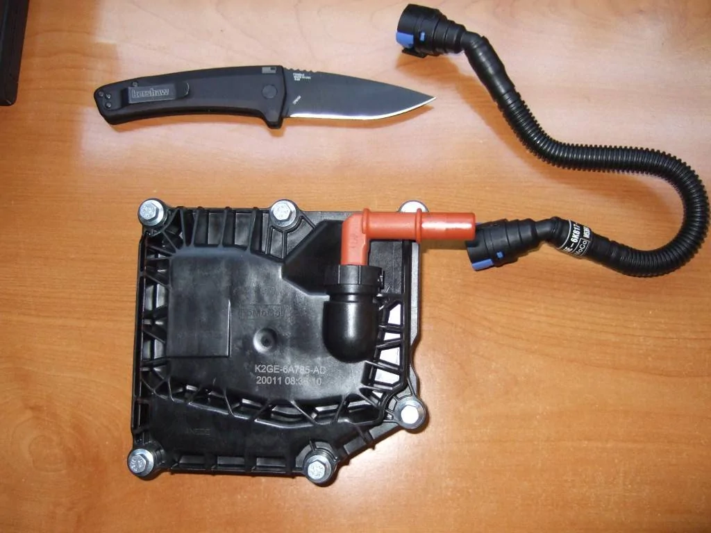

I can see how one could damage the PCV port while installing the catch can. I worried about just that when I installed my UPR can. Enough so that I purchased the PCV Oil Separator/ PCV Port from Ford. After receiving it and looking over the replacement steps, I was somewhat alarmed at the effort it would take to replace the PVC port. I do not think it possible to do without removing the intake manifold as it is tucked up under the intake.. And there are a lot of things attached to that Intake manifold!
I could do it, but I don't want to have to do it. The knife opened is 8" long.
With regards to service-ability, very poor engineering design.
That red port is what was damaged at the base where it meets the black neck. Had to have it replaced by ford...

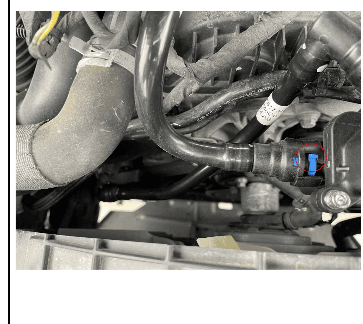

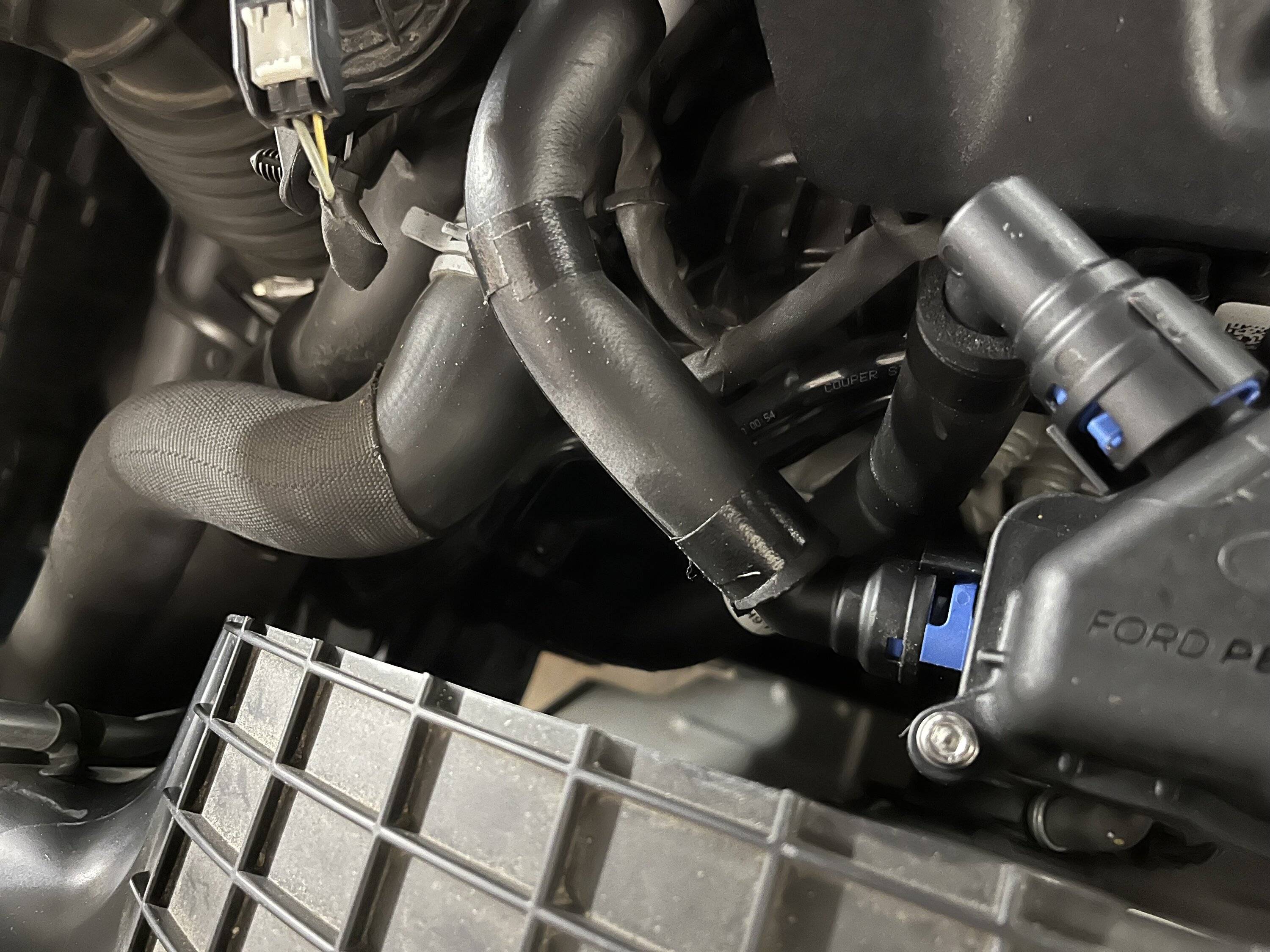

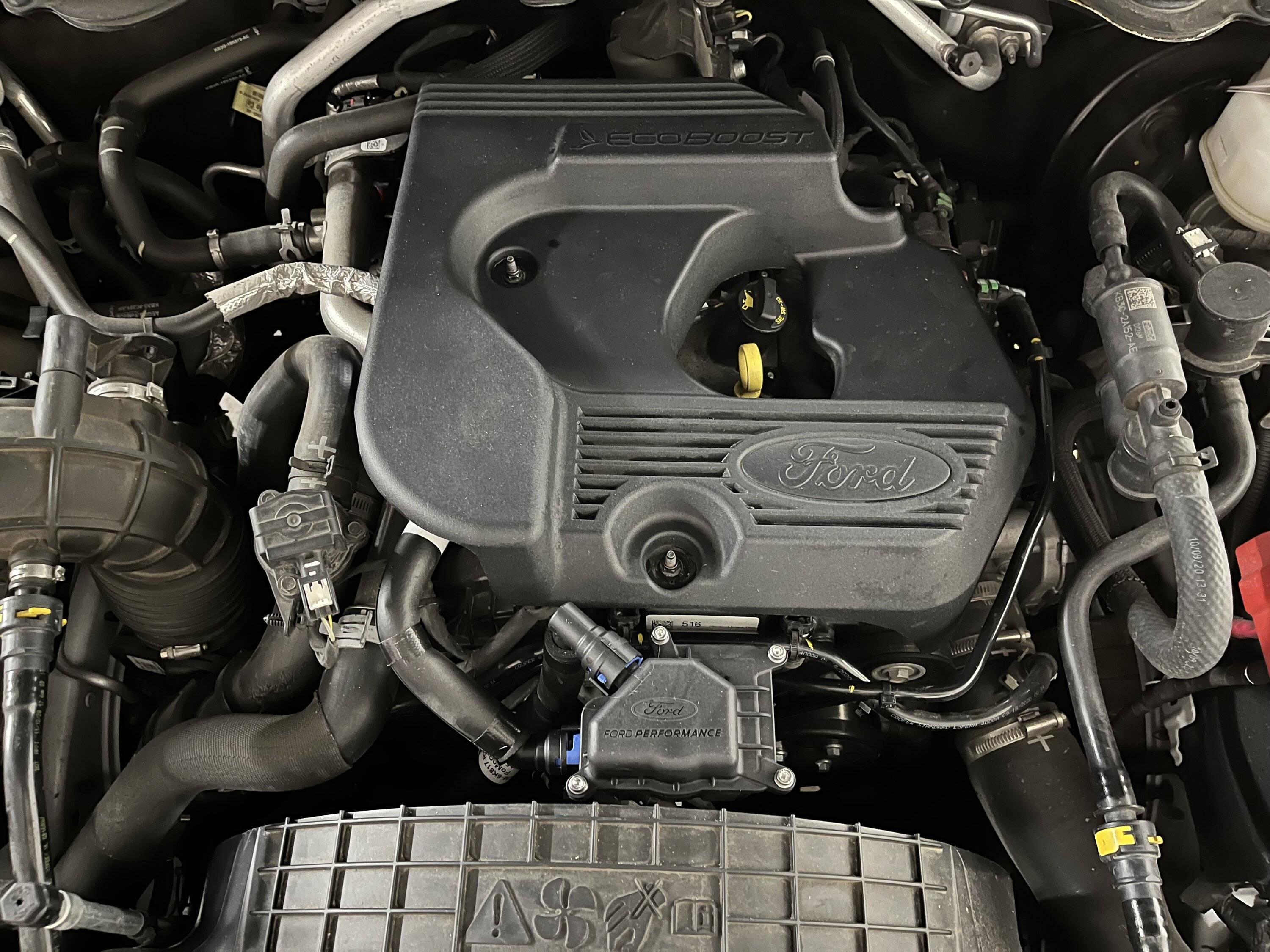

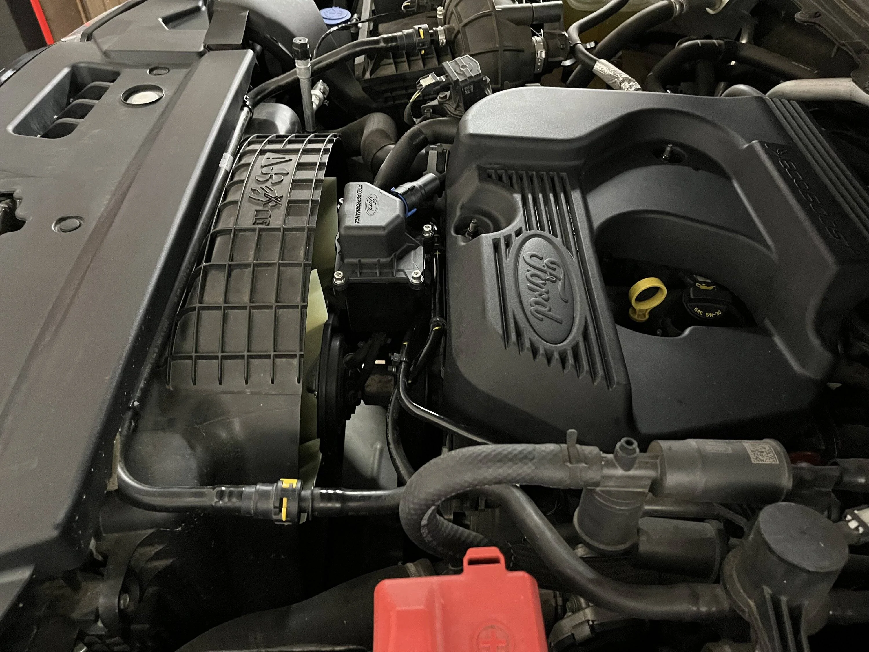

I just installed the Ford Performance Air Oil Separator, and as others have said, removing the lower hose was definitely painful to the hand and arm! I used a pruning shears to cut the plastic tube, and it made rotating the tube to access the orange clip that needs to be cut much easier. I used a right-angle pick to break the orange clip, and slowly but surely it worked, and the lower hose released. My hand and arm looks like they were in a battle zone - no pain, no gain! I would have taken a video, but all you would hear are “bleeps” from me saying naughty words!!! The new tubes snapped right on, and installation was super easy. On a side note, I had to remove my engine cover, which allowed me to wash it up and make it all pretty again. Now - with a clean engine cover, the engine idles smoother, gas mileage went up by 0.001%, I feel good about myself, and the tailgate damper has never worked better!!!
By the way, I purchased my kit from Levittown Ford out of New York. Took about 10 days for it to arrive here in Minnesota. They had a competitive price. Looks like Stage 3 Motorsports had a similar price point as well. What I like about purchasing a Genuine Ford product, is it should keep my warranty in tact. I shouldn't have to worry about "Your rear differential bearings are faulty, but we can't fix them under warranty because you installed an Air and Oil Separator - Sorry!".
I will update on how often the can needs to be emptied. I live in Minnesota, so we get all kinds of weather from 30 degrees below zero to 100 degrees above zero and humidity.
That is the same place that I worried about. The red port pivots but getting that connector off was a bear. I did pivot mine 90 degrees and moved hoses around to assist me in getting my fingers in place to depress the blue release tab while pulling the hose off. I still hate thinking about it! :headbang:

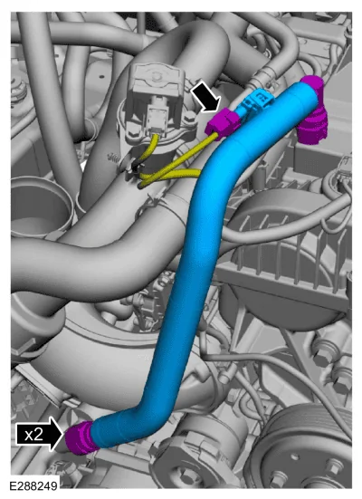

Thanks for sharing this! I am confused about the tube that is running down to the bottom of the engine bay, the instructions don't specify where this part of the tube goes? Bottom left of the screenshot here.

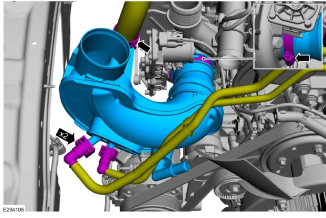

It is rather lax on specifics.
It routes down to the Intake Air Resonator - Outlet Pipe (Blue Nipple - Open)
TJC
Aug 28, 2020
48
4,216
10,845
So right into the Turbo inlet. That does make a lot more sense.

The OEM PCV hose will be easy to spot - just like the blue hose in the diagram above. The Ford Performance Air/Oil Separator was engineered perfectly and fits as if it was there from the factory. When you install the Air/Oil Separator, it will be very clear where both hoses go based on their shape, bends/curves, etc. Put a light coating of oil on all o-rings so the new hoses snap on without putting extra stress on the plastic connector they snap into.
