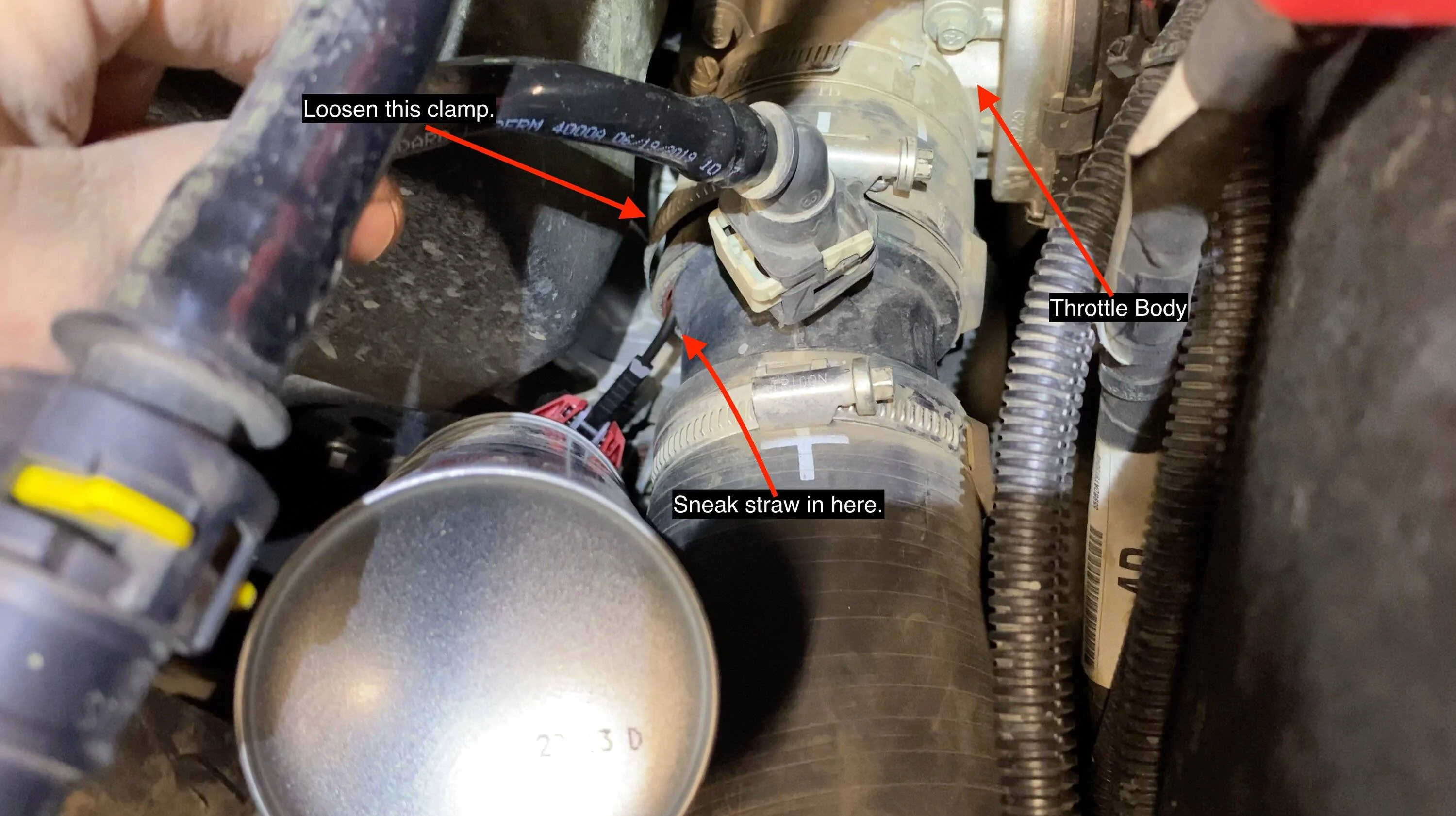

What location did you inject the CRC cleaner at in the intake system?

I cracked open the air intake just upstream of the throttle body:
Thank You! Maybe a dumb question, but that would be after the turbo correct? From what I've read, the cleaner is not supposed to pass through the turbo - especially if the turbo is hot. It looks like the turbo is on the air filter side. Thank You again - very helpful information!!!
Correct - I did NOT want that cleaner going through the turbo. Also note that I inserted the straw past the mass air flow sensor that is in that pipe - you REALLY don't want to get this cleaner all over that sensor, either.
