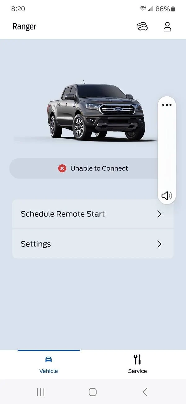

Just got back to this thread. I made the changes that had been suggested, still getting 'Unable to Connect'.
