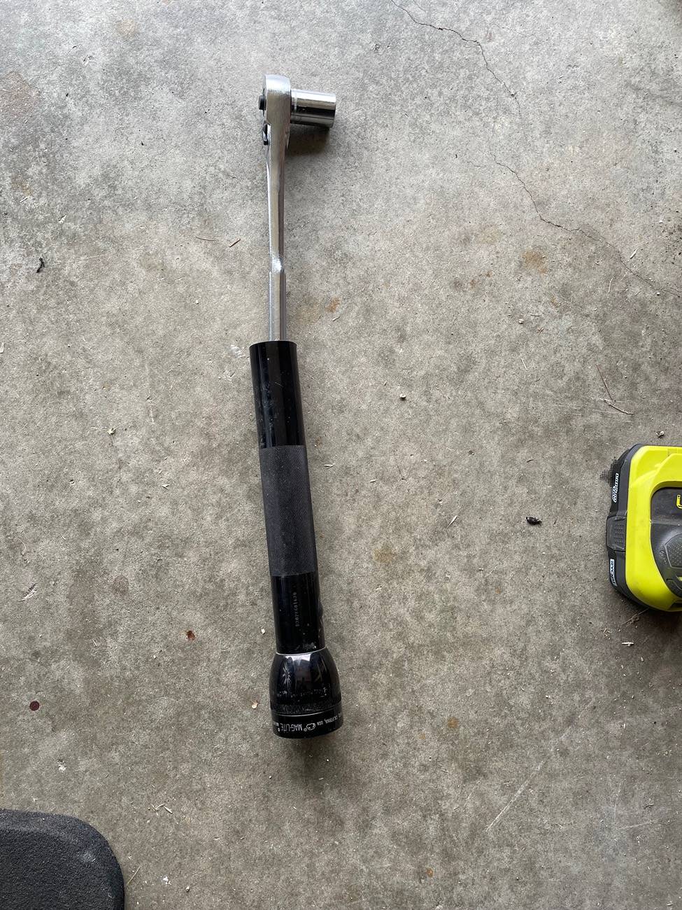

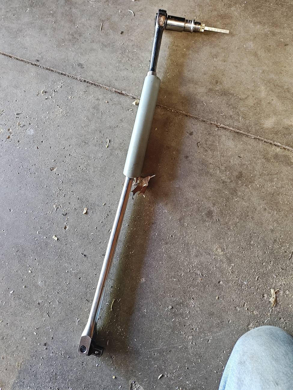

I have one of those in my tool box , a repurposed mag light 3 cell as a cheater bar along with a couple of other pipes.
Maglight used to be my favorite light but since buying a Streamlight Stinger and its lasted over 10 years and gets used frequently at work, Streamlight wins, although I still like the 2 Cell (AA) Mags but after frequent repair or replacement of my (D-Cells) and rechargeable Mags over the years , I dumped that brand as my daily use light.
The Streamlight was a 160.00 light but it is the best flashlight I have ever owned and used.
I have converted two maglites to LED.
