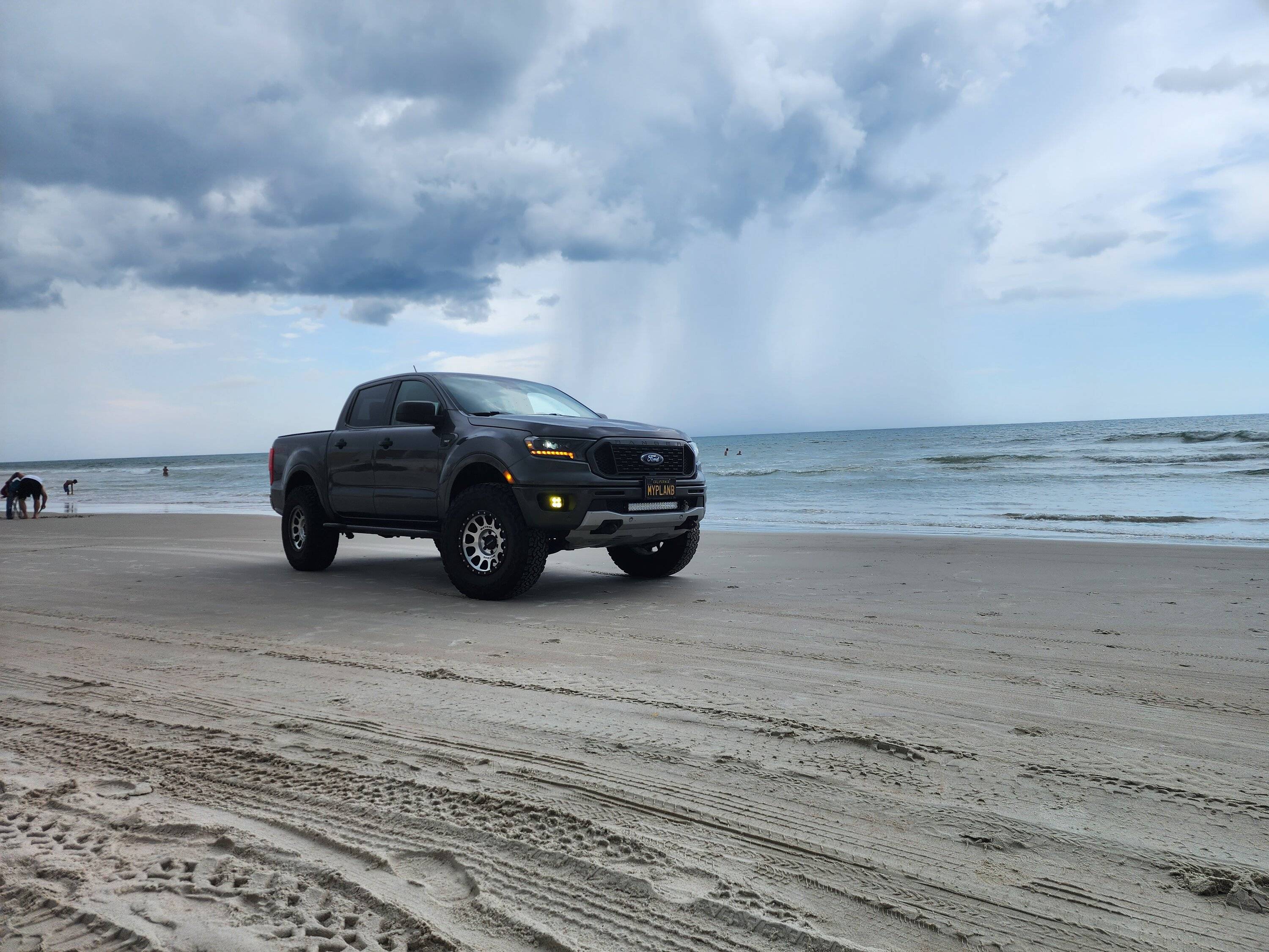

I'm running on 295 70R/17 and using Recon Nitto Grapphler (33.3). I have Fox 2.0 in the front plus superlift to total of 3.5 inch lift and 1.5 inch block with Eiback in the rear. The crash bars all removed and the plastic egg creates or noise dumping is gone. Im using 0 offsets wheels. I'm saving $$$ for Icon since it can handle 3.5 inch lift.

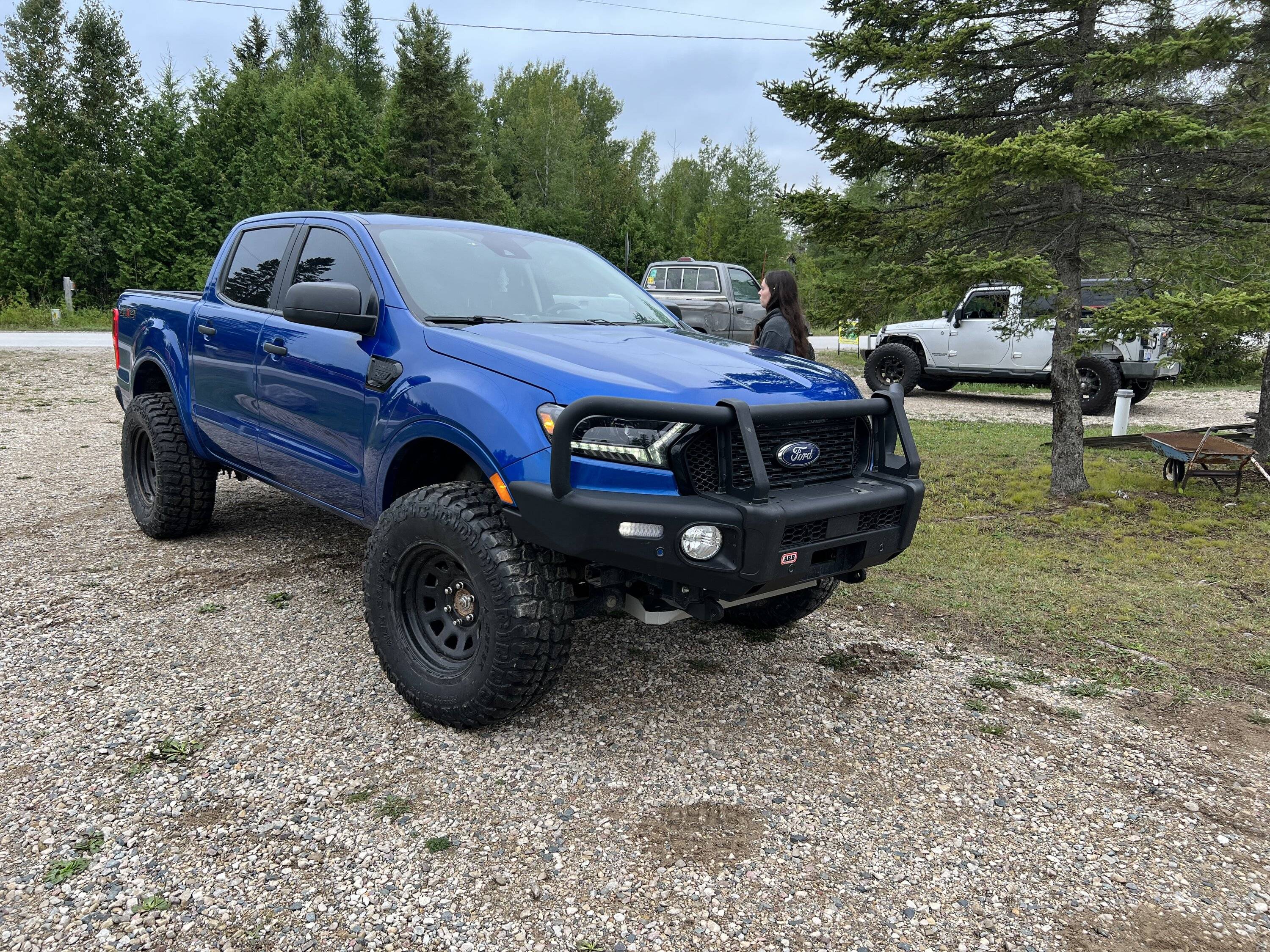

I have 6" BDS lift along with the replacement crash bars. I run 35x12.50 on a 20x9 and have 0 rub even at full turn. I do not have any spacers either.
Does that AVS deflector have lights? Did you have it colour-matched? I’ve been trying to find it online but haven’t had any luck so far. It looks great.

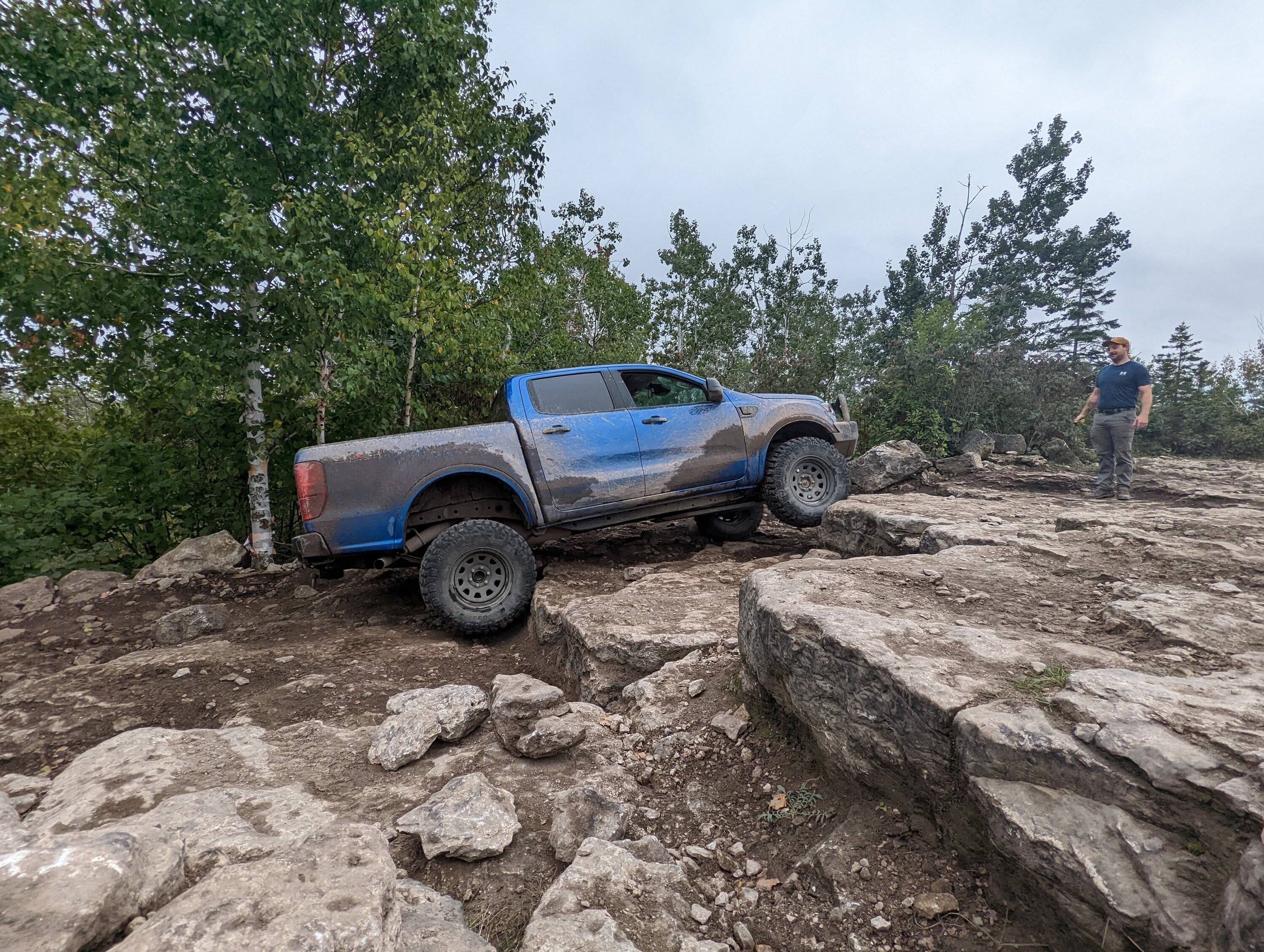

35x12.5R20 landspider
Eibach pro truck 2R front
Eibach 1" spacers on the leafs
Removed crash bars
Air dam behind fog lights removed
Plastic behind felt removed and felt pinned back
Fender weld seam trimmed
