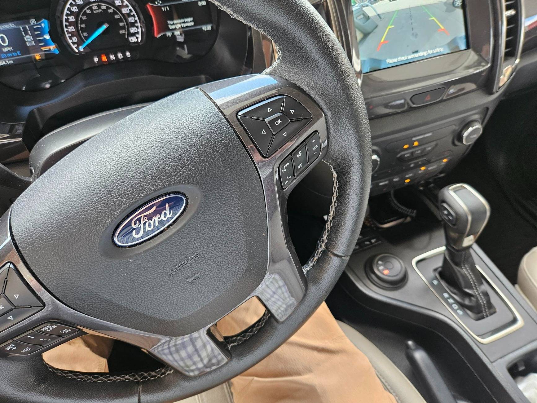

Guys, with this being the latest Ranger tranny post I will add to the info presented.
Have a 2022 (January vintage) Lariat. At about 70K miles the transmission went out. Wyatt Johnson in Nashville, TN is where I purchased with extended warranty. These guys were able to pull up the tranny info online to see that it had crashed. So, I received a "remanufactured transmission".
Now, about 1K miles later, there is a hesitation, some unnatural gear shifts, tranny fluid on the garage floor, etc.
The real kicker is below. Notice the shift is in P while the dashboard says R! If I move around the shift it drops into P.

Continuing from above, this morning my Ranger hesitated when I needed to move fast. This is a dangerous problem IMO.
I did reach out to the dealership. The quickest transmission service is three weeks out.
It may be I should trade the truck in and let the dealership sort this out. Any thoughts?
Whats the point of buying an extended warranty if you don’t use it? I would let them fix it before you decide what to do. Trading for another truck is the most expensive outcome you can have.
Take it back and have them fix it.
