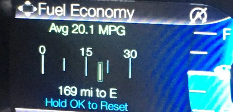

Just started it, and didn’t touch auto start stop, but it’s crossed out on display.
Lot of reasons why it may not be activated (page 144 of manual):
Enabling Auto-Start-Stop
The system is automatically enabled every time you start your vehicle if the following conditions are met:
• The Auto-Start-Stop button is not pressed (not illuminated).
• Your vehicle exceeds an initial speed of 3 mph (5 km/h) after you have initially started the vehicle.
• Your vehicle is stopped.
• Your foot is on the brake pedal.
• The transmission is in drive (D).
• The driver's door is closed.
• There is adequate brake vacuum.
• The interior compartment has been cooled or warmed to an acceptable level.
• The front windshield defroster is off.
• The steering wheel is not turned rapidly or is not at a sharp angle.
• The vehicle is not on a steep road grade.
• The battery is within optimal operating conditions (battery state of charge and temperature in range).
• The engine coolant is at operating temperature.
• Elevation is below approximately 12,000 ft (3,650 m).
• Ambient temperature is moderate.
The green Auto-Start-Stop indicator light on the instrument cluster will illuminate to indicate when the automatic engine stop occurs.
If the instrument cluster is equipped with a grey Auto-Start-Stop indicator light,
it is illuminated when automatic engine stop is not available due to one of the above noted conditions not being met.
There is trip 1, trip 2 and fuel economy in the menu. Go to that fuel economy tab and page down. You will get to a screen that describes why your auto start/stop is not operating. I'm not sure it if works when not at a stop. I've only tried it when the ASS wasn't working. The description might also be in the manual. I'm not sure. I learned it here.

Well, it was on. Didn’t work at first two stops, then it started working and worked 7 different stops. Worked all the way home, no crazy lights. I’ll check it again in the morning.

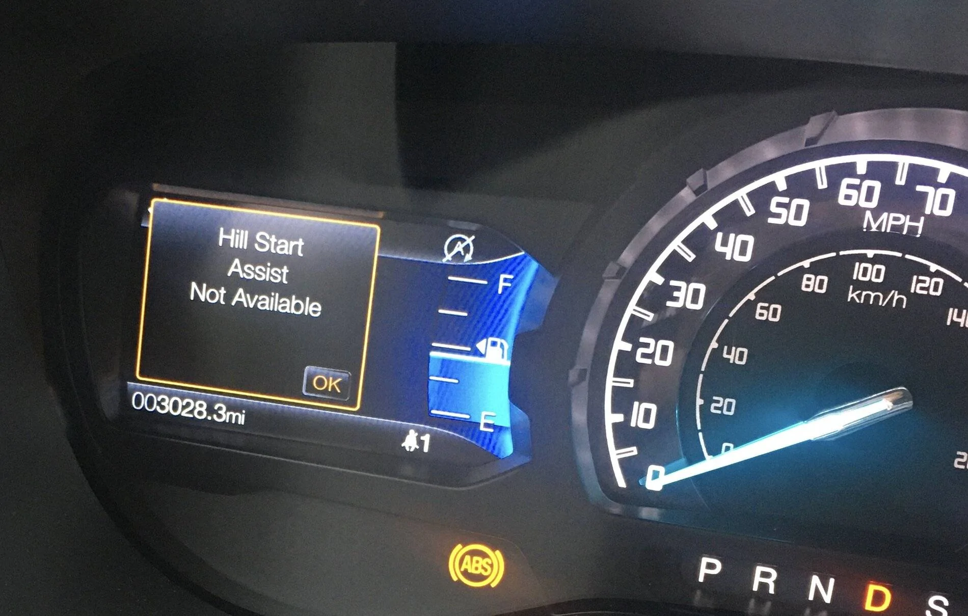

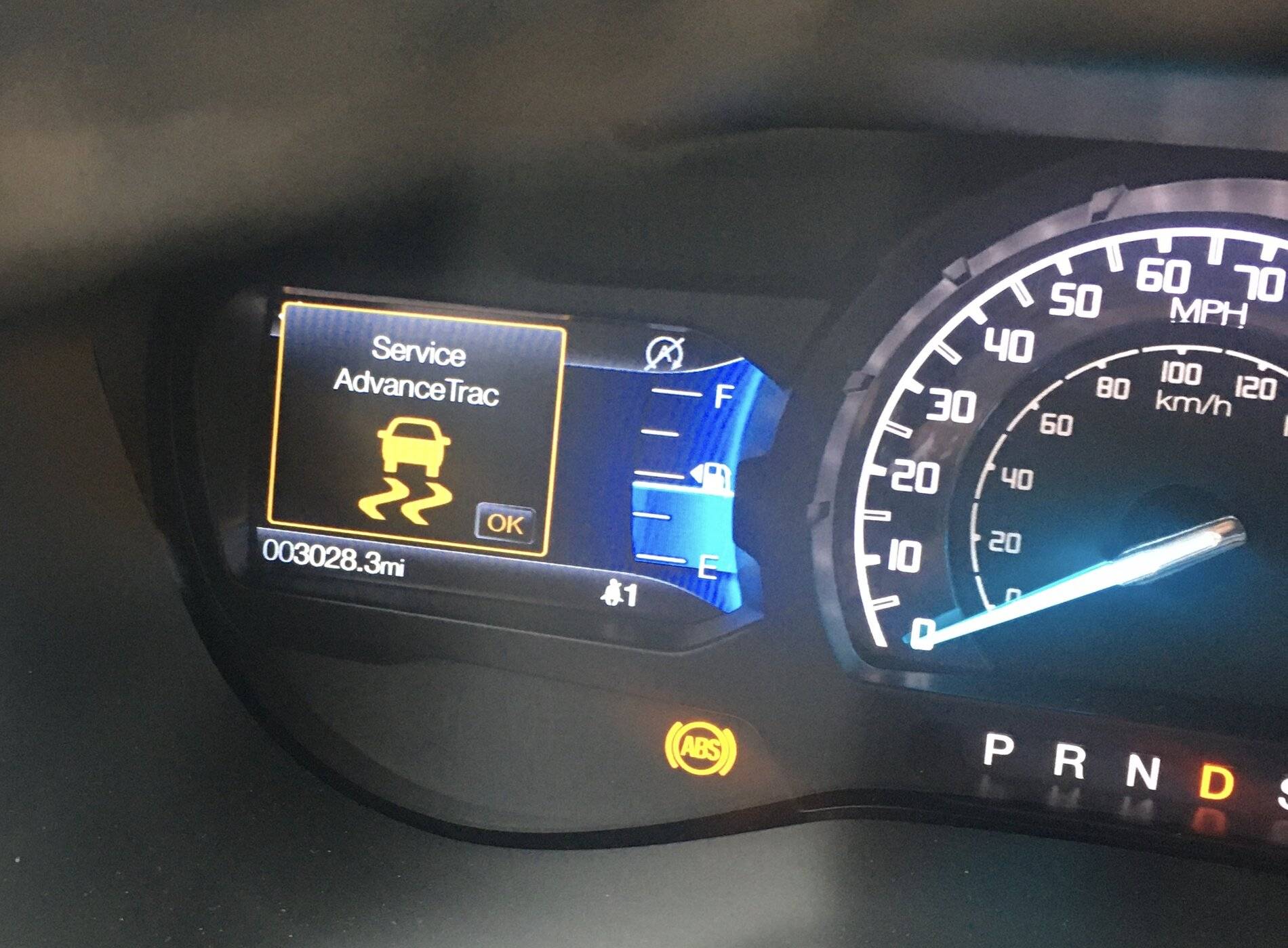

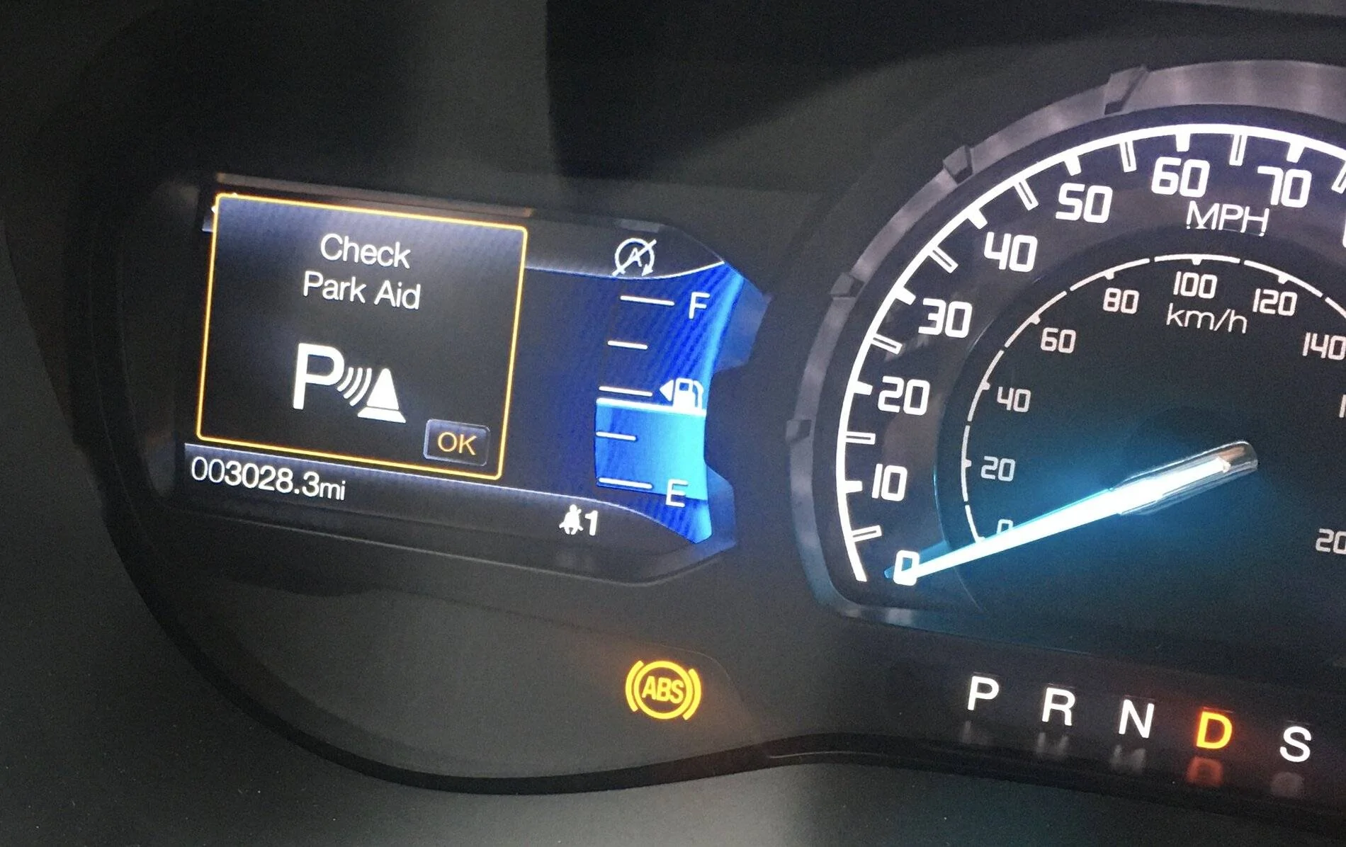

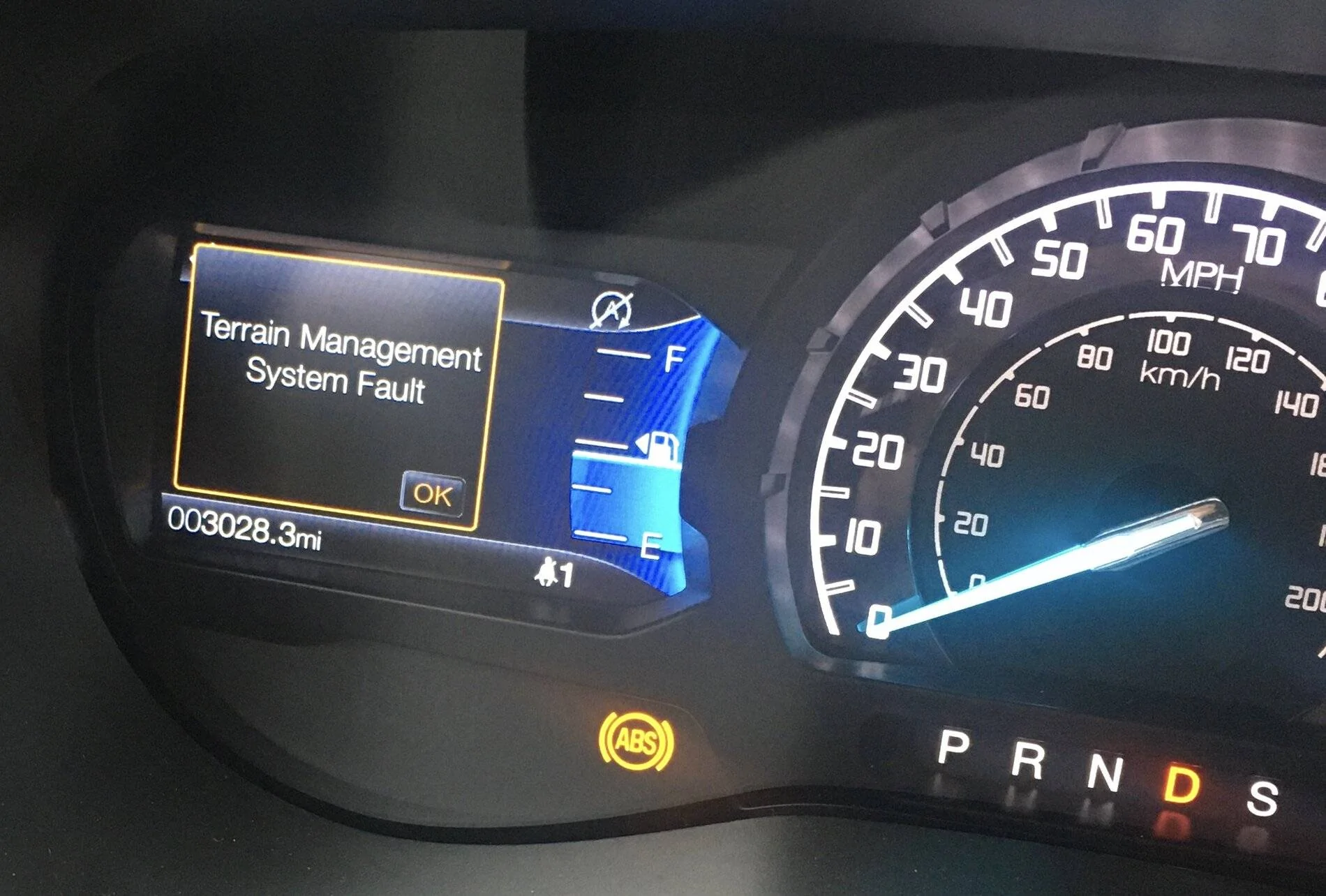

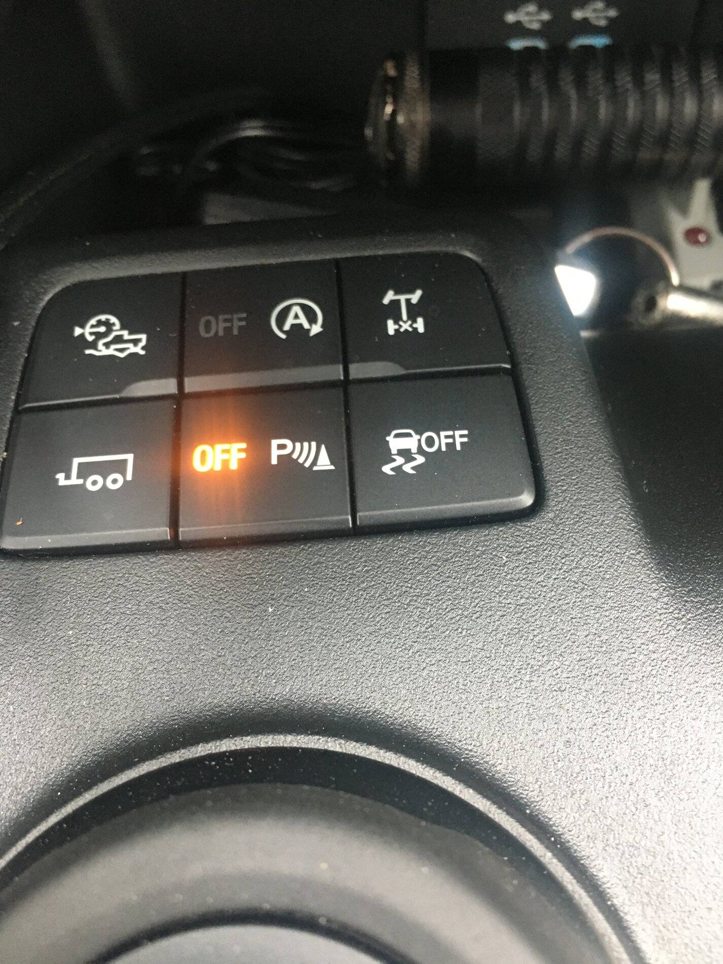

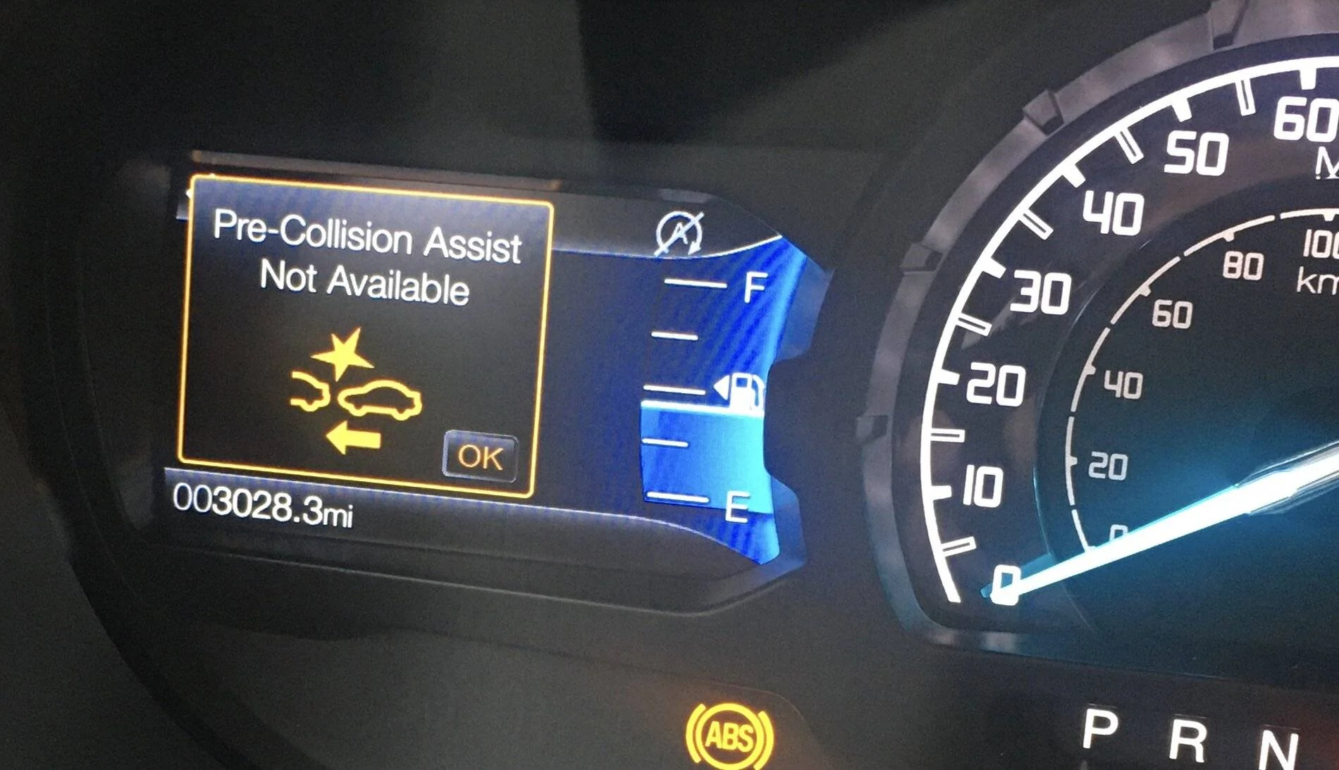

Spoke too soon. As soon as I got home, my wife had ordered food. Went back out and started it, and this happened. Drove it to get food, turned it off there, and when I started it back, it happened again. Check out all the lights and messages...
