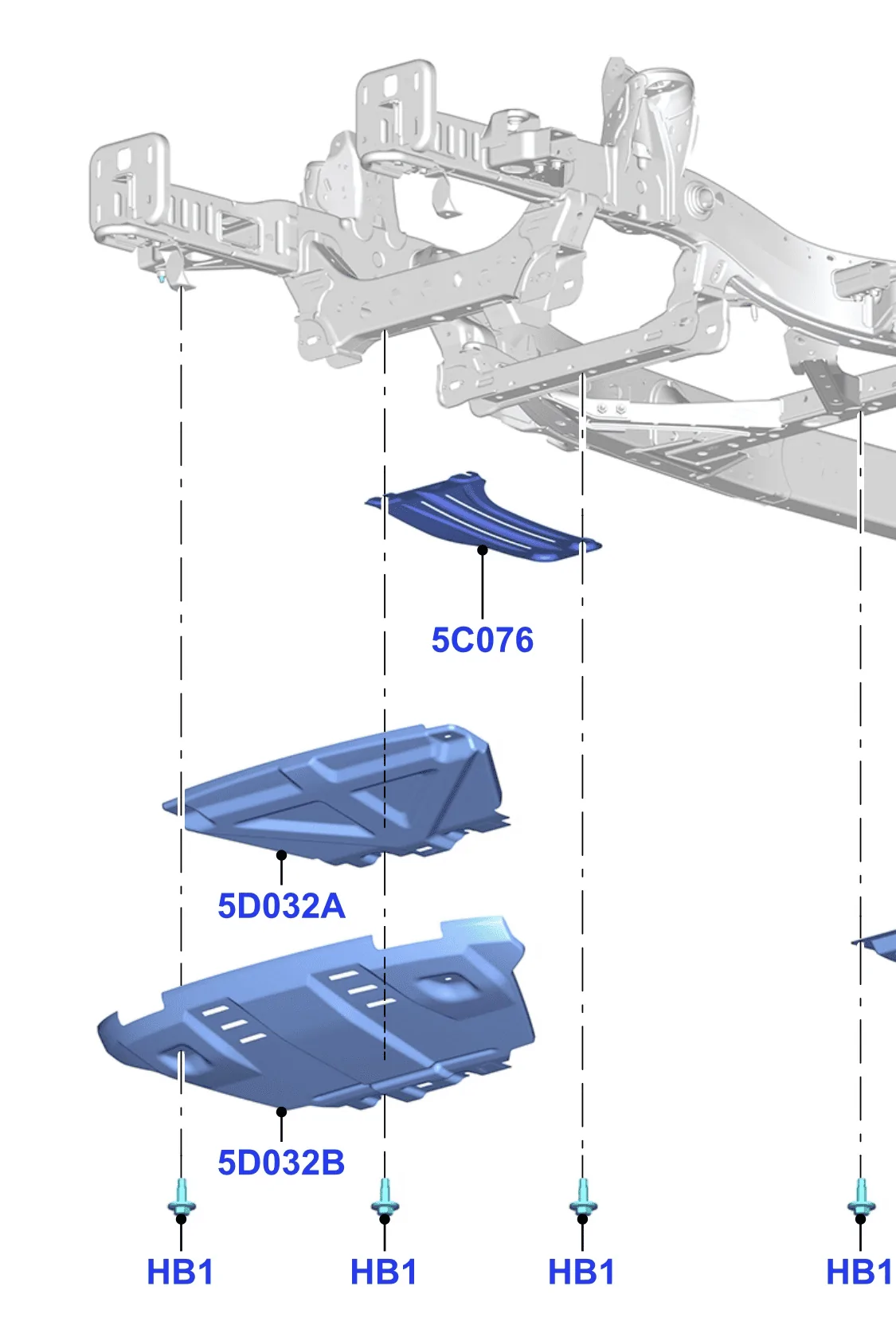

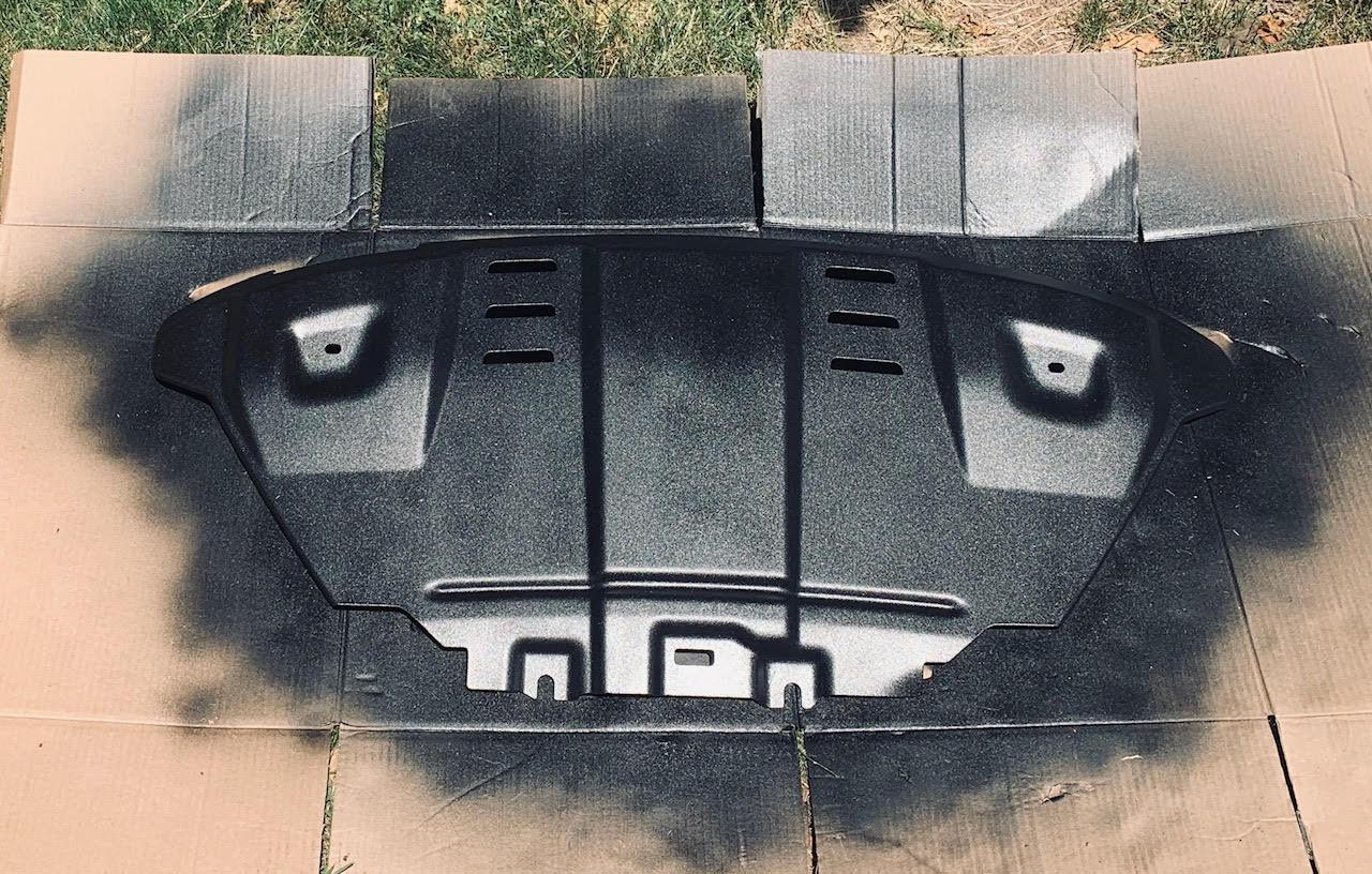

After reading through this I am still a little confused on a couple things, wondering if anyone could clarify.
I have an XLT with 301A and Black Appearance Package and would like to install the 5D032-B skid plate from the FX packages (mostly for looks) and am wondering if I have or need any other parts to do a swap. From the below image I cannot tell if 5D032-A is needed as well.
7,083
37,184
Hi Zach,
You do not need the 5D032A.

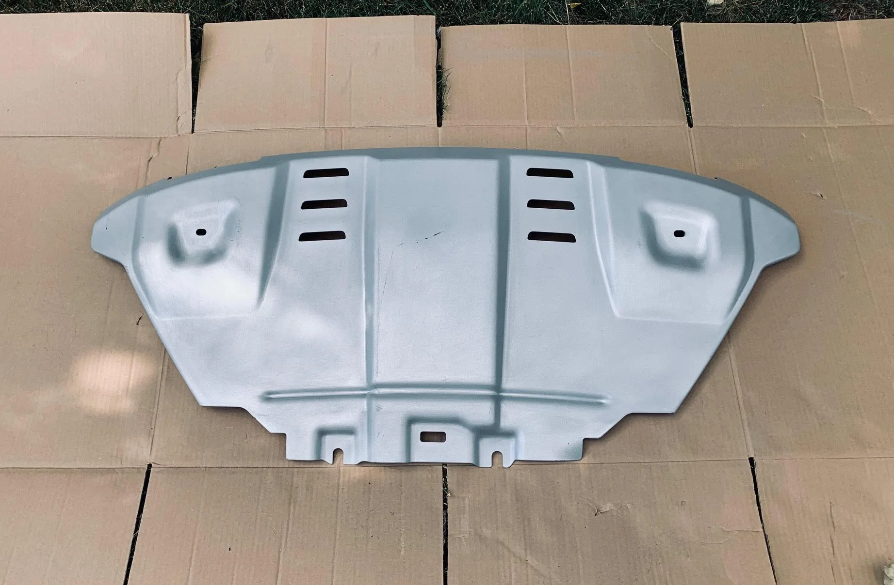

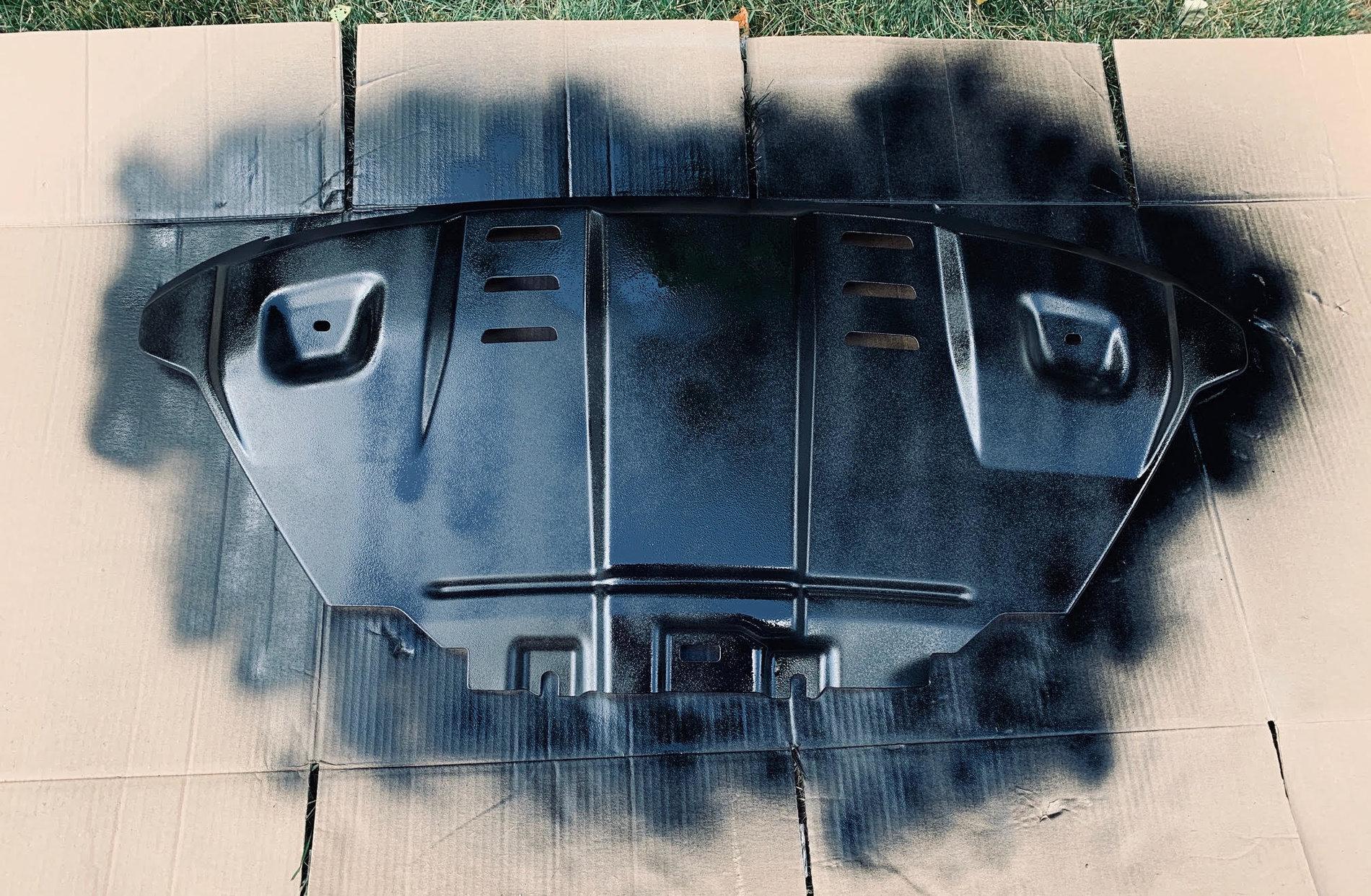

Just received my 5D032B yesterday. Scrubbed it down with steel wool and put four coats of Herculiner on it today for aesthetics and scuff resistance. Waiting for it to dry overnight before installing. One (and-a-half) questions for those that have worked with these: Does the 5D032A stay in place? It almost seems redundant, they are very close in coverage. I do assume they should both be in place, but just want to double check. Also has anyone swapped their lower grille that has skids? I haven't mucked around with the lower grille much, but it seems like you need to get into the rear side of the bumper to remove it.
Zetterbeard
Zach
Jul 3, 2019
128
112
2020 FORD RANGER XLT 4X4
Well, I put it on today and am satisfied with the results. The Herculiner looks great so far (obviously minimal driving) and matches the rest of the truck. Anyone want to buy a 5D032A for their 2WD?
