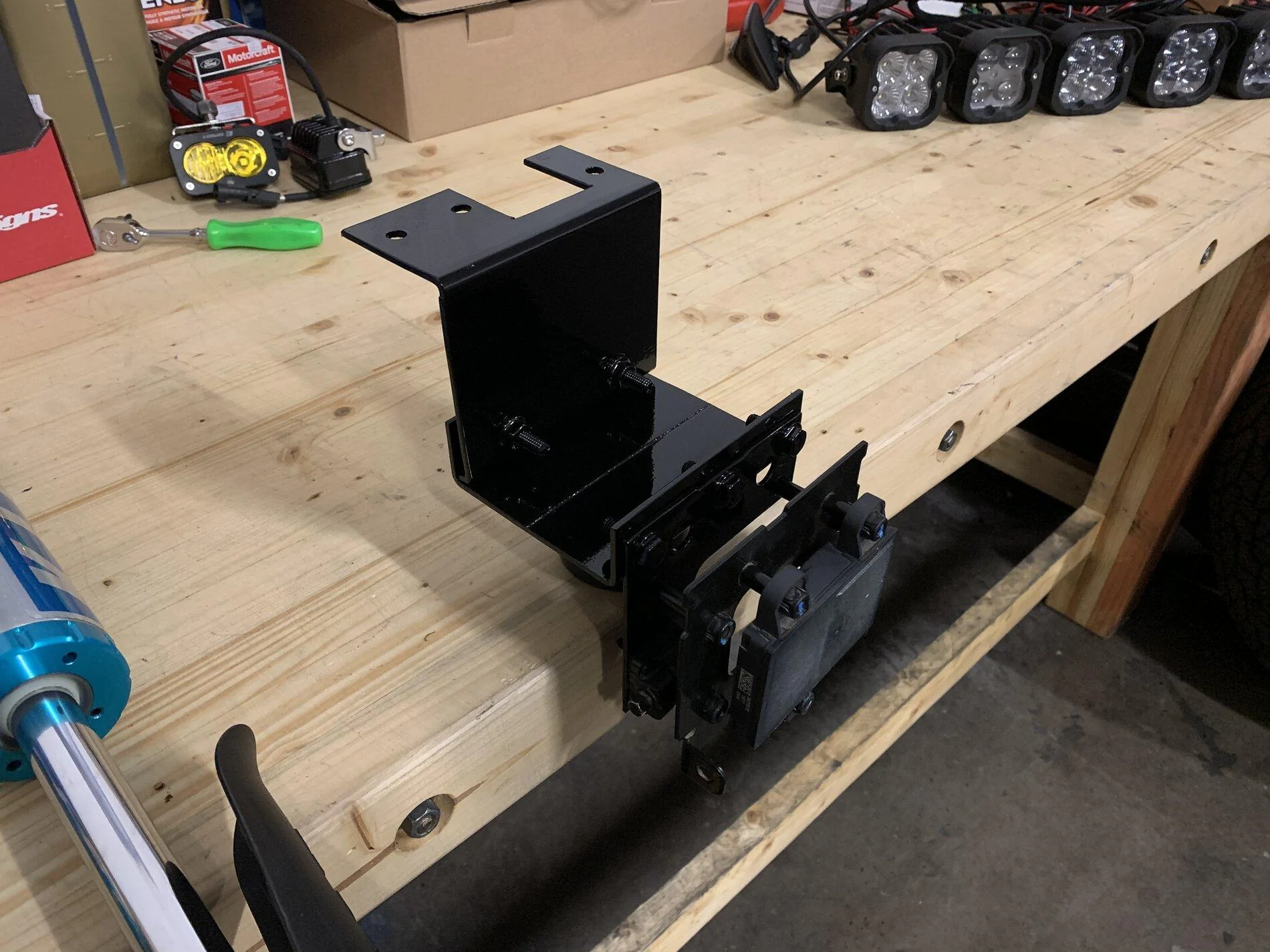

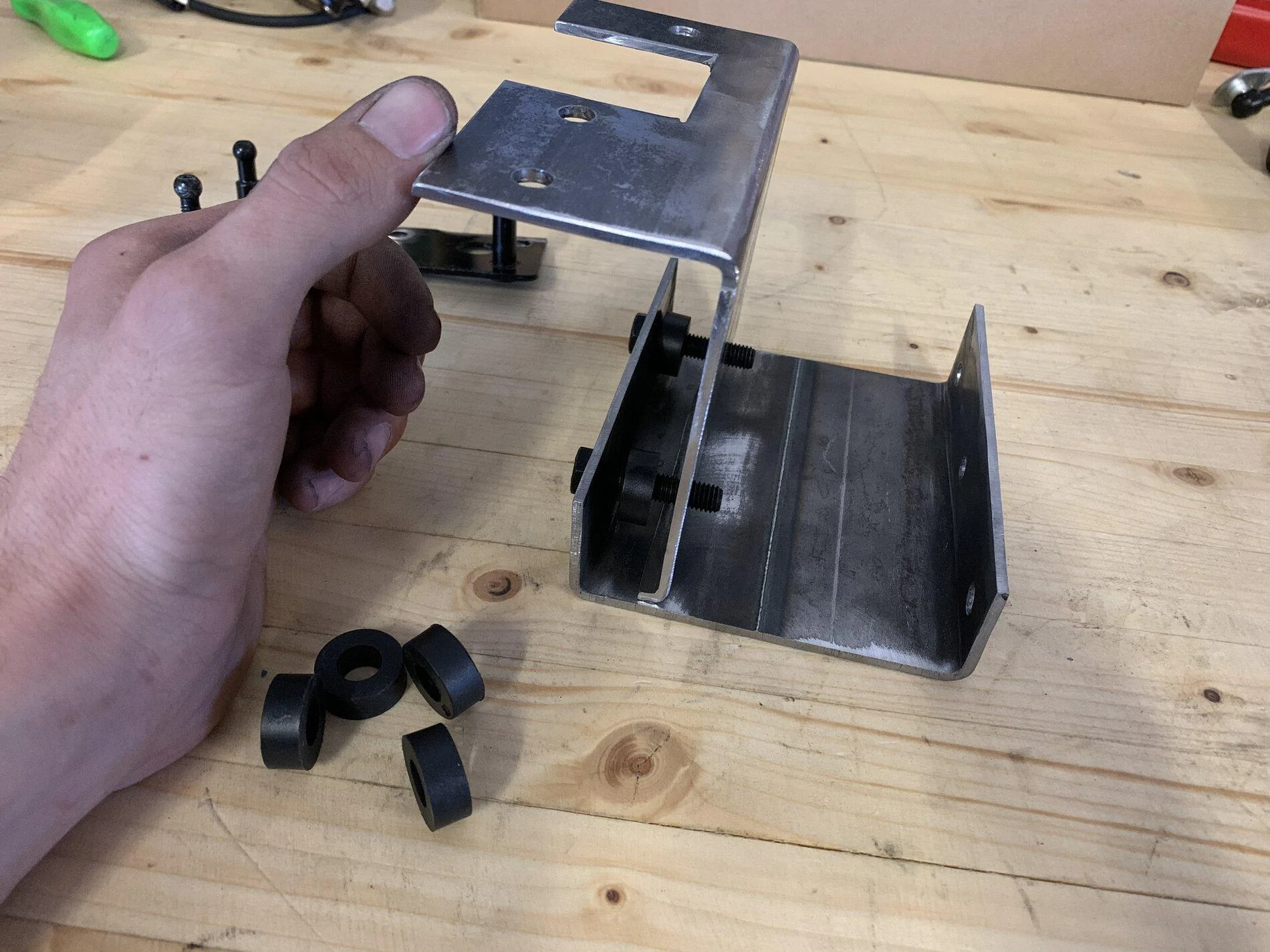

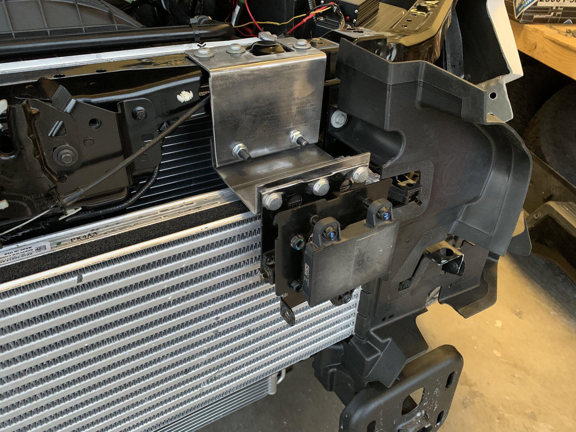

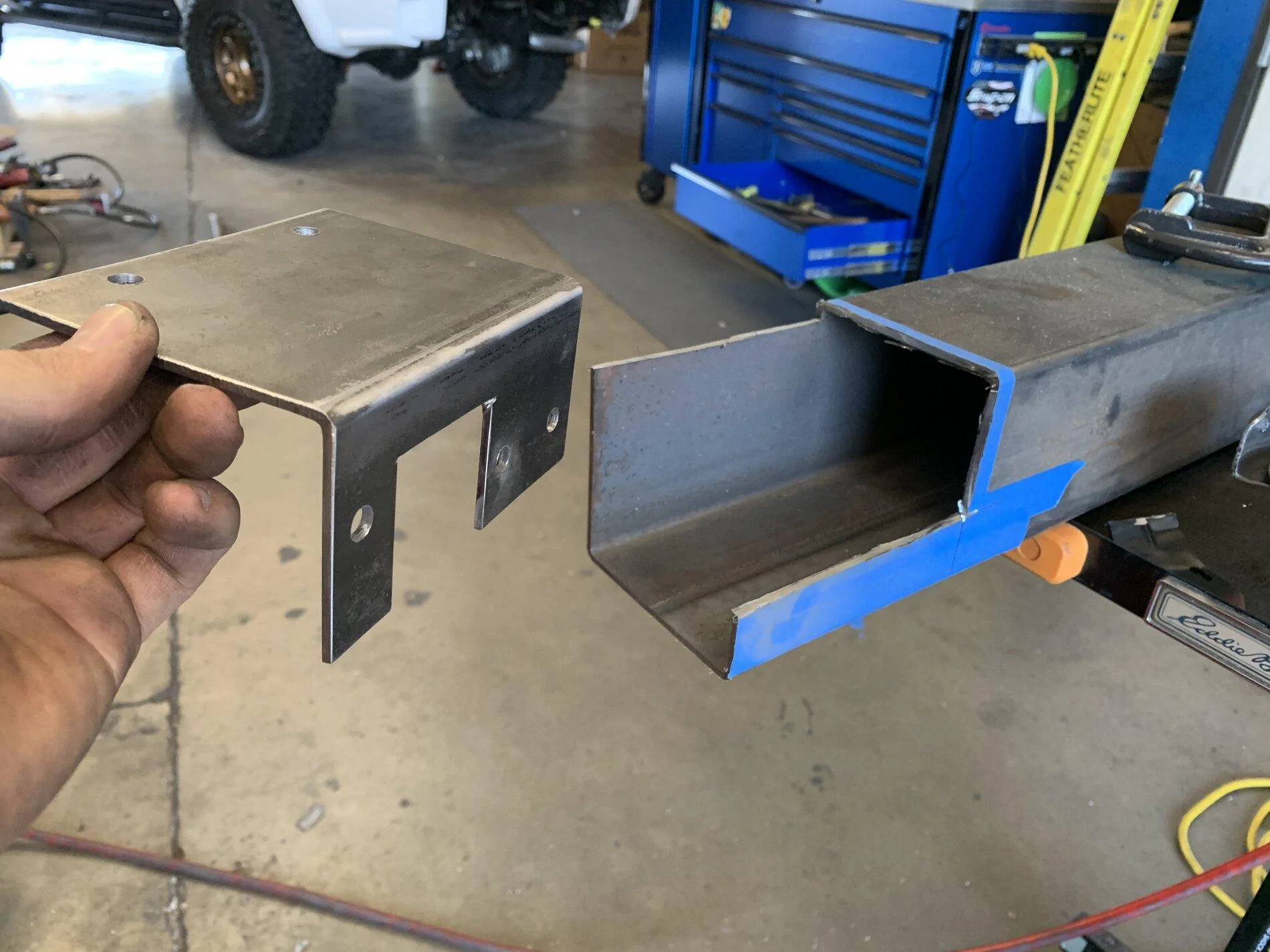

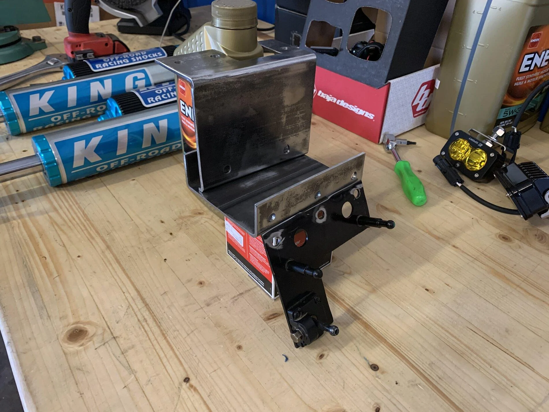

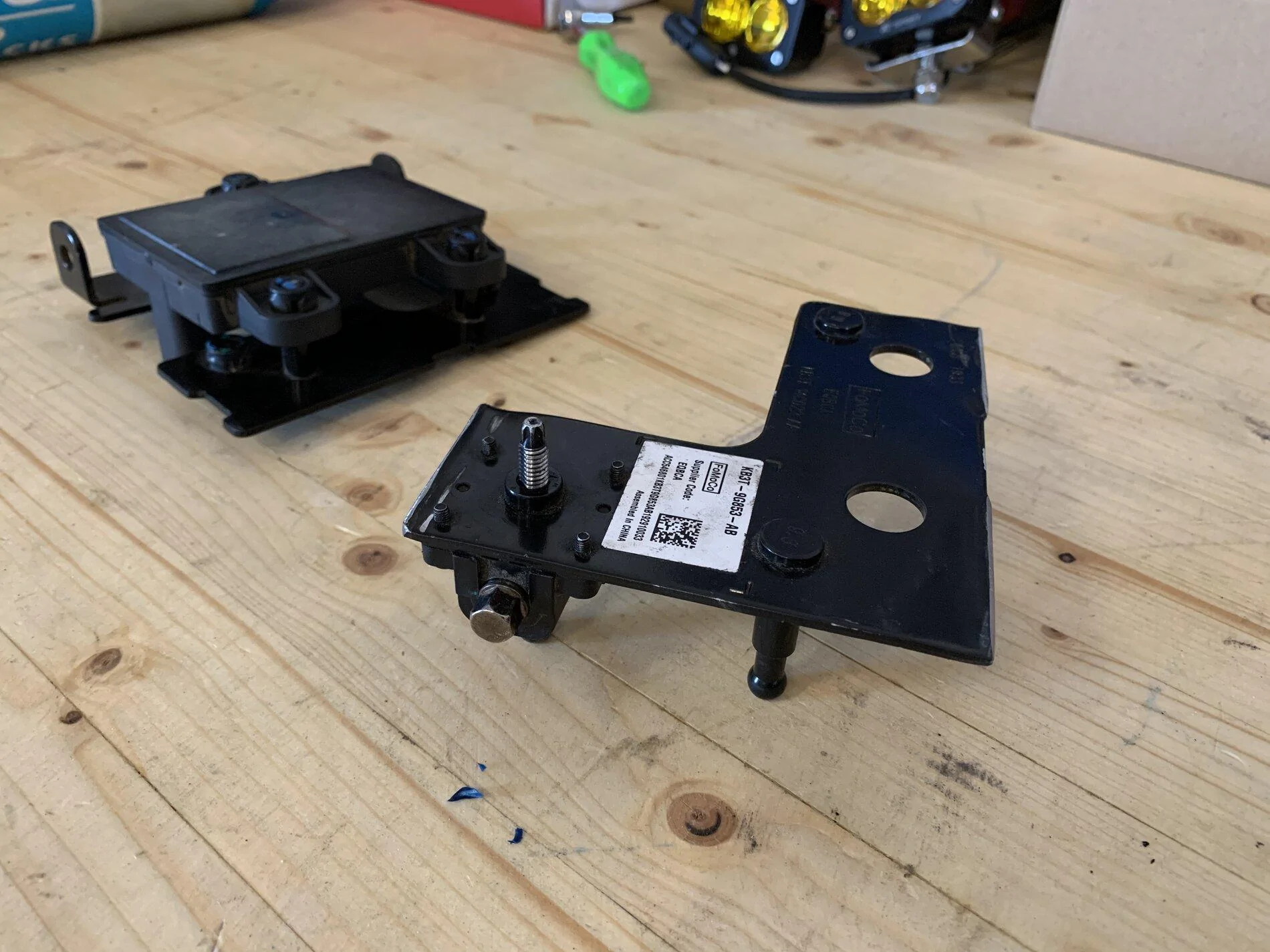

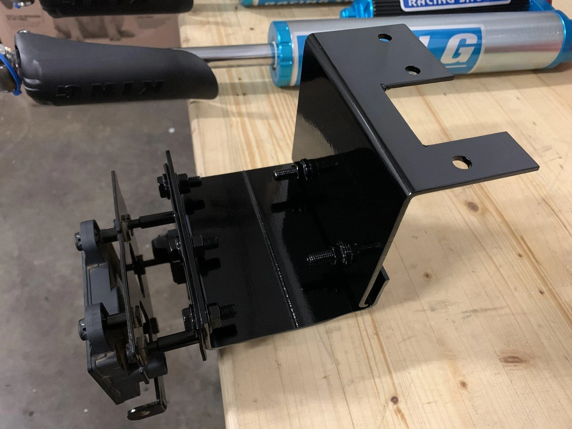

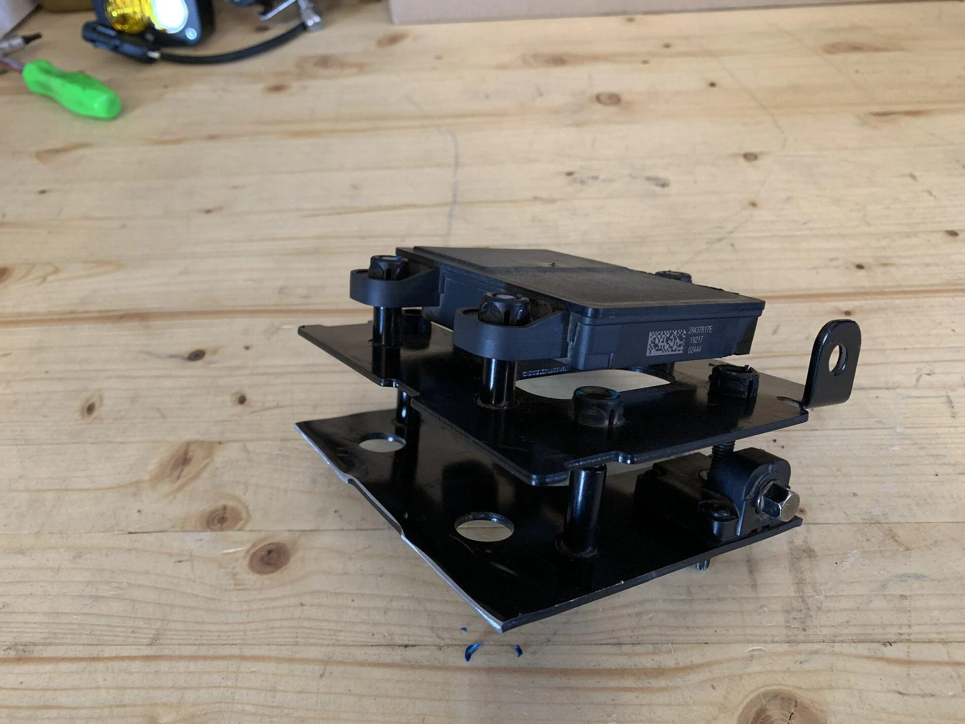

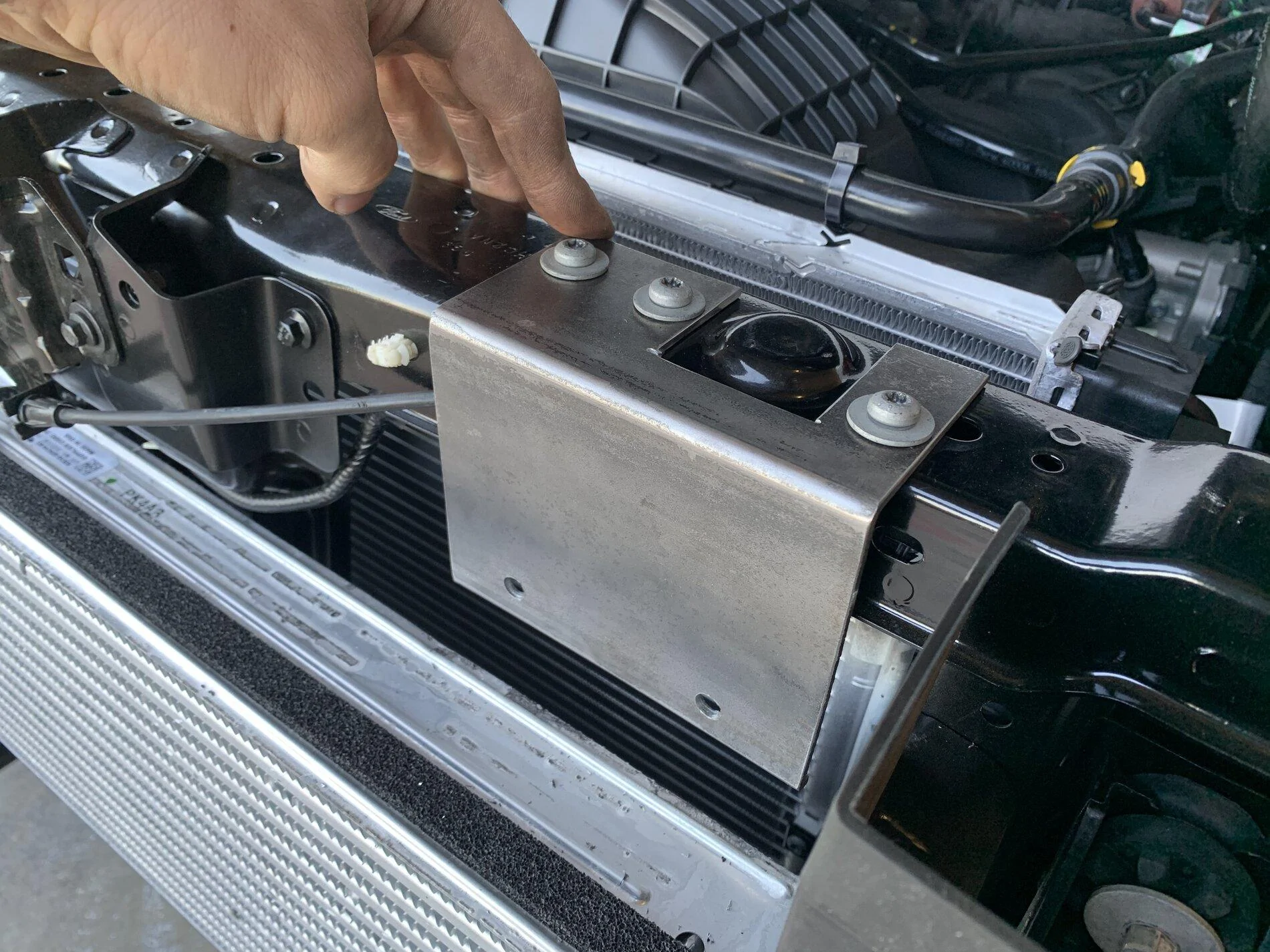

Found some scrap steel laying around and decided to build a bracket for my ACC since i have a offroad bumper coming soon and dont want to pay 200+ for a bracket. I cut the original bracket mounting points off then measured and cut some custom pieces, cut out a little channel so it wouldn’t interfere with the hood stop, drilled holes, used some nuts and bolts i had laying around and painted the whole thing gloss black. It is fully adjustable inwards and out ( by adding or removing spacers ) and retained the factory up and down tilt adjustment. It is tested and works just fine. Pictures are pretty self explanatory.
I dont know if im posting in the correct area im pretty new here.

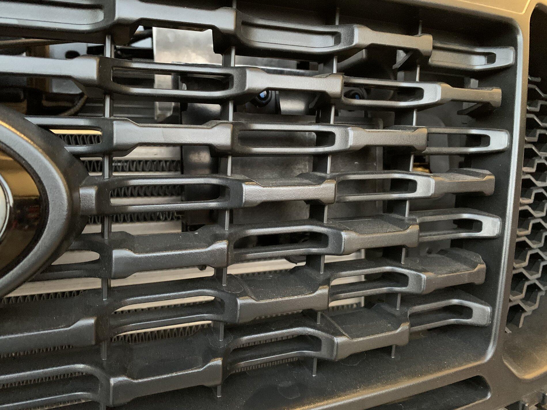

I’d love to have mine moved up behind the grille. It failed like every time it was snowing on the highway from ice accumulation..... great work fella!!

Yeah get the message that Adaptive is unavailable, you have to switch to standard cruise, which while driving can become a minor distraction to go thru the menus....

did you have to extend the wire harness at all ?
Jeff
I soldered on more wire to run it hidden. You can just unwrap more from the oem harness and it will reach but it shoots straight up and visible
