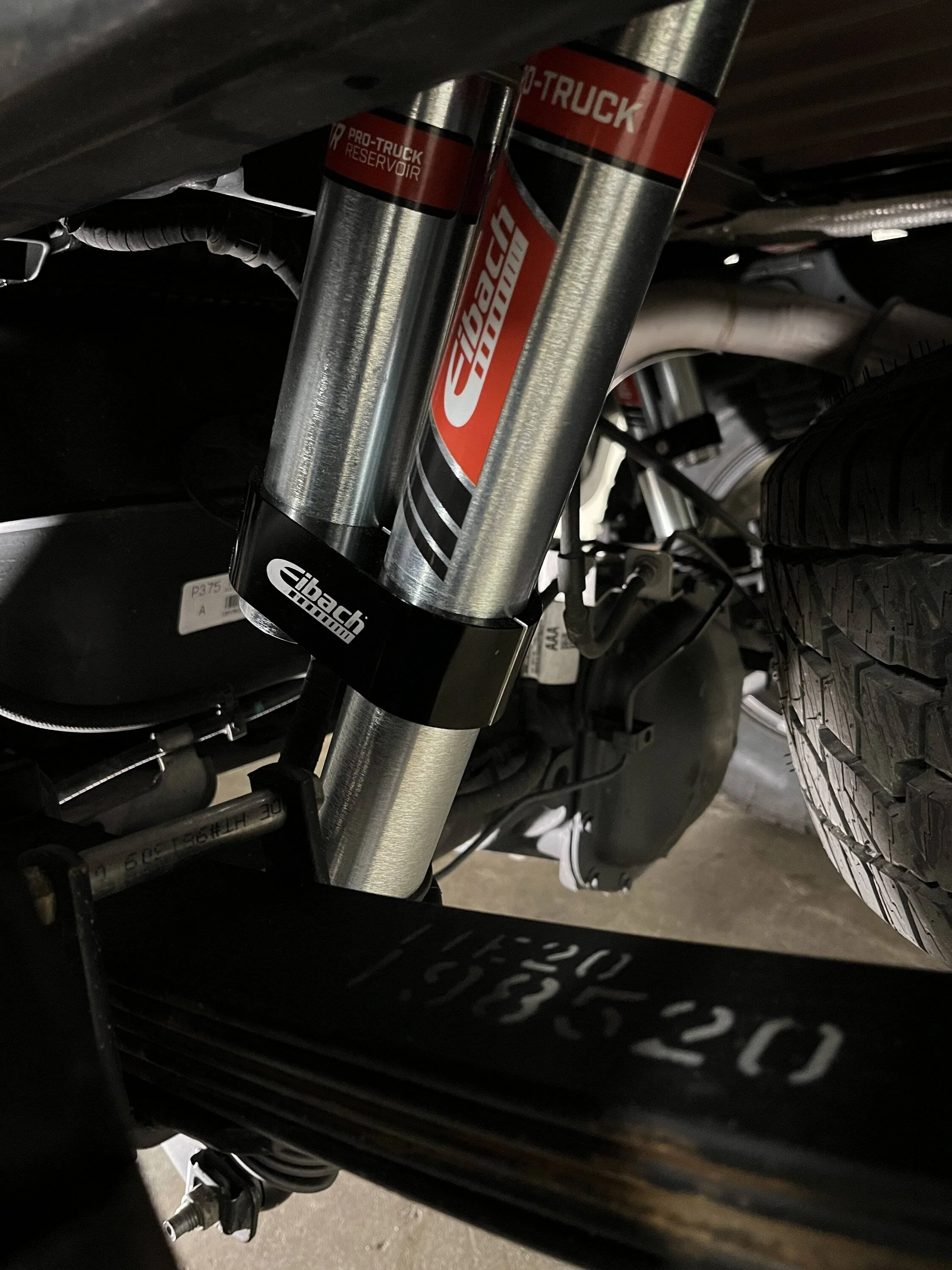

got a good test ride- these balance out with the 2.0 coilover way better than the regular pro truck sport did. small bumps and general drives feel soft like the fx shocks minus all of the bad parts. rebound feels good, they don’t pack up or donkey kick. i also have icon springs so factor that in too.
i’m very happy with the way these feel.
