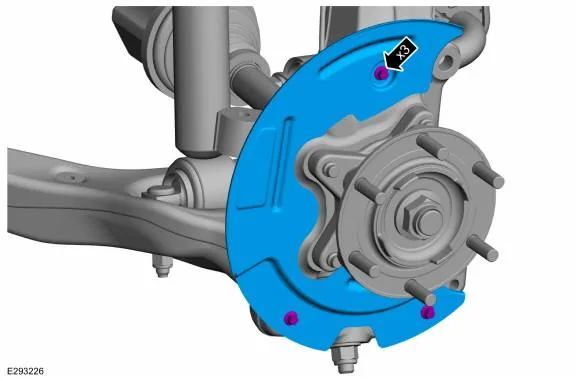

Still troubleshooting before I pull the trigger on parts.
Pulled the dust shield completely, no bright spots anywhere. Drove a couple laps around the cul de sac with it removed. At least I know it isn't that.
