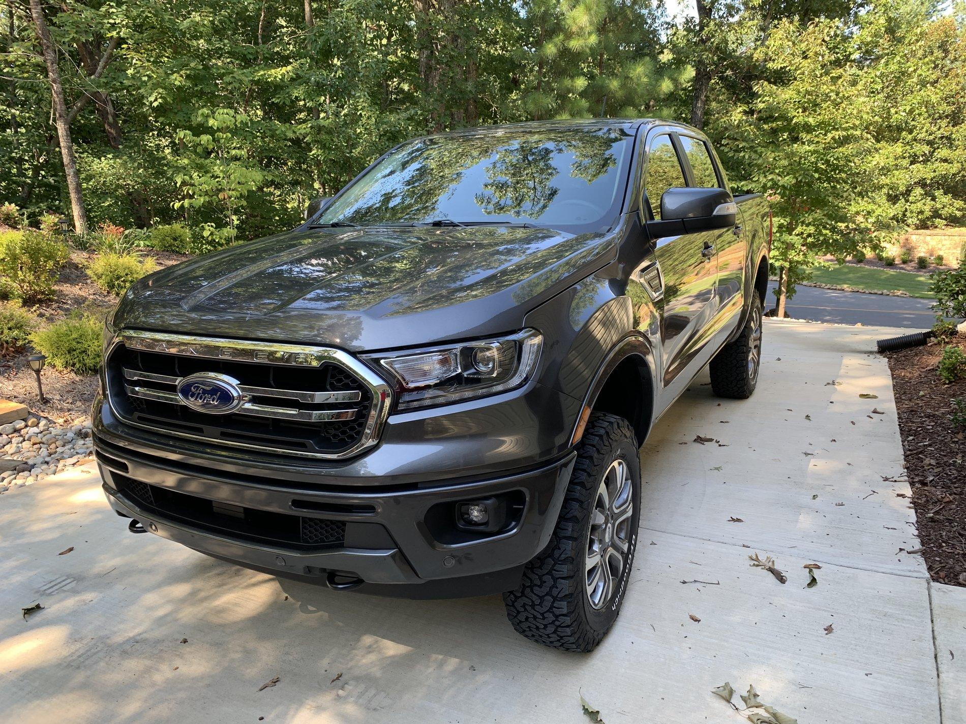

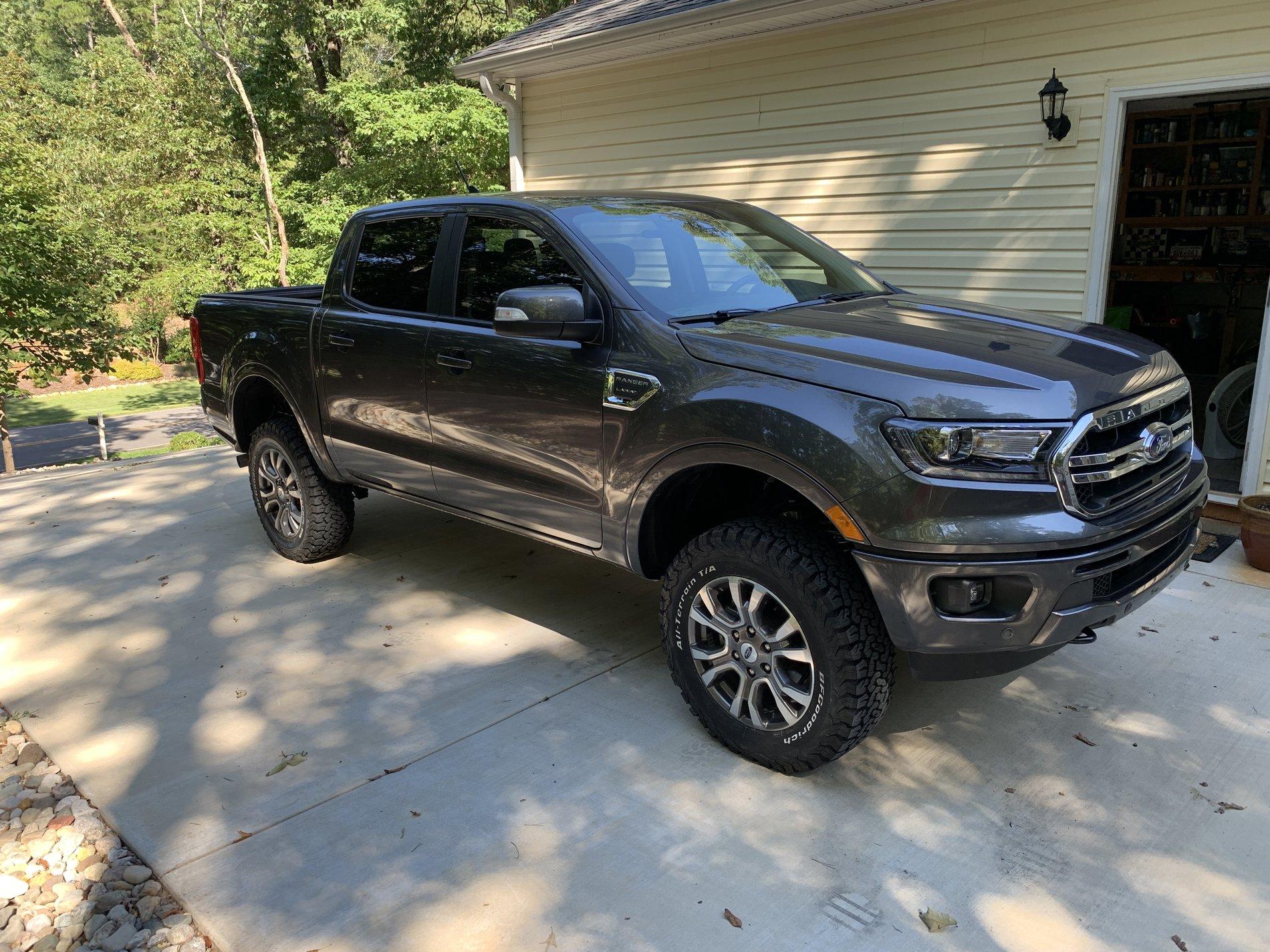

Just got my Eibach kit installed yesterday and it lifted my front end to the moon. Did the shocks and springs with the struts set at level 4, or second from the top. Unfortunately I forgot to measure before they were installed so I don't know exactly how much it lifted it, but it's a LOT. Sucks because it's too high now, so everything has to come back apart. I've only driven home from the dealership which is only about 15 miles, but the ride was good, a bit firmer, but planted in a good way.

No, installed the springs that came with the struts. IMHO it's too high....

Following up as promised. I'm really loving the full eibach kit with new dampers all around, eibach front springs set on the lowest perch level (3" lift) and 1" rear blocks. This made the whole truck feel tighter and less floaty and in general more truck like compared to the stock non fx4 set. Left a little bit of the factory rake. I also installed Toyo open country 275/65 18 in p metric (no need for LT or E rated tires on a chassis this light, the BFG's in these photos were LT 265/65 and were bouncy and rough. I swapped them out after 100 miles for free with discount tire) and whole package is a huge improvement. Very happy with the eibach kit!
