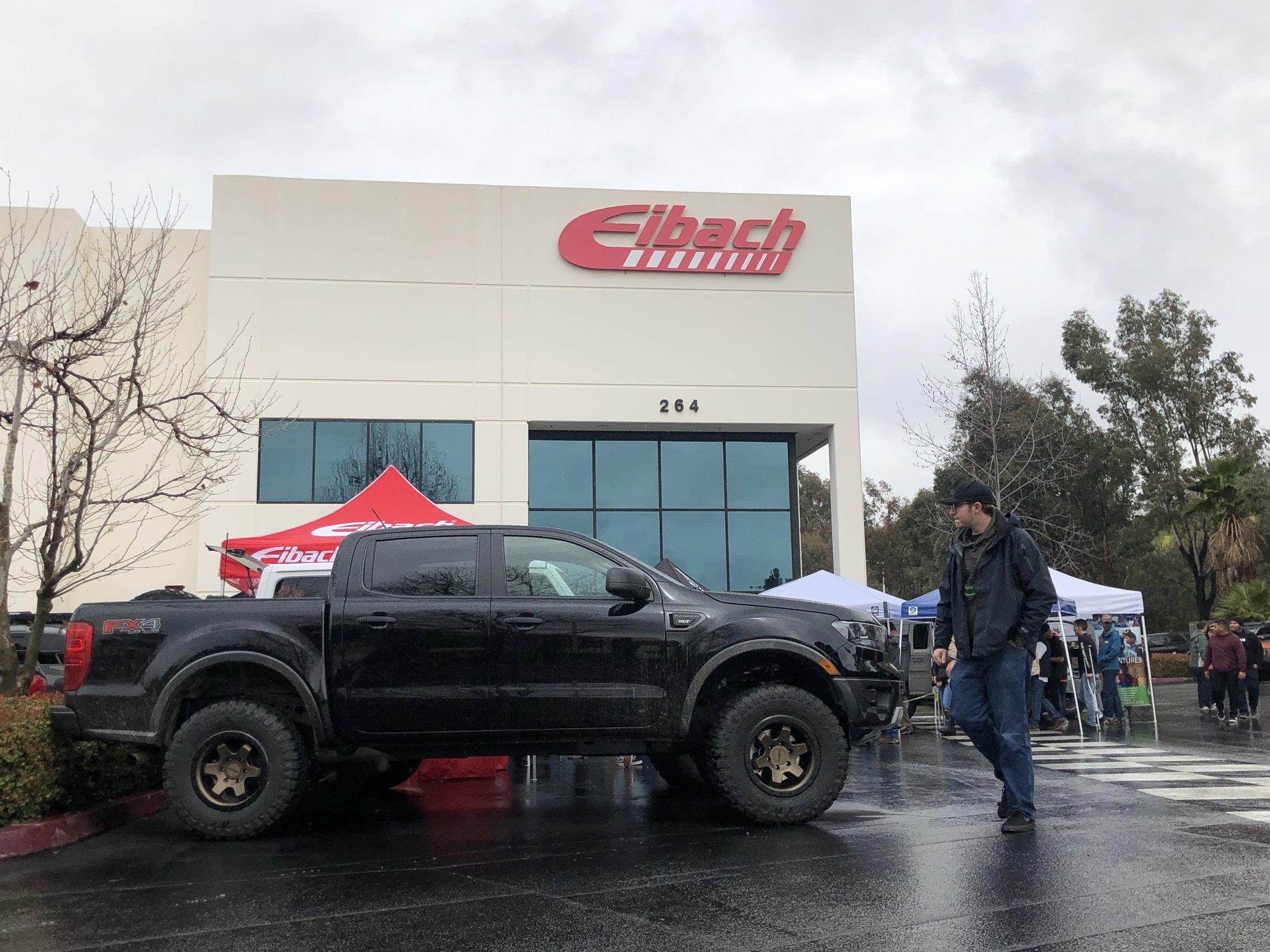

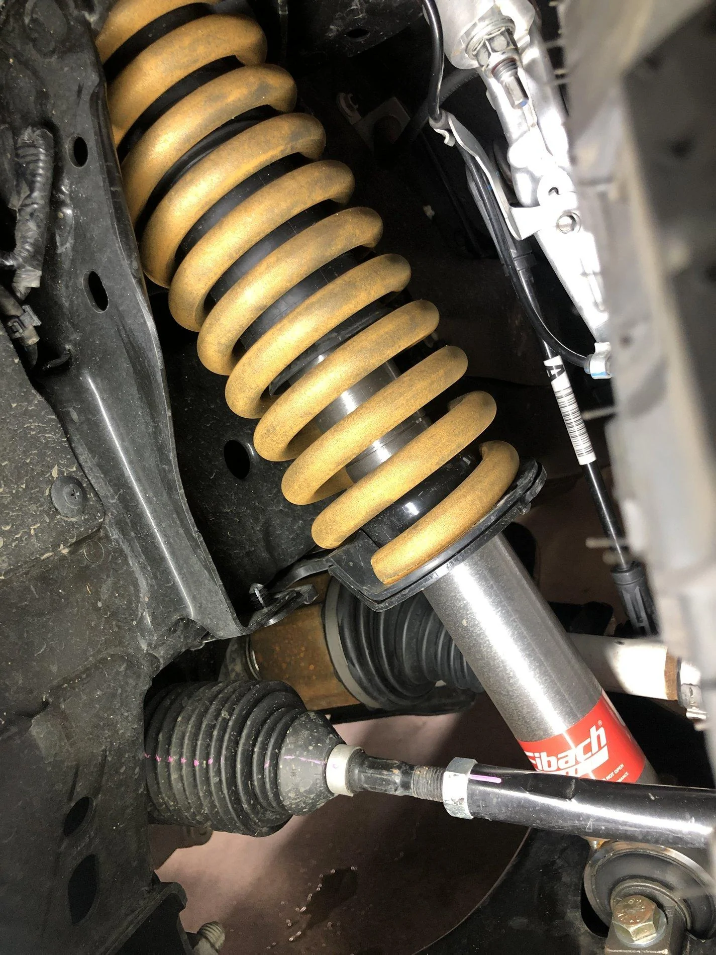

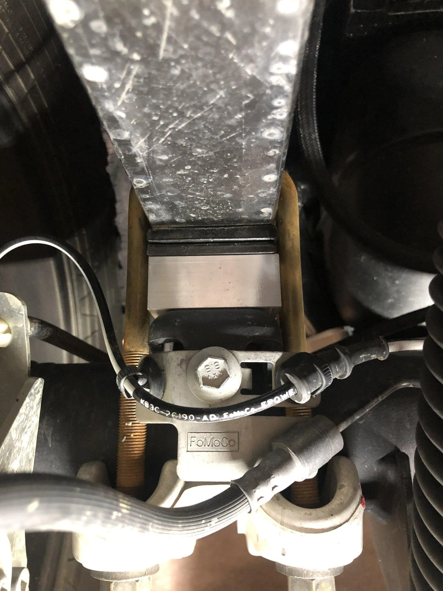

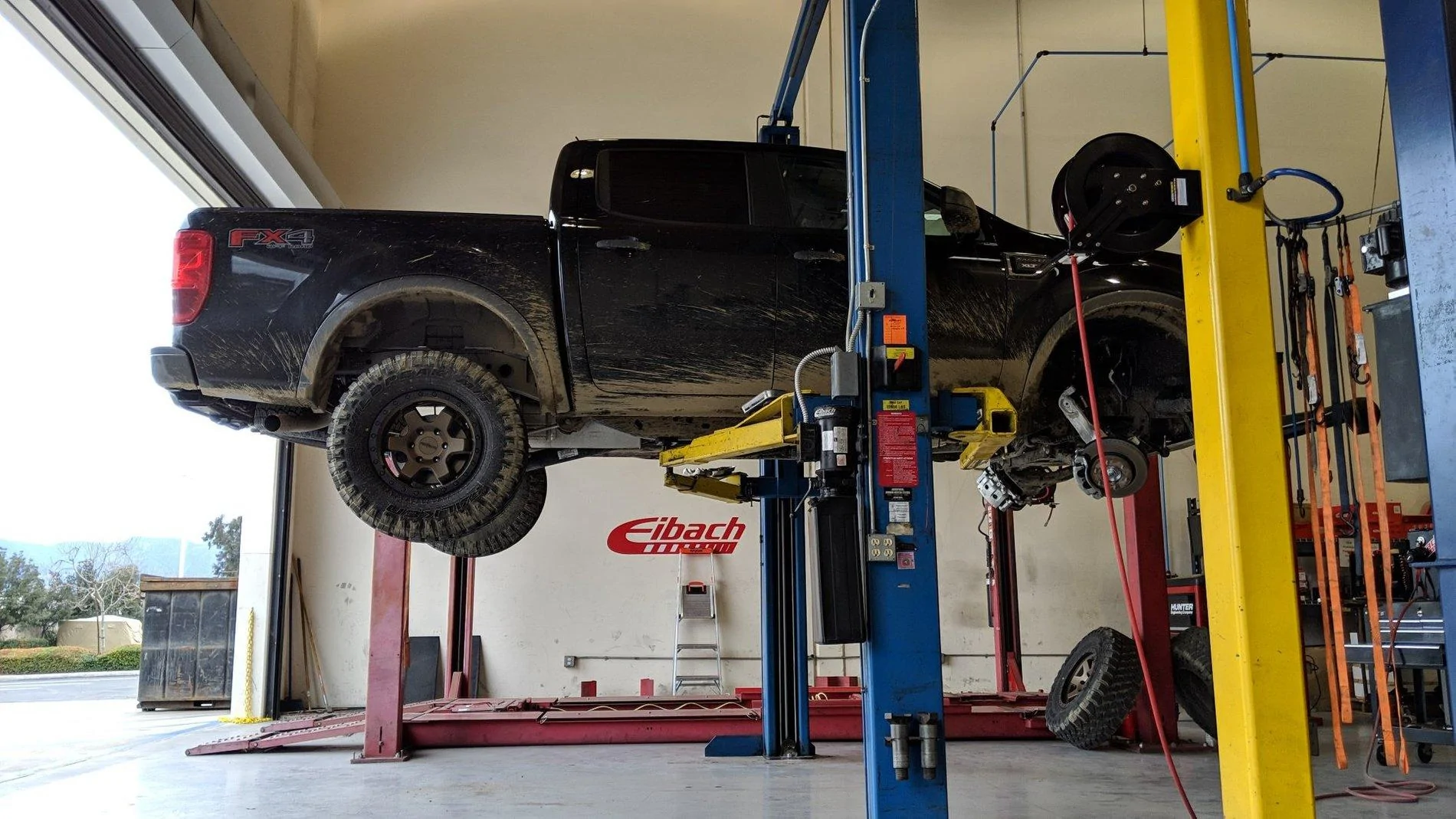

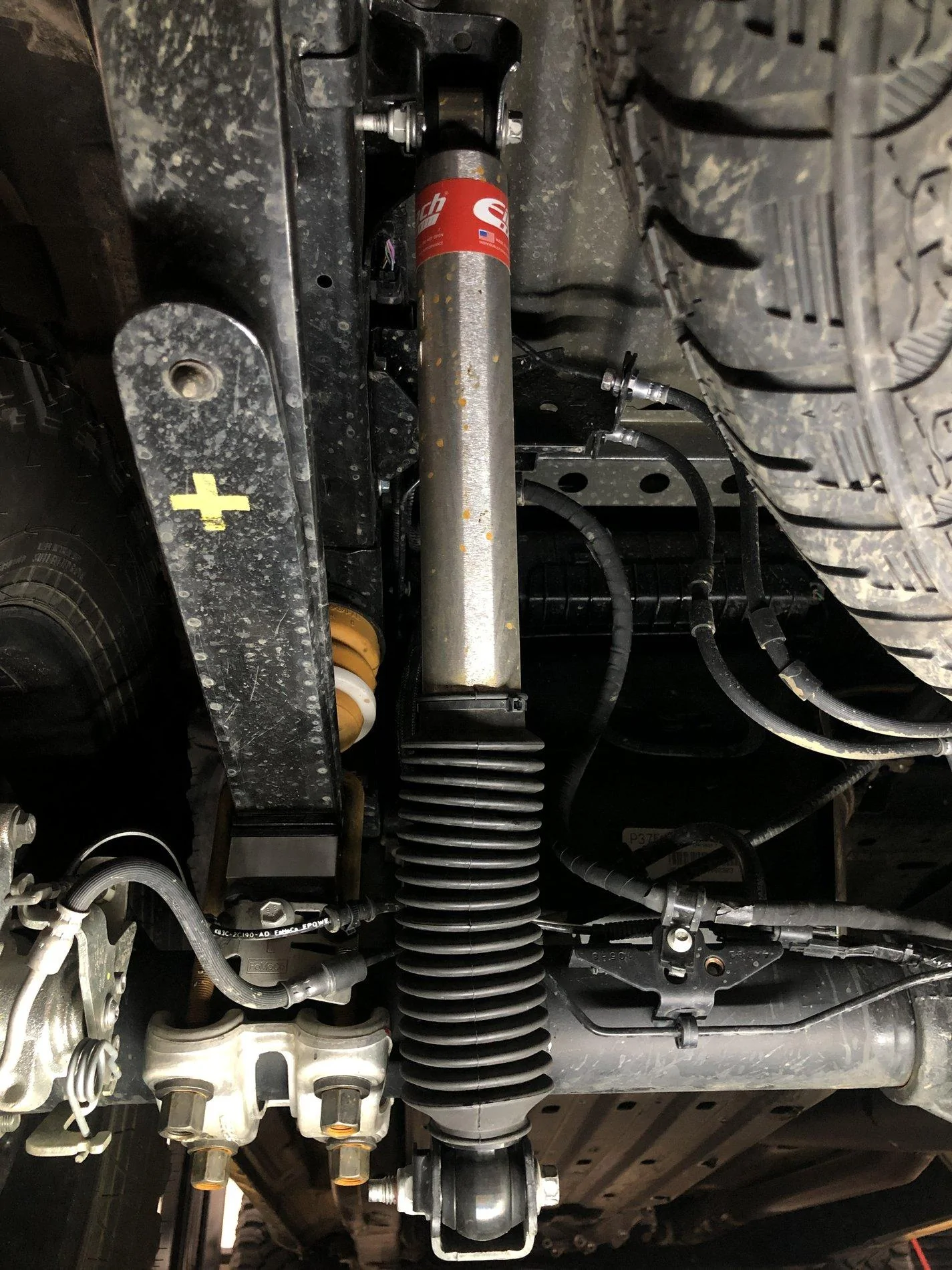

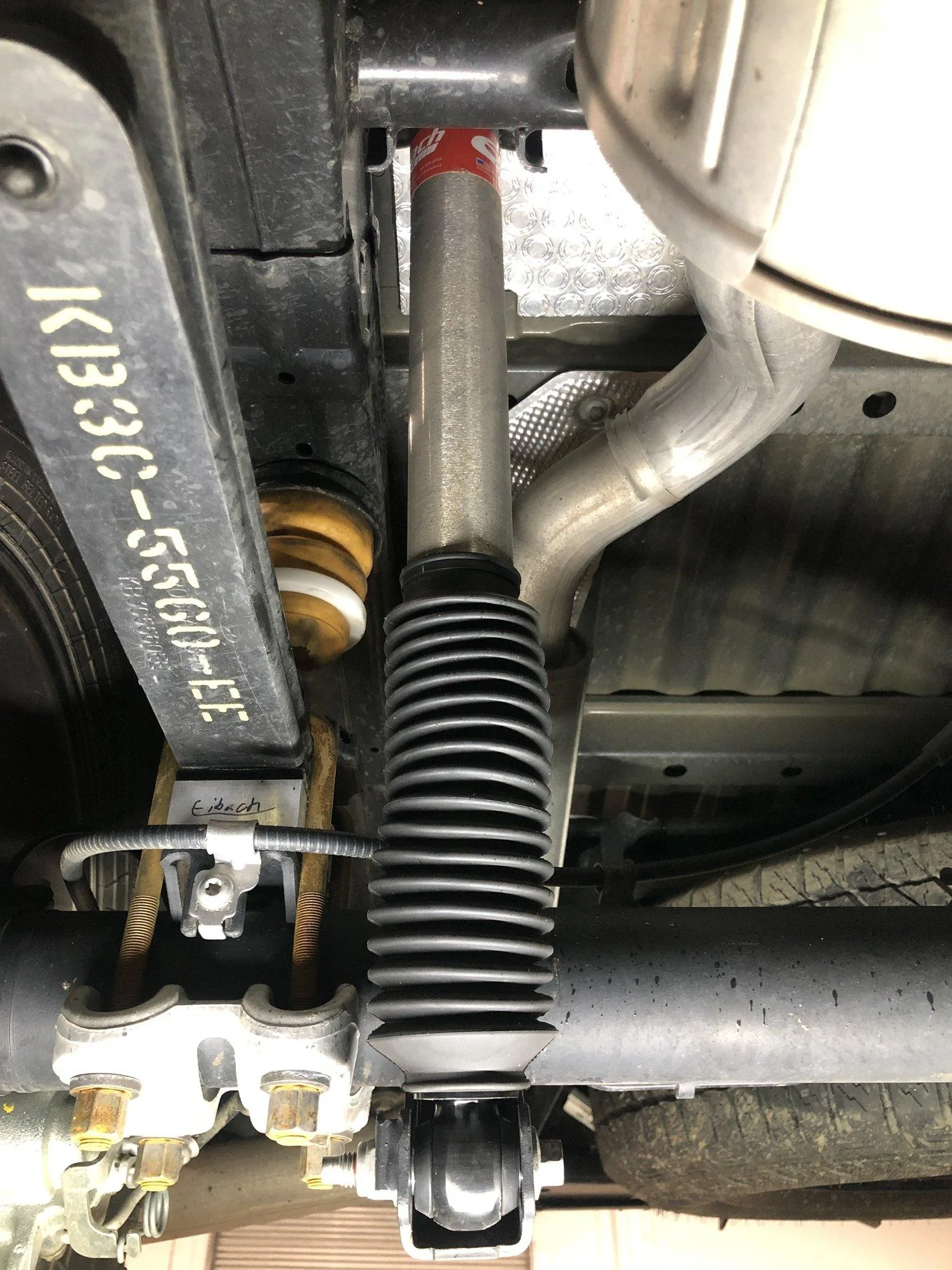

Keep in mind these are still the R&D components and that is the reason for the in coated parts having surface rust.
Eibach currently has my truck and is developing a lift kit for our beloved rangers.

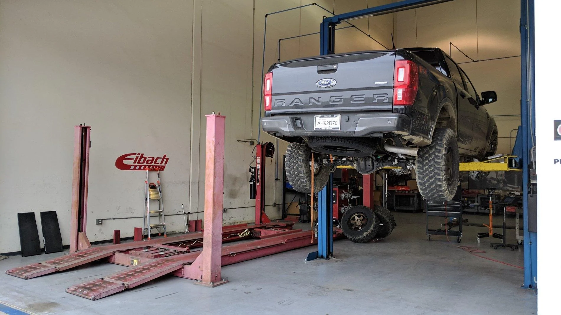

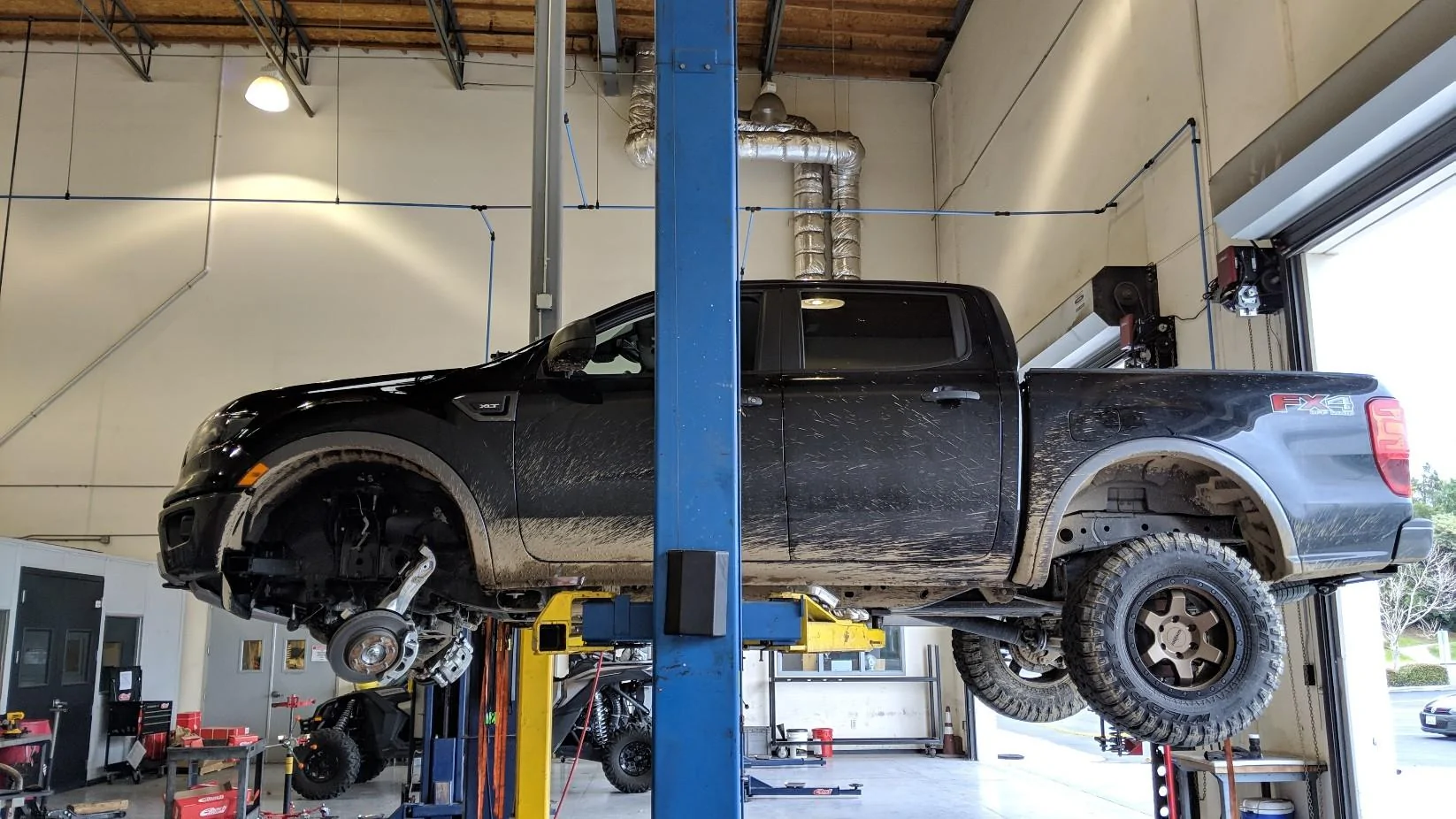

I know it's unsprung, but I really like the appearance of the rear wheel and the clearance to the fender when it's on the lift on the passenger side picture (is it just me or is the driver side tire quite a bit lower?). I don't suppose you could grab a clearance measurement of that for me, could you?
I won’t be able to, I’m about 50 miles away from it.

Eibach added a reasonable amount of hard dampening to the front and soft to the rear shocks. The spring used in the front lifted the truck 3” and they used a block to lift the rear of the truck 1”, which created a very level appearance to the chassis. It actually feels like a truck now, steering input and feedback is much more truck like. I felt like the oem ride was soft and limp in the front and overly stiff in the rear giving it a minor off balance drive.

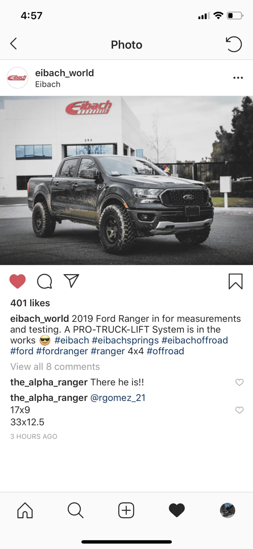

Looks great, can you post your tire rim combo and size, also is there any rubbing and is the crash bar removed?

Updated my original post with pics of the R&D components. Enjoy

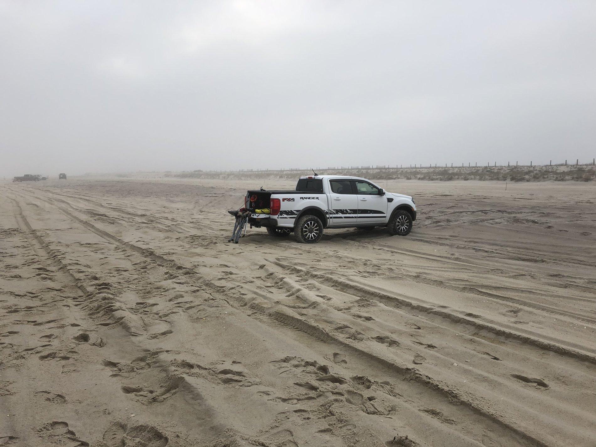

My family and I do a lot of Beach 4x4 fishing here in Long Island.
That includes powdery loose sand, deep ruts, and unpaved areas (that turns into mini ponds after it rains lol).
The Ranger has done pretty good so far, just wanted better ground clearance, esp in front.
