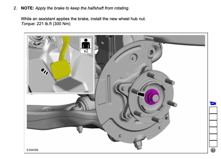

I also have a set of the Eibach Pro-Truck Sport shocks on order, and from what I understand, you should also buy a set of the nylock nuts that you will be removing. The upper ball joint, tie rod and sway bar nuts. I am assuming that Eibach will be providing new upper shock mount nuts for each side. I am in agreement that the axle nuts should be removed and the shaft tapped back out of the hub. I cut a 1” diameter length of brass rod to tap it with.
The Eibach struts do not come with new nuts for the top. I reused mine as well as the sway bar link nuts and axle nuts. I picked up new outer tie rod end and upper ball joint nuts from Ford. I used a large puller to pop the CV shaft out of the bearing and it worked great!

Thanks Adam, that information makes a lot of sense!
