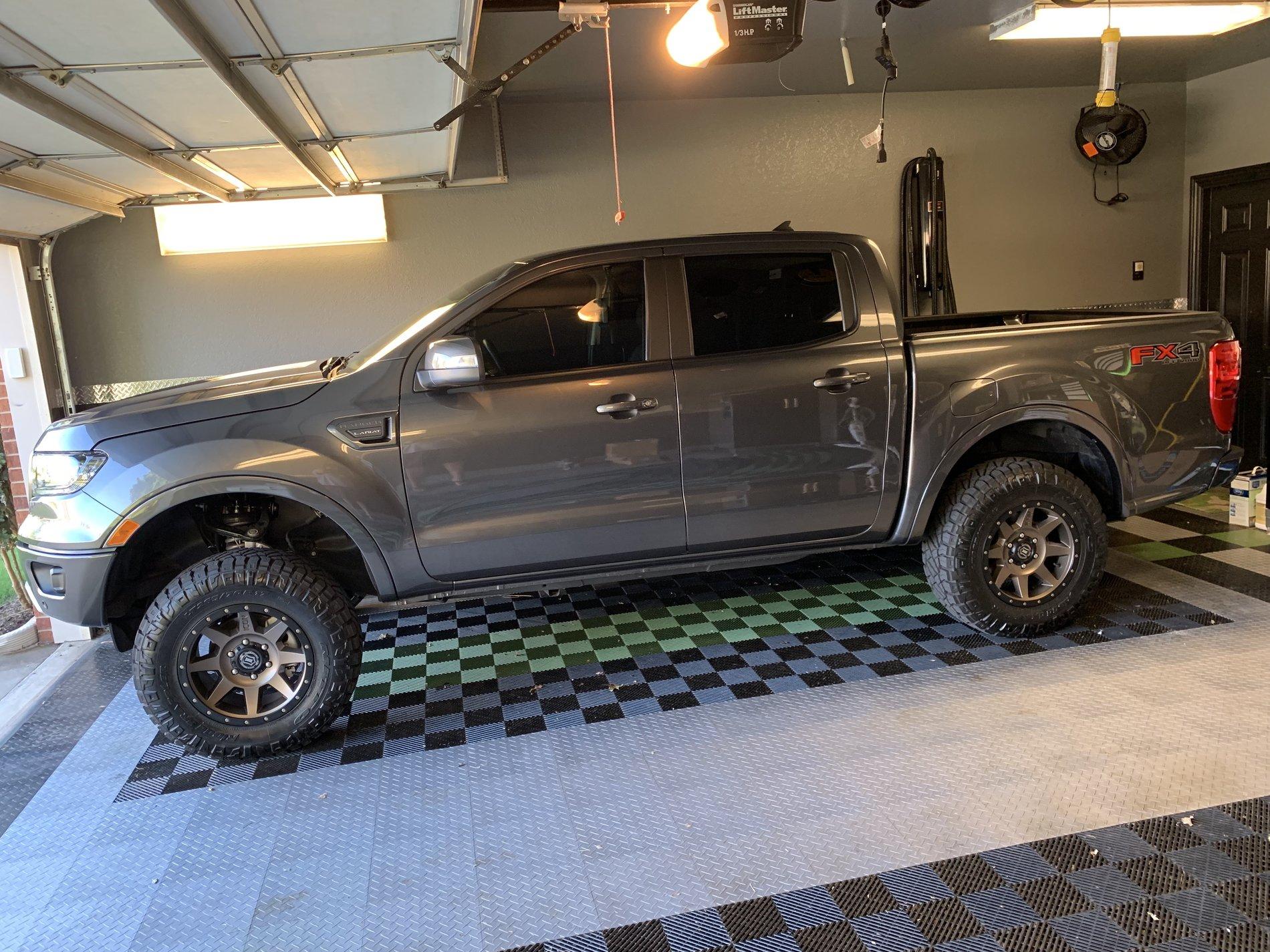

still waiting on my kit after the shipment was redirected. starting to get impatient at this point. planning on having the front set at 2.5" and 1" in the rear. My wheels and tires are getting lonely not putting them to work.

This is the full Eibach Explorer Kit. Front coil over, rear shocks and 1" block. Purchased from Peak Suspension. I'll post some more pics tomorrow with close ups. Shop removed the front crash bars but seems fine with back still on. Also removed the front "air dam" plastic fascia and I like it. Stance is sooo nice.
