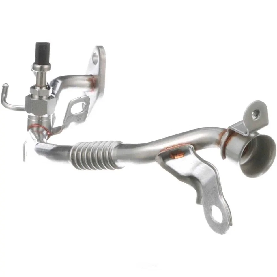

Not exact but I had to top off my washer fluid this AM and I threw a wrench on the tube at the Intake End (OD) = 3/4 In
So 3/4 in brush (approximate) and it looks like the Inside Diameter might just be big enough to fit my Borescope inside it.

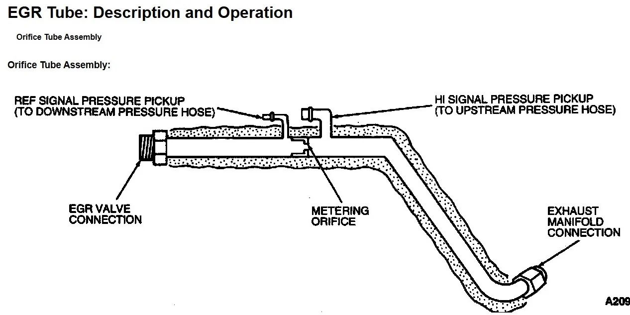

I am curious what the (Orifice) split looks like inside the tube. between the 2 DPFE Sensor Hose ports

My quick search could not find a good pic of this end (EGR Valve) connection
DPFE Hose Ports
For cleaning REF: This is a Example Only of what it should look like and may require a piece of safety wire or similar to clear the (orifice). This is why I would (if I had it apart) put my scope in the tube to get a visual on it or if replacing cut the tube open as if I was actually pulling it off, knowing me would have a new one already to install.
Ref Only - Not actual tube
This is only for showing the presence of the Orifice and what to expect when running the brush through the tube.

Well that's quite the challenge! And clever engineering...
That first 90 degree bend will be the toughest. I'd use a smaller diameter brush and a bore scope to confirm it is doing the job. Ned to go at from both directions.
