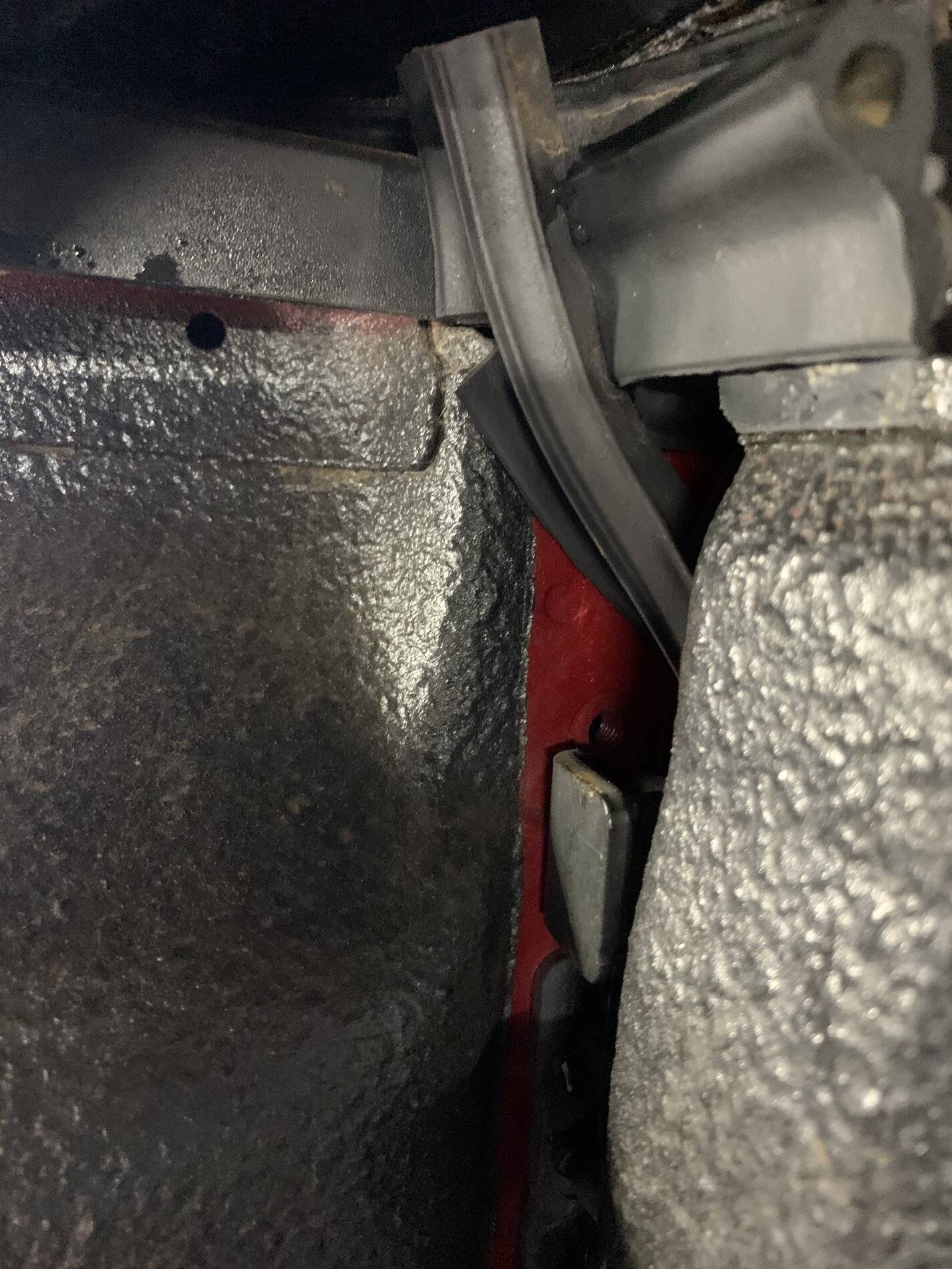

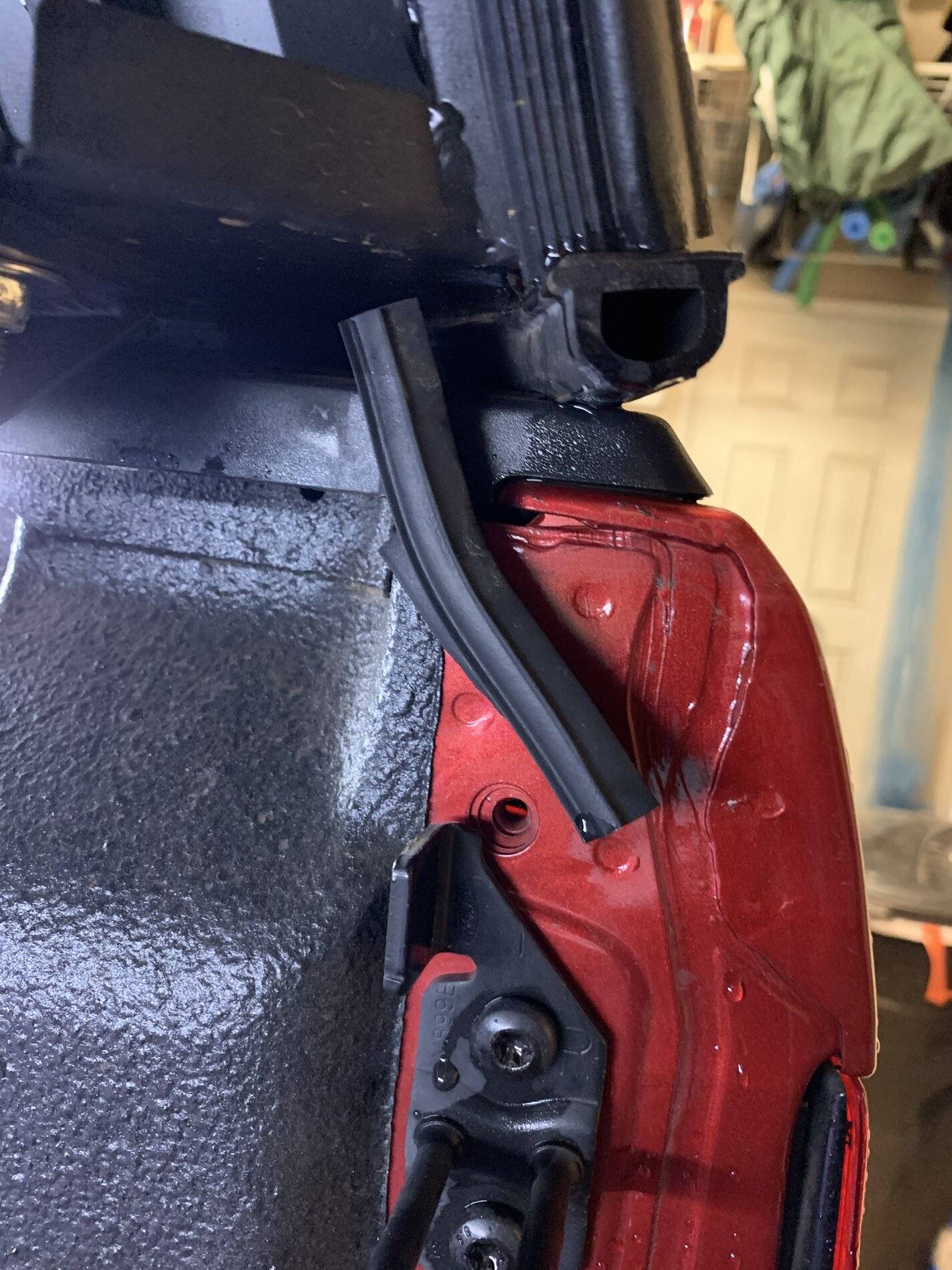

I use this one too but I was still leaking in from the top of the tailgate so I modified a piece to sit like this to rechannel the water. Also keep in mind that there are holes in the front corners of the bed that also causes water and dust to get in.
You are not wrong about the other holes causing problems but I still believe that the tailgate is the major problem to say the least. Some tape can fix the other holes in my opinion
