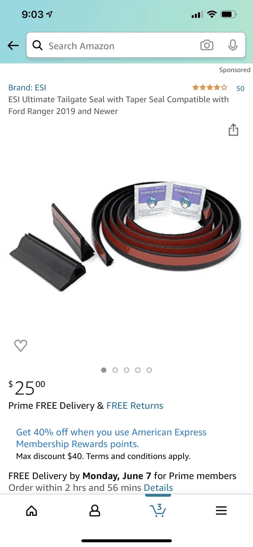

I ordered the ESI Ultimate Tailgate Seal from Amazon. Scheduled to arrive first of next week. I’ll get it installed and report back.
So I have this one and I can say that it is so so..... Dont get me wrong, it has made a difference on how much dirt and dust comes into the bed but I do t thing it is that great....

Yeah, me and @Trigganometry have that one, too, and both think it's so so. That's why I'm in search of something better before I try to 'fix' this one.
