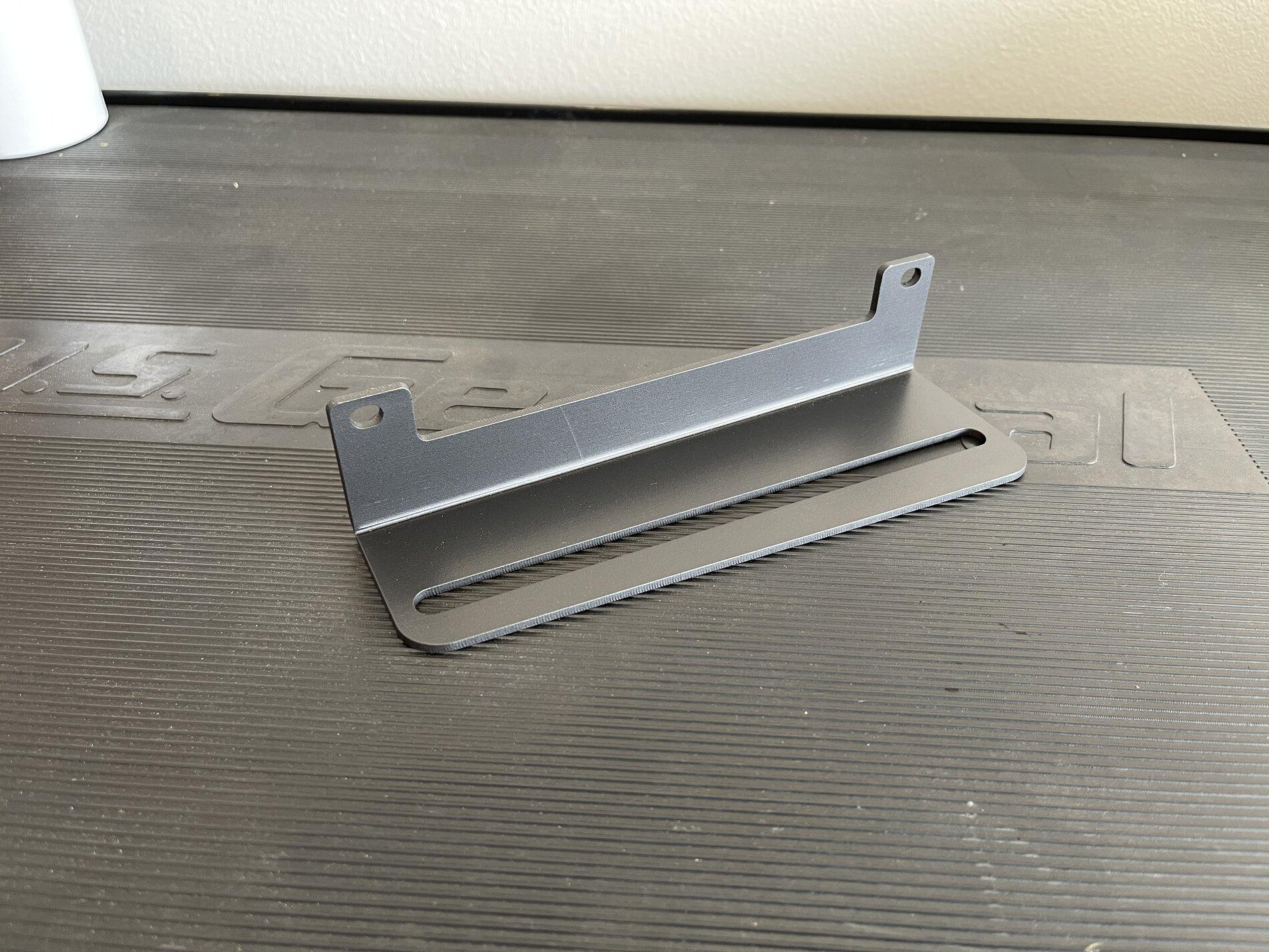

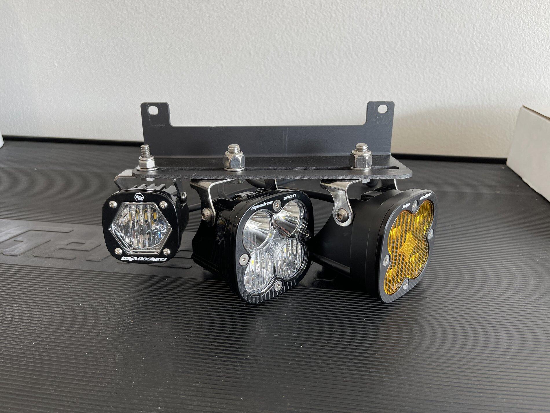

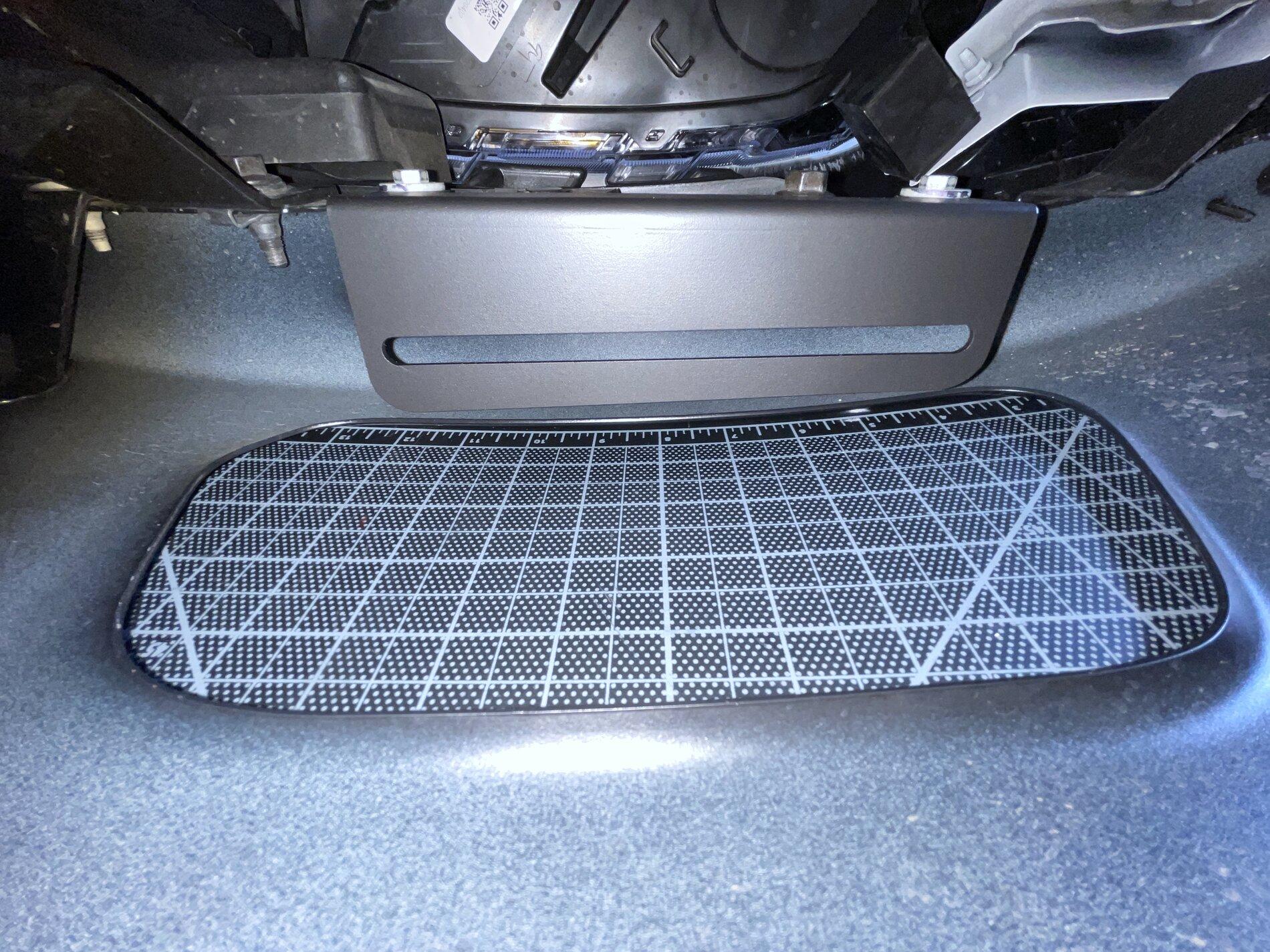

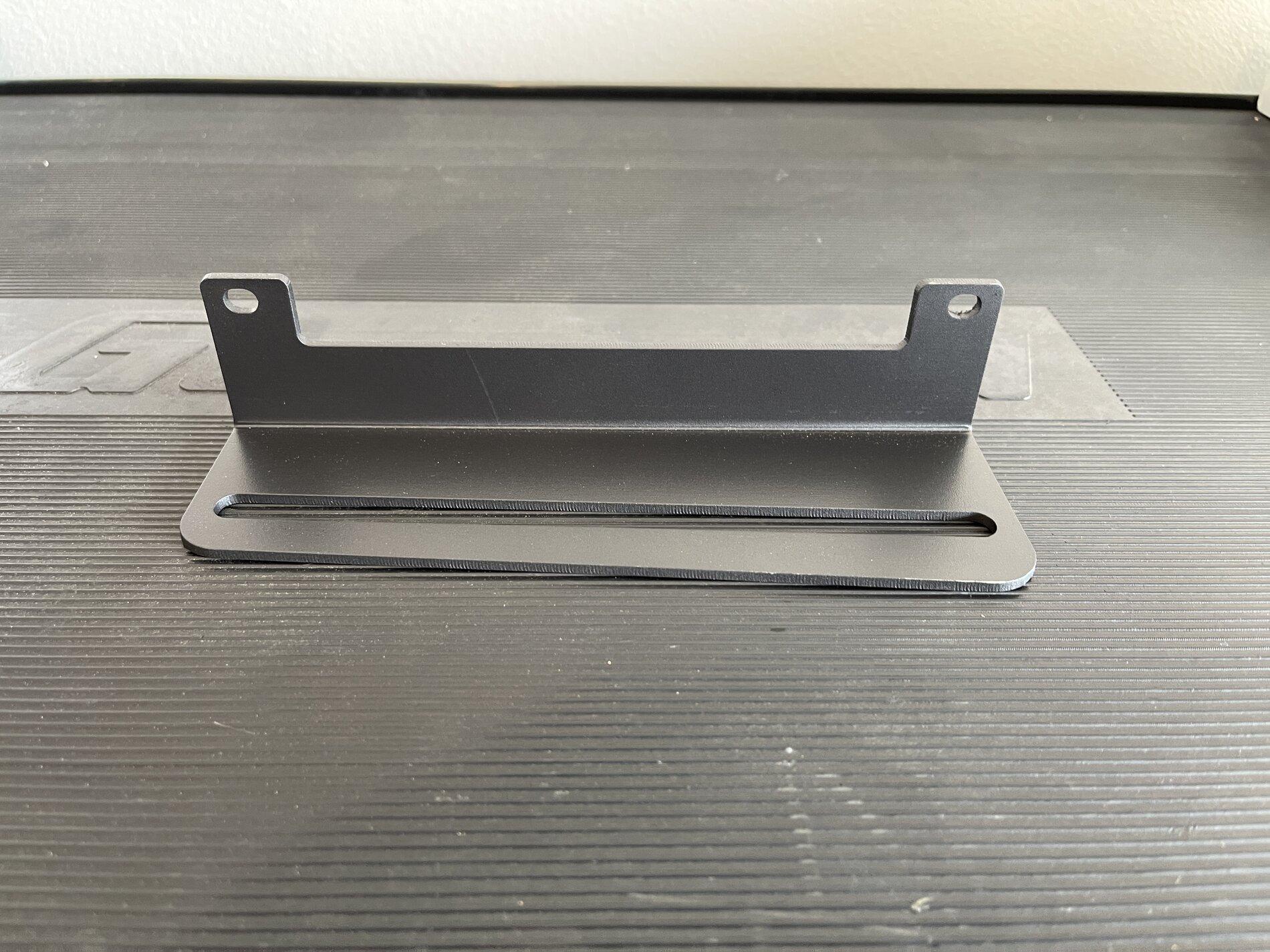

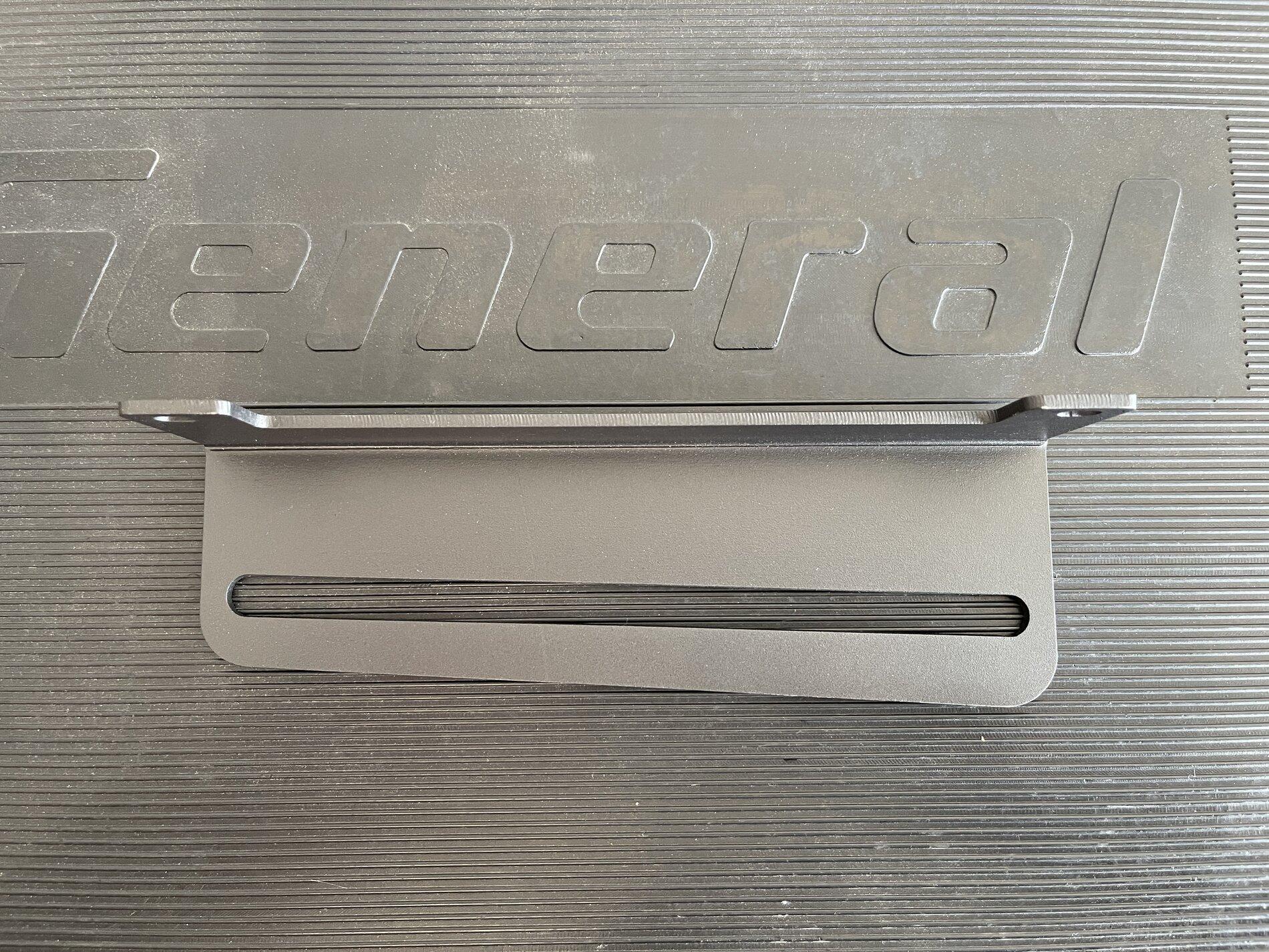

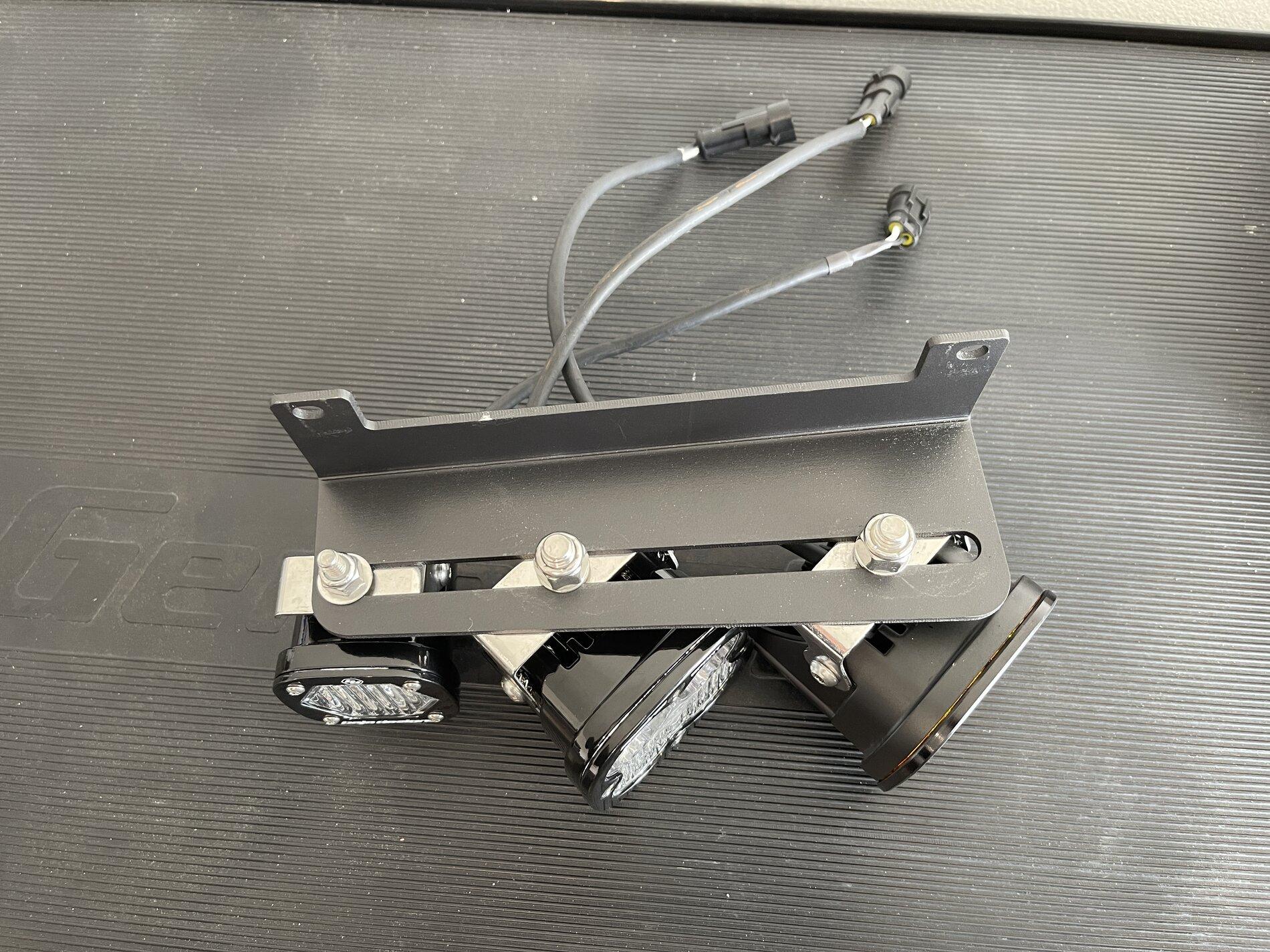

Alright everyone, here are a few more pictures of the revised bracket. Unfortunately the powder coating place couldn't knock this set out for a good price, so I used Steel-it Black to coat these ones but the "production" brackets will have a powder coated finish. All mounted with stock hardware are they are solid.
I'll put some mounting pictures here and the next post below will have a little more info as well.

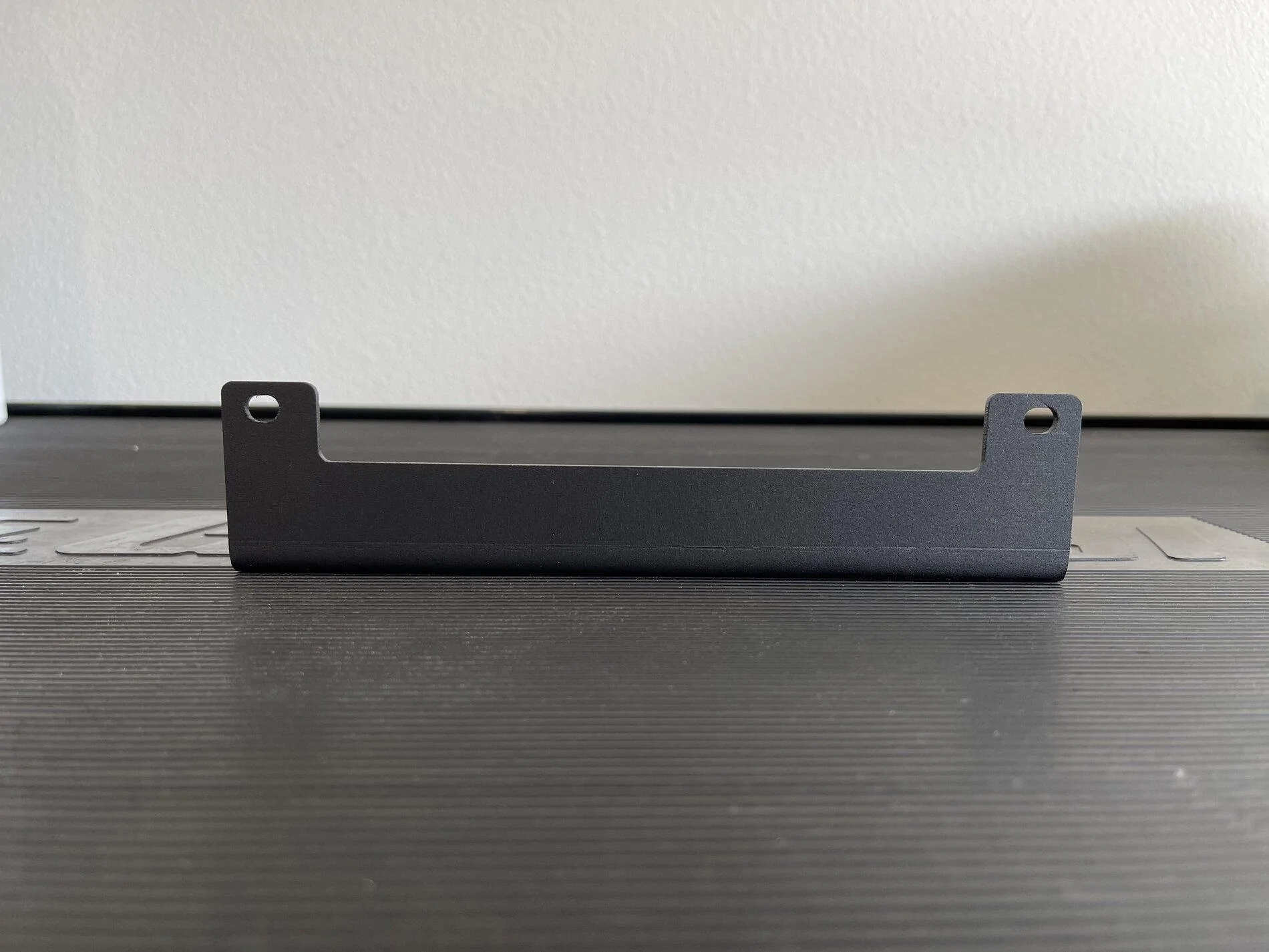

The brackets shown below are for the passenger side. The driver side is the same, just mirrored.
The wide light channel is .375 for 3/8" bolts.
Again, the material is 1/8" steel plate which is then water jet cut and bent to 90 degrees.

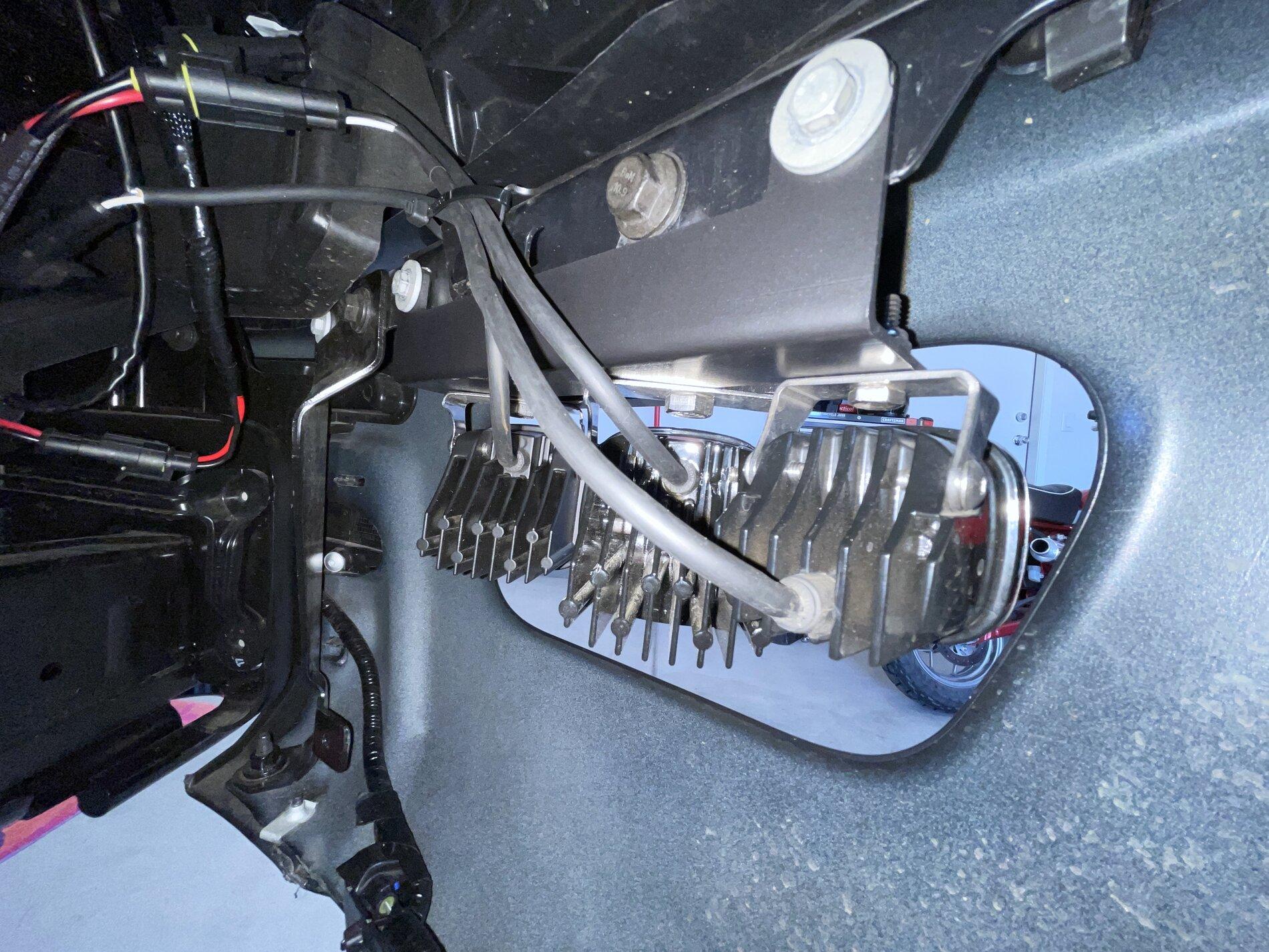

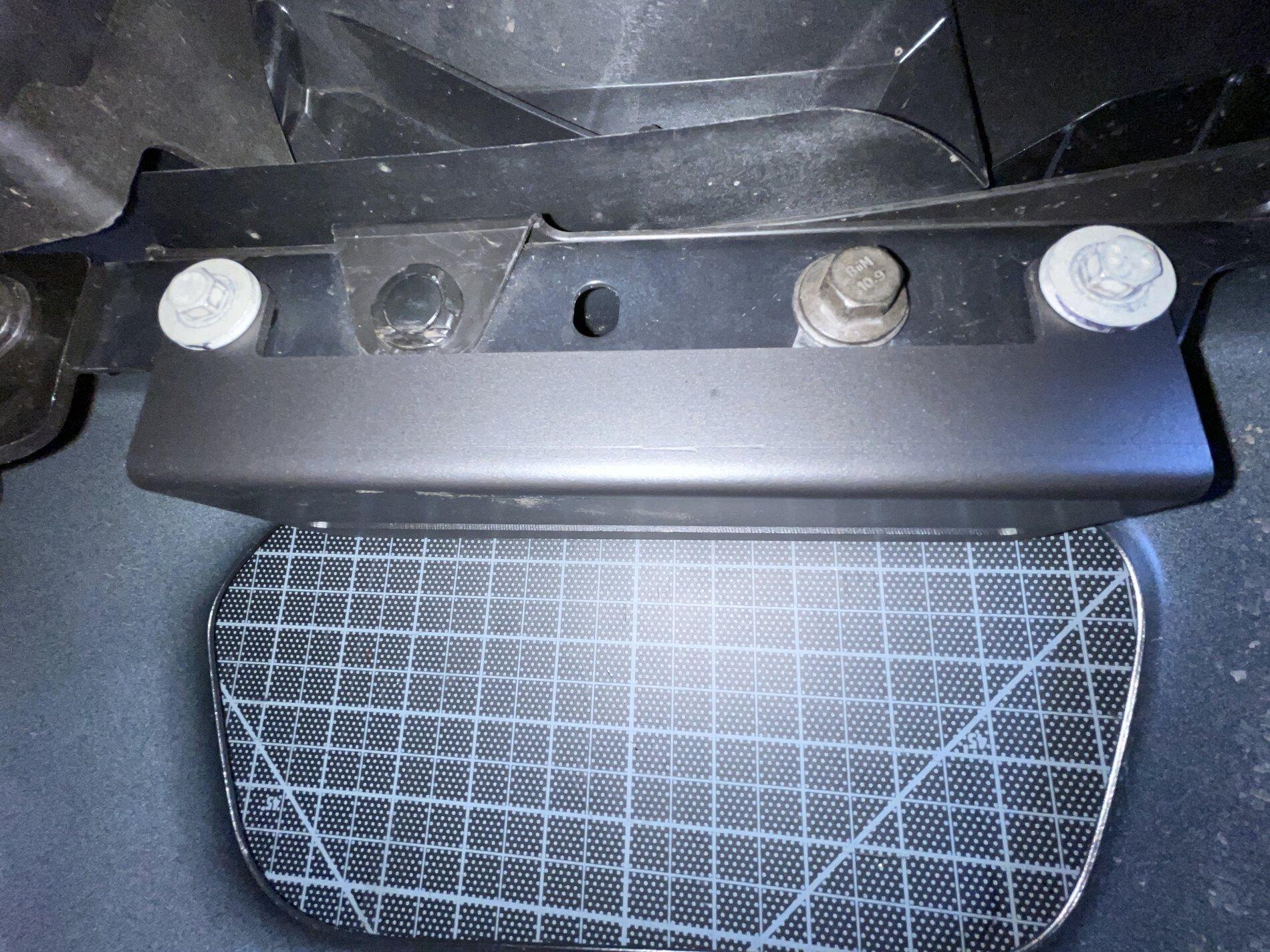

Here are some pictures of it mounted onto the bumper. This is the PASSENGER side, so the left side of the image closest to the center of the truck.

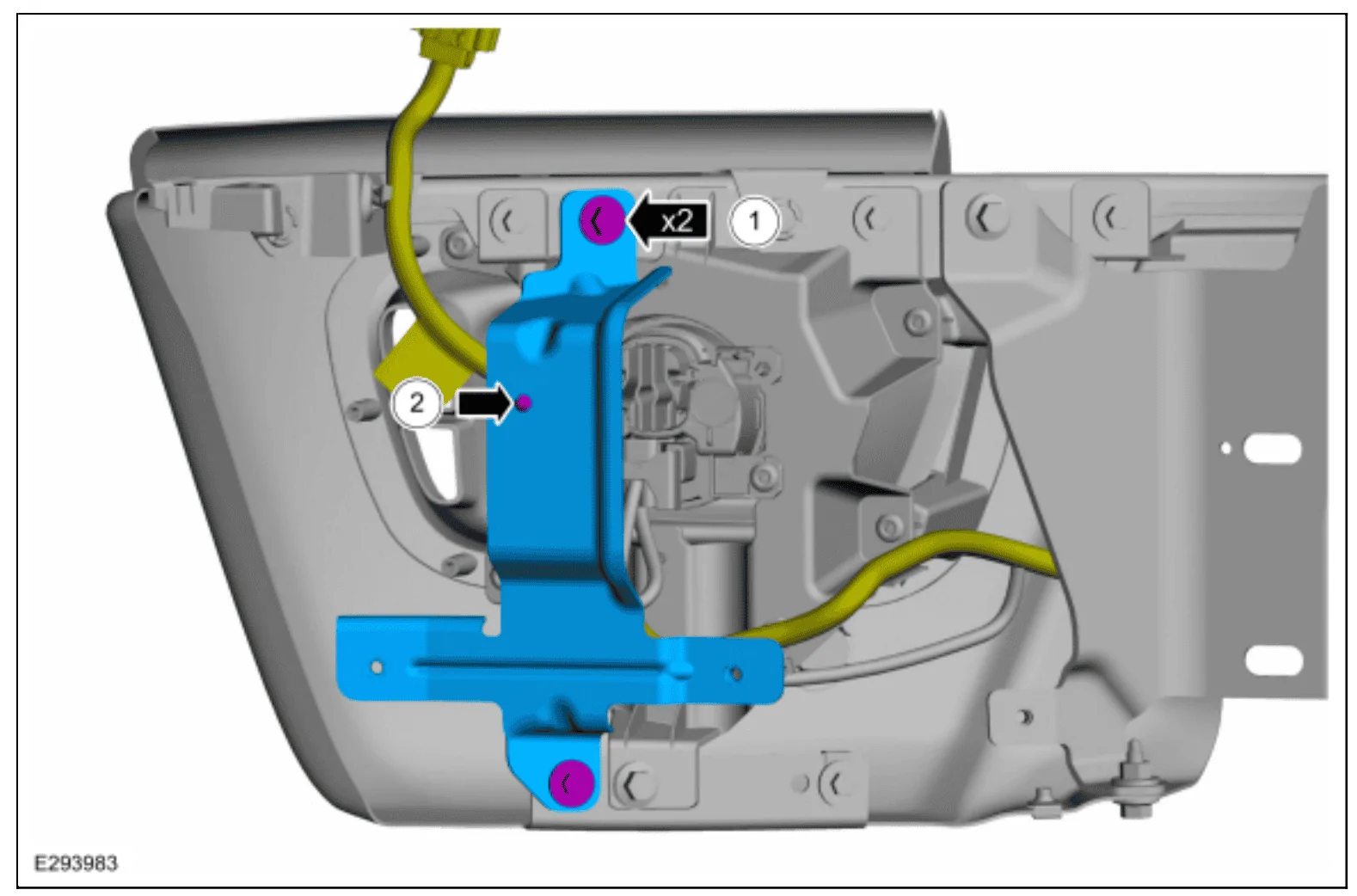

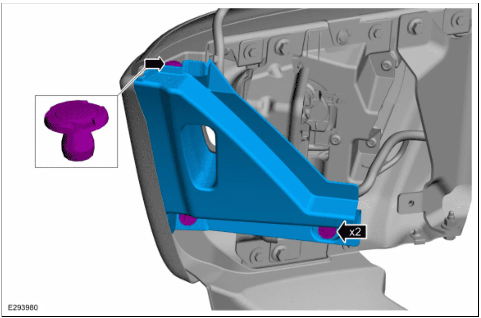

And here is some detail on how/where they mount. These brackets replace the entire OEM fog light pocket. They mount to the top two purple bolts pictured in the image below. The OEM hardware is used to mount the bracket.
The bracket and cover below can be reinstalled, but there is no need for them in order for these brackets to mount or function. They have no structural purpose. I have mine left off for the time being since I've been taking these on and off.

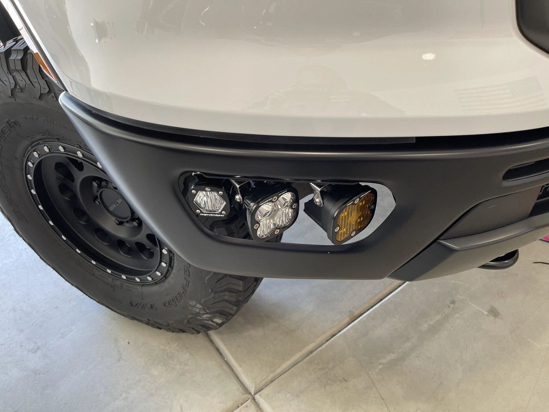

A few pictures mounted on the truck with the revised bracket. Then below that are some pictures of the light output. A few of you were asking about the light being cutoff because of the bumper being in the way of the inside light. Check out the pics below...
For these pics below, I'm standing directly in the center of the truck, in front of the Ford emblem. I'm trying to show that there is no light cut off by the lights being set back slightly behind the bumper or any distortion from the middle clear light being cutoff by the inside yellow light. I will try and get some night pictures, but night time pictures never get the full effect of the light output.
Yellow SAE output below...
White Spot/Wide Cornering with headlights (top) output below...
