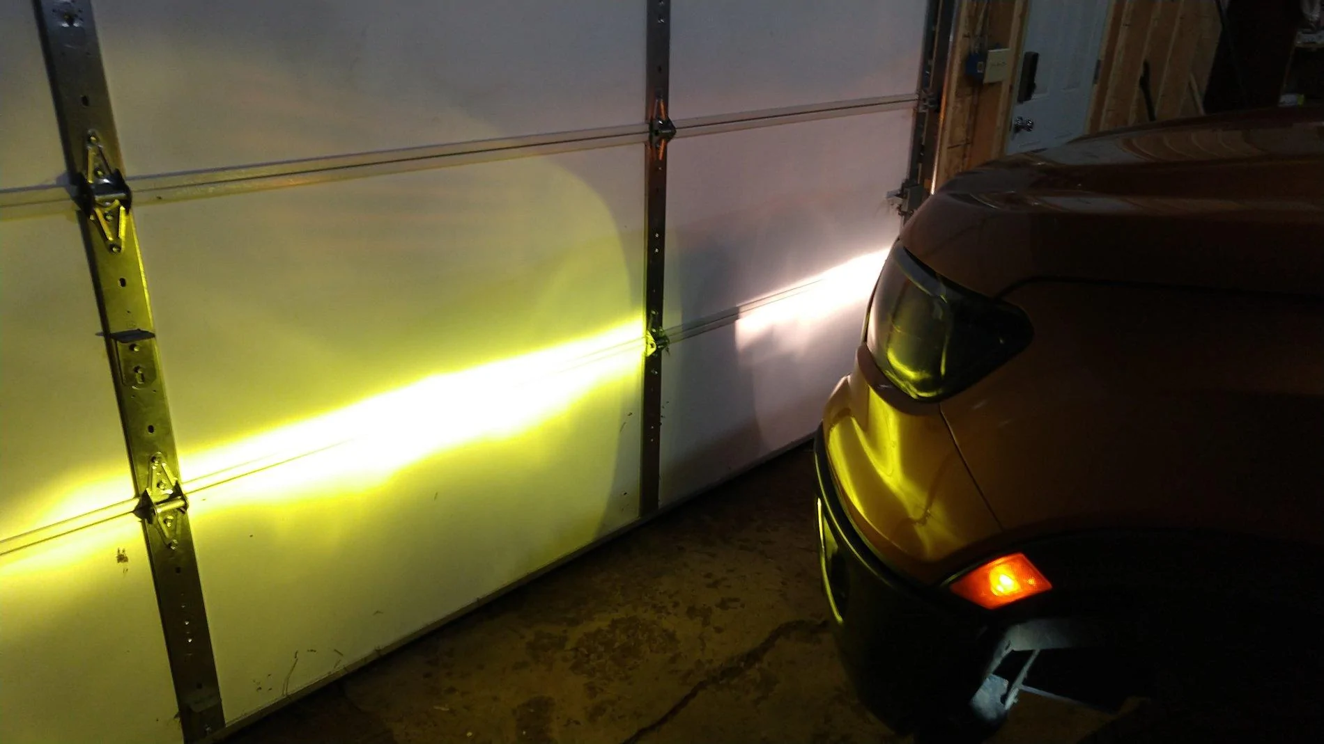

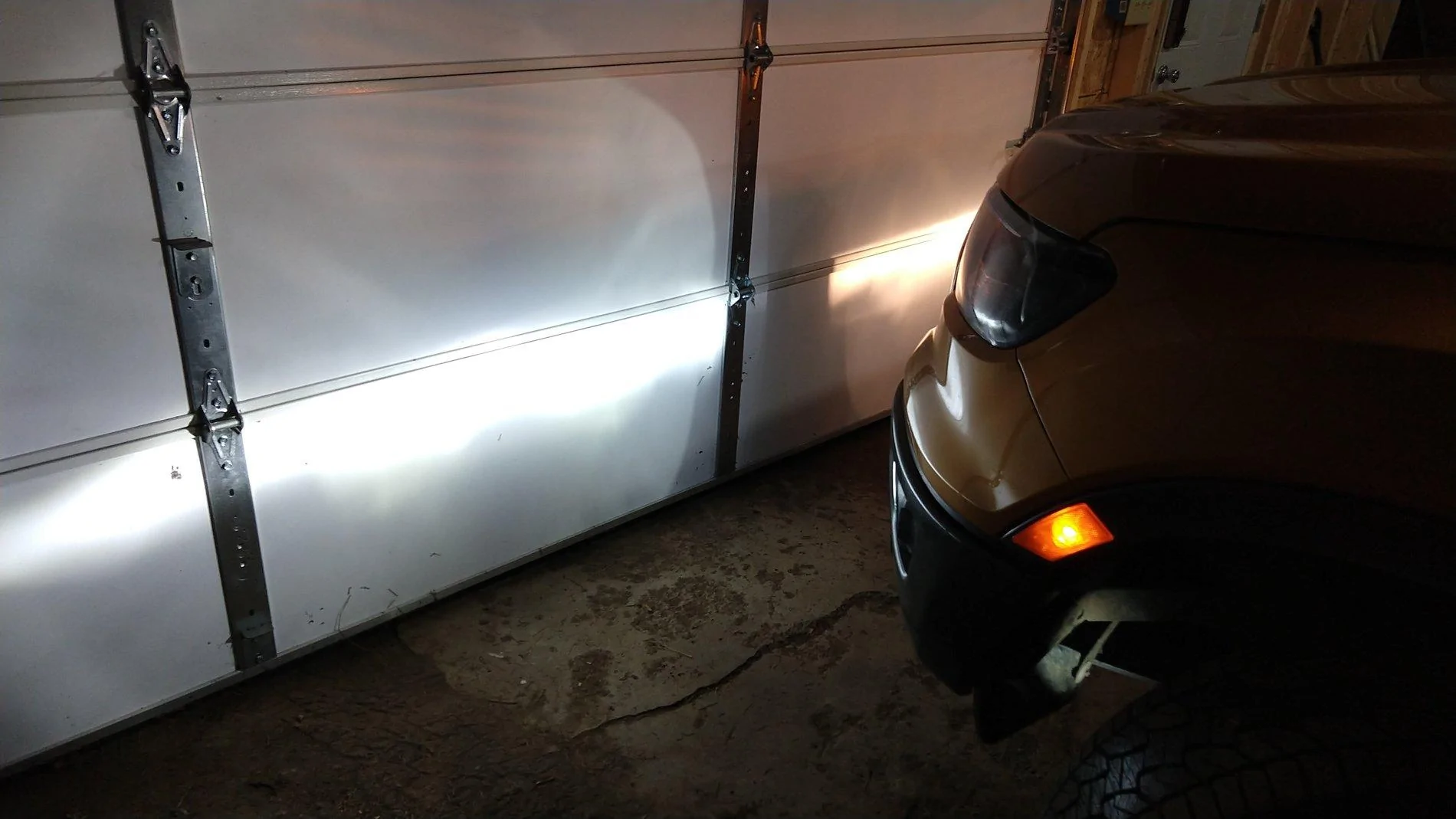

Looking at your comparison pictures again, it does appear you have significantly more scatter above the cutoff with the dual color LEDs than the OEM halogens. This is probably due to relationship of the chips vertically to the optical center of the reflector. That also explains the yellow mode being aimed higher than the white mode. another disadvantage to the dual color LEDs. Unfortunately reflector housings are very sensitive to light source size and location.
That is why it is technically illegal to replace the halogen headlight bulbs with LEDs in the US, even though a lot of us are doing it. Good thing we don't have vehicle inspection that include headlight alignment anymore.
I think I stated in a previous post that I'm not sure there's necessarily more scatter, just brighter scatter. You can see the same pattern with the halogen lights as well, just not as bright, since those bulbs are not as bright. But I could be wrong, it's been known to happen. The "hotspot" for the LEDs are the same size and shape as that of the halogens. The yellow is higher and the white is lower than the stock halogens because of the chip placements for sure though.

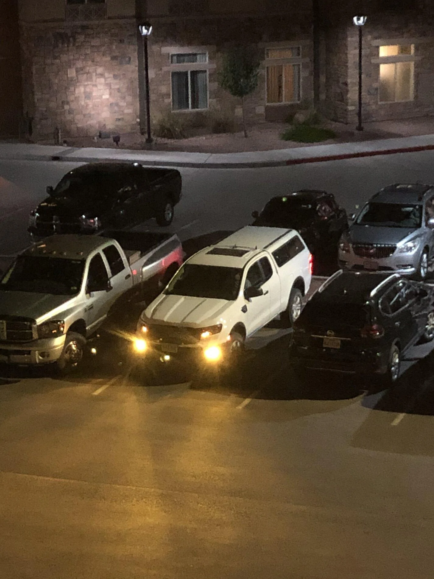

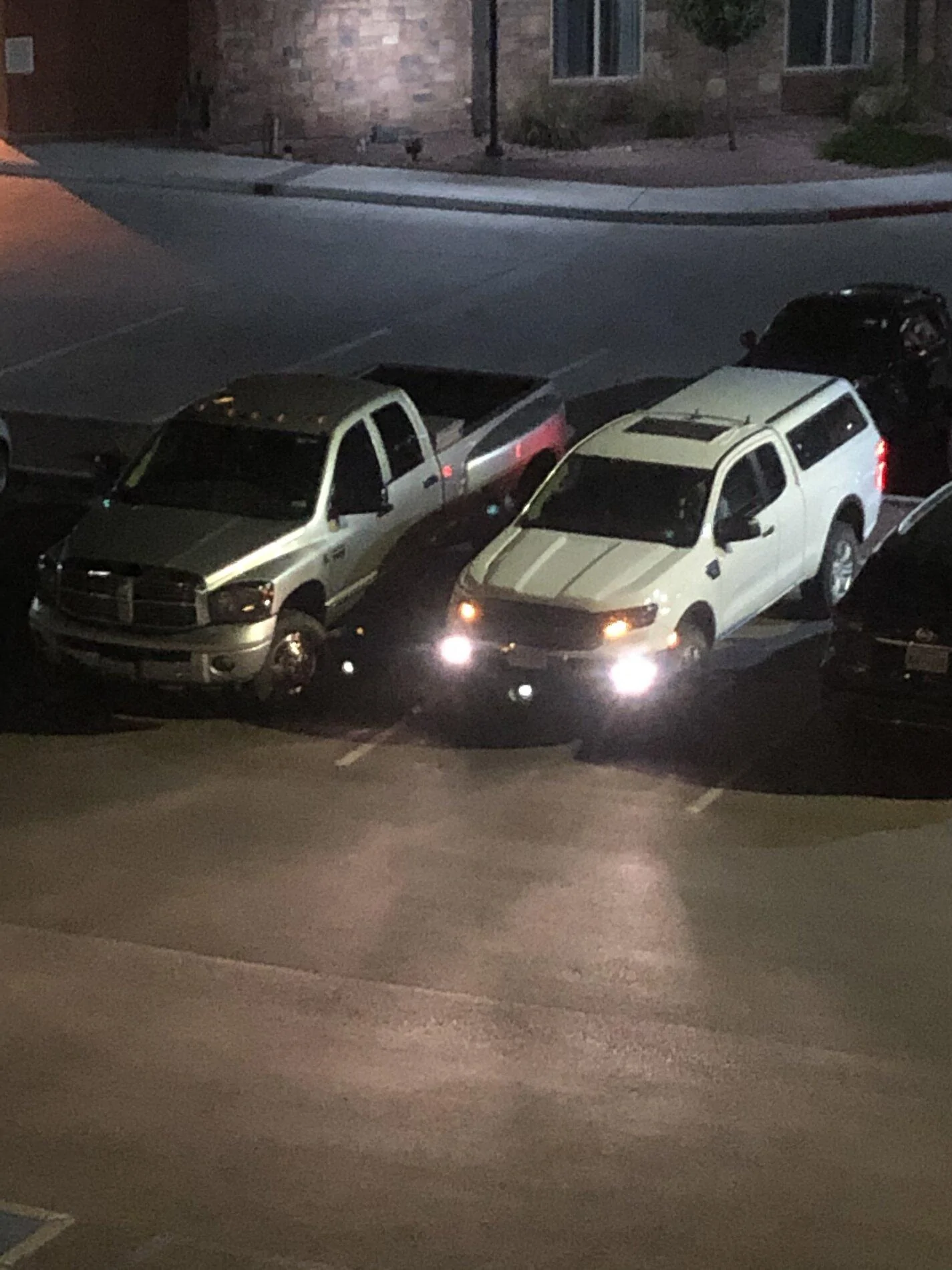

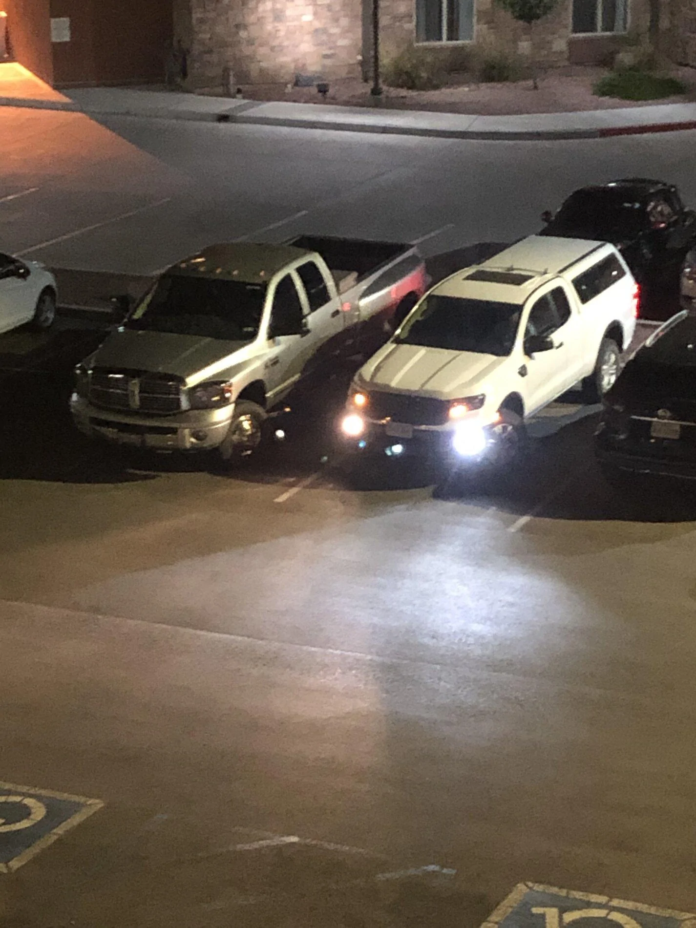

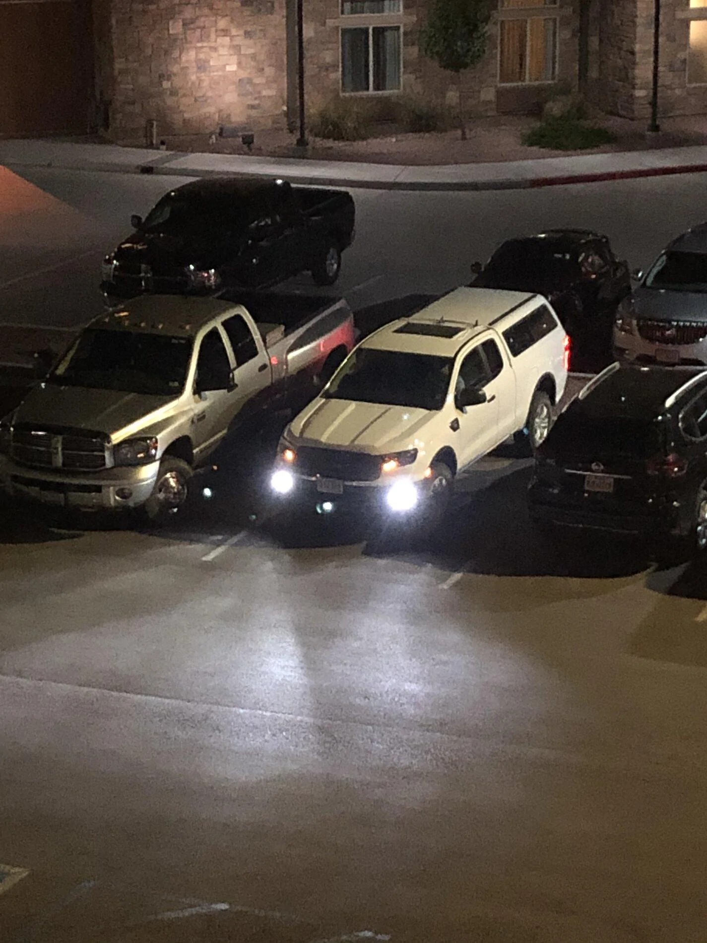

unfortunately, i dont have a garage to project on, but i had my wife take some parking lot photos from our current spot. here are the results, for folks interested in the light pattern.
first photo, below: stock halogens
second photo, below: passenger stock halogen, driver ALLA LED fog on white setting. the LED seems to have a slightly cooler color and looks brighter on the pavement.
third photo, below: both fog lights now with the LED replacement, on white setting
fourth photo, below: now on yellow setting.
all told, im happy. they seem a little brighter. and while im not sure, i think they have a slightly wider spread, which could help with trail and cornering visualization. ultimately, i think the proof is in the pudding. we'll see how they work on the backroads.

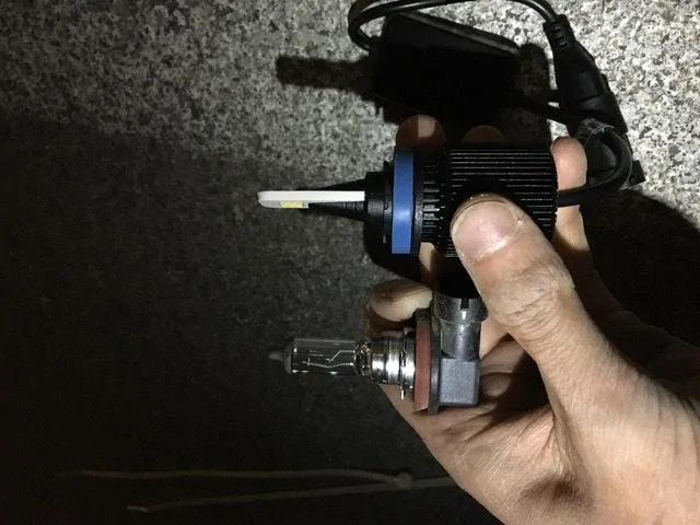

tips if anyone wants to repeat this trial: in terms of putting these in, you need to switch the stock silicone seal for the provided one. the stock seal is lower volume and compresses easier. i tried for a half hour with the seals provided with the LED lamps and failed to get it to work. although with the skid plate and plastic wheel air dam off you might get enough in-line push to get it on the provided seal. or you might be stronger than me(!).
second, putting these in its still a tight fit. there is no bulb cover like for the low/high beams, but its not a lot of room. the wire out the back of the heatsink assembly gently touches the innards of the car, cant remember if its the crash bar or plastic paneling, but it makes it a little awkward to finagle it into the slot compared to the low bulk right-angle halogen stock lamps.
finally, the LED lamps here come with an external driver, and about 8" extra length of cable. this would dangle and bang around unacceptably, so i ziptied it to the crash bar, with a shim of closed cell foam between the crash bar and the wiring/driver. without that i doubt these would last a week or two unless you're only on the pavement.
thanks again everyone. ill report back with real-world experience a little down the road.

So far they work great. Both the white and yellow modes seem brighter than stock. I have spent a lot of time playing with them, flicking them on and off, using the white as a poorman’s DRL, and have yet to have a single instance of out-of-sync colors which I know is something that has bothered some folks with other models.
In practice, while I do not have a good way to measure it, I think the white is similar in beam height to the yellow but that the effective visibility is better with yellow. This was a little unexpected for me.
When I have low or high beams on and add the white fog LEDs it seems to fill in the foreground and the nearby sides of the road, but the yellow does an even better job. I can’t seem to convince myself I understand why. It might be the yellow is brighter, or the beam is more uniform, or it’s higher/more lateral, or who knows.
This does make me wonder whether a dedicated powerful LED fog replacement yellow would be a better option for us, but then as we are trying out the white mode to increase daytime visibility maybe it’s better to have a white as well.
Short story: the addition of the yellow LED instead of stock halogen fog has improved my night time off-road comfort. There is a more uniform and bright wash in front of and to the side of the truck that makes squirrelly terrain easier to understand at night. The white may or may not be a good DRL replacement, but it doesn’t do as good a job as yellow at night.
