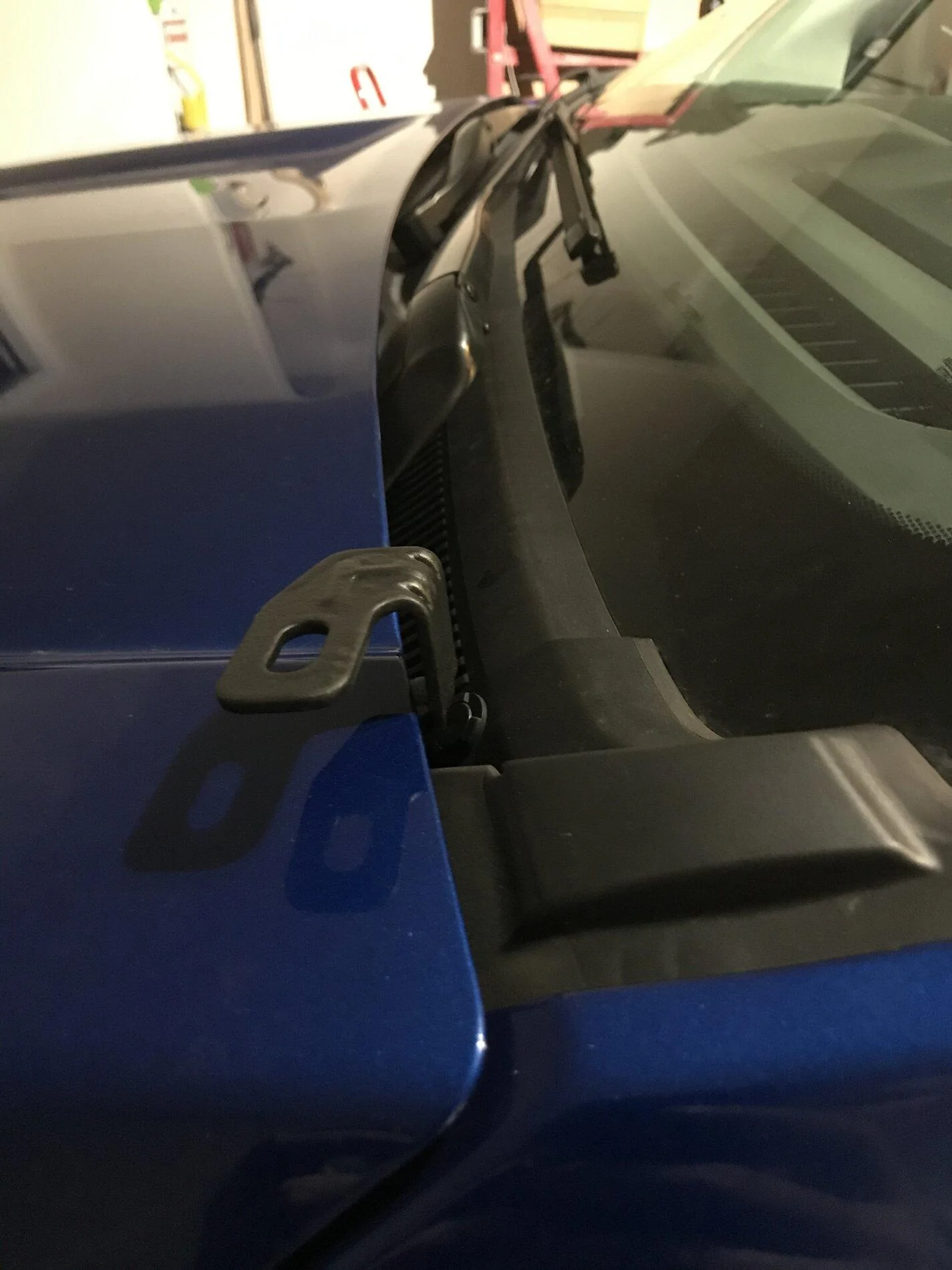

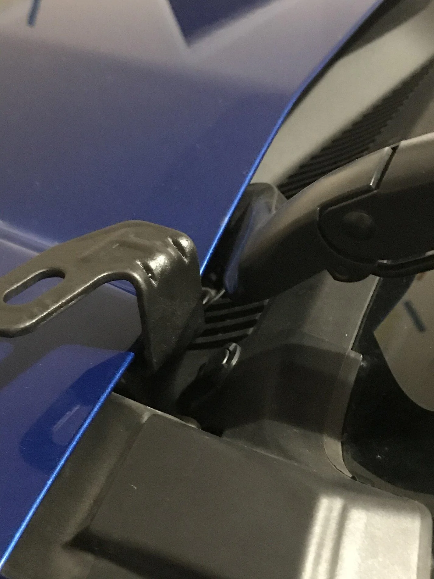

Ok so changing the wiper range would reduce wiping 2 in her on the bottom and 4 inches on the top. Not good. So I cut and 2 inches reweld it. Fits like a glove.

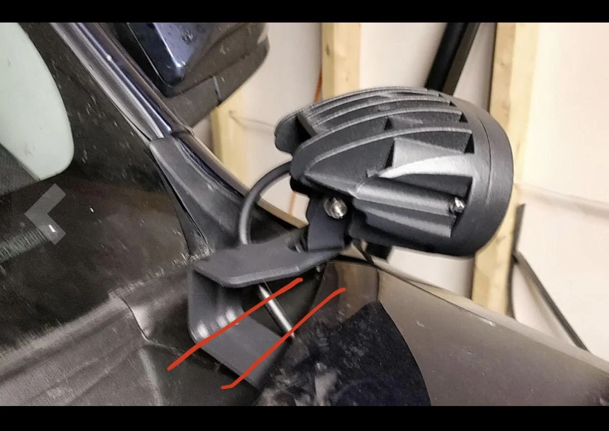

I'm sorry, I don't quite understand what you did. Did you have to modify the brackets to get them to fit on your Ranger? If so, how and what did you do, and do you have any pictures of the modifications? I'd be interested in seeing the whole bracket if possible. Do the wipers interfere with the brackets at all? Thanks for any help that you can share.
I removed about 2 inches
yes I cut out inches from the bracket to bring it closer to the hood. I do not have before/after photos of what the bracket looks like. If you look at the photos in the thread the modified bracket sits about 1/4 in from the hood lip. They will not interfere with the wiper any longer. I took a photo from Amazon to help. I cut the bracket at the red lines and re-welded to shorten it.
