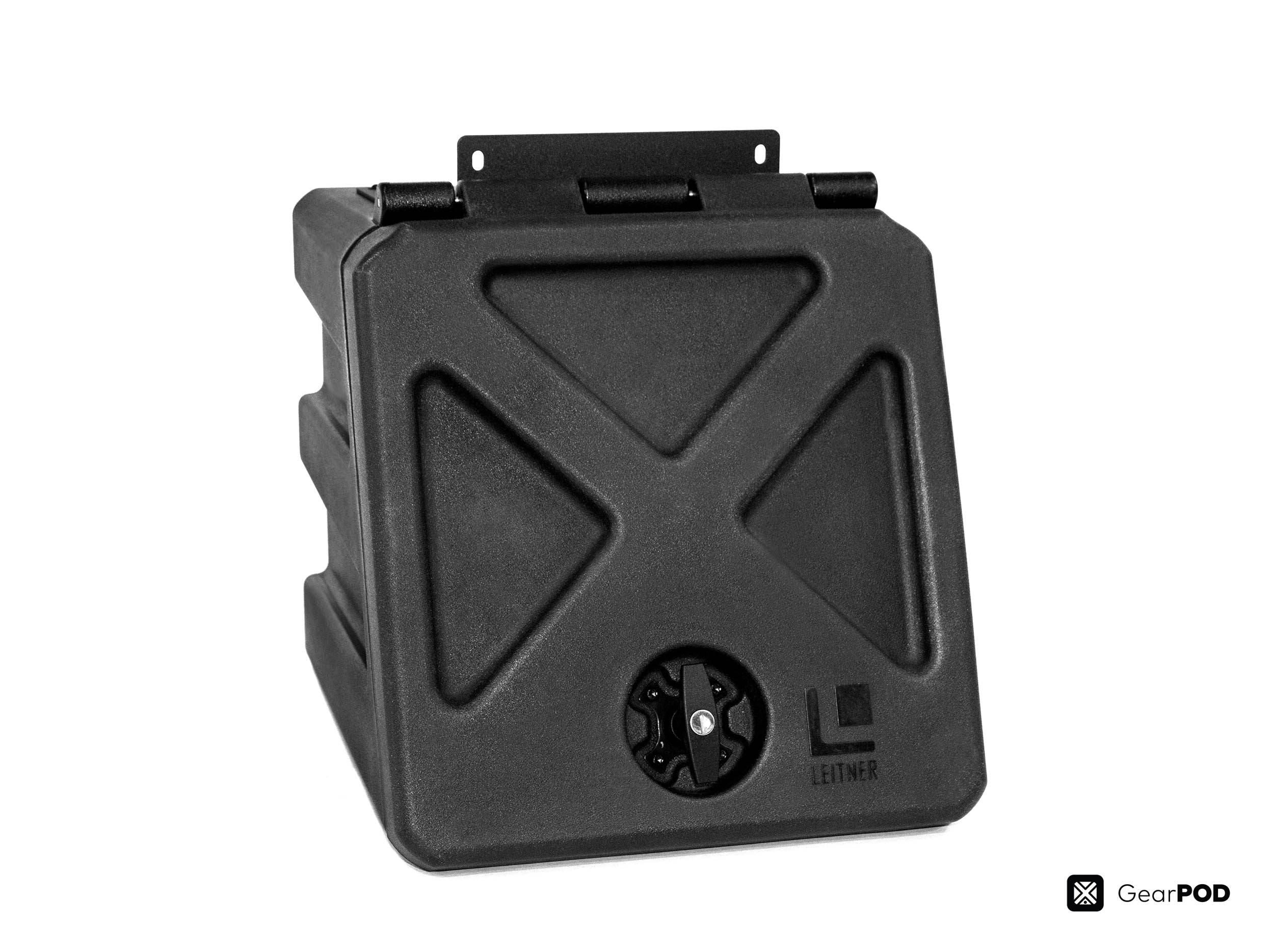

Hello everyone, wanted some pointers and advice on a project I'm going to start doing with in the next month.
So I purchased the Lietner Rack and love it, and was thinking up purchasing a single pod and running a dual battery setup with solar support. My fear is the elements ? Any suggestions

So essentially I would like to put 100ah lithium battery , dc to dc charger , fuse block inside. Pretty much all my components in this box that attached to the bad rack . My fear is the elements getting in and destroying the component.

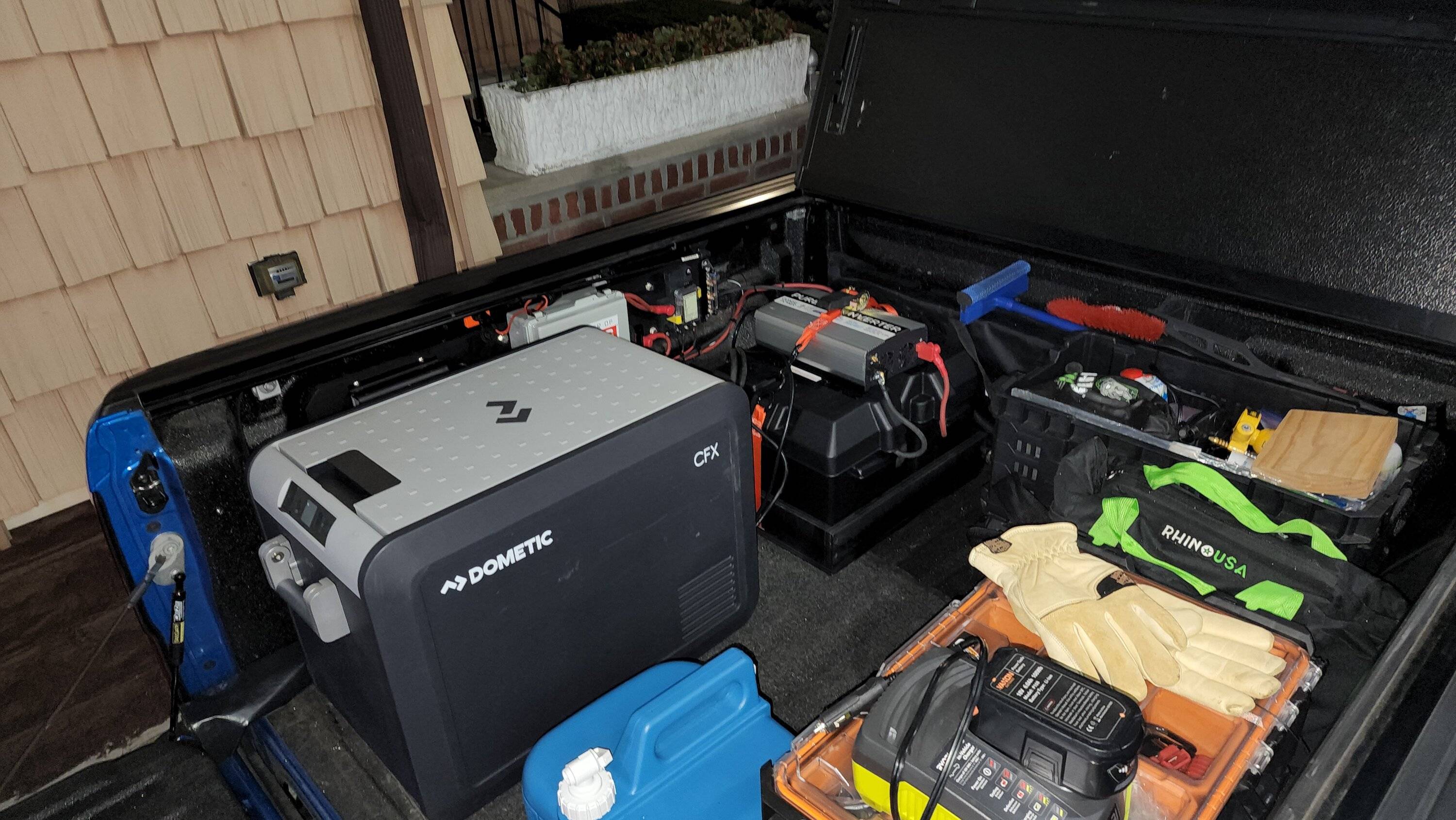

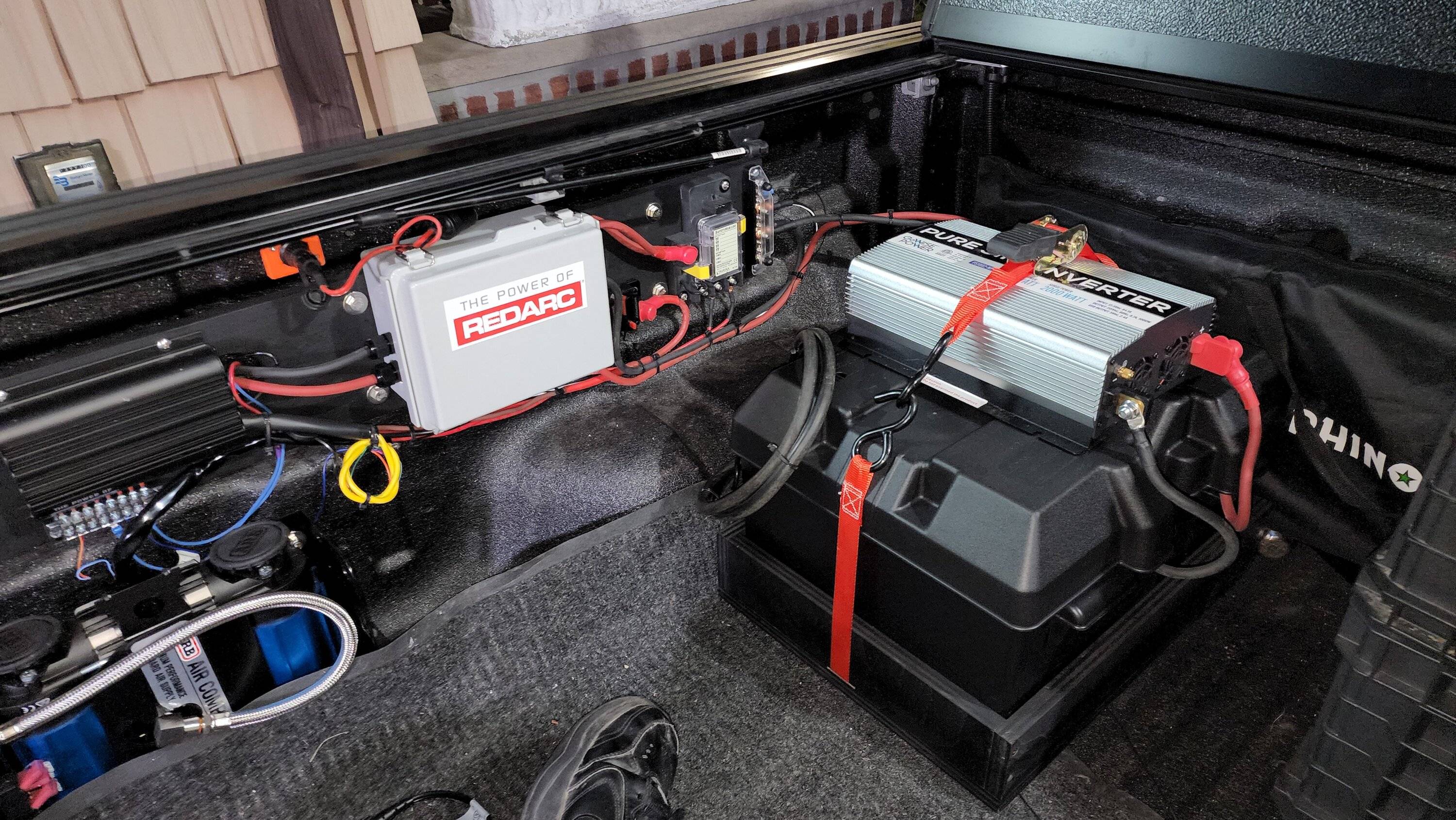

Fwiw, here's what I did....
4 awg cables run from up front coming through the factory opening.
I attached a ¾" plywood backer board to the side using riv nuts.
Anything sensitive is in a sealed box or component.
Inside the grey box are bus bars and a 60 amp breaker
I have two 100Ahr LiFePO4 batteries in those two boxes that sit in a removable tray.
That inverter is not protected, but I have a tonneau cover. Everything else would be weather resistant.
This was an old pick and I had not yet put all the boots on, and you don't yet see the 30 amp anderson connection points.
I made a DC extension cord also with anderson connectors and I run that into my tent so I can plug in my CPAP.
I also run my fridge 24/7 regardless of my camping status.
Edit:
I used two 100AHr batteries cuz I already had them. If I was starting with nothing, I'd have used a single 200AHr battery. It would take up much less space.
I'm also toying with the idea of building a battery from raw cells, a BMS, and an Anderson bulkhead connector into a Ridgid tool box so that it will stack nicely with my other stuff. That would be the most efficient use of that limited space.
Edit:
