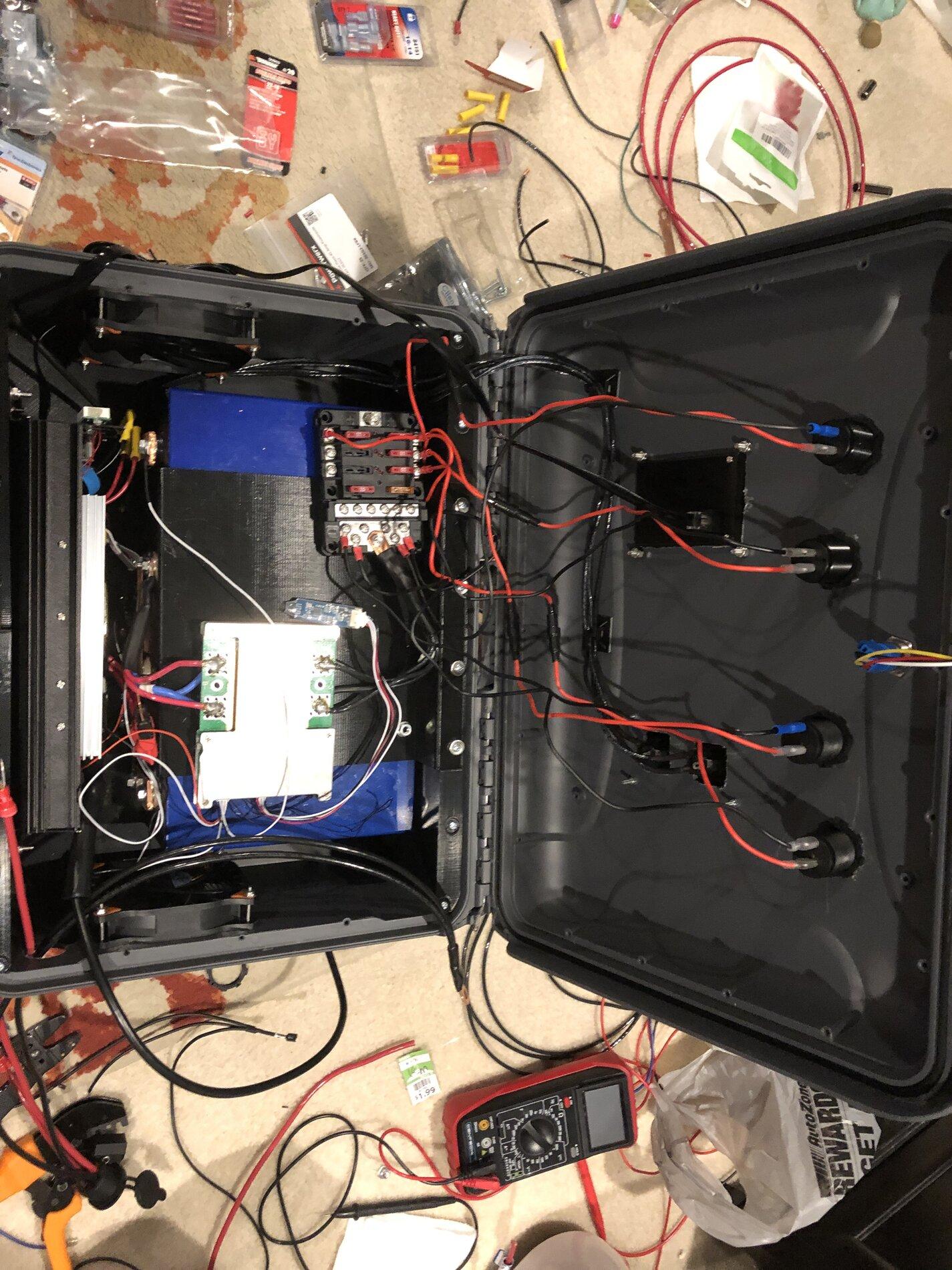

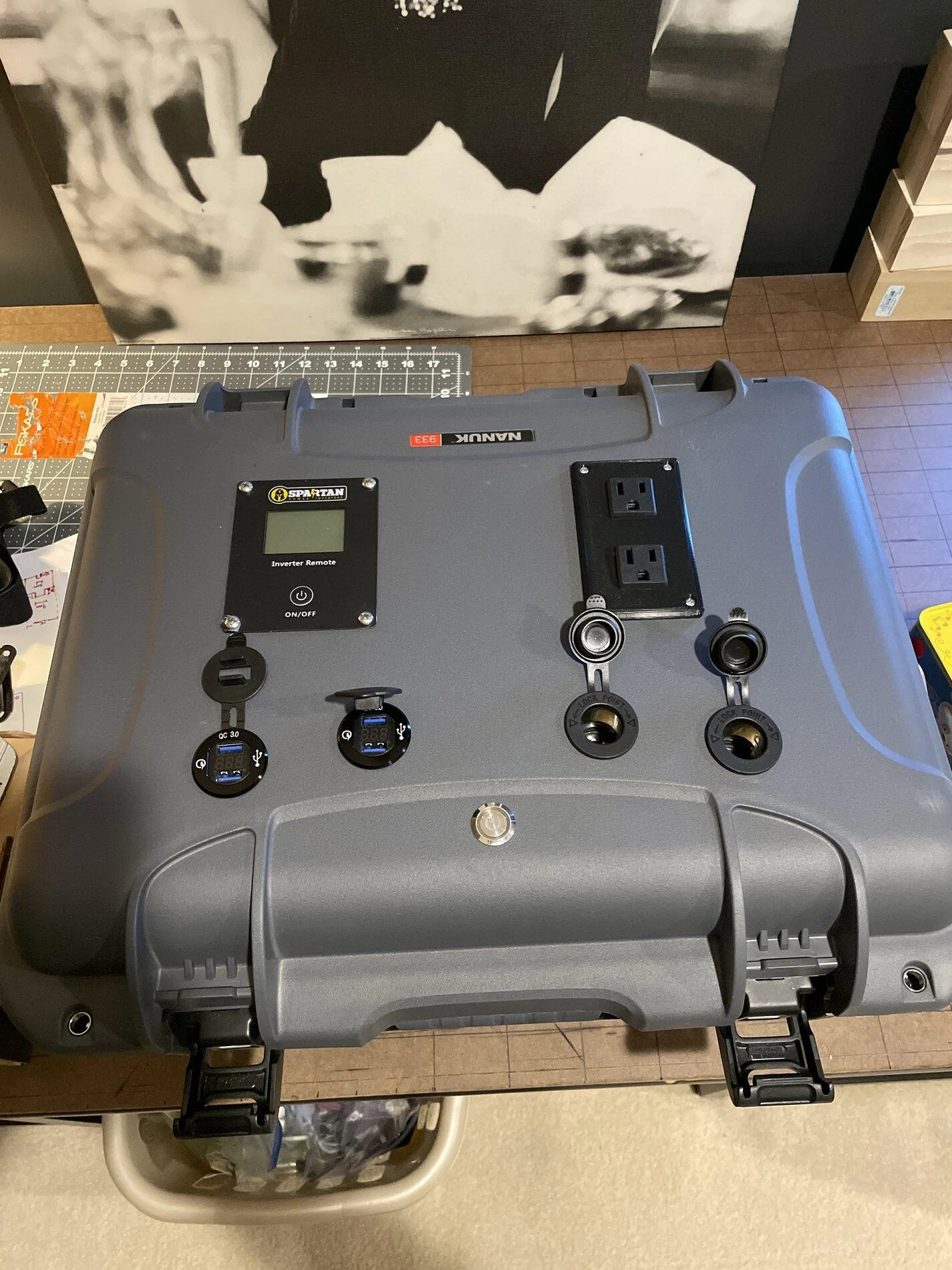

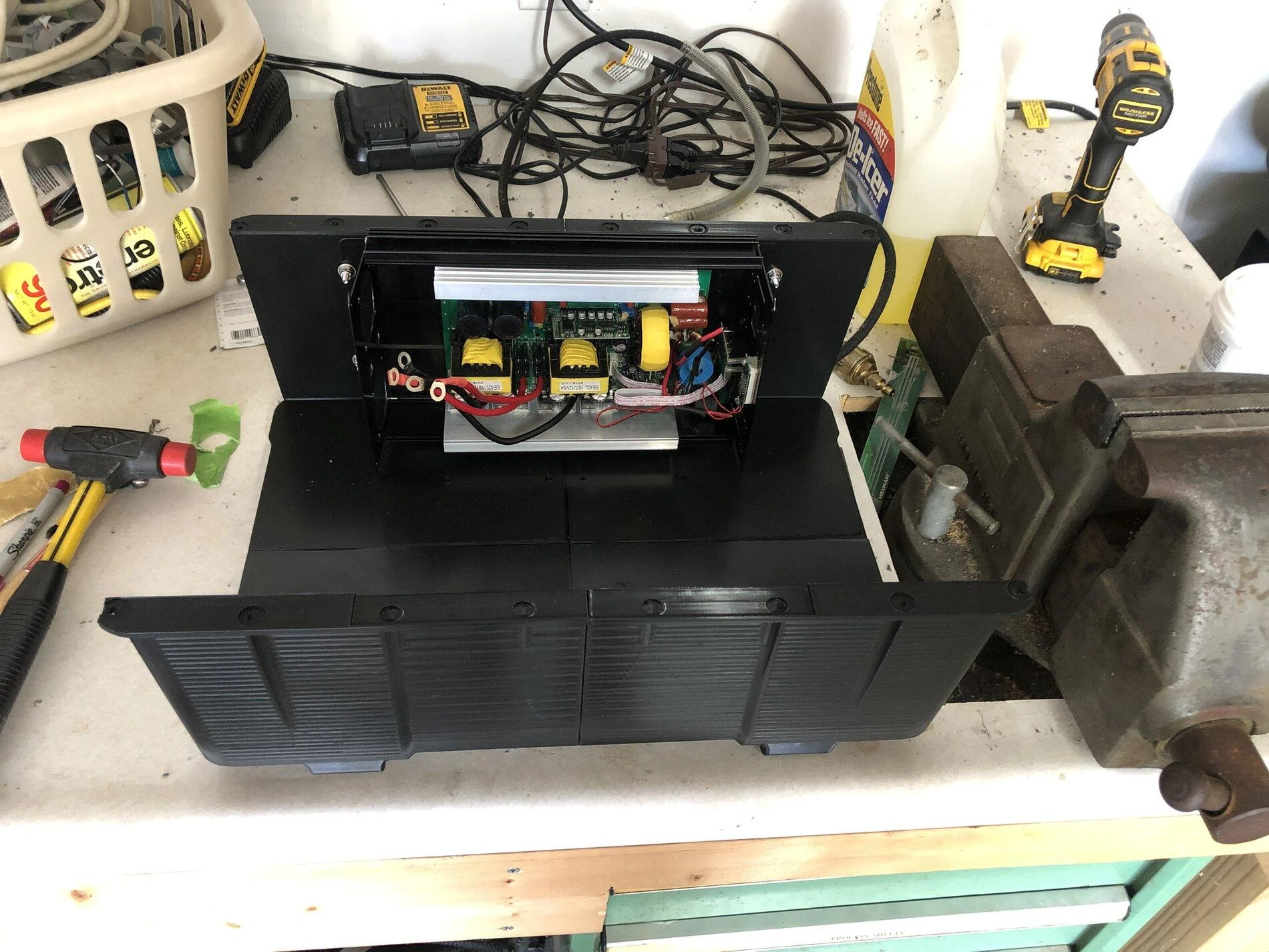

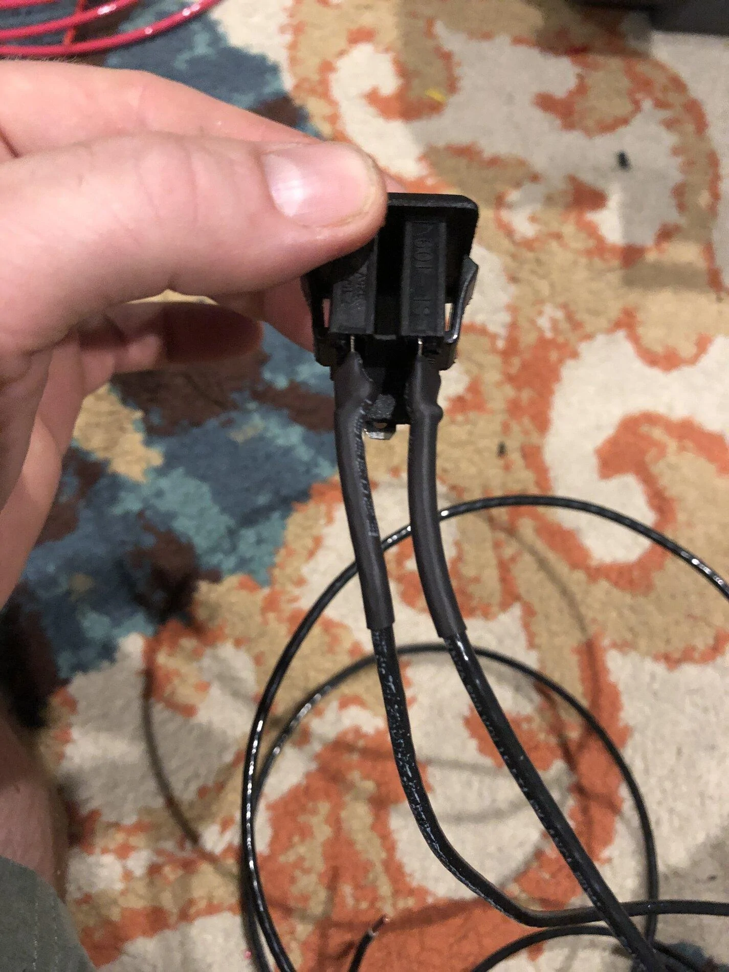

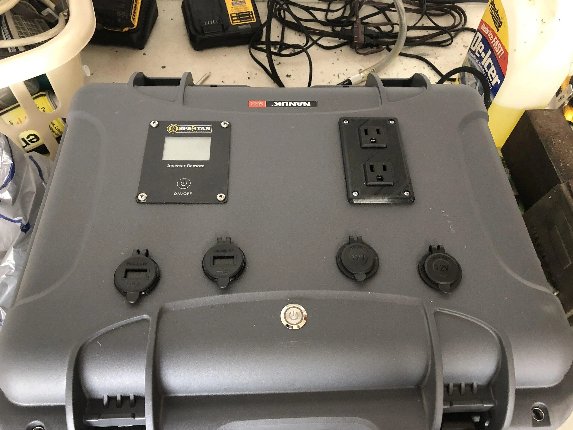

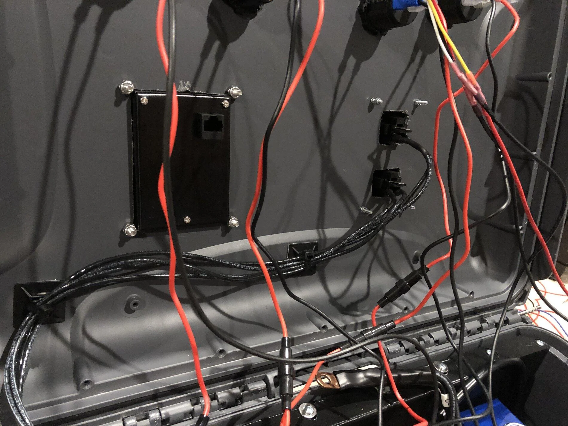

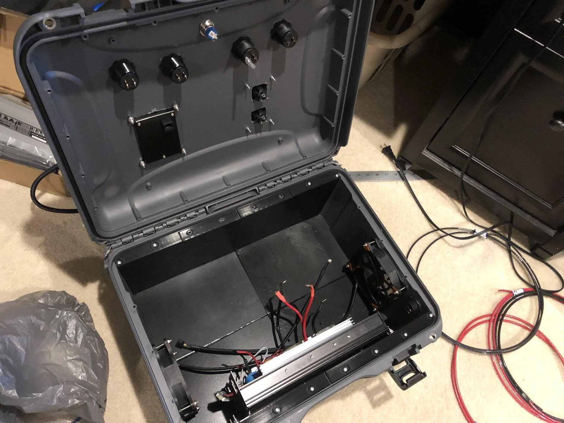

Where we camp generators are a big no-no.
So I built a battery box with DC-DC charger on it that lived in the bed. It had a canopy on it, I think in the USA yiu call it a topper?
I ran wires to the back (fused at the positive terminal) and the cables ended in a plug that matched the input for my battery box. The DC-DC charger automatically switched on and off by sensing the voltage from the engine battery. In essence it was a smart isolator.
I put a myriad of power points on it for the fridge/lights etc.
It was a 90ah battery and we could easily run our fridge for a weekend on it.
If I do it again I'll put the fridge behind the seats (my extended cab doesn't have extra seats) and the battery next to it.
The old school overlanders always put the second battery in the engine bay, with an isolator relay between the batteries, and then ran a cab to wherever to power whatever. This makes a lot of sense as the current draw is a lot lower for something like a fridge than for charging a battery in the bed, so the cable can be thinner As there is less voltage drop.
