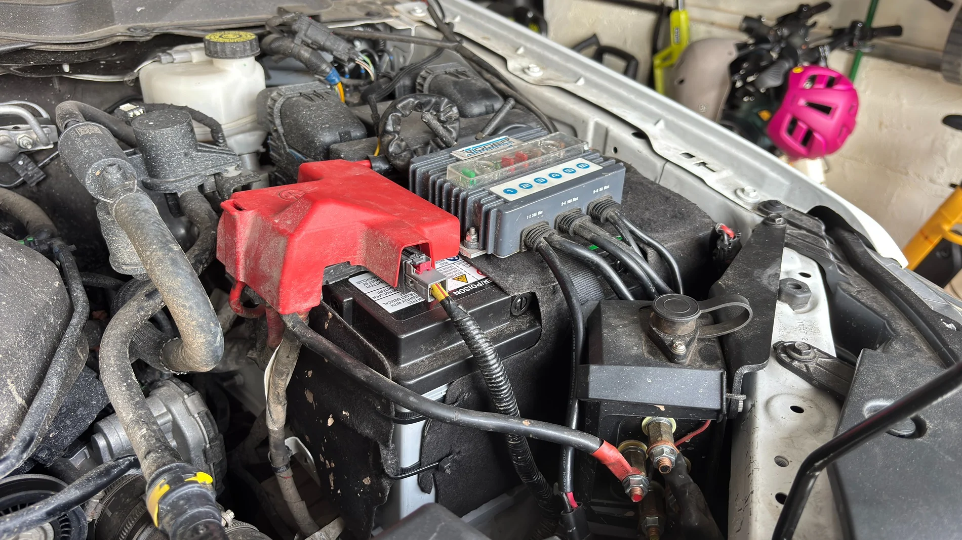

Thanks Mike for the original post. I just upgraded my XL to the Lariat size battery. It was a tight fit with my winch control box and trigger six box mounted in the area but its all neatly tucked away now and I'm happy to know i have some extra juice for my added accessories and winch. I just used the stock battery heat shield and snugged up the gap with a few zip ties, I doubt the 1/2" that goes uncovered will result in sizeable life loss of the battery.

install pics?
Illking
Nov 10, 2021
310
1,291
Los Angeles
2022 Ford Ranger XL
install pics?
under the Trigger six is a bracket that holds the module to the battery safety strap, also velcro to keep the module from wiggling around on the felt. Its very secure. You can see on the bottom left of the battery I had to bend out the white metal tab just a smidge to allow the fit of the battery. There is just enough room between the winch control box and my battery to work but to make unbolting the battery strap a complete PITA. And of course my frankenstein zip ties on the stock battery heat shield. Would have loved it it was hidden in the back right corner but its probably best so anyone working on my truck sees that first and knows how I operate lol.
