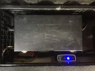

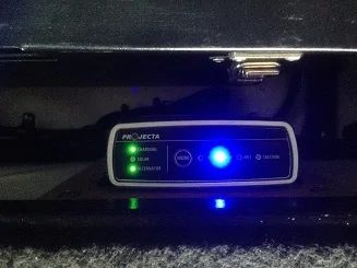

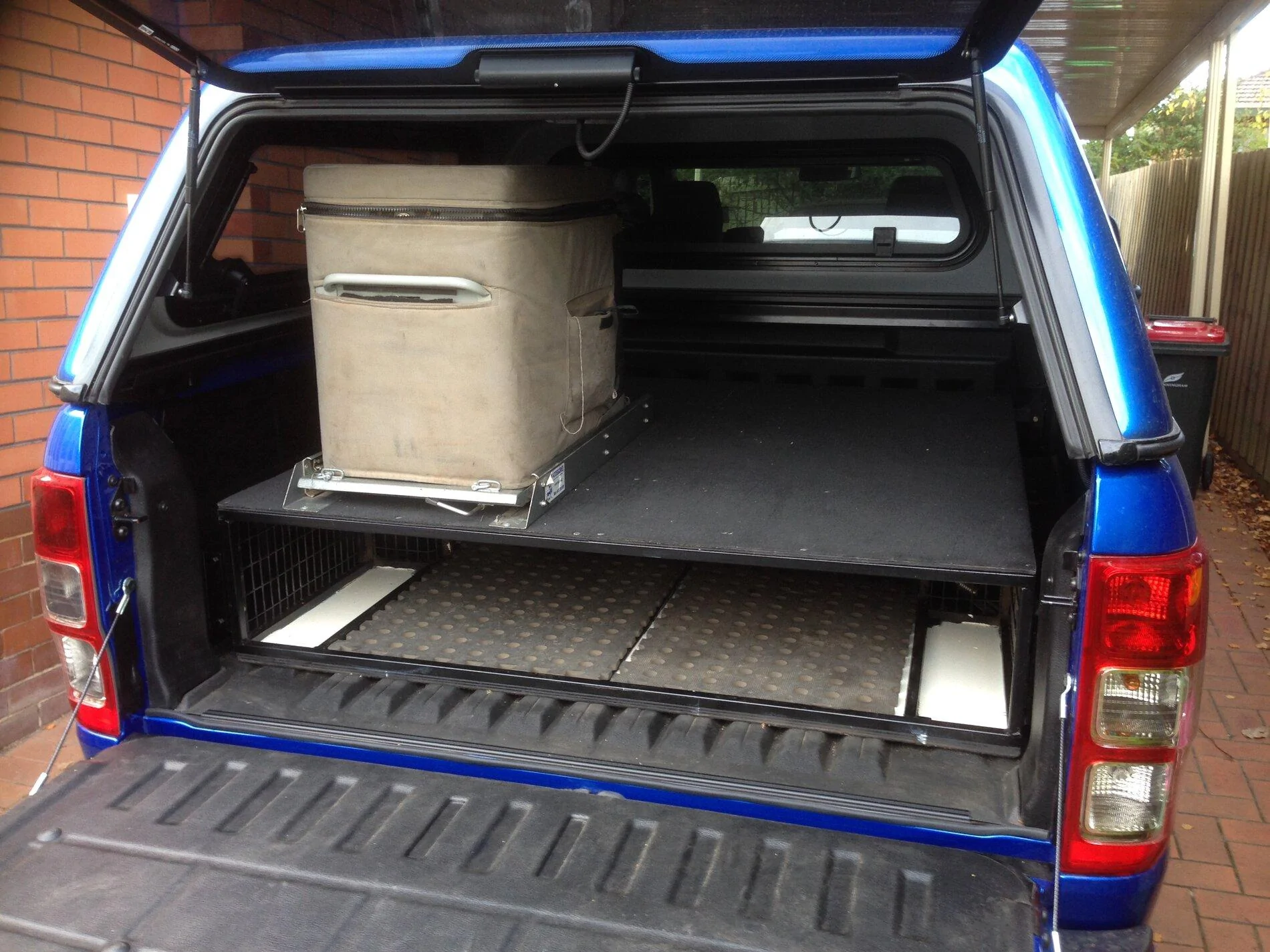

I don't know how different your petrol Rangers are from the diesel units sold here in Australia, but every second touring Ranger here has a dual battery system installed.
There are tray mounted cradles, underbody cradles (by ARB for totally sealed batteries), and now cradles for mounting slim lithium batteries behind the rear seats in the double cab Ranger.
I have a false floor in the ute tub and a canopy. I have a $300 AUD 105 ah sealed battery and a $400.00 AUD Projecta Dc/Dc charger. It is solar capable as well. This power my fridge without issue and I have all camp lighting connected to it.
This sort of set up works for me. The only disadvantage is that the battery is heavy at 50 lbs approx.

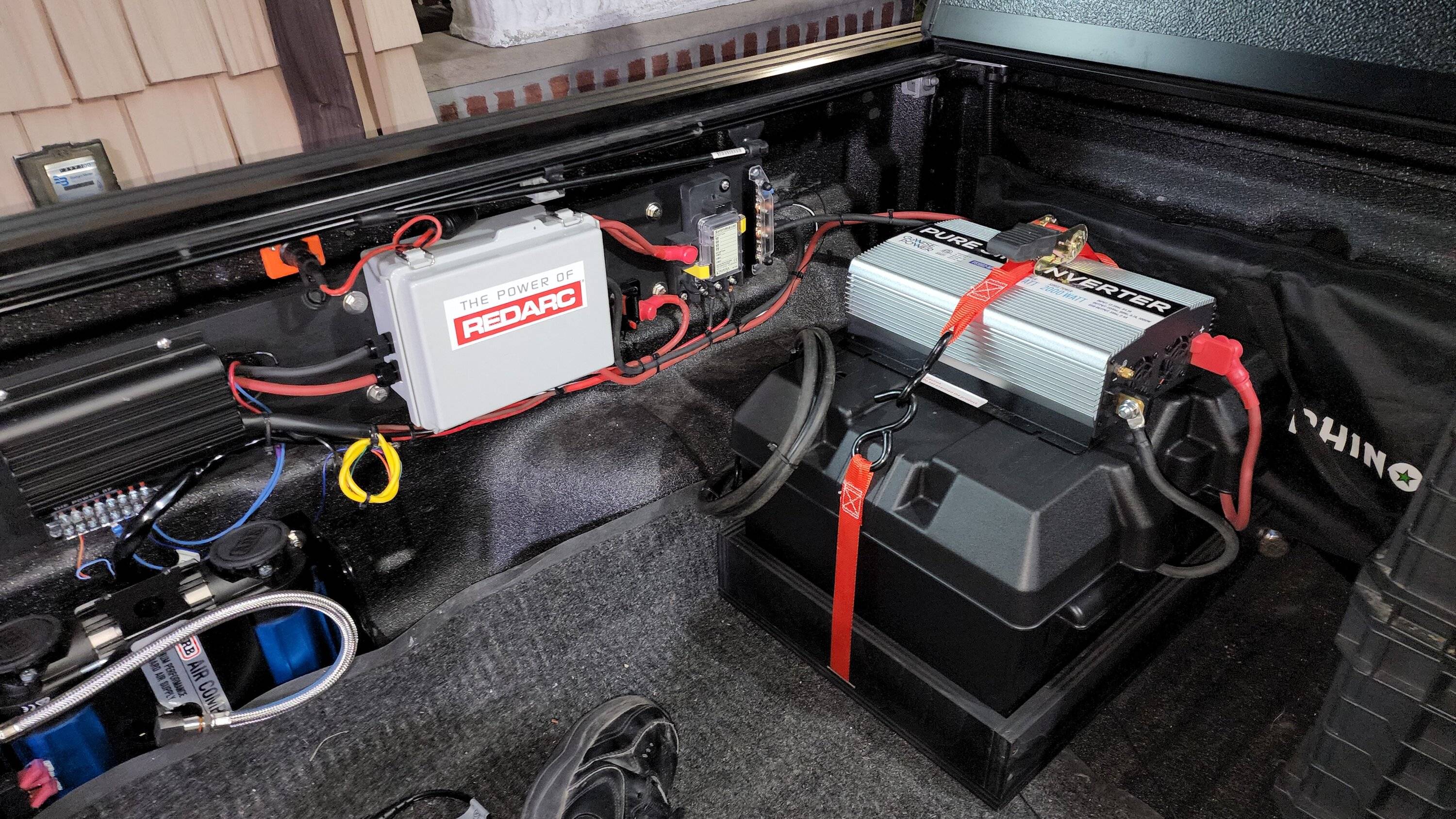

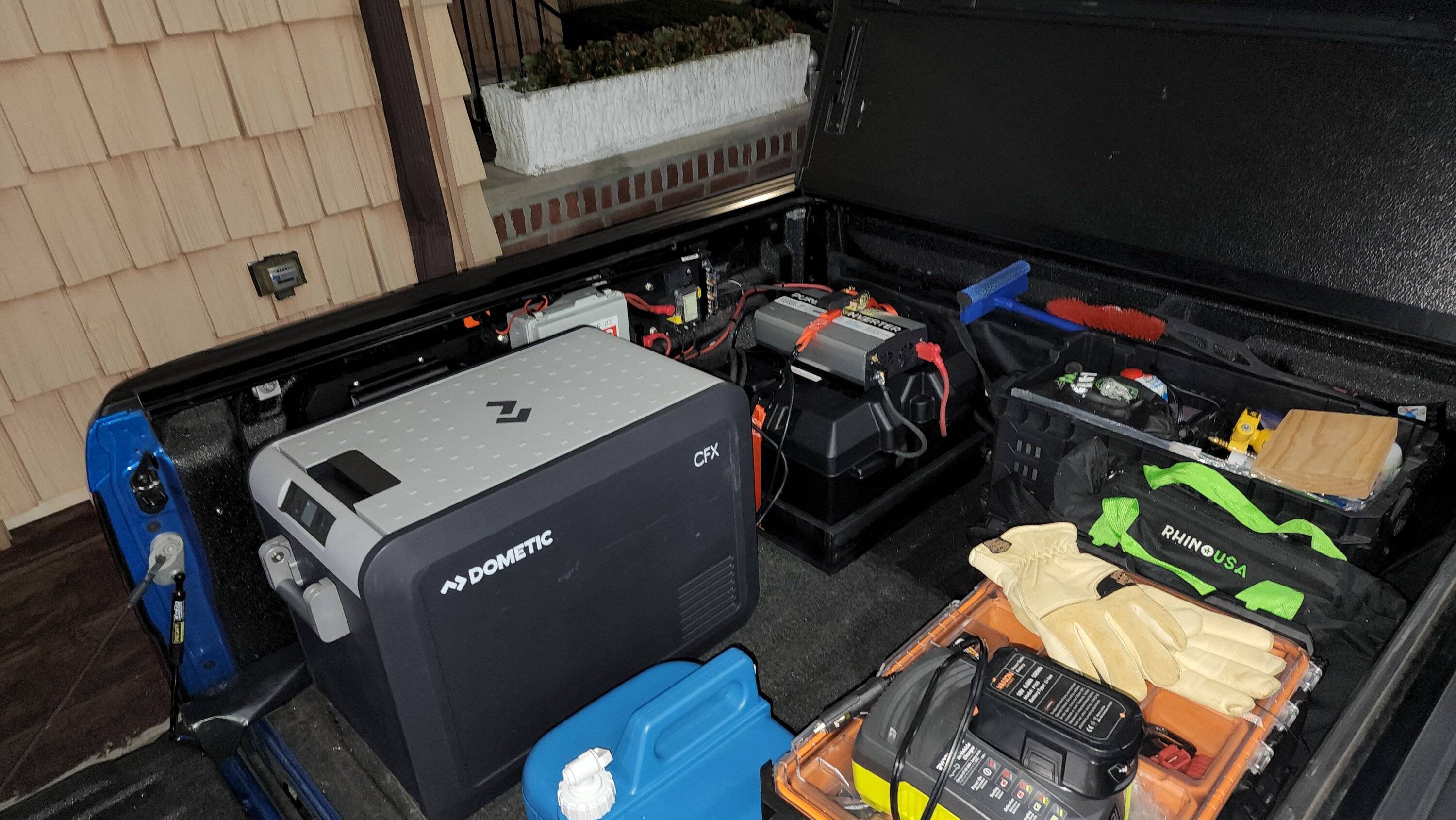

2x 100ah lithium batteries, charged by the redarc 40amp bcdc.
2 nights ago, we ran a 12v video light for hours, a fridge, charged a bunch of electronics, then powered 2 CPAPs over night for me & my buddy. In the morning, I was down to 77 percent.
Brett Fields
Brett
Jul 20, 2021
373
929
Brooklyn
2021 Lariat FX4, Blackout, Tow
Paramedic
Two more thoughts here...
First, I only used the two 100Ah batteries cuz I already had them. They take up way too much space. If I was starting starting over, I would use a single 200Ah battery.
Keep in mind, you may not need 200Ah of lithium. I sized my system to run my fridge, my CPAP, and whatever other electronics for a long weekend pluged into an inverter. I'm working hard to get everything running off 12v so I don't have inverter overhead.
Second, I could have used a smaller inverter. I have a 1000 watt pure sign wave unit. With most everything running off 12v, the inverter becomes more of a backup tool for the "Just in case" scenario. With a smaller unit, maybe I could have mounted it more creatively.
