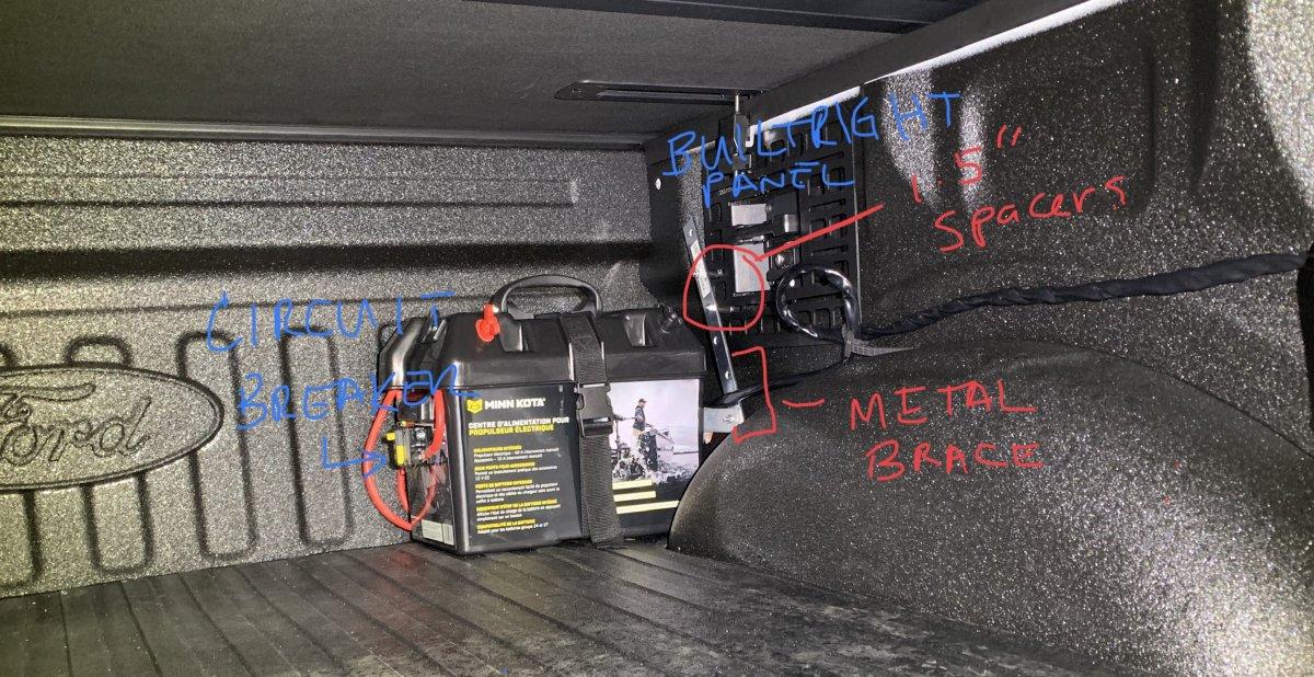

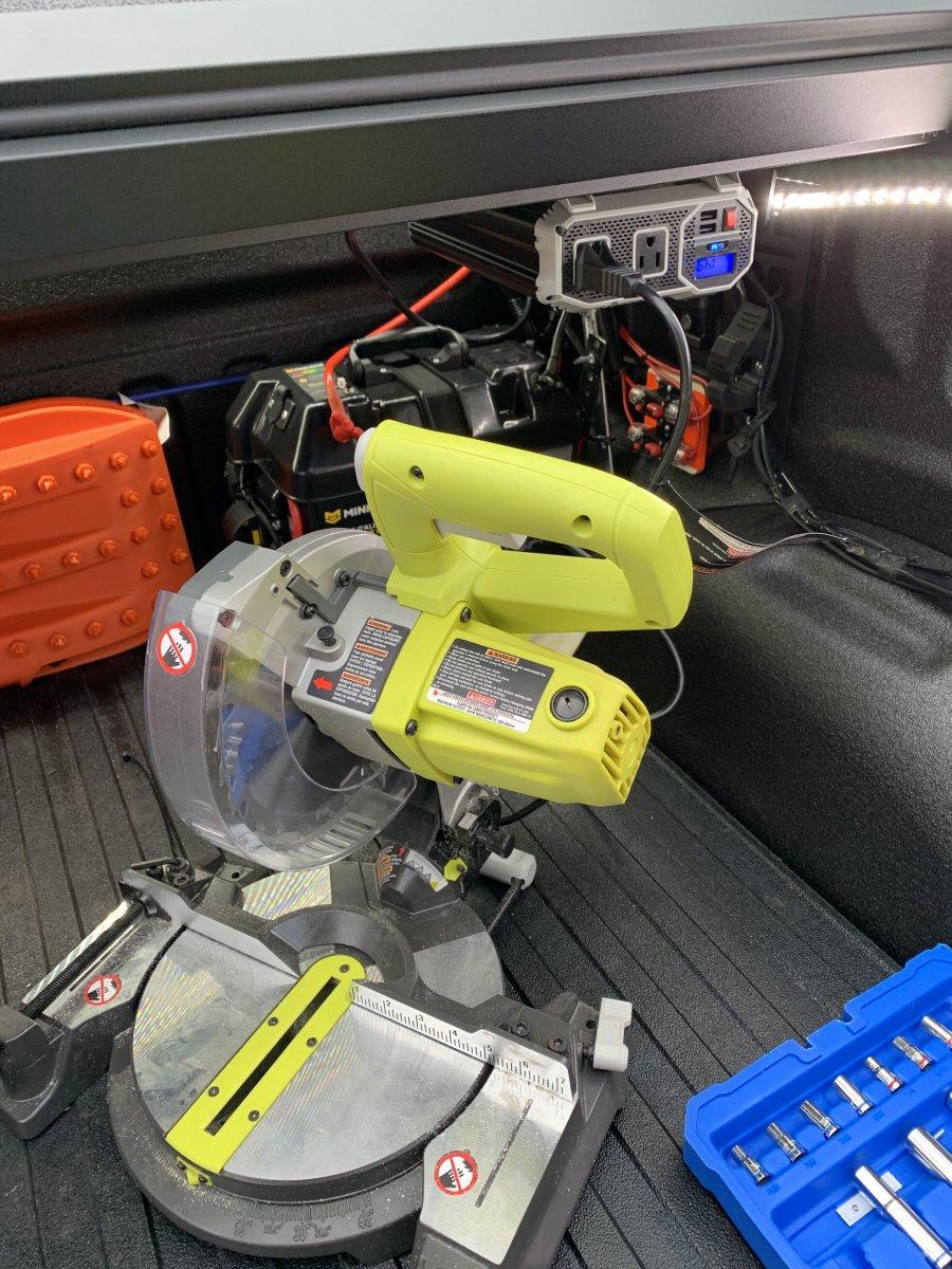

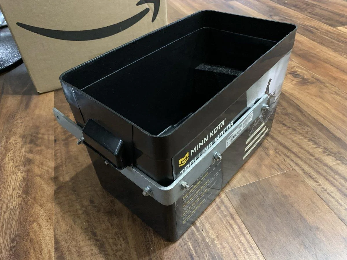

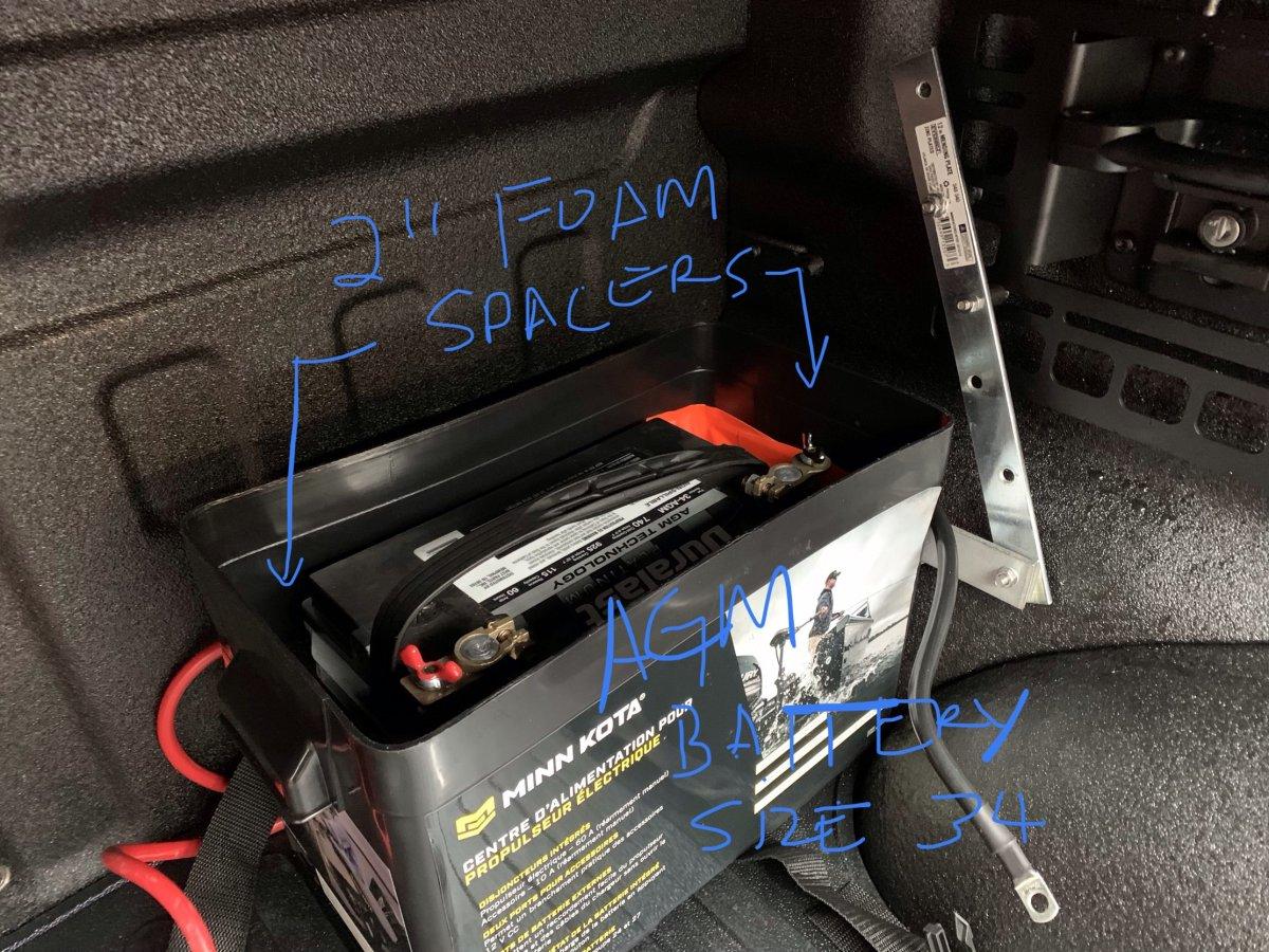

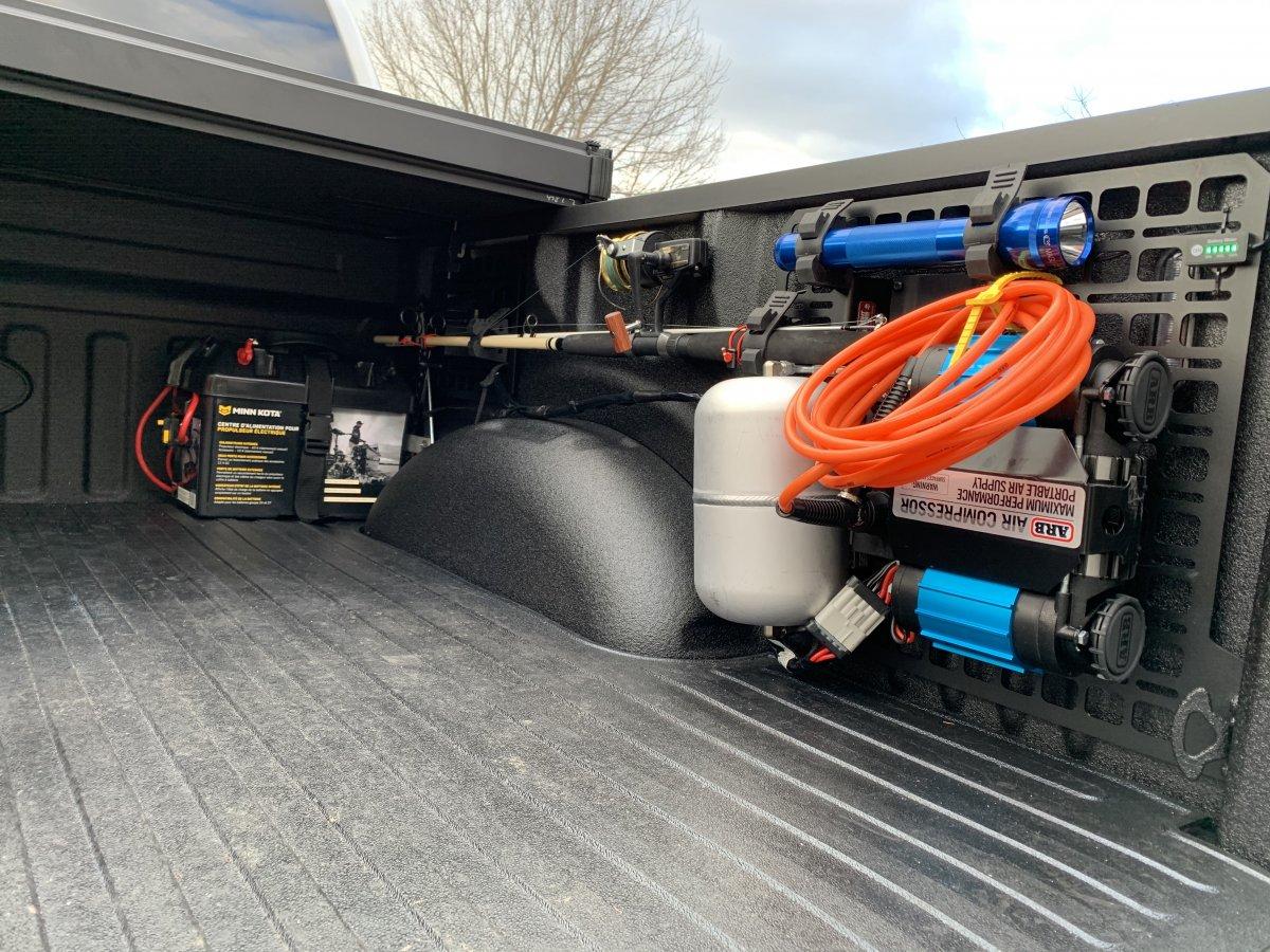

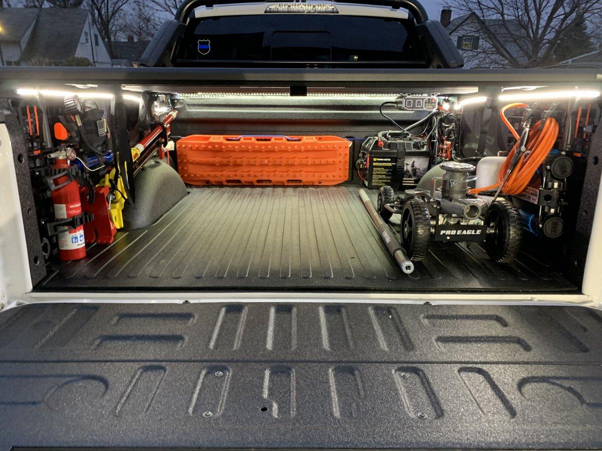

I did a non-permanent dual bettery setup on my Raptor.
( not planning on doing it for the Ranger...yet)
I used a Trolling motor battery case, a size 34 AGM battery,

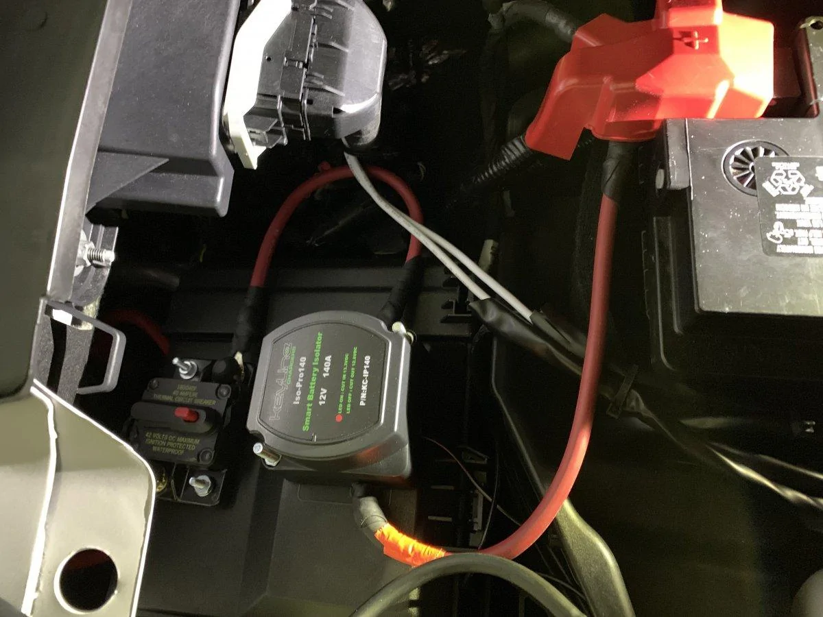

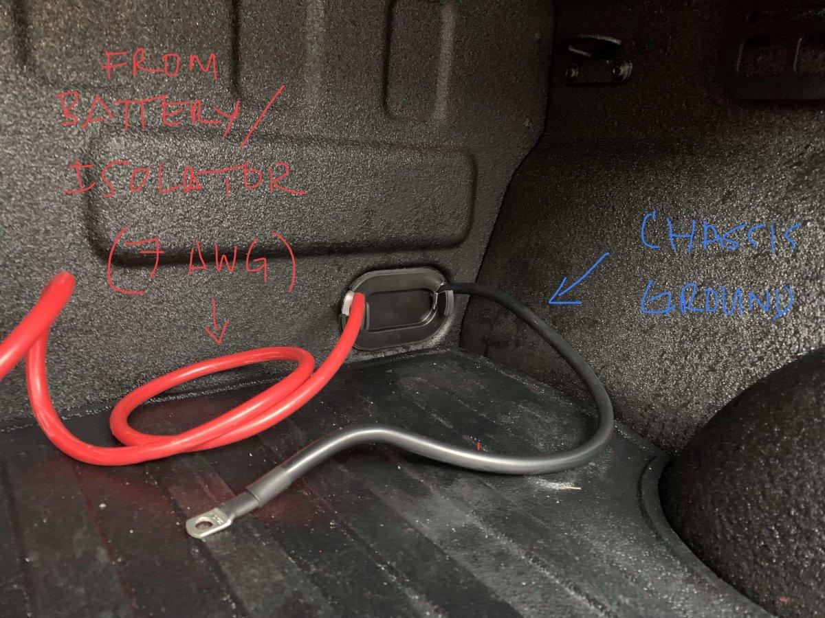

a battery charger/ isolator and a cicrcuit breaker to and from source battery(hood) and 2nd battery(bed). Run the 7awg from the charger/Isolator kit, under chassis frame, then into the bed.
(Its important to add circuit breakers to and from, for safety reasons, in case the wire gets damaged you dont want it to turn into an arc welder, remember you now have 2 batteries, not one)

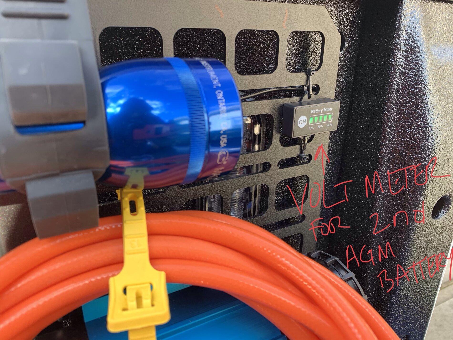

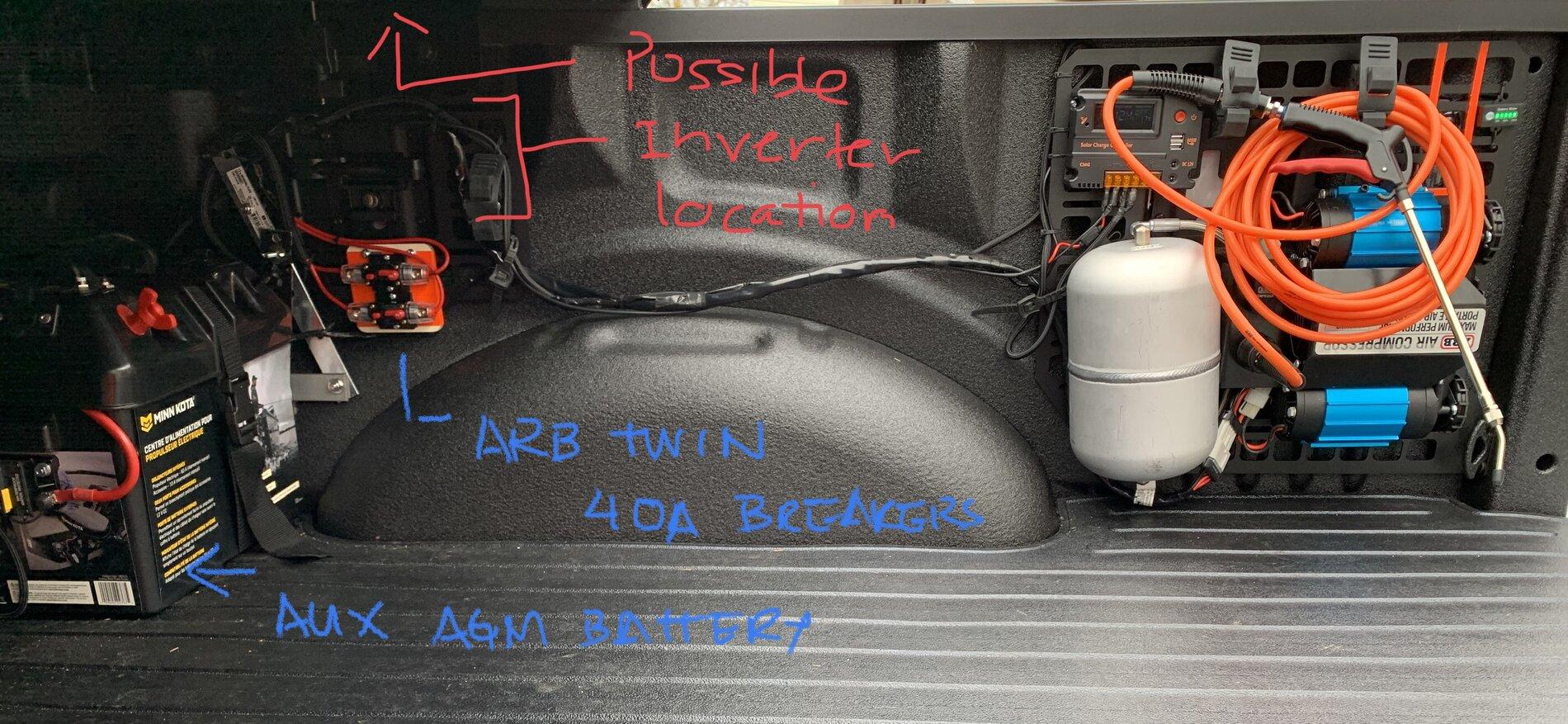

No issues, for the year that I had the truck...running inverter, power saw, tools, Arb twin comp, etc...
Its not the prettiest setup, but it worked. :p
And its Not permanent, so I was able to remove the whole thing before trading my Raptor.?

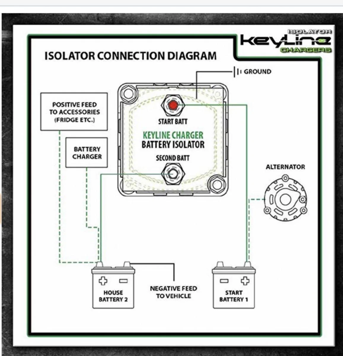

The old school overlanders always put the second battery in the engine bay, with an isolator relay between the batteries, and then ran a cab to wherever to power whatever. This makes a lot of sense as the current draw is a lot lower for something like a fridge than for charging a battery in the bed, so the cable can be thinner As there is less voltage drop.
