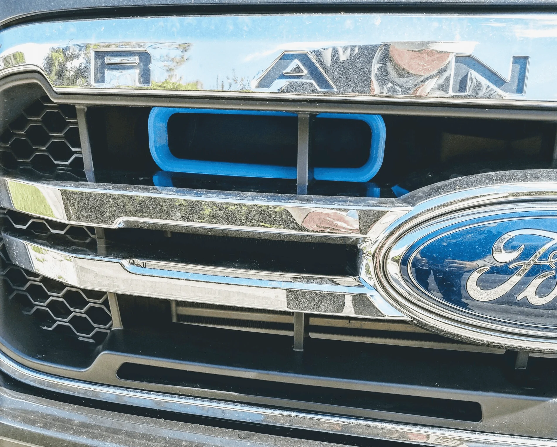

It went in just about the time we switched to winter fuel and I added a Velossa Tech Big Mouth at the same time.
Ah, you also installed an intake snorkel. Does that just attach directly to the airbox in place of the factory one? I was noticing how the whole area around where the factory snorkel pokes up is sealed off except the front where the air comes in. I thought this would give great directed air to the snorkel.
Not really a snorkel so much as a cold air snoot. There's no ram-air effect really, but it does draw ambient air, as opposed to the bubble of hot air from the radiator.
I mean, it's a turbo. What's a little ram air gonna do?
Cold air, on the other hand, is very bueno.
It's one of there..
https://www.ranger5g.com/forum/threads/velossa-tech-design-big-mouth-for-2019-ranger.9147/
