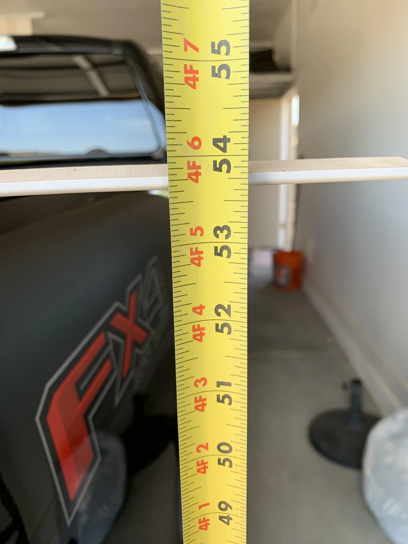

Still higher in right side (stick for measuring purposes)
142
7,016
36,214

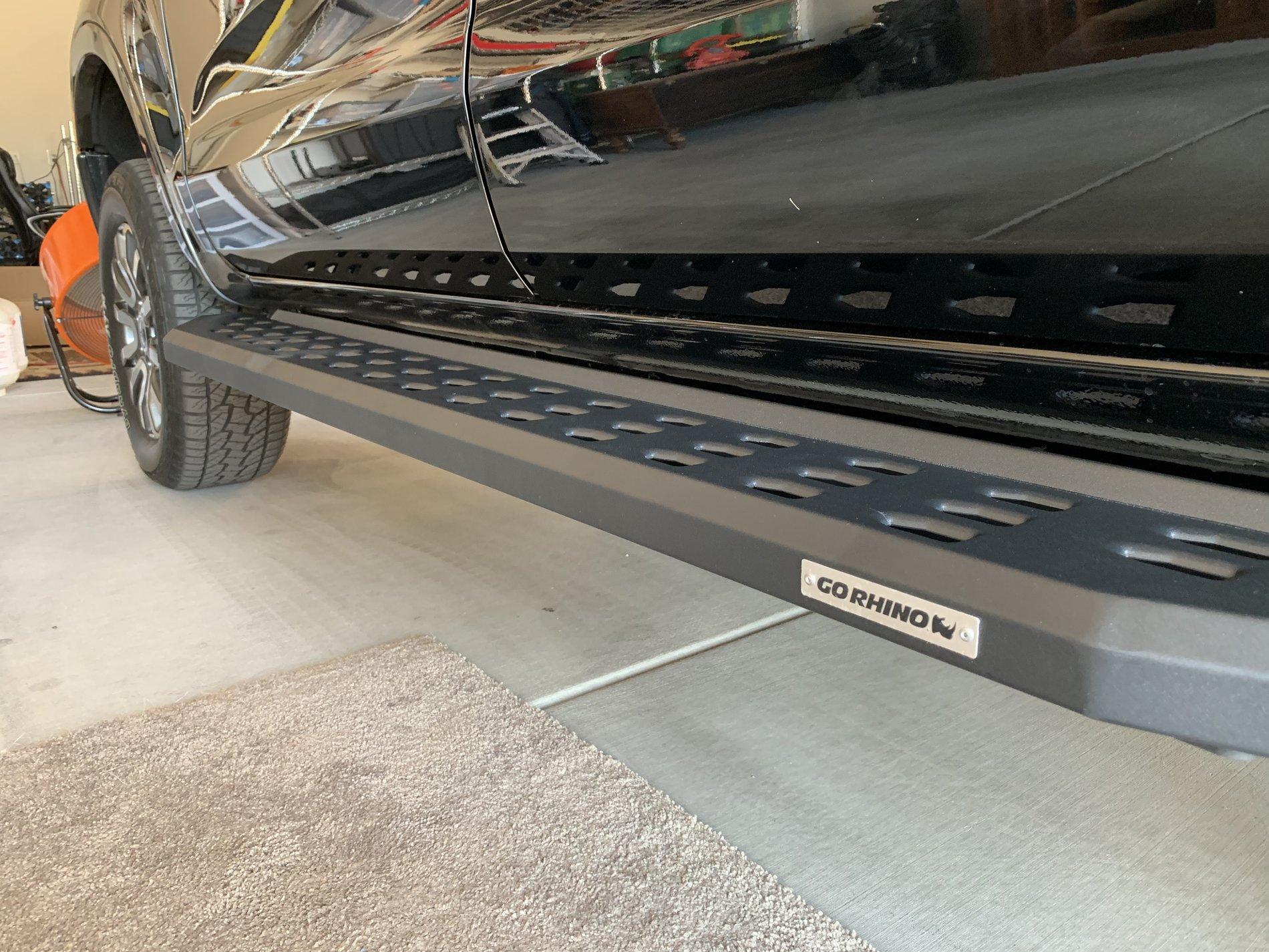

Hi Gavin,
If you do in fact replace the left spring. When you remove the old spring, compare the "free length/ height"...would be interesting to see if the old spring was out of wack before an install on your truck...I really do not think shimming is such a bad thing as long as it is an approved Ford 'repair". As for aftermarket, we aligned our Off Road teams with National Spring...They are/Were? a top drawer supplier...
Like the running boards...Are they frame mounted or body mounted?

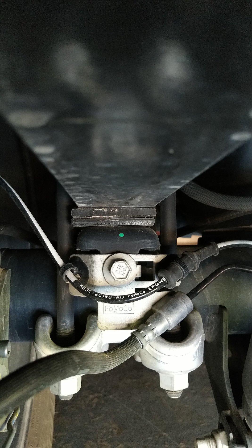

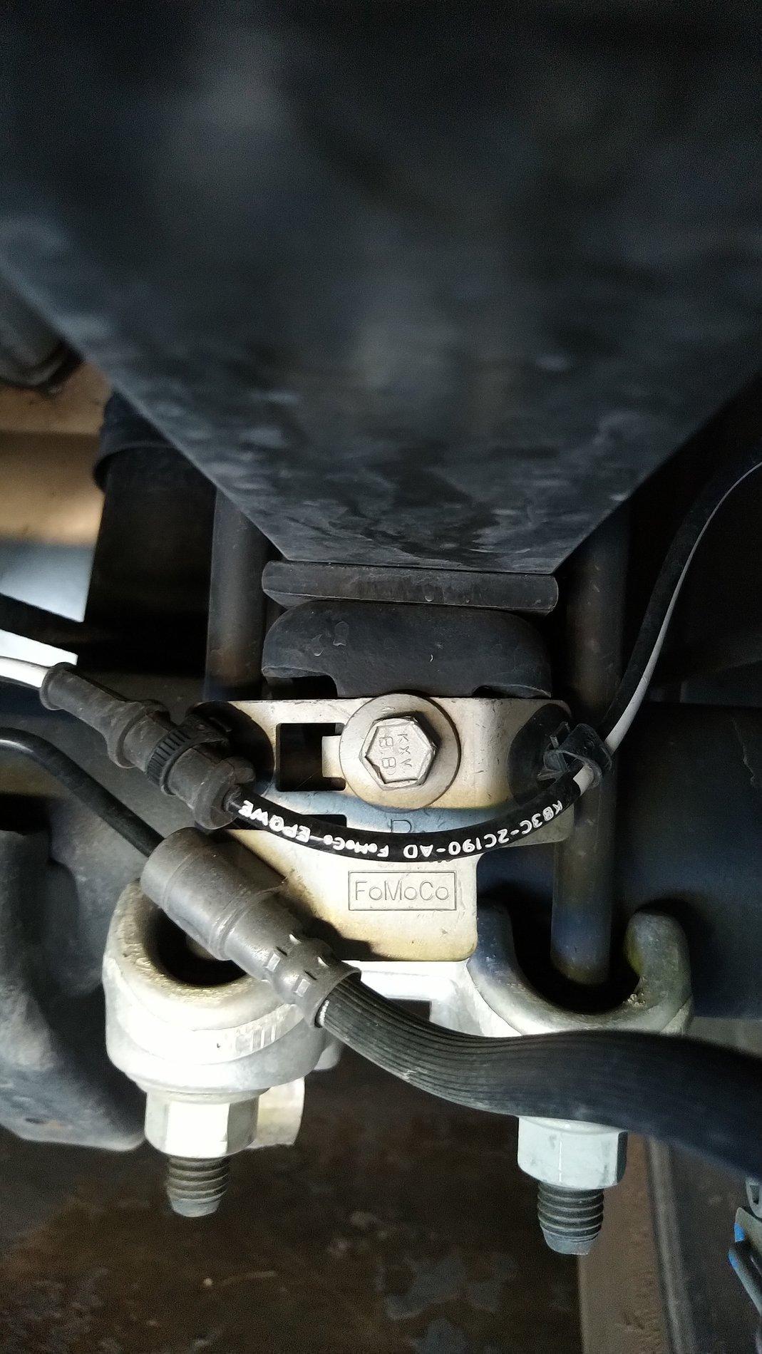

I noticed my truck has the shim from the factory, 1st pic is the driver's side.
My truck was built in March so they knew about the issue when you took yours in the 1st time.

Hi...
Amazing...Now if this was really from the assembly plant, I would expect that there will be a TSB on this...The assembly plant does not do this on the fly...Truck Engineering has to have been alerted and there were likely tests run to ensure this is a proper "fix". There will also be a very detailed paper trail as well. Will be interesting.... Are you sure it was not added by the dealer?

It could have been dealer....I was wrong for saying factory as I really don't know.
I am definitely bringing it to their attention & I will ask if they installed it. My truck isn't level either, it's only 1/4" lower on driver's side (front & rear) so I wasn't concerned at 1st but seeing the spacer changes everything.

Hi Justin,
Thanks...I am not challenging you but trying to understand this phenom that affects a small percentage of vehicles. I hope the dealer is honest with you on this. In looking at your pictures it does not show that there is any shiny spots on the U bolt nuts that indicate an impact wrench was used so do suspect it was at the plant. If it is indeed the plant, then I have a good feeling that this has been thoroughly tested before the plant was authorized to install a shim... Please keep us in the loop on this as the archive of such info is key for other Ranger owners.
Damn you @User79. I just *had* to go out and look out of curiosity and since my truck was built in March. I have a drivers side shim as well and I can tell you with 1000% assurance that my dealer did not install it. Would be cool if @P. A. Schilke knew someone at the factory that could describe the issue.

You made me go look as well! I also have a shim on the drivers side and my truck was built in March as well.
The mystery deepens....

It would be interesting to know if the spacers are least consistent - at least on Lariats. We've got at least 3 Lariats that have the driver side spacer.
